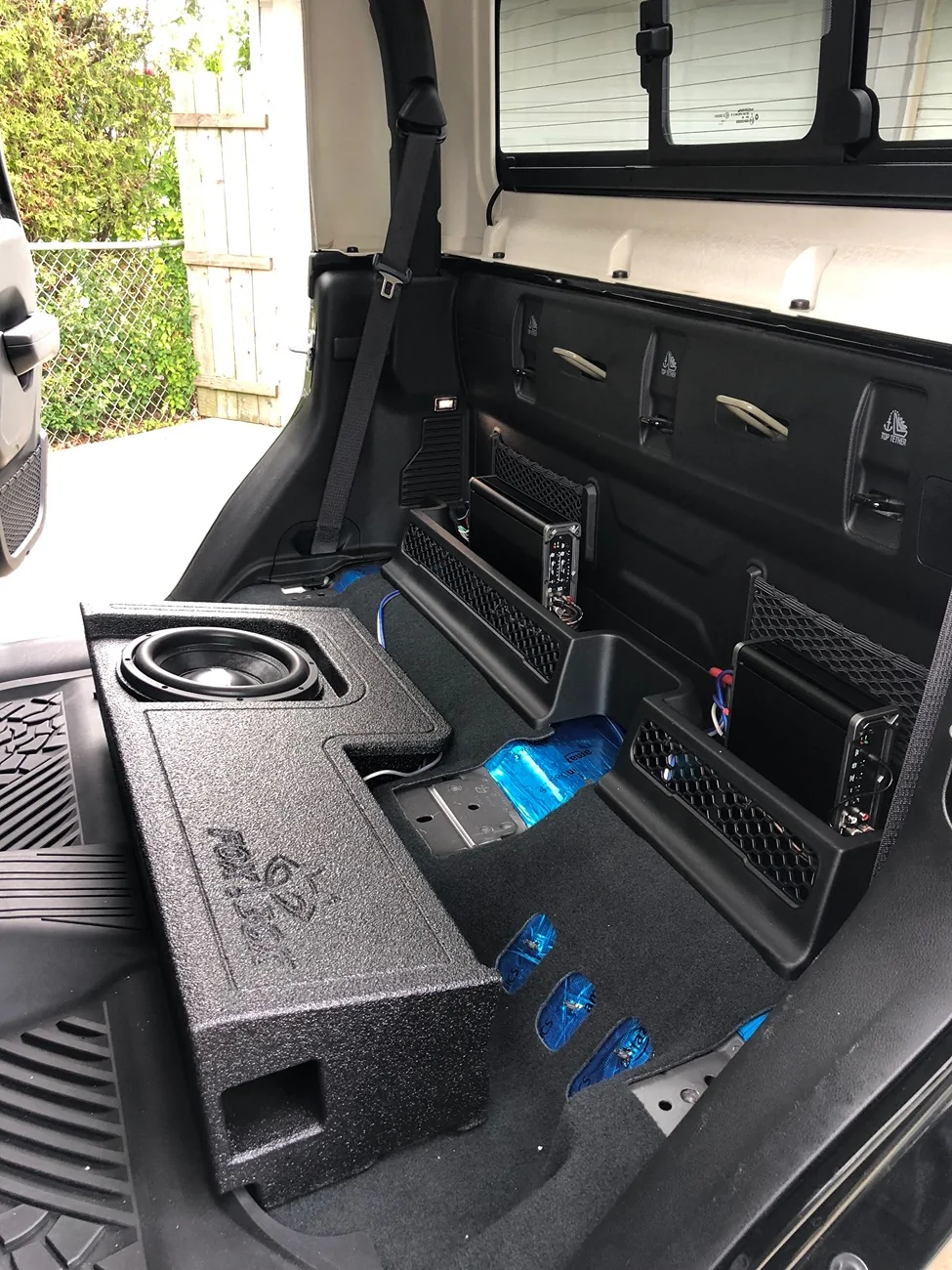

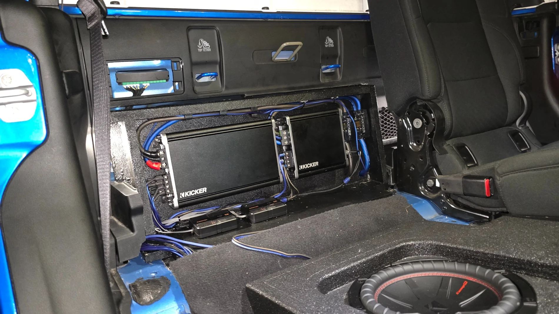

Stage 1 complete. Full replacement audio with stock 7" head unit. I used the PAC AmpPRO AP4-CH41 since I wanted to upgrade the speaker wiring (16 gauge ofc) too. Ran RCAs from the PAC to the amps. Used a kicker 360.4 and an 800.1. Ran zero gauge wire - tight fit under the door sills!
Upgraded the fronts to kicker KSS650 6.5" components and used the KSC690 6x9s in the soundbar. Used the MB Quart adapter kit. Went with the Fox Acoustics Fox Box single 10" and a kicker comp R 4 ohm wired at 2. So getting around 600w RMS. It hits WAY harder than the Alpine sub but probably going to replace with the Sundown ev4 2 ohm when it's available.
Jeep Gladiator Full audio upgrade - bye bye Alpine, hello Kicker my old friend 20478
See post here
After a month of solid use, gonna make a couple tweaks. Looking for some more mid range oomph.
Stage 2 upcoming - redo amp rack to be about 3 inches wider, add d4s dsp68+ dsp, new power distribution, another 360.4 to have 8 speaker channels, and possibly add 3.5 mid in dash.
Once the dsp is in, I'm gonna use REW with a miniDSP umik to dial it all in (already versed in it from home theater use). Needs to cool down a little more in Texas before stage 2 starts.

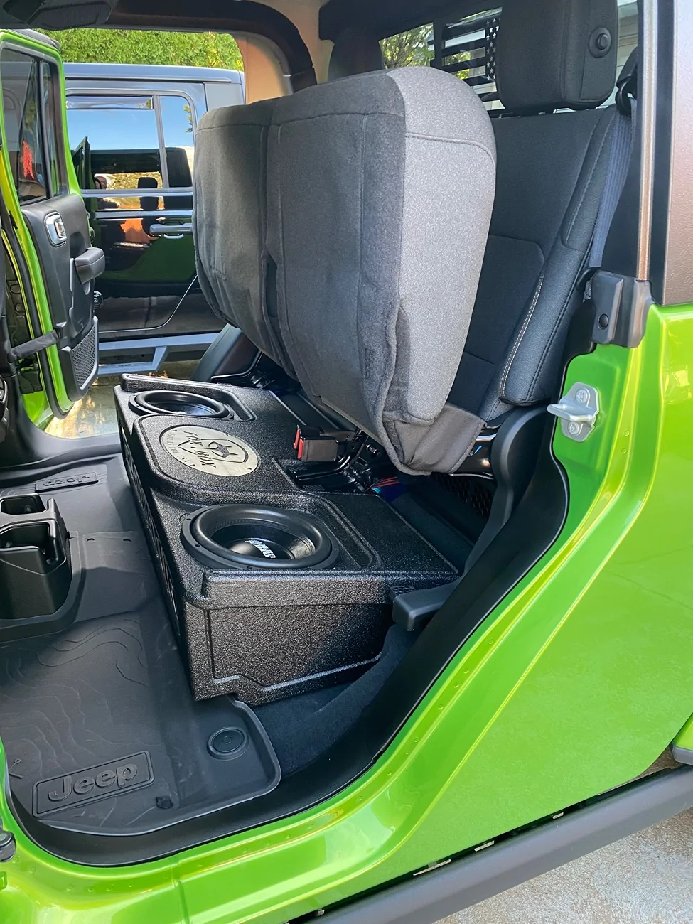

When I had my GMC I did the big 3 upgrade when adding a sub. Zero gauge to the amp, amp to the frame and alternator to the frame,2 alpine 12inch x series and ran a 1500 watt amp to it and a separate 400 watt amp for the door speakers. Hit so hard I had to keep tightening bolts in random places.
When I Got the jeep I realized I still wanted my back seat and wanted it as excrete as possible. Did the full package including knee pods with the 6inch speakers but settled with 2 kicker 10in down firing under the seat. Total 660 watts. Is it like my old system..hell no lol but it is plenty loud enough for me now.

I did 2 10s under seat getting 600w pushed to them and Morel 6x9 in sound bar 75hz. Then I replaced the knee speakers 4in box with a larger 6in box and put 6in morel woofers in. It's a pain to replace them but they also hit at 75hz. Really helps that mid sound.

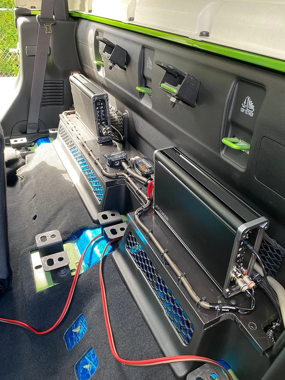

Nice build. I did very similar last summer in the wife’s 2022 same amps, kicker speakers (dash, knee and sound bar. Same box and sundown 10”
Just finished a new setup in my 2025 Willys using the new pac ap4-ch42 kicker components and fox dual 10 box with sundown subs 360.4 and a1200.1 . For daily drivers I was really impressed with how they both turned out.
