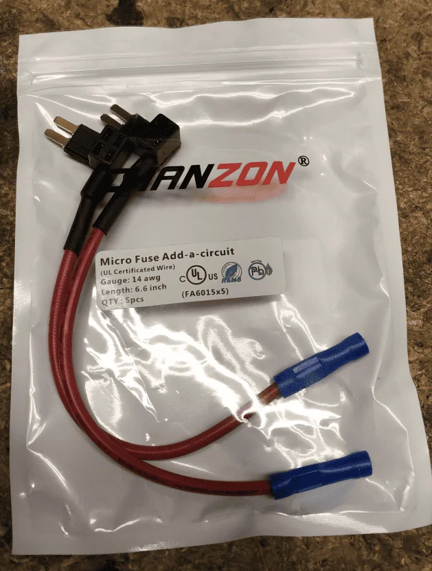

Just used these today:
Jeep Gladiator Fuse question... I've searched to no avail. Ta
Worked pretty well. These are 14ga. wire, many others are only 16ga. These taps basically let you piggyback onto an existing circuit, without interrupting that circuit, and add another independent fused circuit.
Got 'em here: https://www.amazon.com/gp/product/B083R55DBT
I was looking for a hot circuit, but I'm sure you can easily find a switched circuit in the PDC.
And if you don't have the factory Aux. Switches, you won't have the associated wiring harness(es).
Those are exactly what I'm talking about. I was able to go out yesterday (cold n windy but...) and did a quick recon on the PDC. Fuse #52 is switched and is hot on Aux and Run modes. Guess I should have done that first. Thanks for the assist folks!
