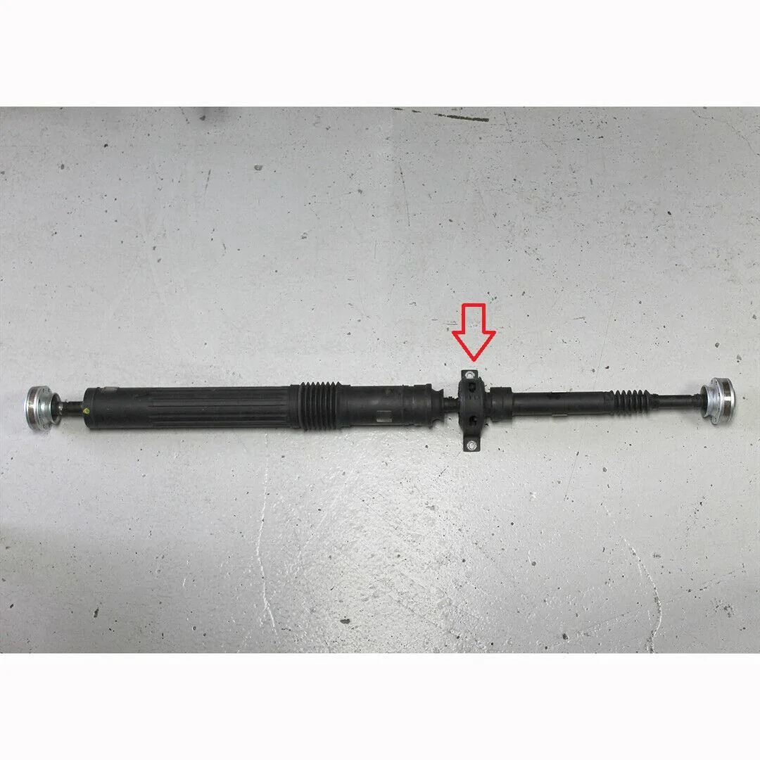

The recall is about what most would consider and call the drivershaft center support bearing and not the actual joint. Calling it a "monoblock" is more of an engineering term. For whatever stupid reason FCA did not make this center support bearing a serviceable separate item like it would in most other vehicle makes that use a similar setup.

Sir - are you referring to what we always called the "carrier bearing" in truck driveshafts where there was a center joint due to length of the total shaft and the flex involved?
I can't even recall all of the truck driveshaft carrier bearings I have replaced.
So in this case it's the carrier bearing and not the driveshaft per se - right?

I didn't realize that it was confusing to some people until I was reading through another Jeep forum earlier. Yes this recall covers the carrier bearing not the rzeppa joints. Mine is not listed under the recall but if I ever have problems with it in the future I will just replace the entire shaft with a one piece shaft which is what Jeep should have done in the 1st place.

Yeah, the carrier bearing or center support bearing. For whatever reason, it is not a separate serviceable unit like most other vehicles and the whole drive shaft assembly on both sides of and with the bearing have to be replace as one unit.
Attached is a pic of the Gladiator rear driveshaft assembly.
And that's silly- I mean it's a dang bearing. Why not make it replaceable or serviceable.
I was right about what I thought it was.

Given enough time, I am sure the aftermarket will find a way to replace it if economically viable. I suspect from FCA's perspective, it is either a maintenance intensive high tolerance press fit and/or replacement requires the assembly to be re balanced as a set and most dealerships are not setup for driveshaft balancing and it is a all or nothing replacement.
That may be it.
I took my Eagle driveshaft to a performance driveline outfit - they replaced the yokes with better, polished and balanced the shaft. It really wasn't far off but had a vibration I was chasing down and hey, it's my baby............
They showed me some stuff they've run across that would make you wonder WTF............
Like a Chevy driveshaft with the yokes out of phase, among other things. Factory issues.
Most dealerships are only equipped for basic stuff - decent at most things, REALLY good at very few.
Most are parts swappers, not diagnosticians. IMO, anyway........
