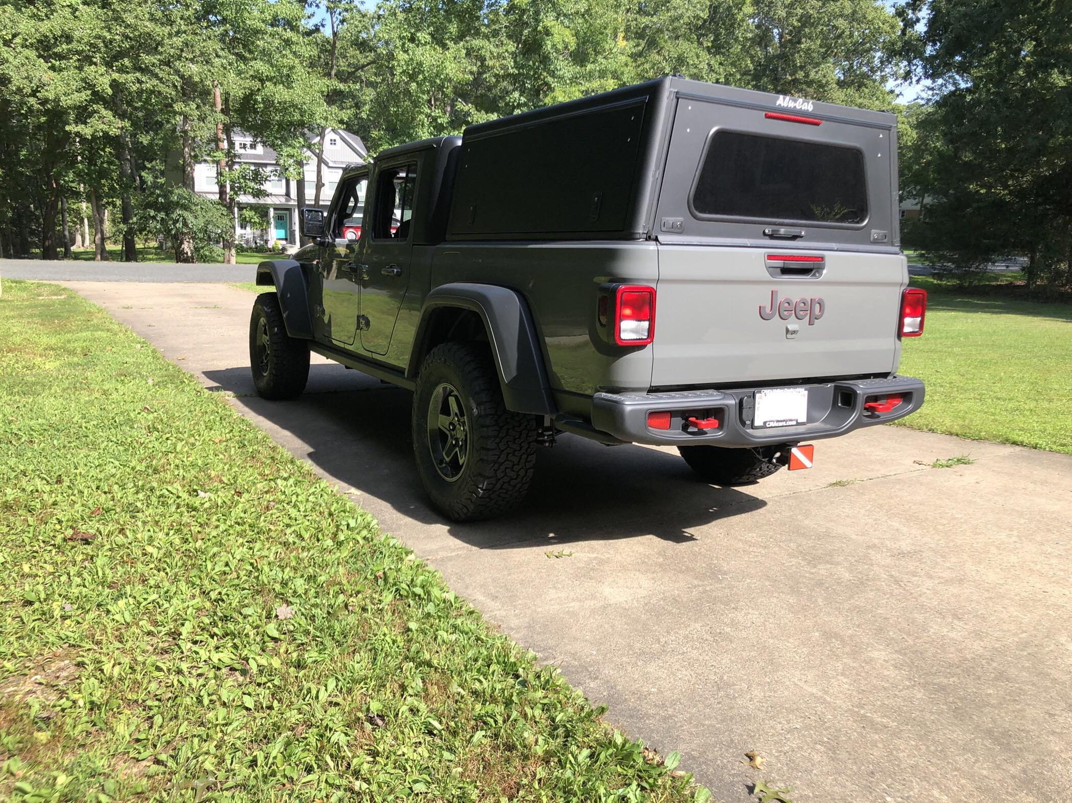

What a difference. Look awesome (perfect size, in my opinion) and rides great.
Edit: These measure 33.5” under load with ~38 PSI. With the AEV Procal Snap at 3, 3, 5…the speedometer is right on.

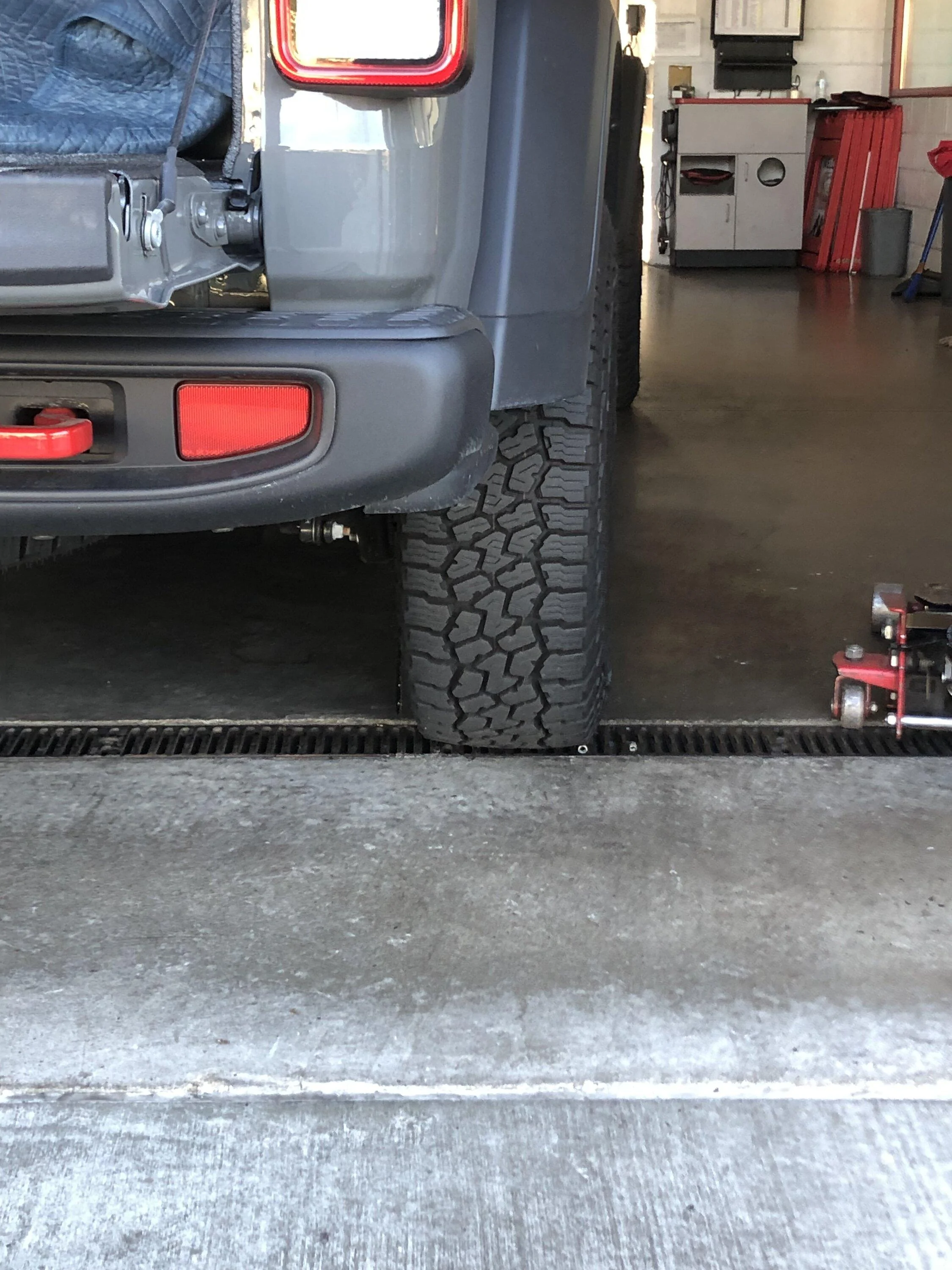

Before:
Jeep Gladiator Thoughts? - BFG A/T KO2 - 315 /70 R17 113T C2 vs. Falken A/T 3W 315/70 31337A4D-2AD6-4551-8FF6-DCEFAD3E449F

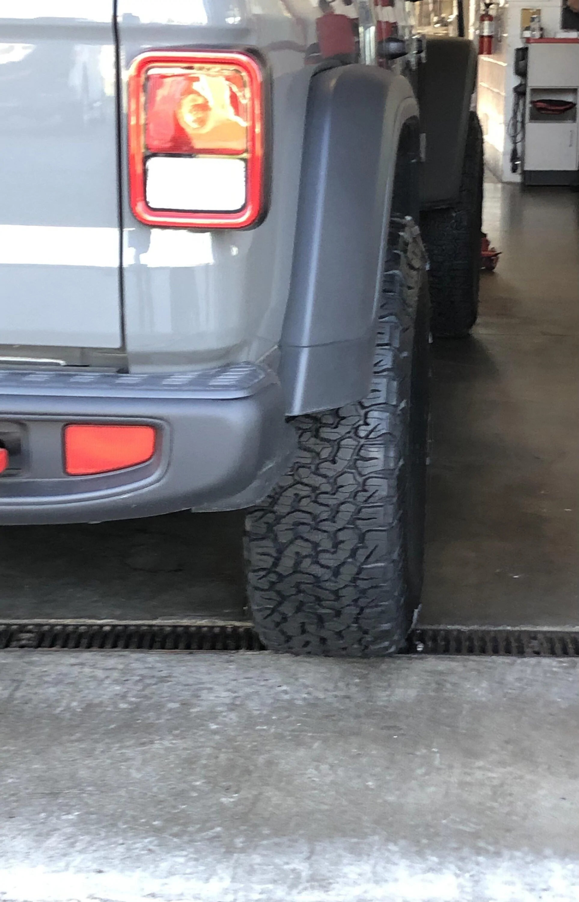

After:
Jeep Gladiator Thoughts? - BFG A/T KO2 - 315 /70 R17 113T C2 vs. Falken A/T 3W 315/70 03A2A8BA-320D-4ED3-ACBC-0194DC6EEF8A
Jeep Gladiator Thoughts? - BFG A/T KO2 - 315 /70 R17 113T C2 vs. Falken A/T 3W 315/70 AA1DD821-50AF-4869-A428-7DB2FA6137F4
