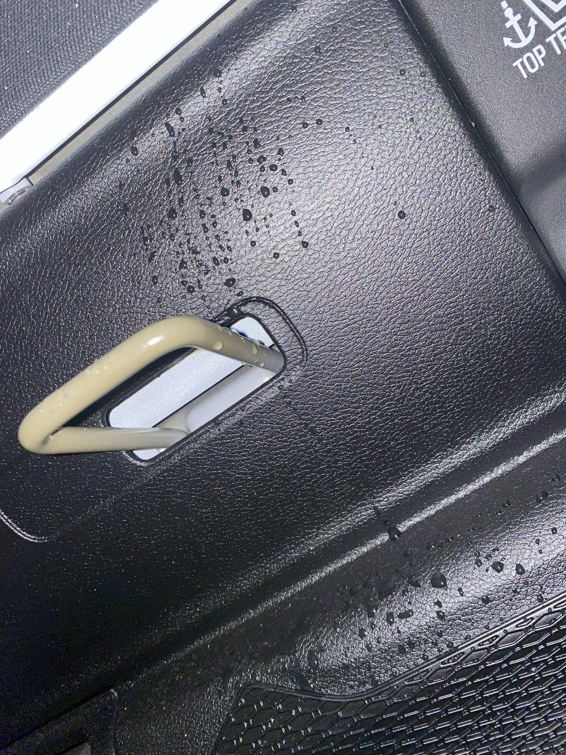

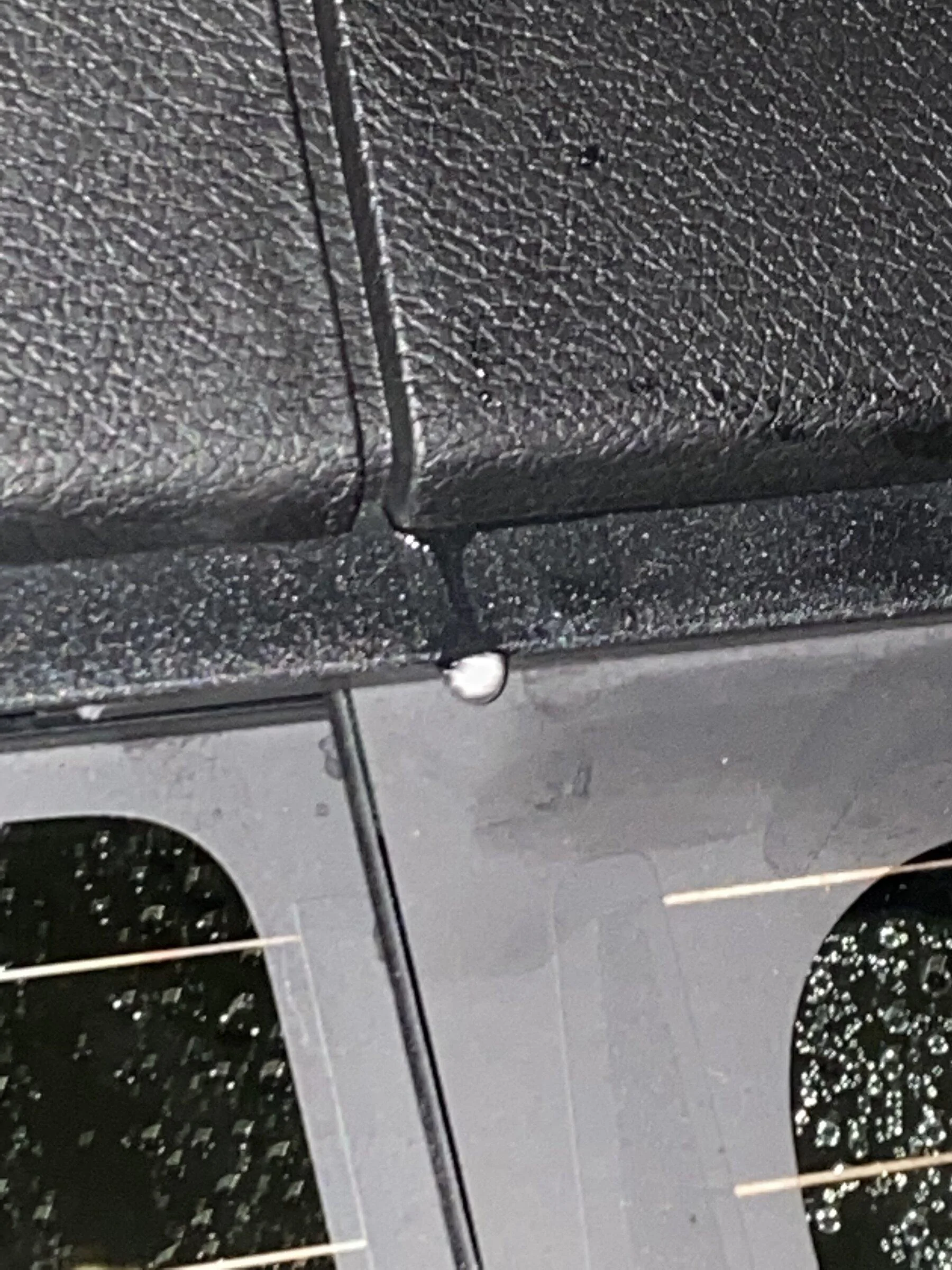

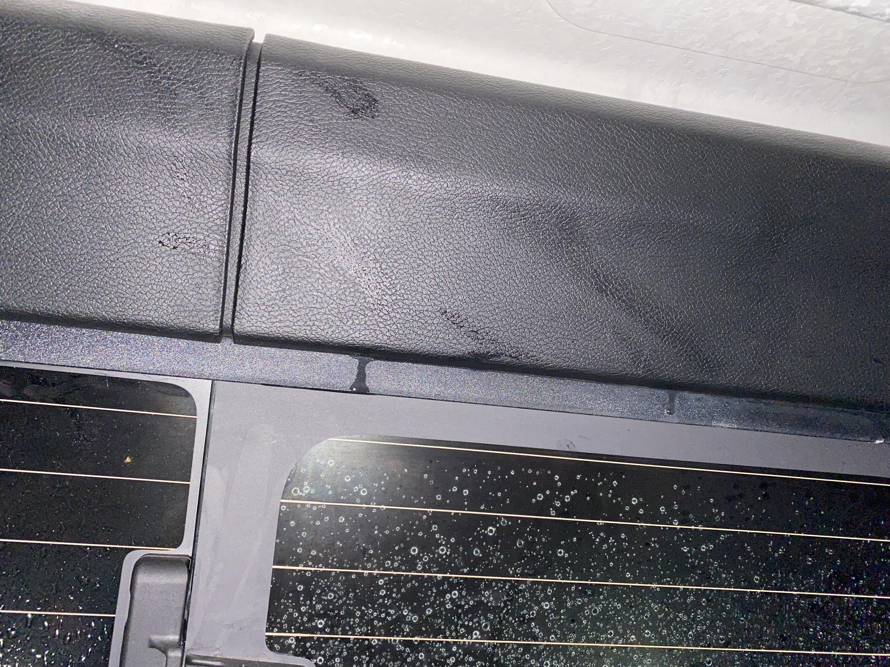

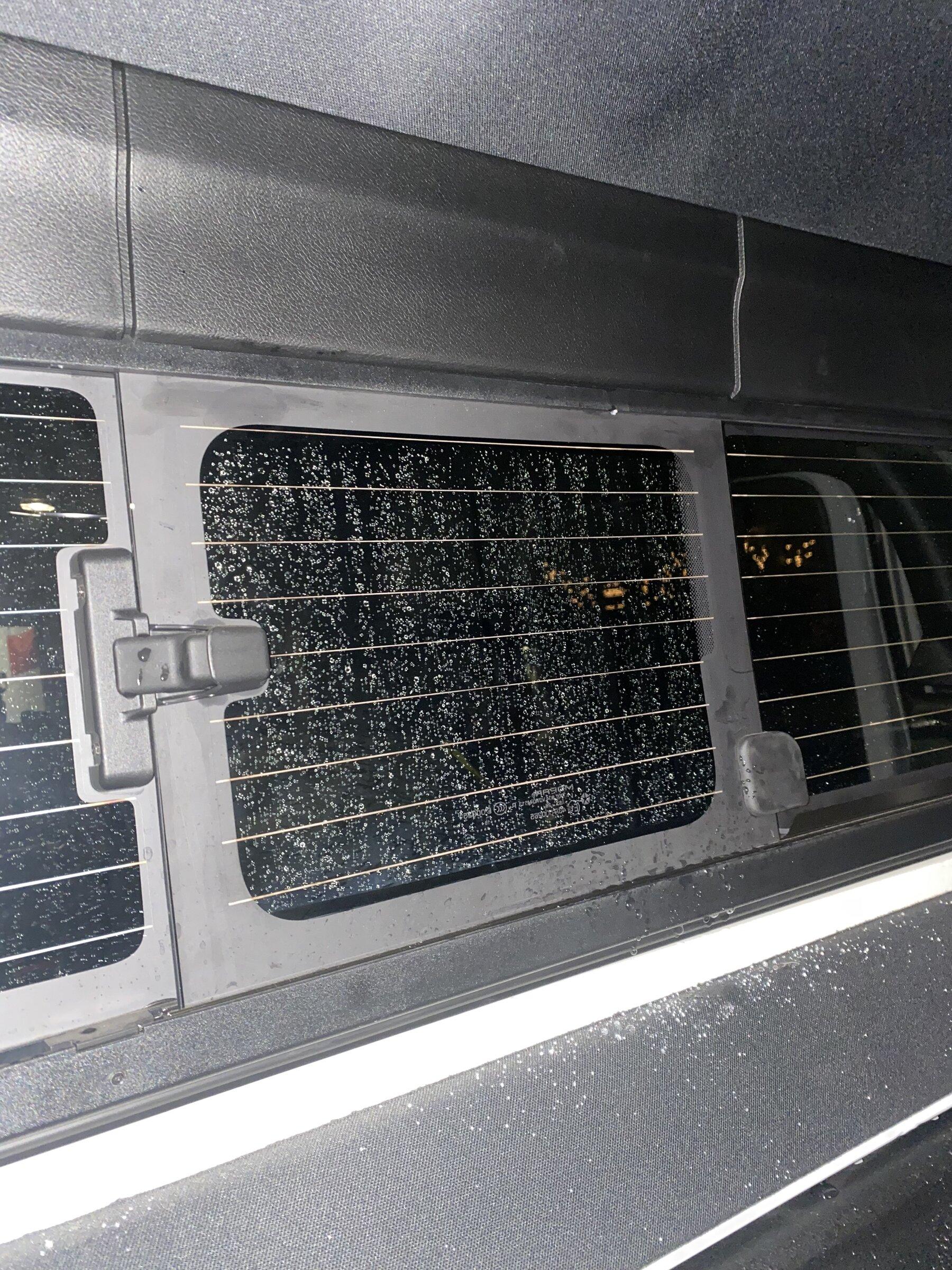

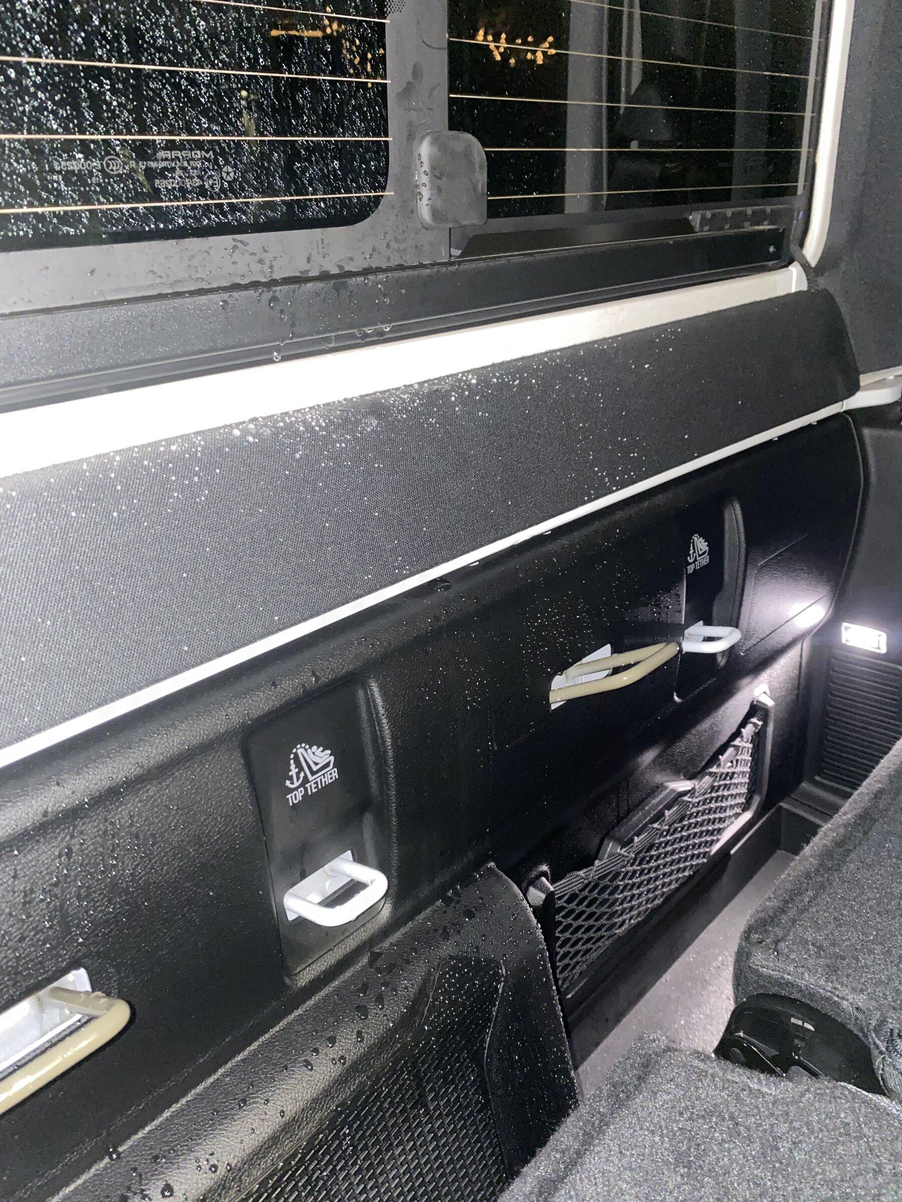

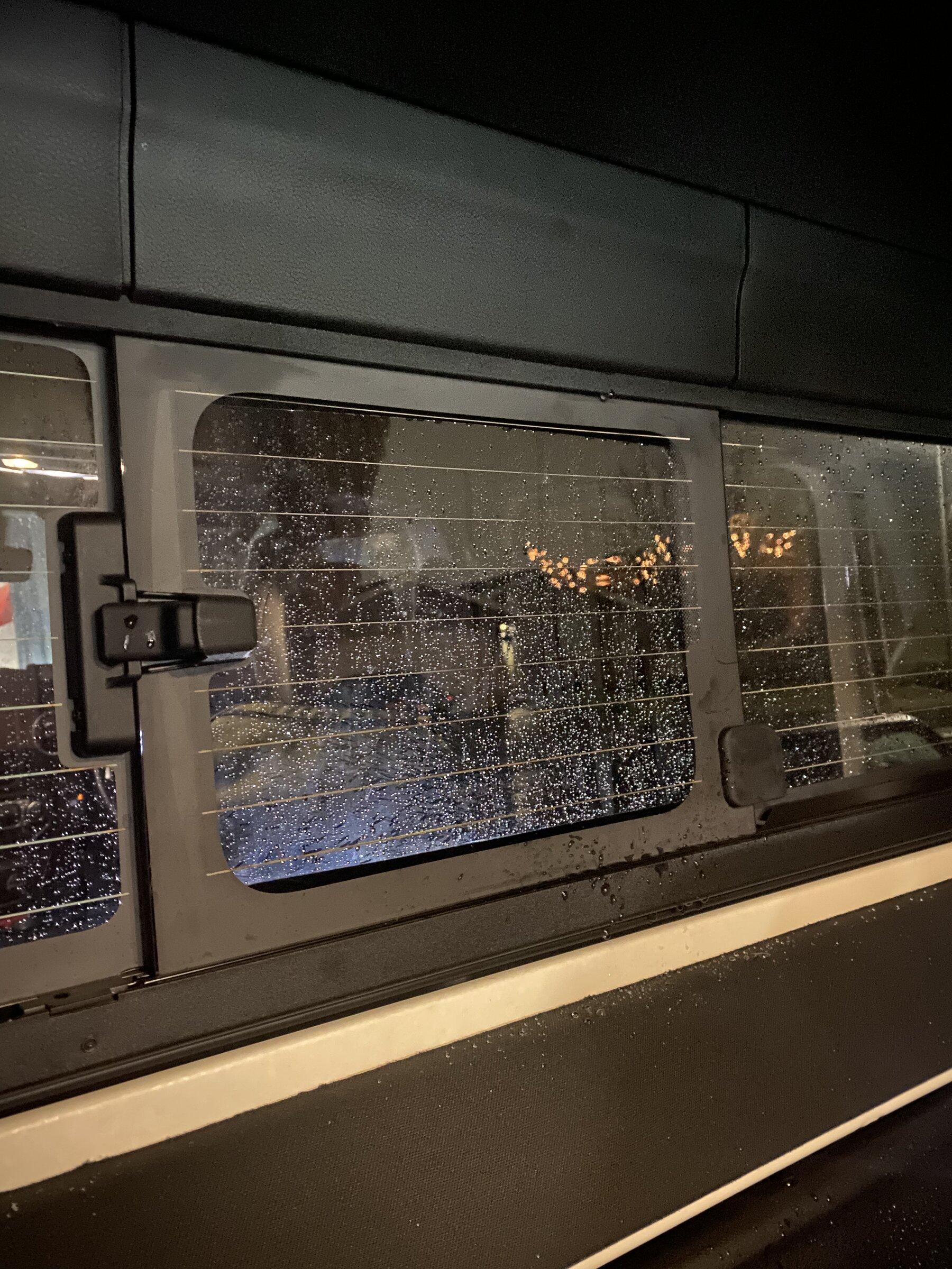

Mine was leaking enough for it to be a problem, I haven’t had a chance to take it in yet but the weather hasn’t been bad

Update: Jeep fixed it under warranty, the interesting part is they replaced the whole back window it wasn't the seals.

That’s what they did for mine, too. But the original warranty fix was to remove and reseal, but according to the glass guy there is a 50/50 chance of them breaking when removed. Mine broke, so I got a new window assembly.

In the process of building my sub and amp rack behind the seats, went out to check a fitment and there was a puddle of water on the floor and a jacket soaked. Never noticed it before. One more thing for the dealer to look at in a few weeks.

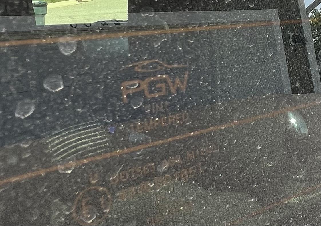

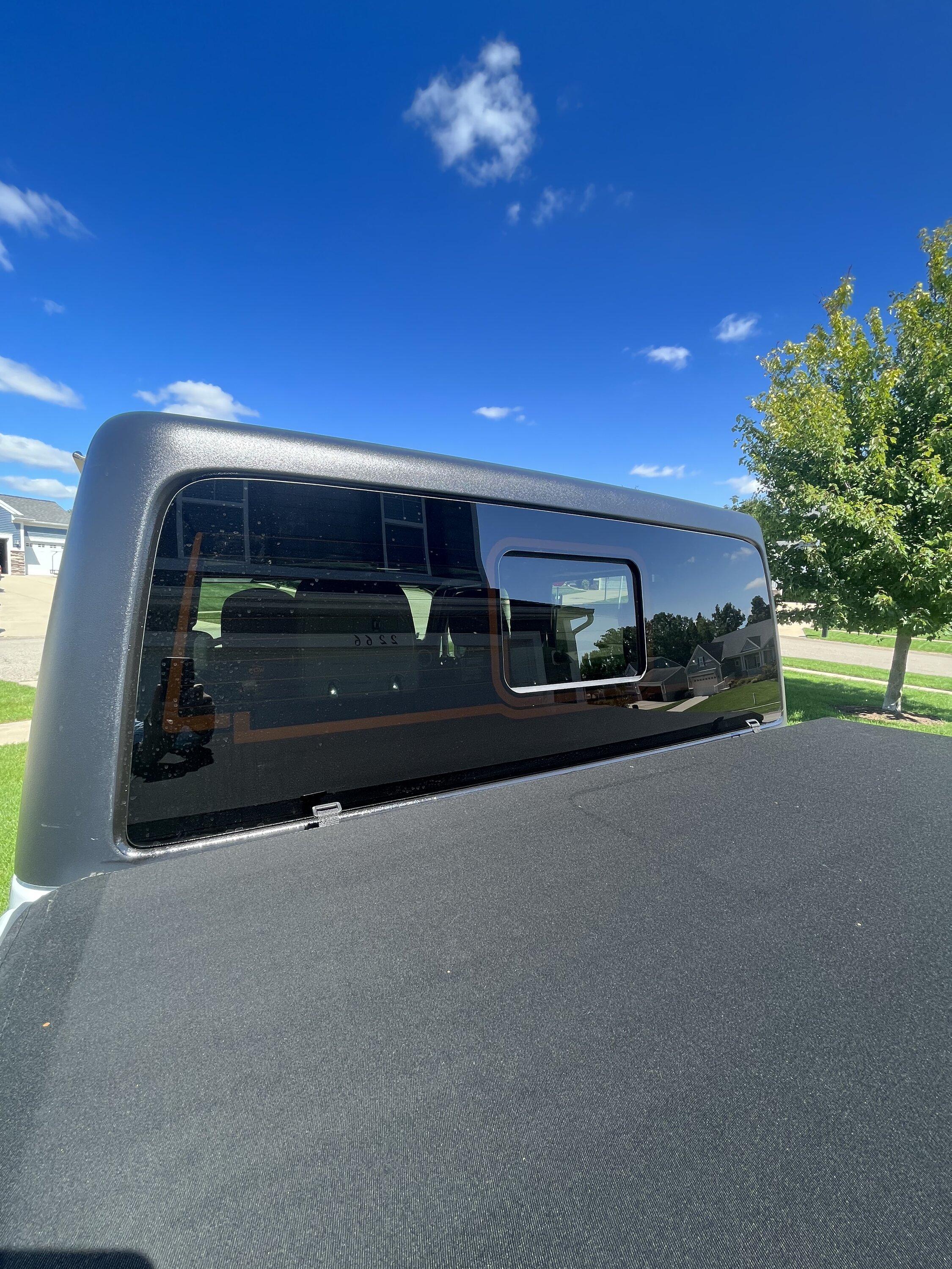

If you had your back window replaced did you get a Mopar factory window? The dealer replaced mine under warranty but when I picked it up I found an aftermarket window. I am not a fan of the orange lines. The logo is PGW.
Mine was a factory window
Ugh…. I went back and complained and they ordered another window. I’m waiting to see what arrives.

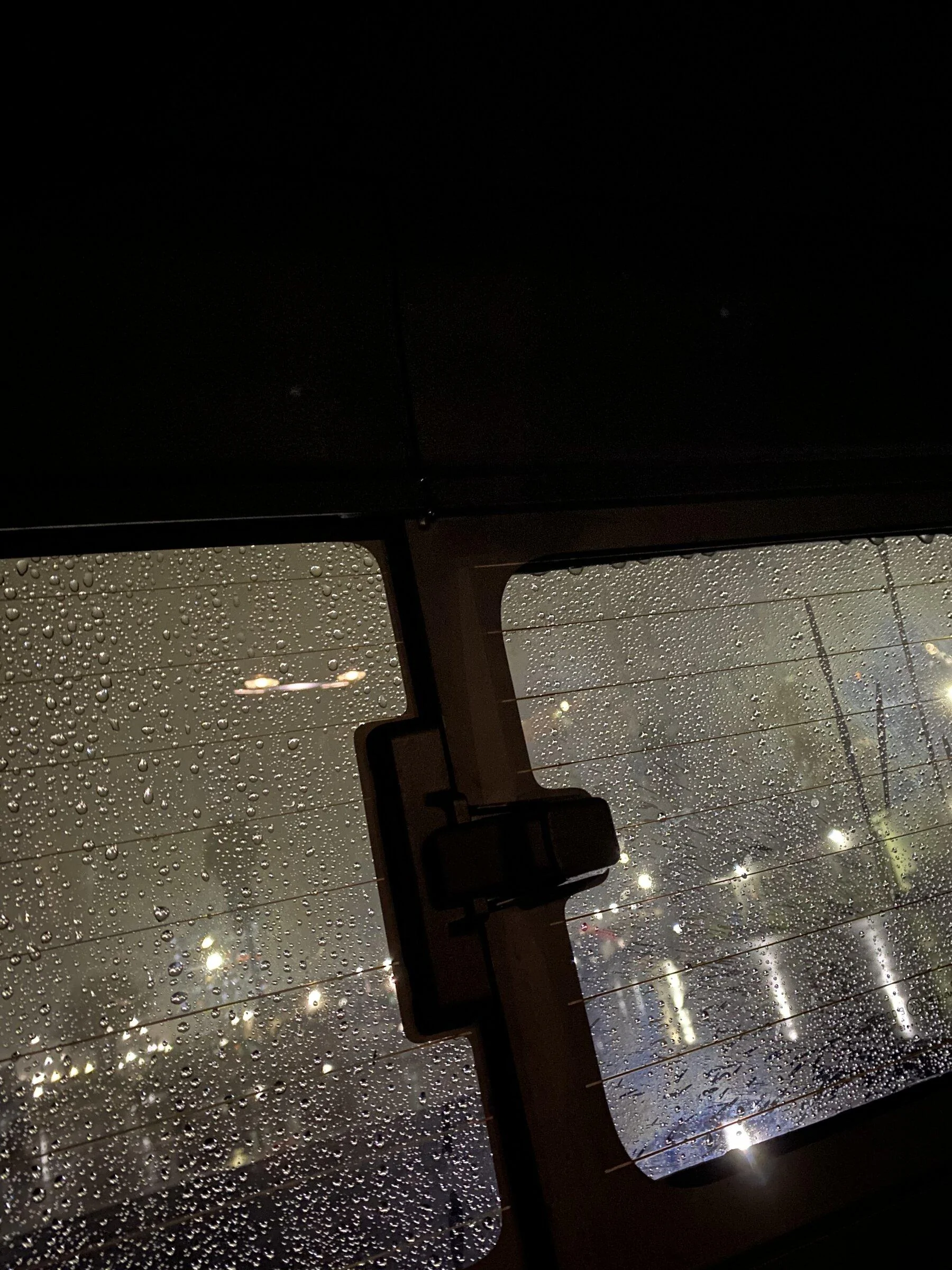

44K miles, my rear window (with slider) is now leaking. I stuffed in a towel to catch the water and occasionally wring it out. Works okay as a temporary fix but humidity in the cab is still more than normal.
I hold no grudges against Jeep for this issue. Vehicles have issues just like software has bugs, and we address them as we go, either via warranty or DIY fixes.
Thinking of DIY fixes to avoid dealer delays and "hit or miss" aftermarket windows.
Option 1 is a full length visor installed across the top. Not sure where I'd find such a thing.
Option 2 is a readily available "window length" visor at the top of the rear sliding window. However, not sure where the leak is entering - might not be directly above the slider.
Option 3 is applying silicon seal into the channel all around the rear window. I like this idea. Has anyone tried it? Only caveat is I don't know if the leak is coming from the entire window channel, or from just the channel around the tiny rear sliding window itself. Any ideas? I'd guess it's from the full rear window.
Going to try the silicon seal approach, but not until after this evening's crazy wind-whipped rain blows through, with predicted wind gusts up to 60 mph. In the meantime, I covered the entire window channel with blue painters tape.
The leak is in the seam at the top center between the glass and the roof. My dealer had their glass guy try to pull it some, re-seal and test, still leaked. They needed to replace the whole thing. Been fine since.

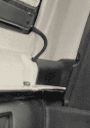

I had mine fixed last summer while it was still under warranty. It was a complete rear window replacement. 6 months later I had the first time attempt to use the rear window defroster, and it didn't work. Contemplated taking it in to the dealer (now out of warranty), but a buddy started looking:
On each side of the window at the bottom there is a wire connecting to the defroster. The window has a stud (like a snap), and the connector snaps on to that. On the passenger side, the wire was disconnected, and the old snap from the old window was still in it. 2 seconds with the point of a knife popped the old snap out, and the wire connected to the new window. I now have a working rear window defroster.
Borderline criminal laziness on the dealer's mechanic, in my opinion.

The second back window was a Mopar window. All set now but irritated I had to do it twice.
