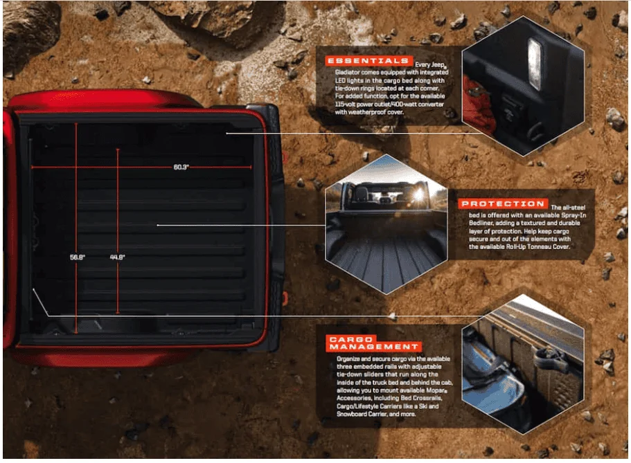

Jeep Gladiator Gladiator bed same Dims as other trucks? Wondering if used Truck Caps are out there & will fit 1677251062259
Here are more accurate bed dimensions. I think Tacoma Double Cab beds are close in size but not sure if they fit.
