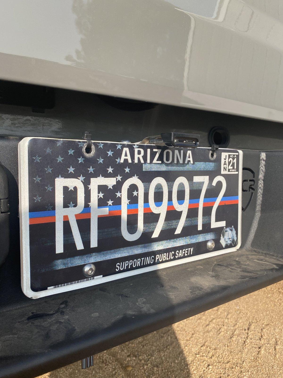

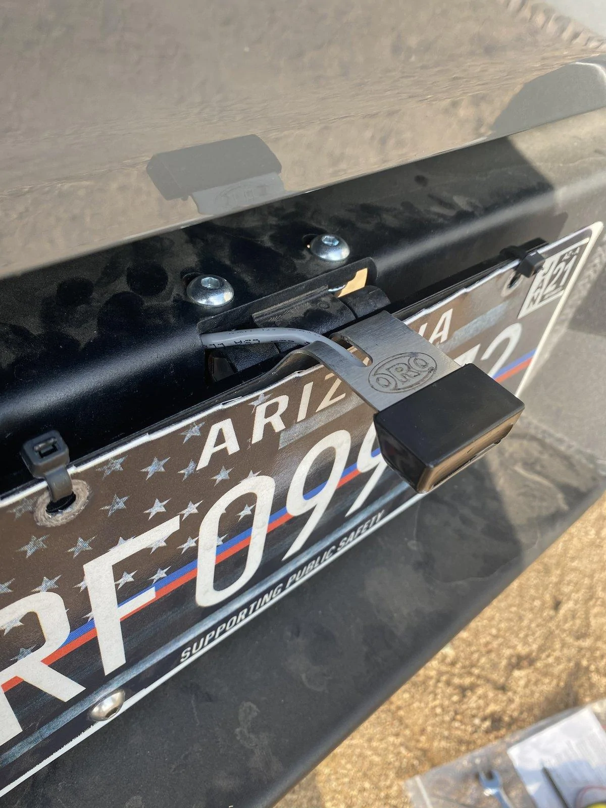

If any of you guys are disappointed with the license plate light solution like I am, I found this awesome replacement from Offroad Only. @JcrOffroad , I urge you took look into revising the license plate light something like this. The adhesive on my DOA license plate light failed after 2 days. I left it on the bumper even though the light didn’t work just to see if the adhesive would last
https://offroadonly.com/shop/led-li...late-led-light-with-6-disconnectable-harness/
Edit: Side note, I did have to modify the license plate bracket by removing the wing that sticks out where the adhesive light attaches

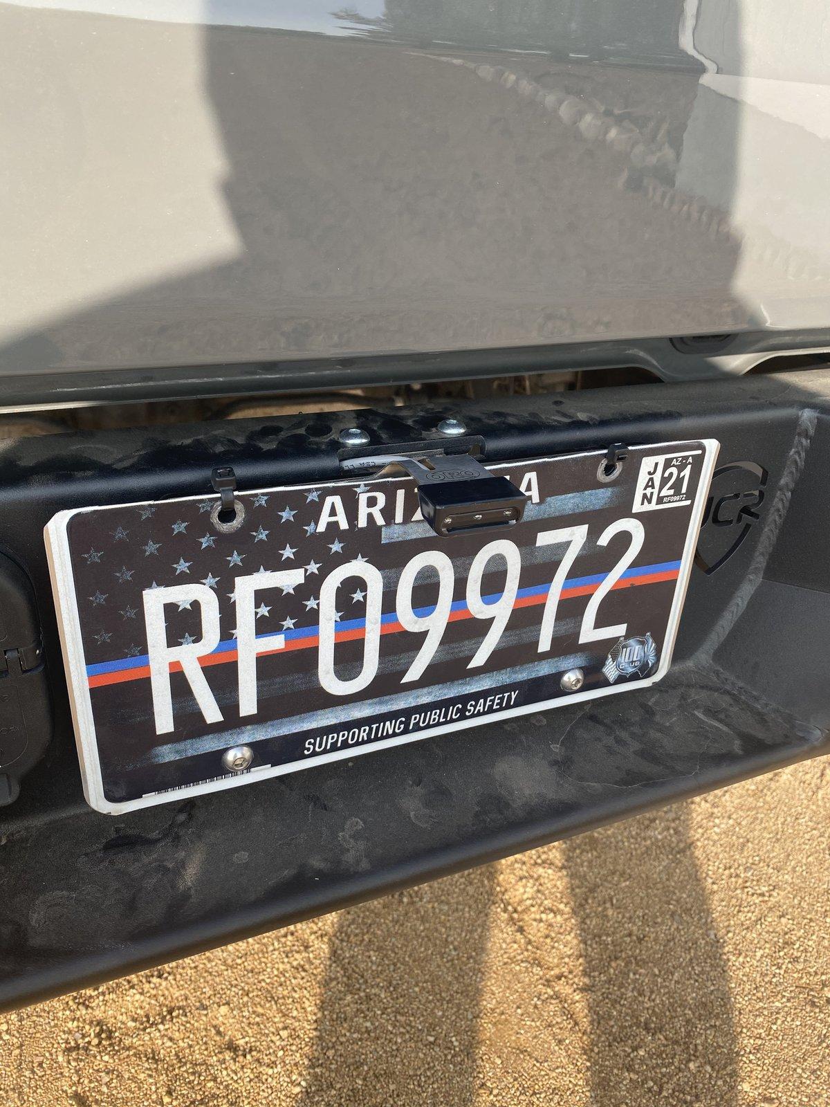

Finished product. The zip ties are temporary. The supplied hardware can’t be used on the top holes, otherwise they hit the bumper before the hinge is closed all the way. Also, the wing that was originally on the bracket was too low and I had to cut 1/4” off the top of my license plate to make it fit. With this light you wouldn’t have to do that

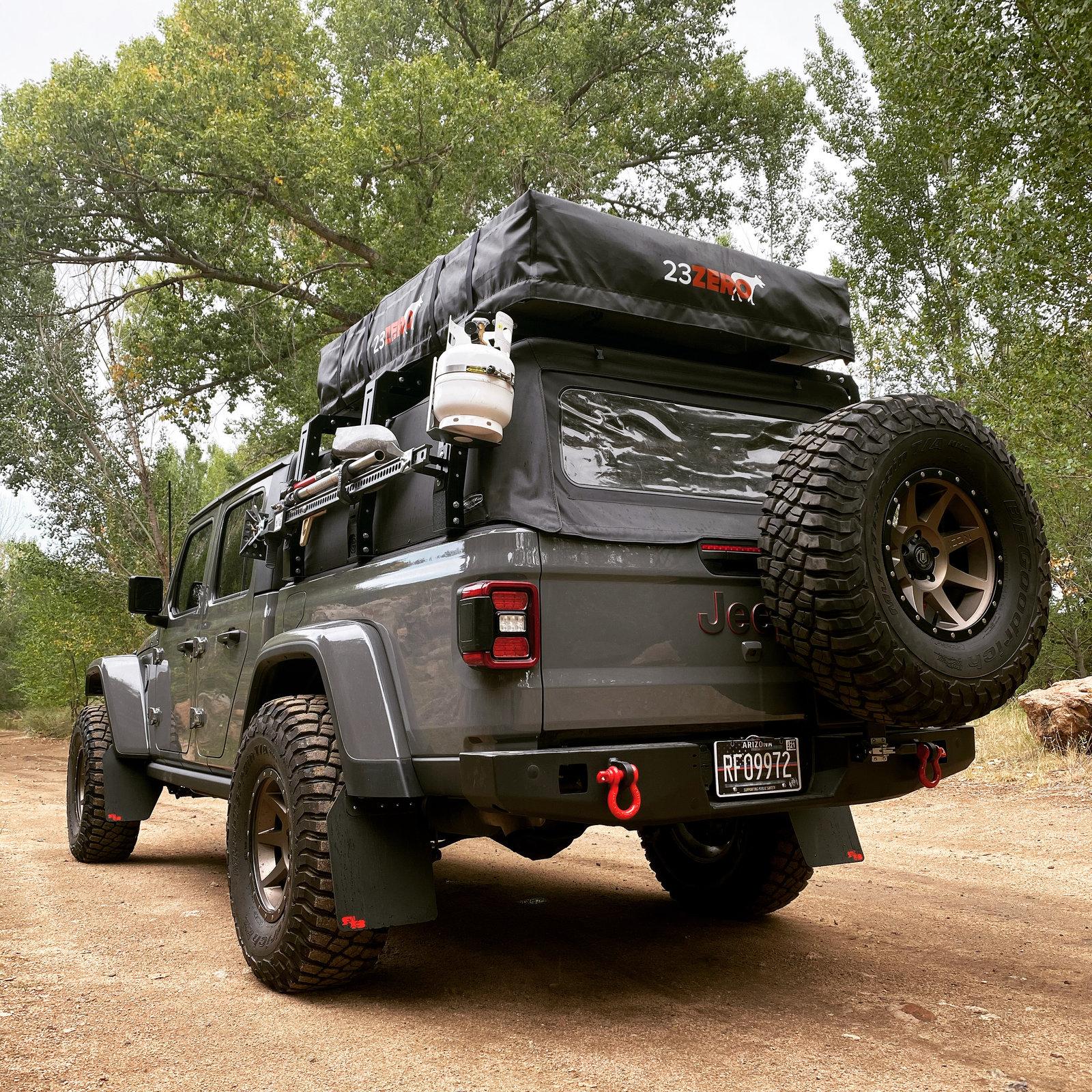

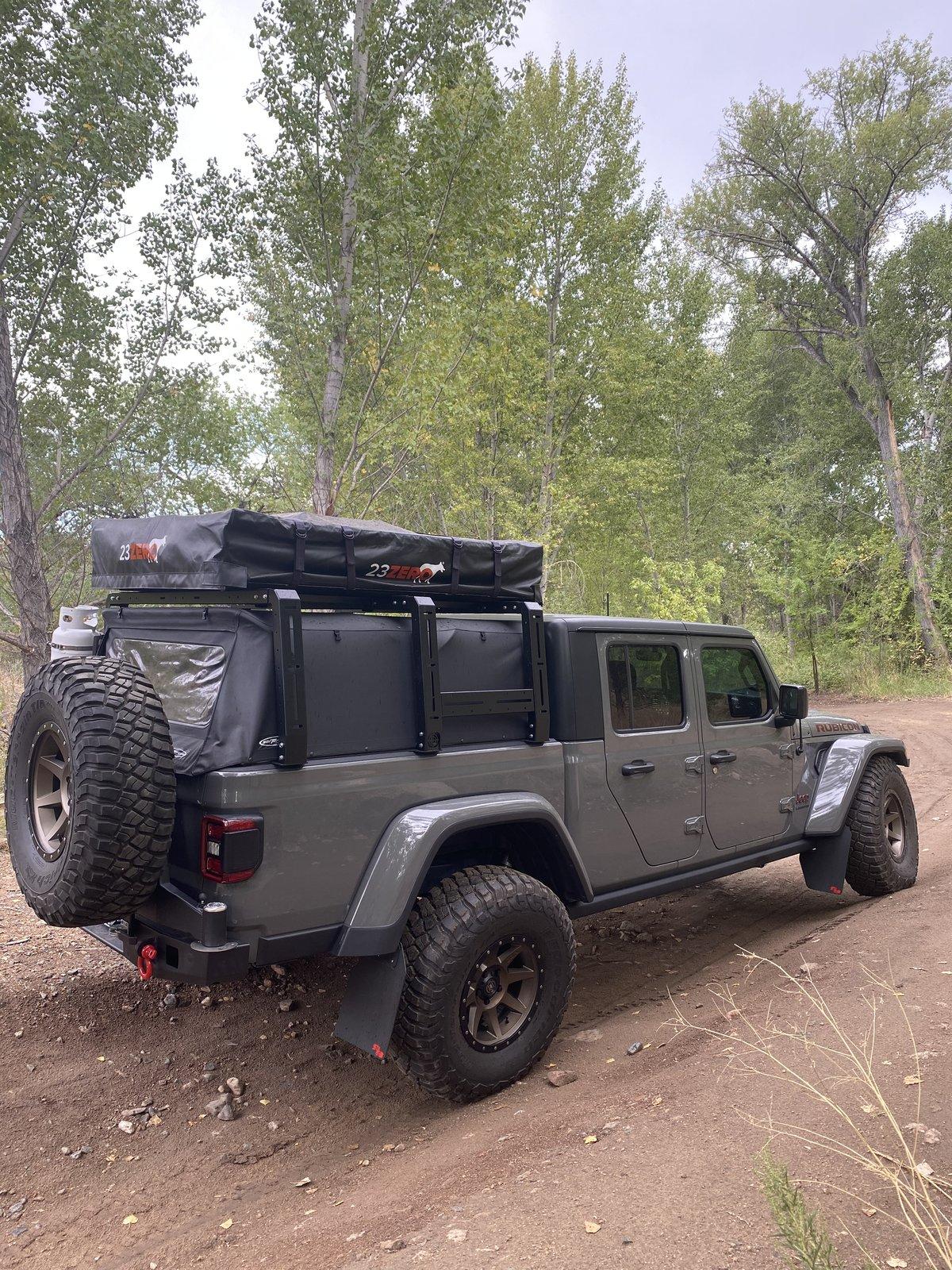

Thank you! Quick question while I have your attention. Is this normal? I feel like it isn’t/shouldn’t be. I see it wobble with every bump and I’m afraid over time that this will lead to cracked or failed welds/fatigued steel. I had to add it to YouTube as the forum tells me it’s too large to upload
That's not normal. Our JTs spare doesn't wiggle like that. Check the carrier attach point?
I think I improperly installed the spare. I need to move it closer to the carrier so the tire rests against it by 1/8th of an inch or so. I missed that in the install video
Ah yes. Measure the rear of the hub to the rear face of the tire. You then want to adjust the carrier length to slightly shorter than what you get, so when you tighten the lugnuts the tire is pressing tightly against the carrier. Hope that makes sense.
Got it all fixed today. The only movement I have now is a slight front to back movement throughout the entire swing arm when I really push on it
That is normal flex, no way for it to be totally rigid. Glad you got the tire tight against the carrier :like:
