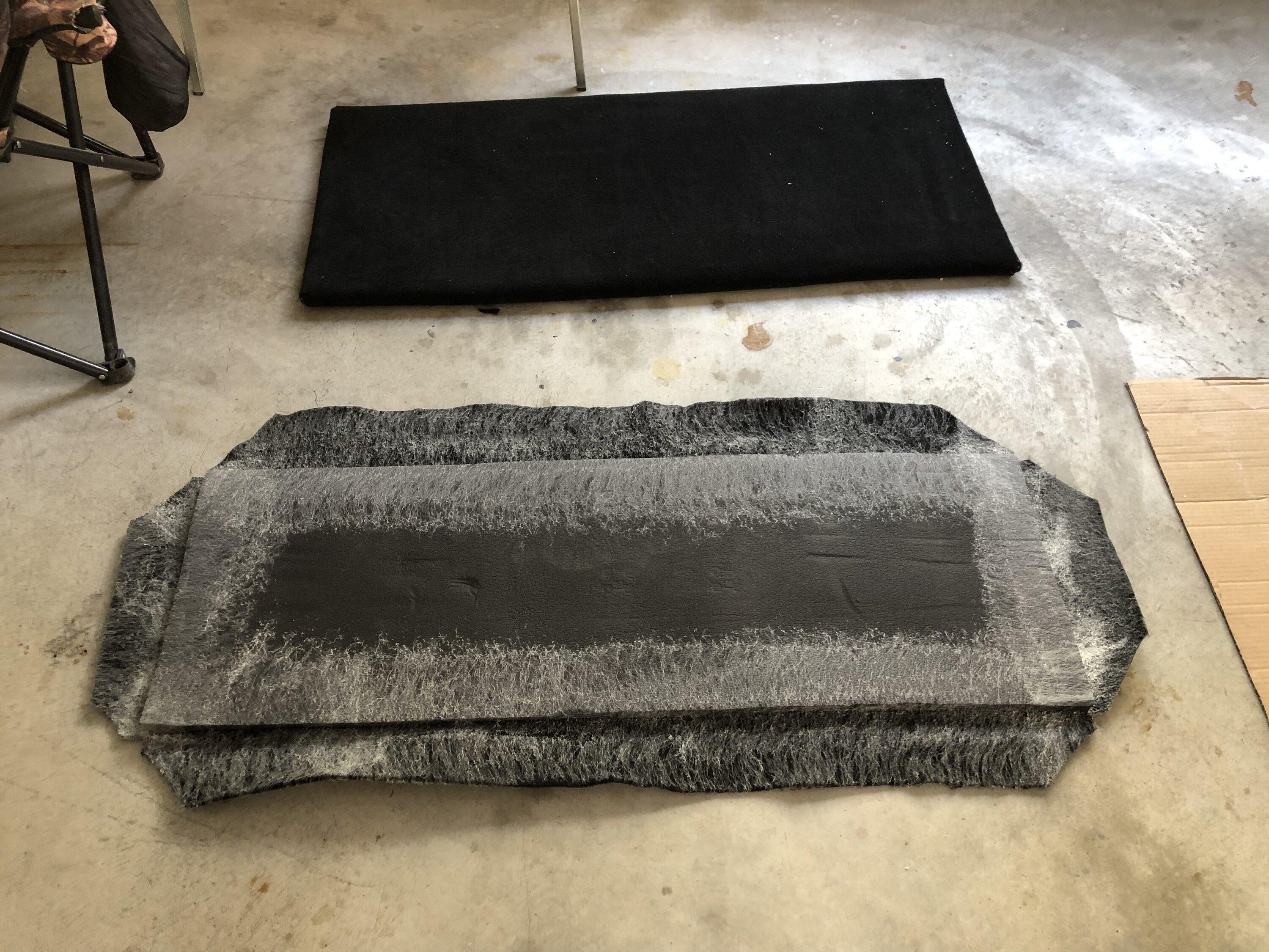

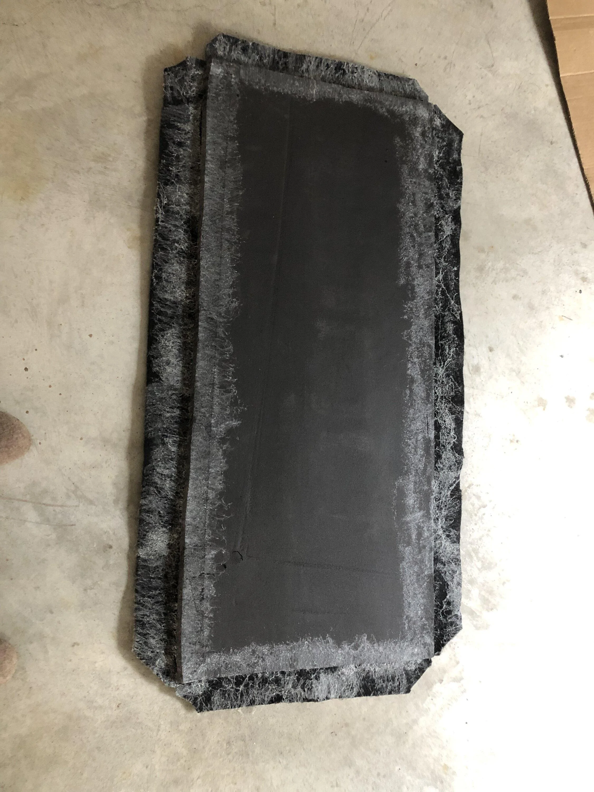

Next conversation is insulation/padding.

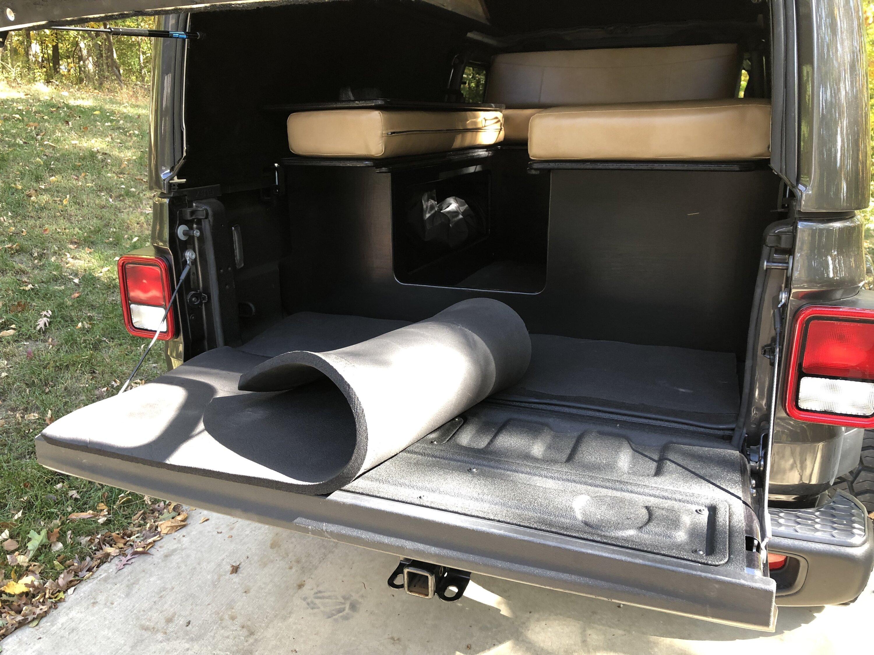

I figure I need two types of insulation. One for the top and one for the floor.
Here's my choice for the floor.
HVAV Duct Liner - It is elastomeric foam insulation used in HVAC equipment and other industries. It is designed for wet environments, is a great insulator, is anti microbial, and is flame and smoke retardant. Best of all, it's free since it was in the scrap bin at a HVAC company. It is very soft and nice to walk/crawl on. It comes in different thicknesses. I have a bunch of 1/2" and 1" thick. I also have some extra carpet left, so I will eventually glue the carpet to these pieces to make them last longer.
This pad on the tail gate is a life saver. The truck's spray on bed liner is brutal on my knees, and this padding feels incredible.
You could also use a Bed Rug, but I'm cheap and like DIY projects.

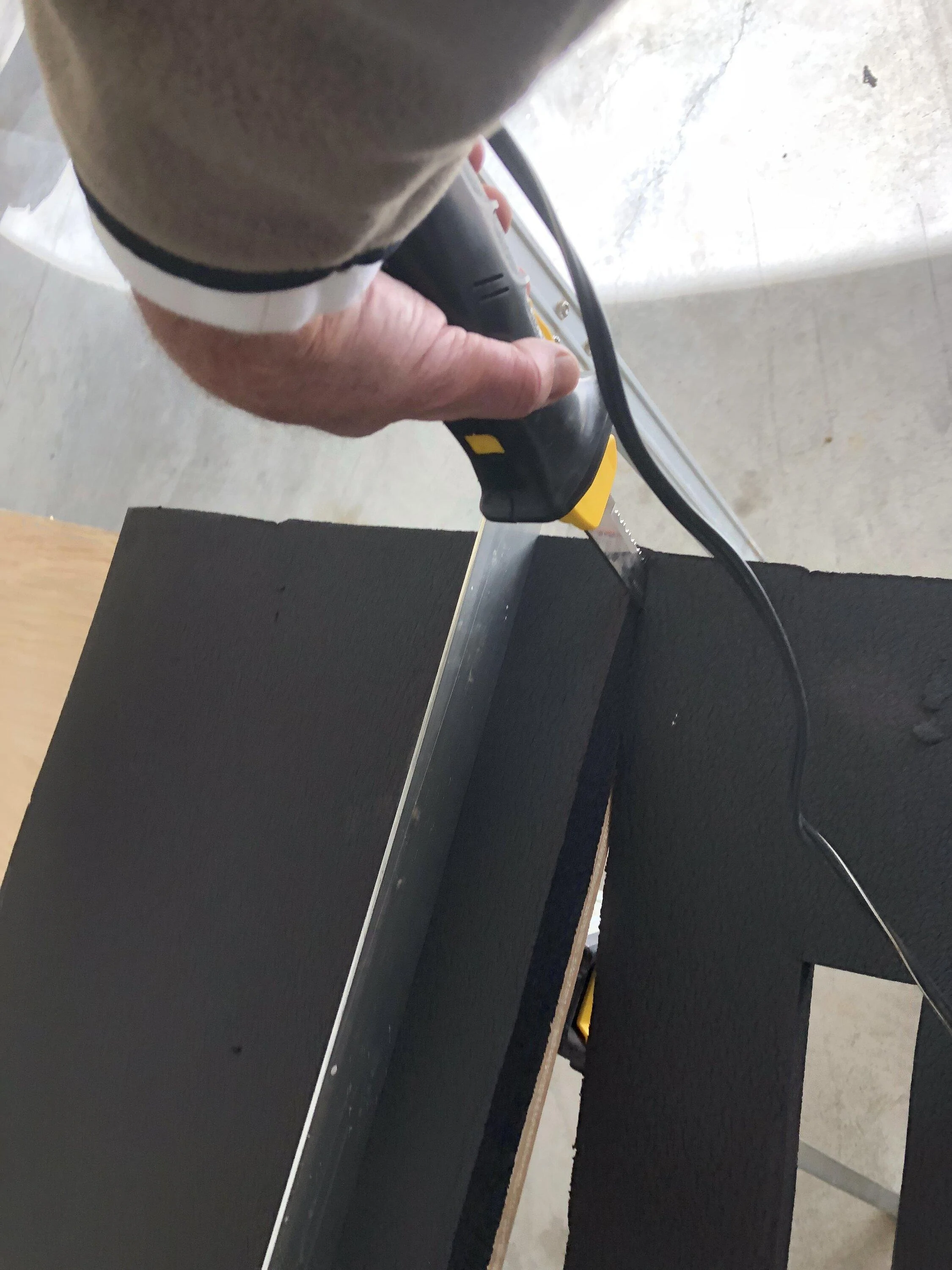

And here's a trick. Skip the razor knife and use your electric fillet knife. Cuts like butter.

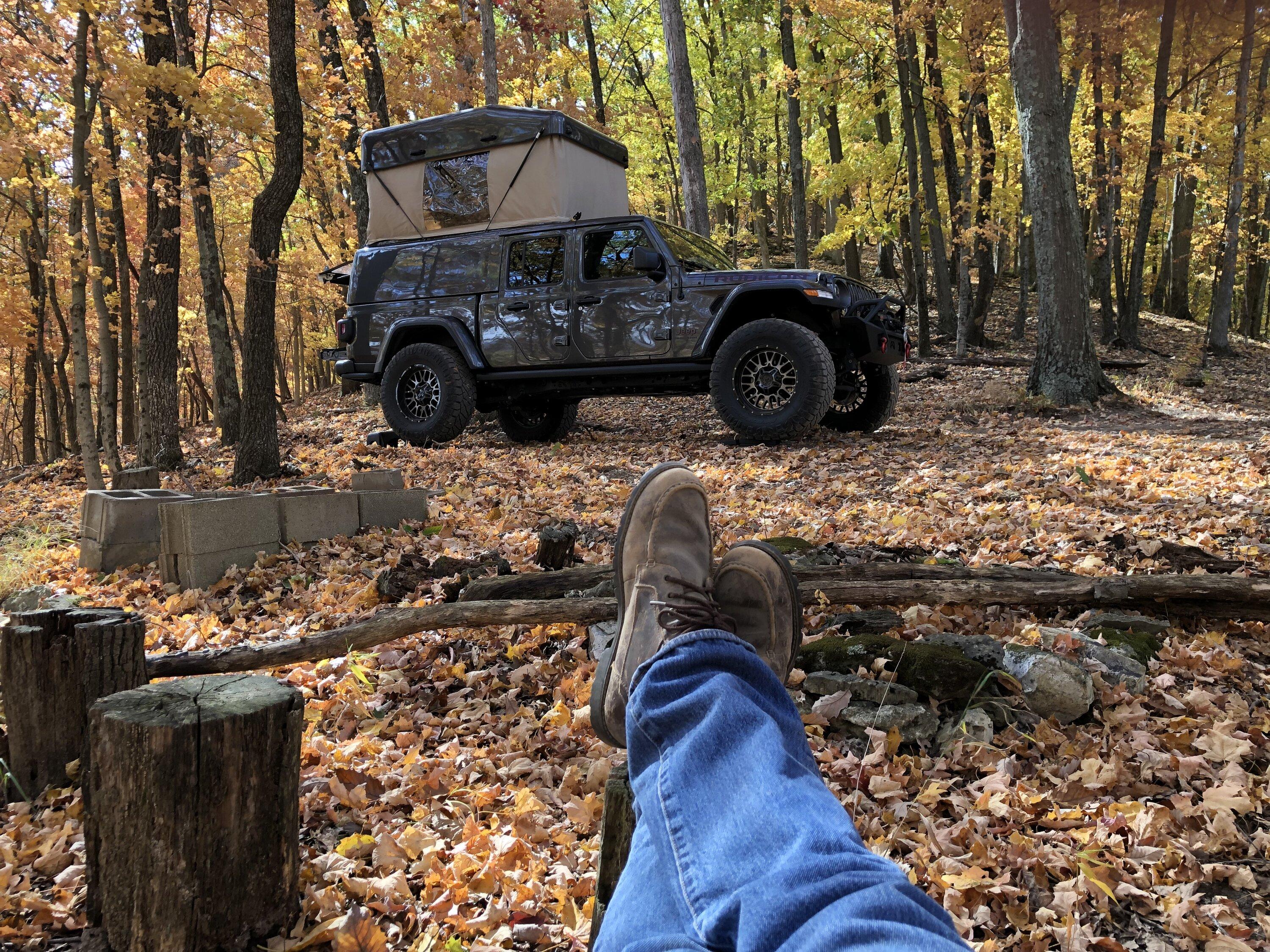

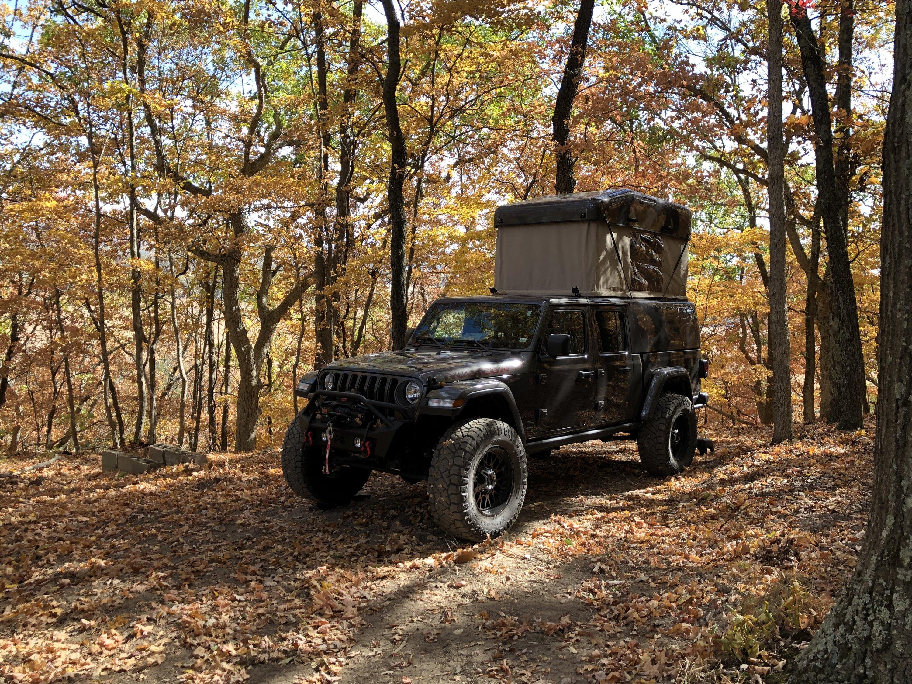

Beautiful weekend for the woods. Didn’t get cold enough for heat last night.
The black foam insulation. We use it at the power plant to insulate pipe. The insulators use electric knifes to cut it. Good stuff. I got some of it at home that I use as a knee cushion.
I call this camp site "Sugar Bush". Here's a video of my son and friend boiling maple syrup here a few years back.

Always loved the size, low profile hard shell, ability to leave bed made with pillows, ladder also fits under the mattress, ease of the open and close a hard shell offers (under 1 min. Open and 2 min close) and the straight room up vs the triangle open style most hard shells offer, open 360* view. Lots of room in this tent (The EVO XXL). My girlfriend appreciates the cassette potty in the RTT as well ?.
I am moving it forward on the bed rack to match rear closed tailgate. Unlike most on here, I do wish the bed was 24”es longer.
We have camped in the James barroud during 25-30 nights with and without a heat pad. The memor foam mattress did fine but the days were in the 40s
agree about the quick up/down with everything inside already. That is key with any weather

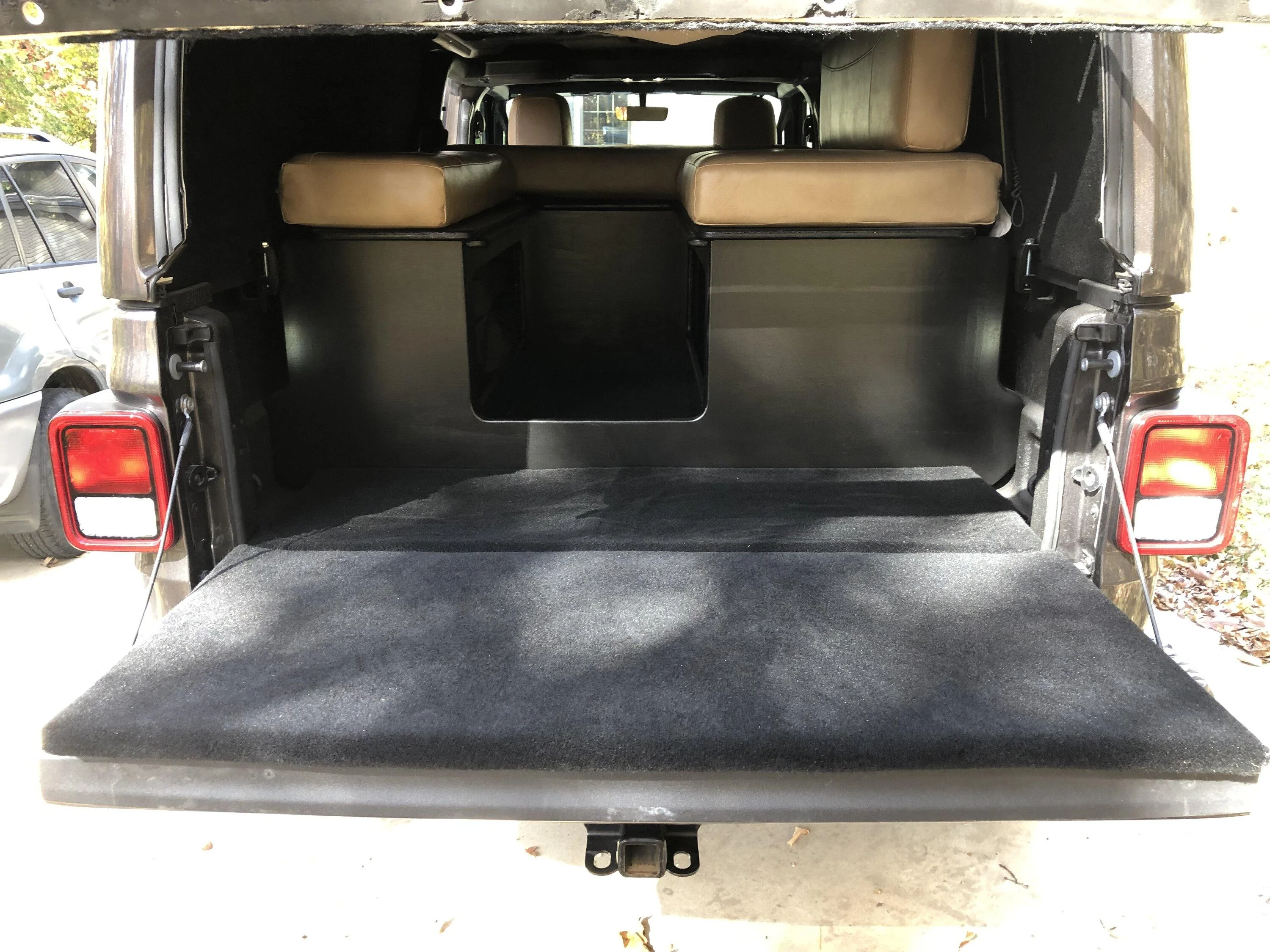

I glued some leftover carpet to the foam for floor mats. This should make the sponge rubber last longer.

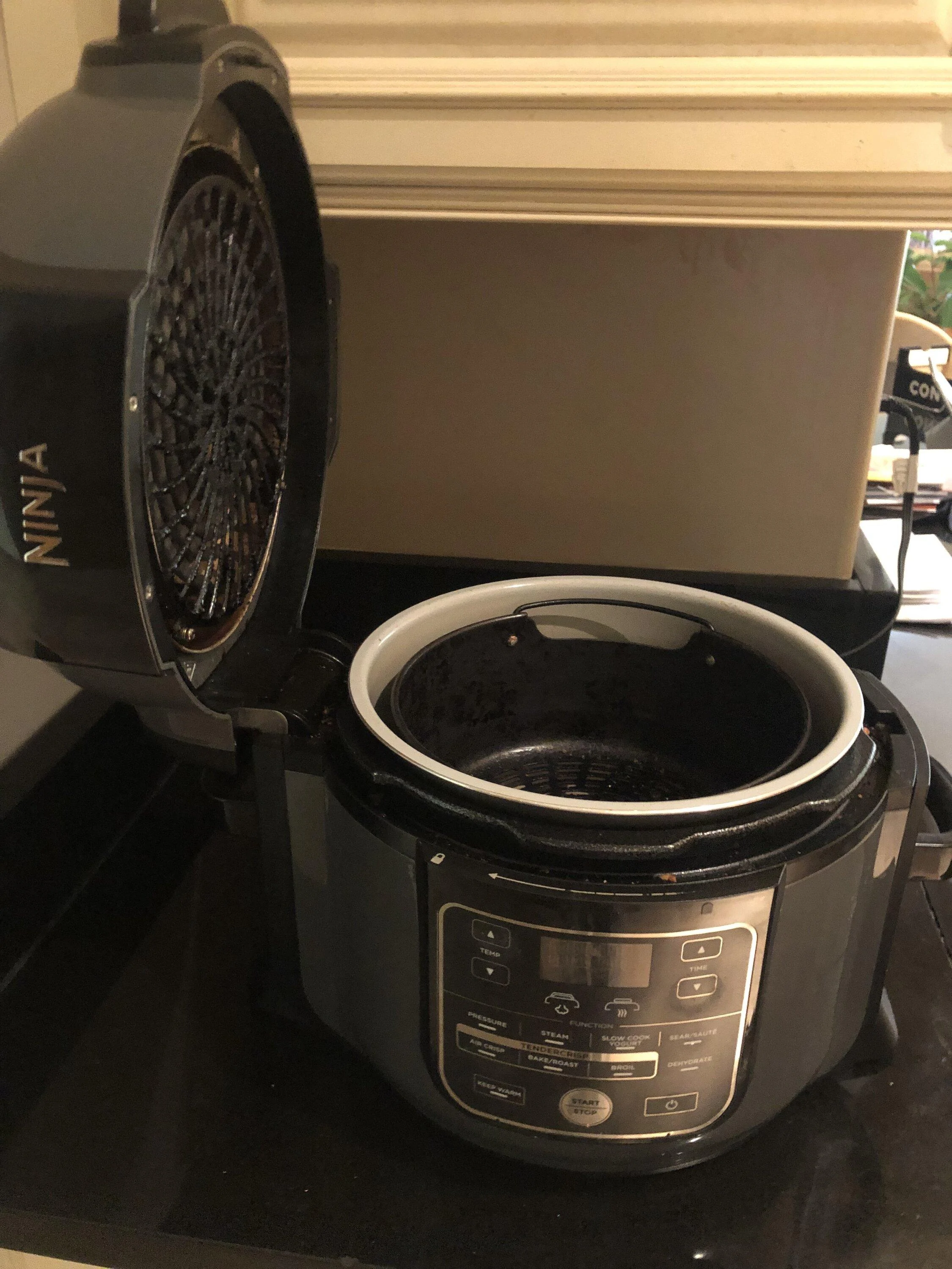

Having 3000 watts of continuous power opens up new possibilities. Maybe I'll find a small air fryer. My home air fryer is a Ninja which does everything, air frying, backing, pressure cooking, slow cooking, searing, etc.
Foresty Forest, a YT'er in a mini-van and then a Quiggly full-time in Canada does some great recipes with his Ninja, and a crockpot before that. Sometimes puts my cooking to shame and he's doing it after 15 hour days in the mountains.

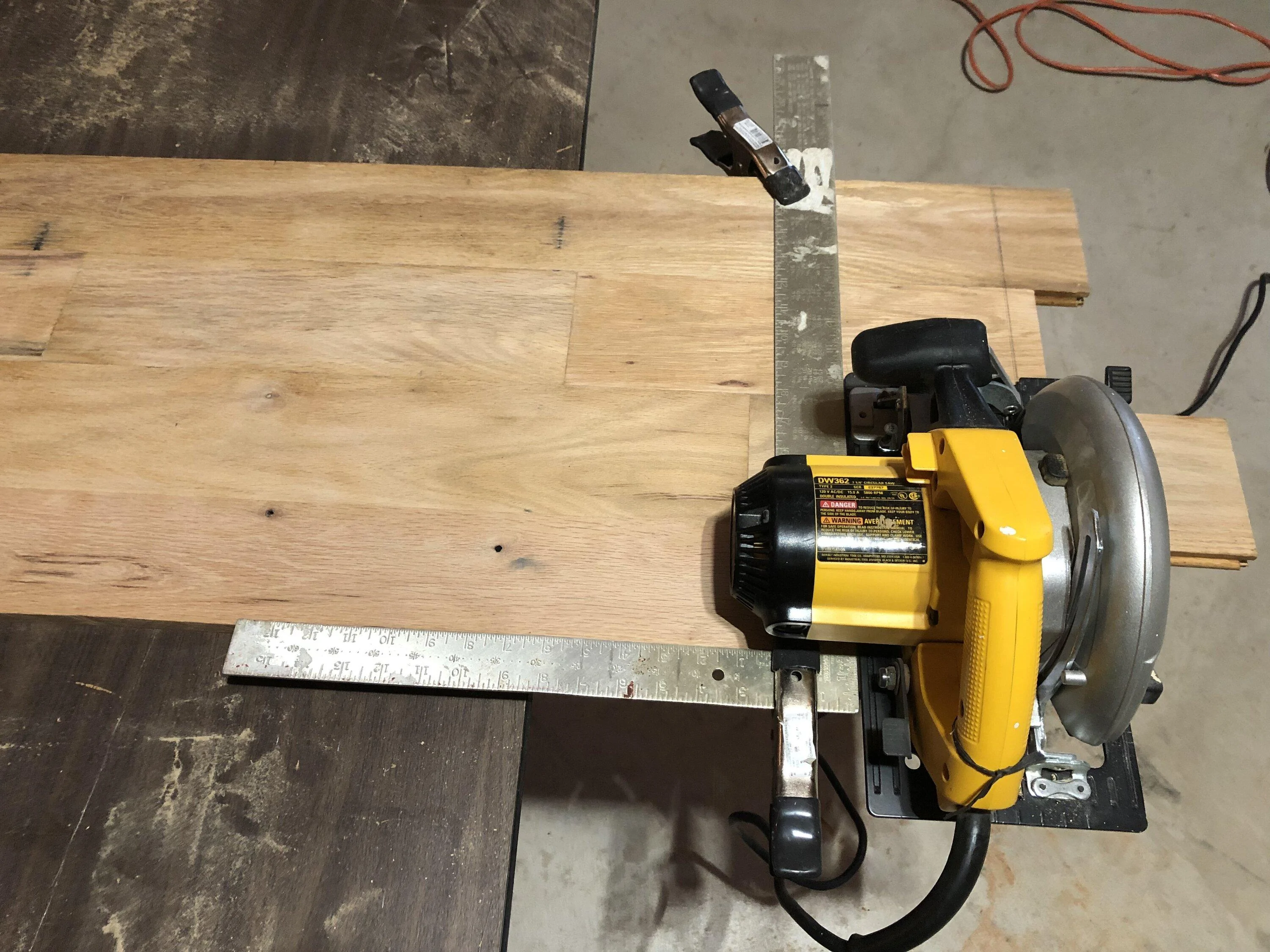

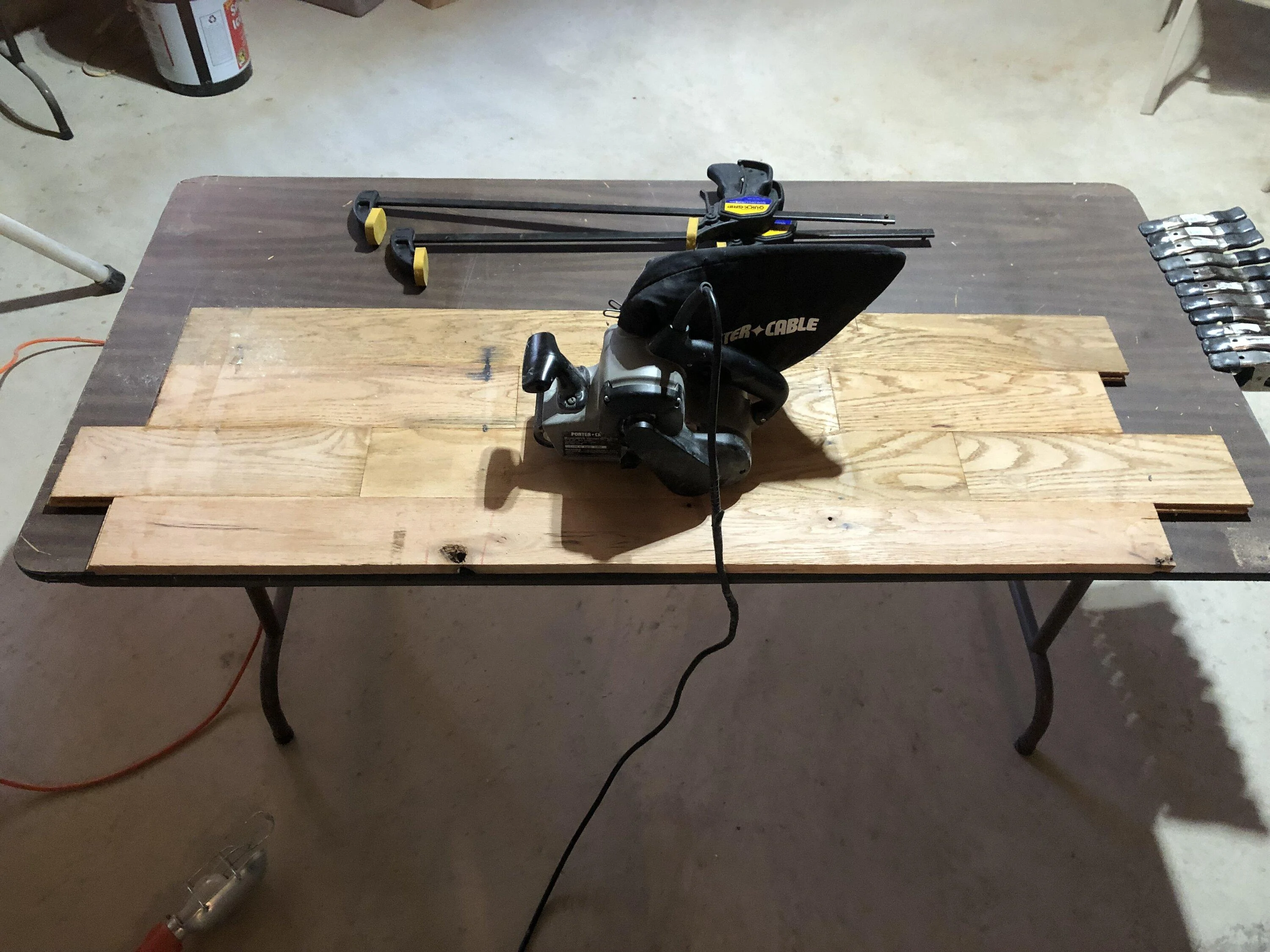

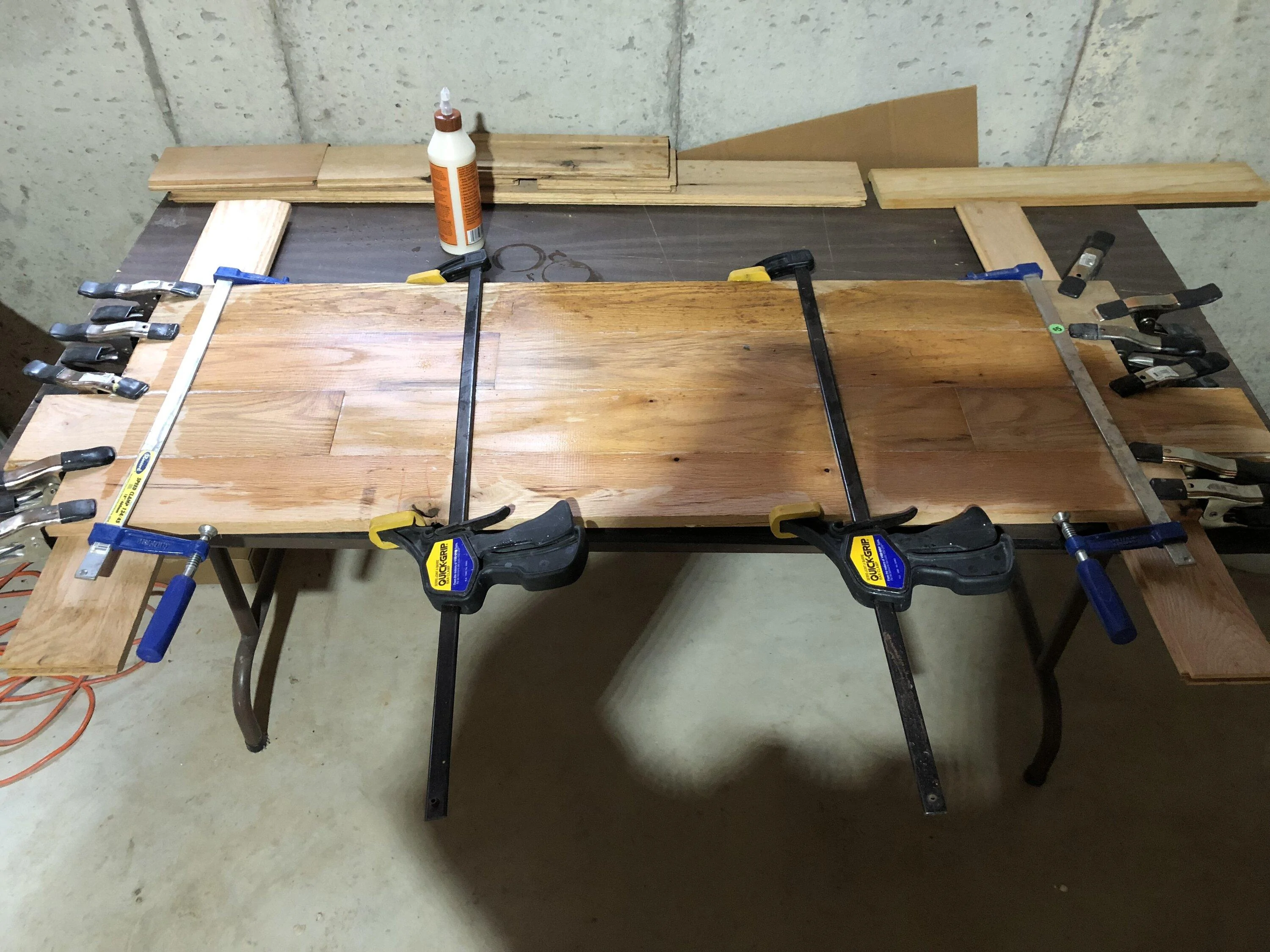

I like the look of a butcher block counter for the camper's kitchen, but It's hard to find the right size, and getting a large piece is pretty expensive. I decided to try building the counter out of some left over oak flooring I had. I'm glueing together some pieces and will cut to size later.

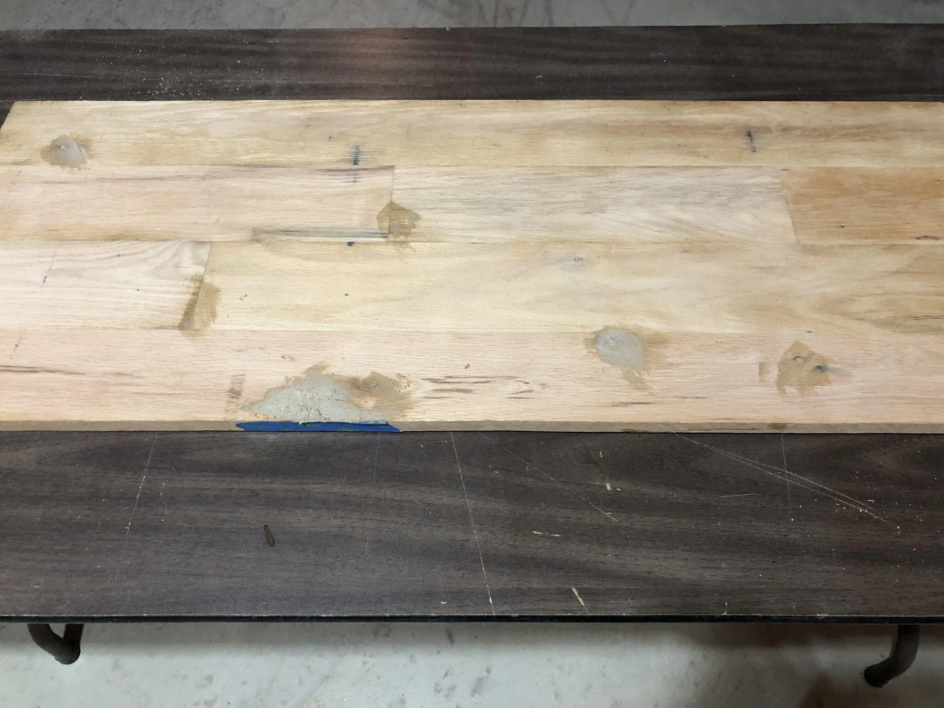

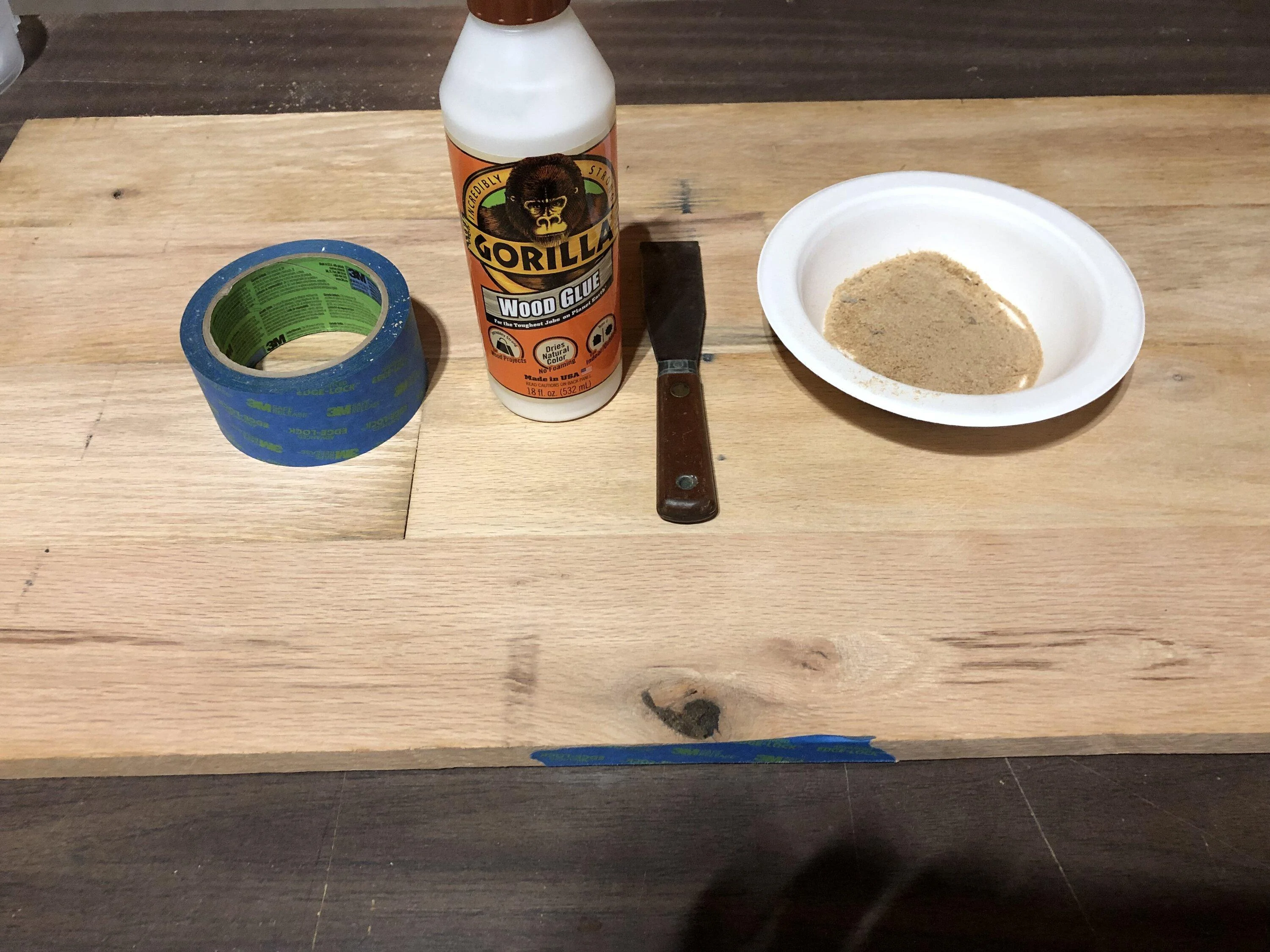

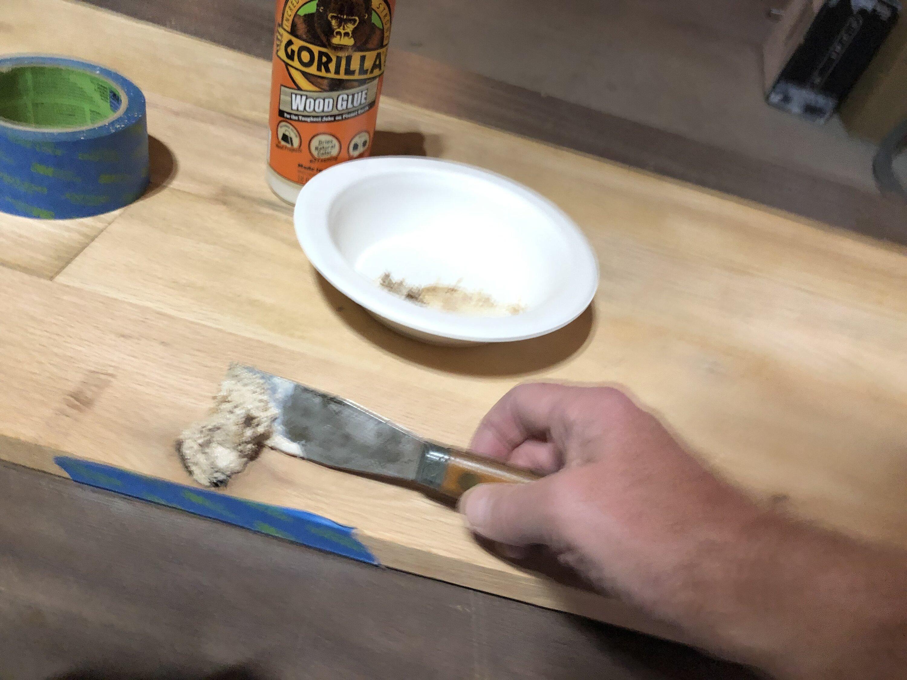

Turning my oak flooring into a camper counter top. I’m using sawdust mixed with glue to fill the holes.
