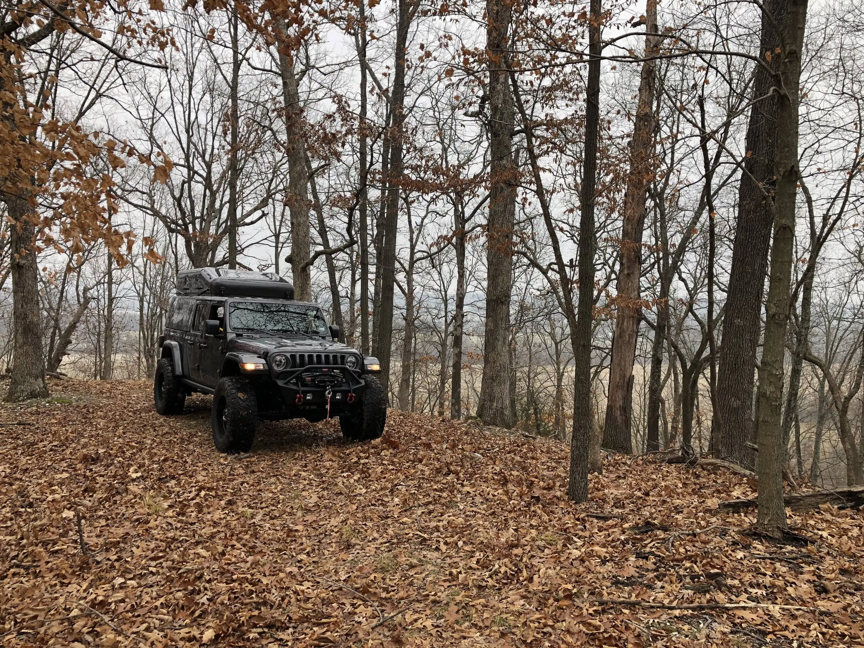

I have some scratches from the last time in the woods. This time I brought an extension for my limb saw. This rig is tall!
Ya I just know going in that any true off-road vehicle is going to get scratched to hell and back. I just let it happen lol. One reason the Cybertruck interested me... paintless stainless-steel would be amazing in that regard. But then again it's a "full size" pickup type vehicle that wouldn't even fit down a lot of trails.

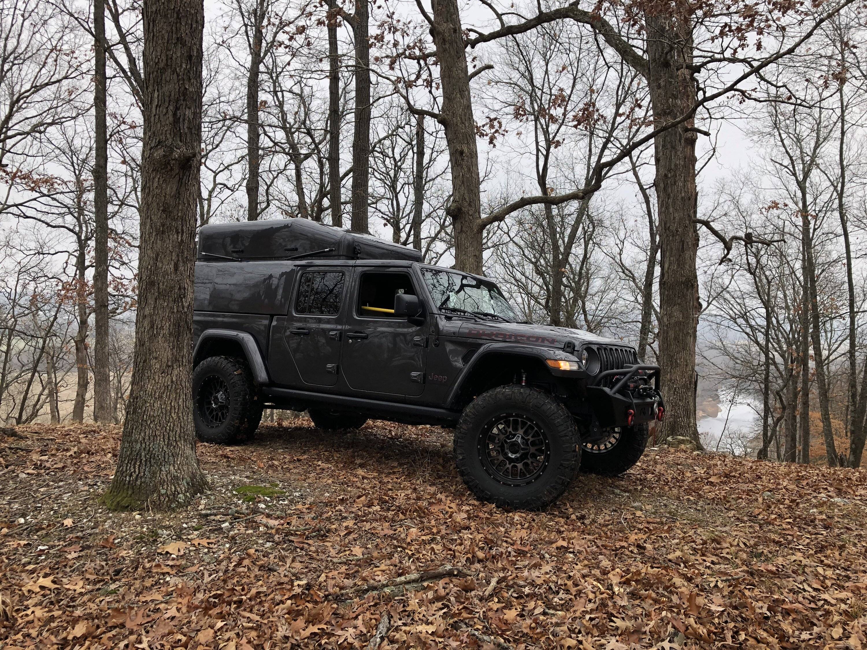

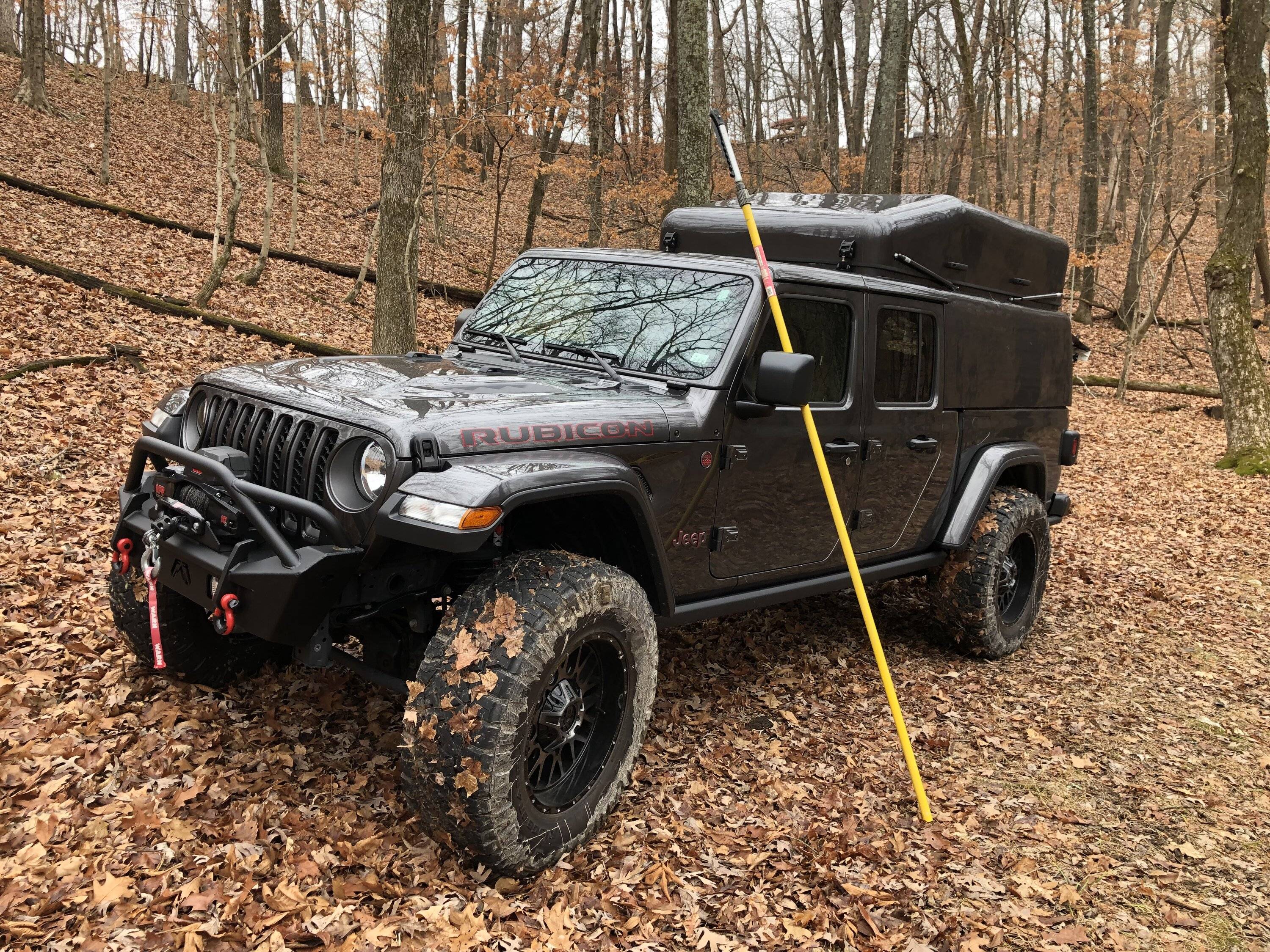

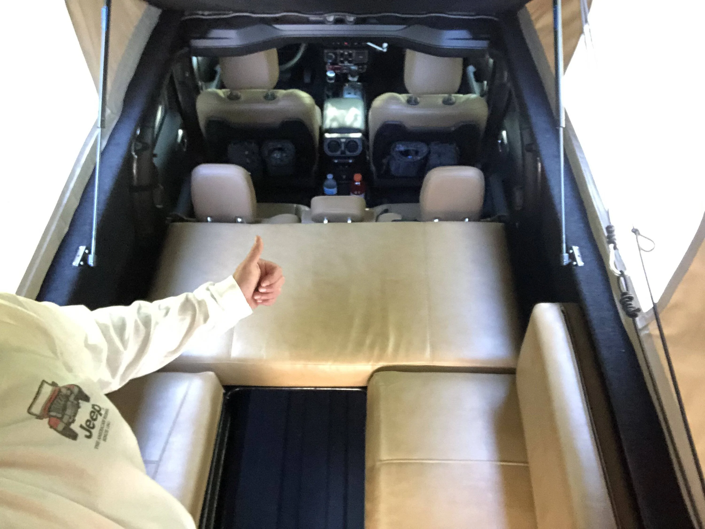

I can't believe I've been driving around with this camper for 5 months! This is my daily driver as well as my camper and toy. Here's my good, bad, and ugly report.
The Good:
  • The truck's HVAC works fine to heat and cool the truck in 100 degrees F to -10 degree F, driving or parked.
  • The fiberglass shell and paint job is holding up very well (so far).
  • The lift cylinders and external hardware is holding up nicely to the weather.
  • The lexan back window is working out well (I broke the acrylic one and had to make a tougher one).
  • The shell is very weather resistant driving in the rain. Only a small leak around the back hatch that doesn't affect anything.
  • The tent material I used is very heavy duty and probably overkill, but holding up great.
  • Love the layout when set up, with plenty of seating and room to stand and move around.
The Bad:
  • It's 6 inches too tall! I wish I would have shortened the top by 6 inches, so I could drive into my 8ft. tall garage. It still would have been tall enough up top to keep the mattress and bedding. Opps.
  • I love the simplicity of my push up/pull down bed and that I can leave the bedding made all the time, but it really restricts head room when the bed is down.
  • I have to put up the pop-up from the outside the truck, since the bed is in the way of pushing it up/down from inside. it would be nicer to pop it up from the inside.
  • Since the back is open to the front of the cab, you can hear anything in the back squeaking or banging around when you drive. It helps to keep stuff in bags, to reduce the noise.
  • I didn't make zip down windows, so it gets too hot inside to camp in the summer. I have a large velcro panel I can take out, but it's not easy to use. These campers must have large windows that ventilate. Back to the sewing machine!
The Ugly:
  • I missed two short seams on the top with fiberglass mesh. These seams were only filled with bondo and paint. Now I have two short cracks on top of the top fiberglass section because of this. You can't see them from the ground and they don't leak but I'll always know they are there. Darn..
  • The truck is too tall to go through a drive through car wash. I hand washed it yesterday in 37 Degree F weather. I hate having road salt sit on my cars for very long. Burrr.
All in all, I'm very happy with the build. I'm not much into cold weather camping now, but I'm already looking forward to spring camping.

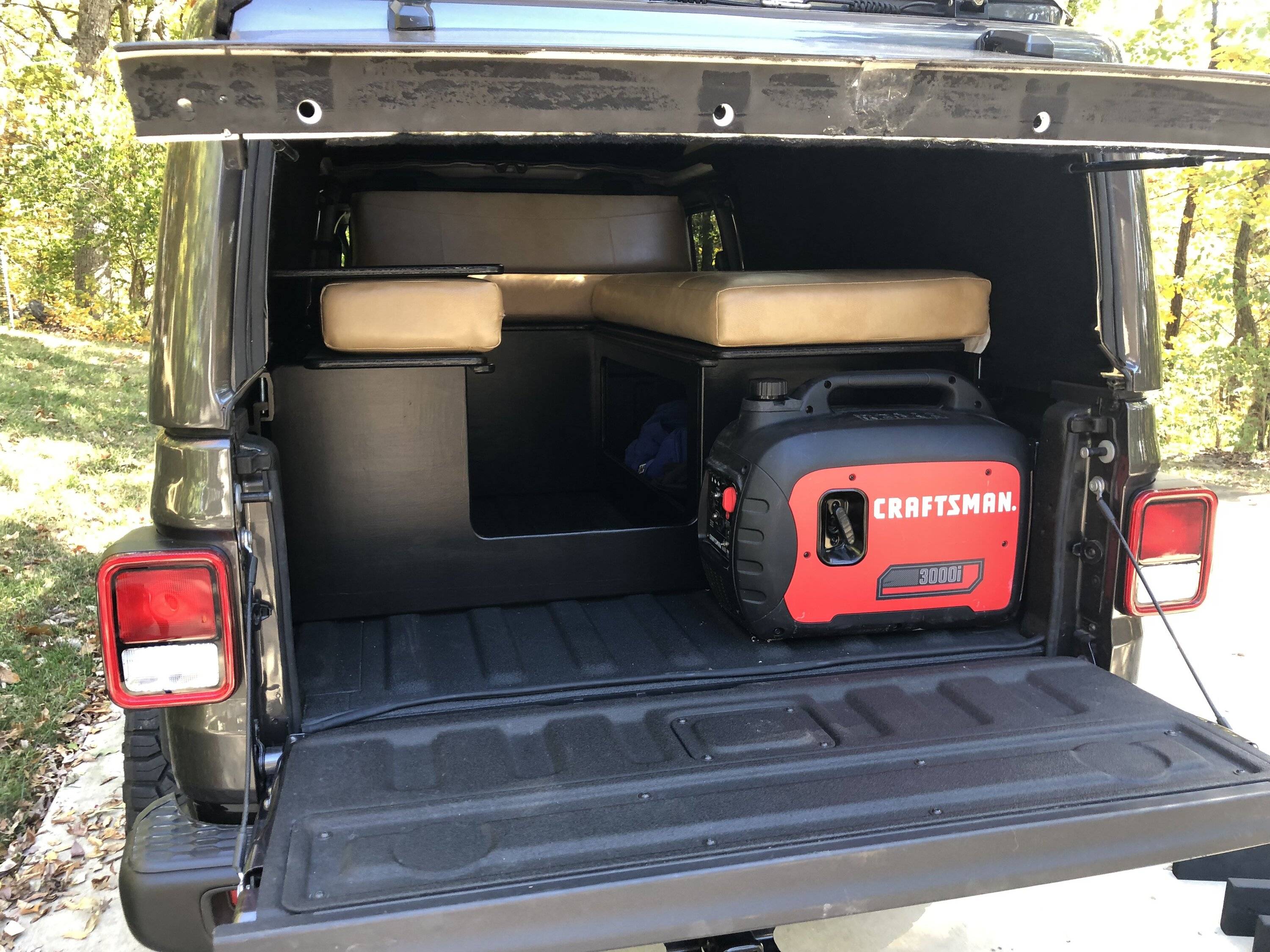

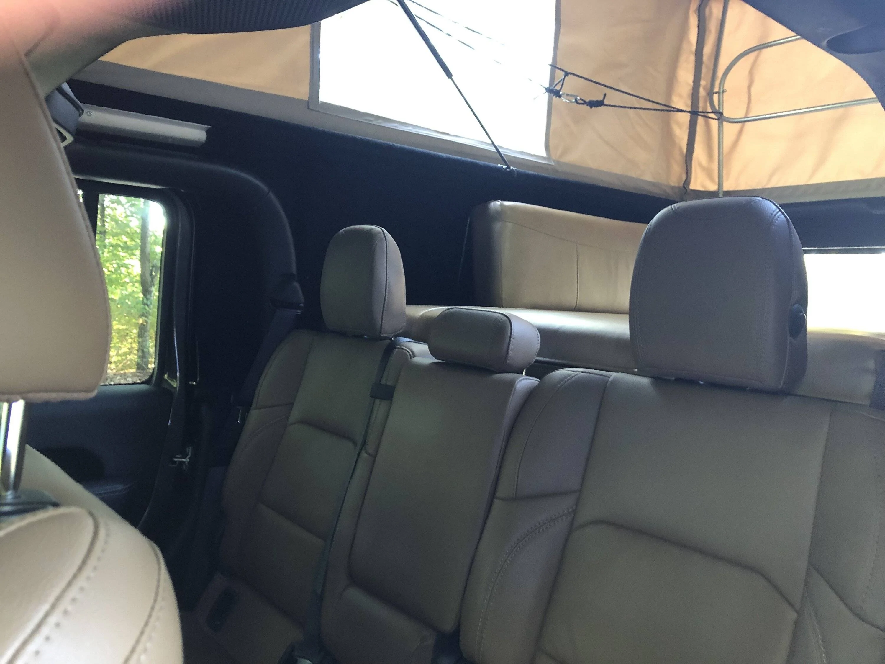

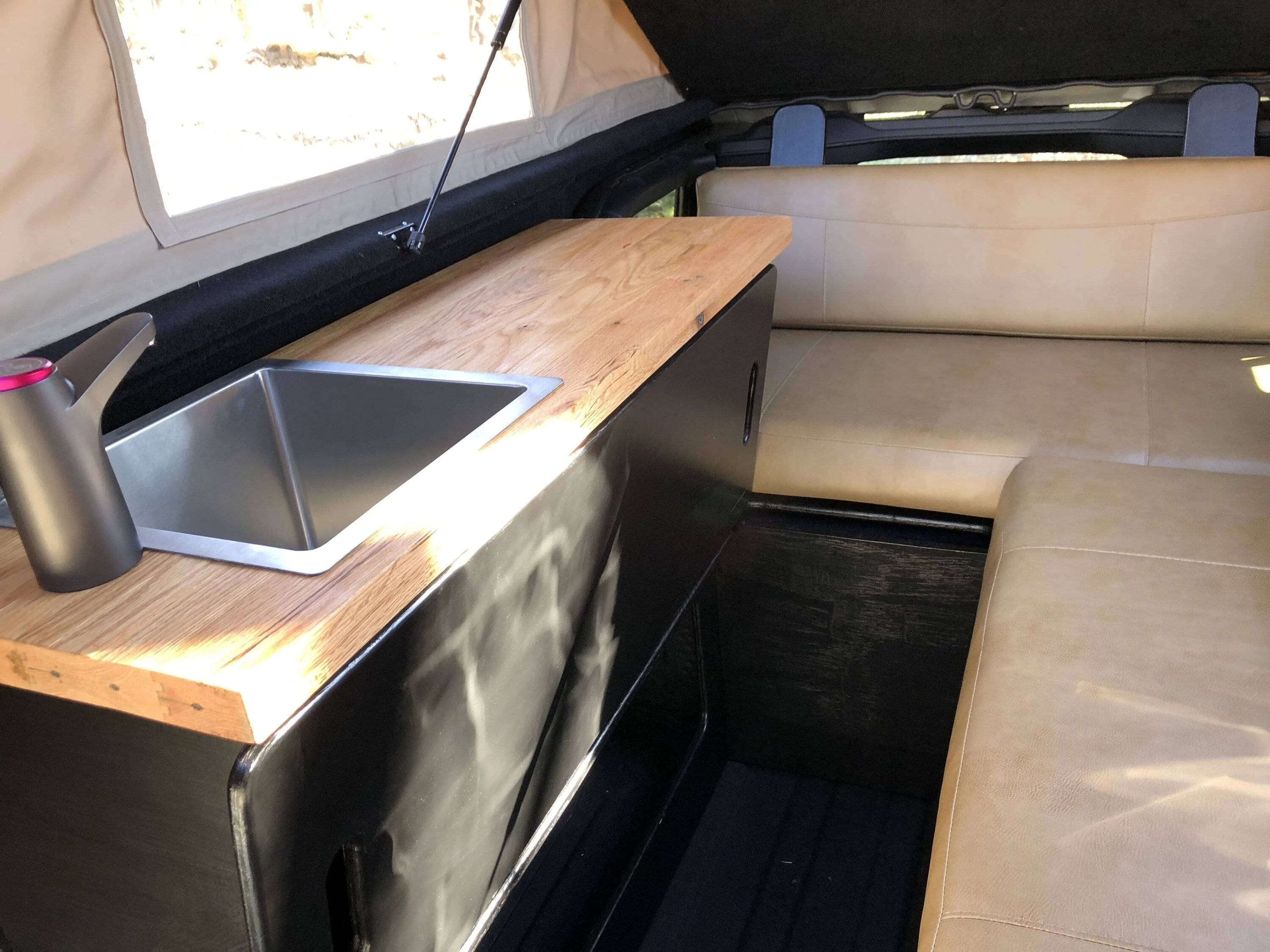

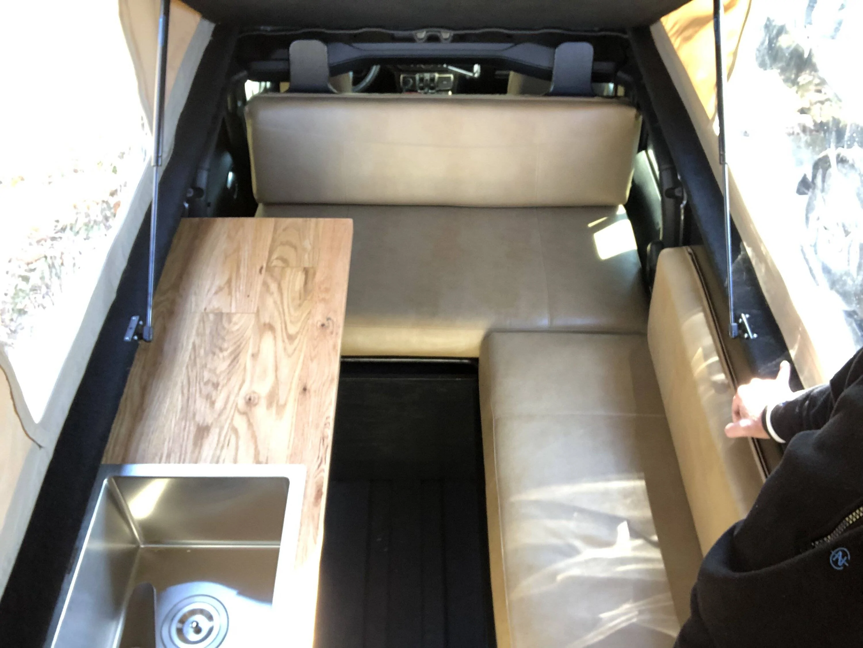

Here's a couple shots of the pass through to the cab that I posted on a couple other threads. I can fold the camper seat backrest up or down. When it's down, you can easily pass through to the back seats of the Jeep cab.
Jeep Gladiator Gladiator Expedition Rigs 137F0D64-12A6-47AD-848C-576EF671167B
Jeep Gladiator Gladiator Expedition Rigs B3FB5DC8-8FFE-47D7-89F3-FA2B2F360219
Jeep Gladiator Gladiator Expedition Rigs 1B5AD47E-6436-41AC-B9DF-7B7802D22800

It's freezing rain here in Missouri, and I'm sitting at home dreaming about camping.
One subject that I haven't made a decision on is a cooking stove for inside my camper. I've got a spot next to the sink for it. We've talked before about this, but I'd like to hear about options from this forum. I don't think I want to fry burgers in my tight space, but heating up coffee, soup, or a grill cheese sandwich sounds great on a rainy day.
Tell us or show us what you cook on indoors.

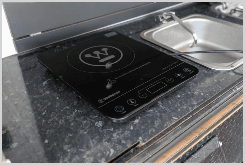

Here's a great article on using induction cooking in RVs. Stoves are cheap, but electric power supplies aren't. Bottom line is I need 2000 to 3000w power supply. Bit of a pain to lug my gas generator around, but electric power isn't much smaller and definitely not cheaper. Lots of choices out there.
https://www.4wdingaustralia.com/camping/induction-cooktop-12v/
