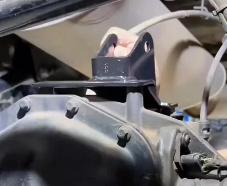

Gladiator have this this bracket?
Edgar
Oct 10, 2022
china
JEEP Gladiator willys

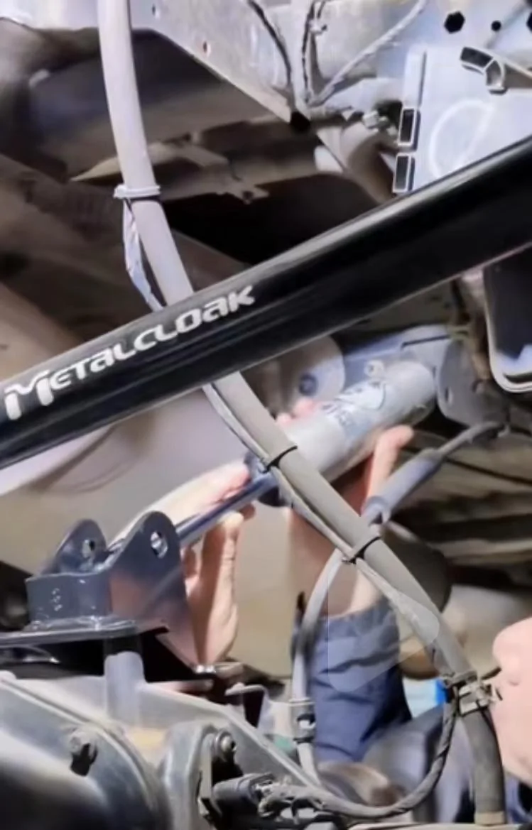

This is the first time I've seen anyone put a third damper on the rear axle of a jeep gladiator.
I want to try it,too.:like: which brand make this bracket?
Jeep Gladiator Gladiator have this this bracket? 5b1a4034d08d3803507e30b3d6431a2
Jeep Gladiator Gladiator have this this bracket? 1665474333124

Be careful when you get the bracket…
i had all the parts and when I was screwing the dang bracket into the top of my rear dif a bolt snapped…inside the screw…of the top of my diff.
and its JAMMED in there. Id need a welder to get it out.
11,420
30,421
It's a factory bracket. For a short lived solution.

What Gladiators are getting those, and why? My SRT10 Ram has one from the factory but with that torque and leaf springs it makes sense.
It really shouldn't be necessary on a 4/5 link unless I'm missing something. Or it's a band-aid.
11,420
30,421
There is another thread on this somewhere. It's a solution looking for a problem. Jeep used it for a short time. So did Ram.
They were installed on 2020 models with a manual transmission to limit rear axle hop. I don't know if they were installed after that. I ordered the pieces from @AllMoparParts.com and installed it on my 2020 Overland.
