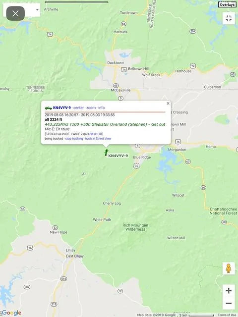

Benefit of FTM-400DXR use in Overland/Off-Road. The main benefit of course is improved communication between rigs in a convoy, improved range capability, more channels available, ability to send TXT over Radio, Ability to send other data such as Photos, my favorite digital capability of a radio using radio to a unit that transfers over to the internet (winlink) using VO/IP ability to be able to talk to some clear across the world with a small low power rig, the tactical side APRS.
APRS- Automatic Packet Reporting System by definition is a amateur radio based real time tactical digital communications of information of immediate value in the local area. A mouth full for sure but what does that mean, for the military guys think Blue Force Tracker in your Jeep. For the non Military being able to share your location by GPS onto a map in real time even when you are way out of cell signal range, even ability to use ISS (International) transfer information. So anywhere you can at least get a shot of the horizon, or in most places on Earth ability to share that info with other vehicles in the convoy, even loved ones at home. As well as sharing weather, messaging to another Callsign, email capability, bulletins, and voice.
Now for us it means security and peace of mind. Being able to share our location in real-time is a godsend in a emergency, or even in a convoy of trying to find another user. We where able to get APRS setup in our vehicle and are transmitting currently for N4VYV-9 and can be seen at https://aprs.fi/#!call=a/KN4VYV-9&timerange=3600&tail=3600 nite: one can ad ambiguity to their data so it removes a decimal place or more from their location for privacy. Here is a picture of us currently being seen using the above link, note: there is an app available. This can all be done with an APRS capable Radio or using a connection device, your radio, and a tablet to see the location in real time.
More information can be found using the website of the creator of APRs: Link
