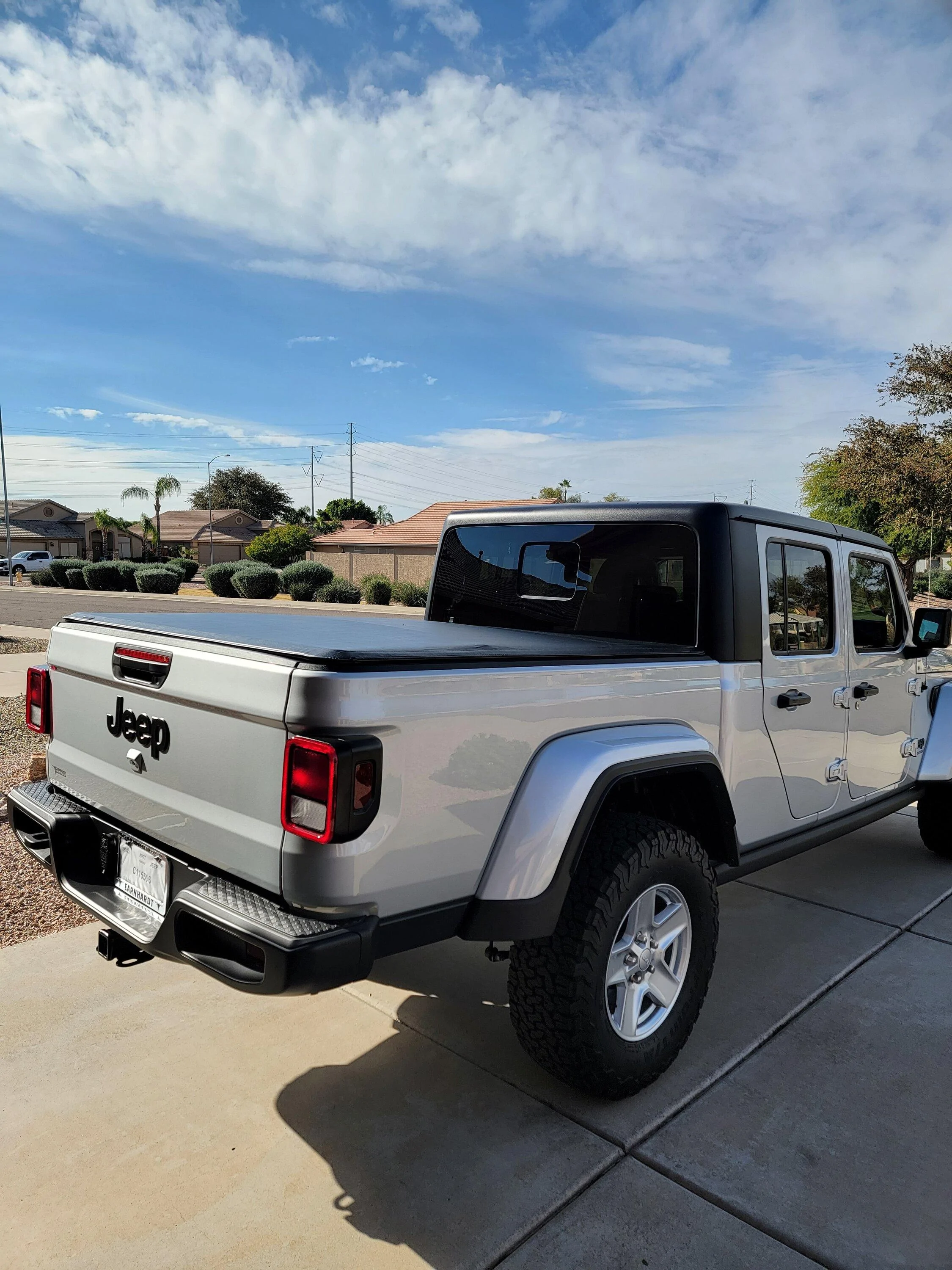

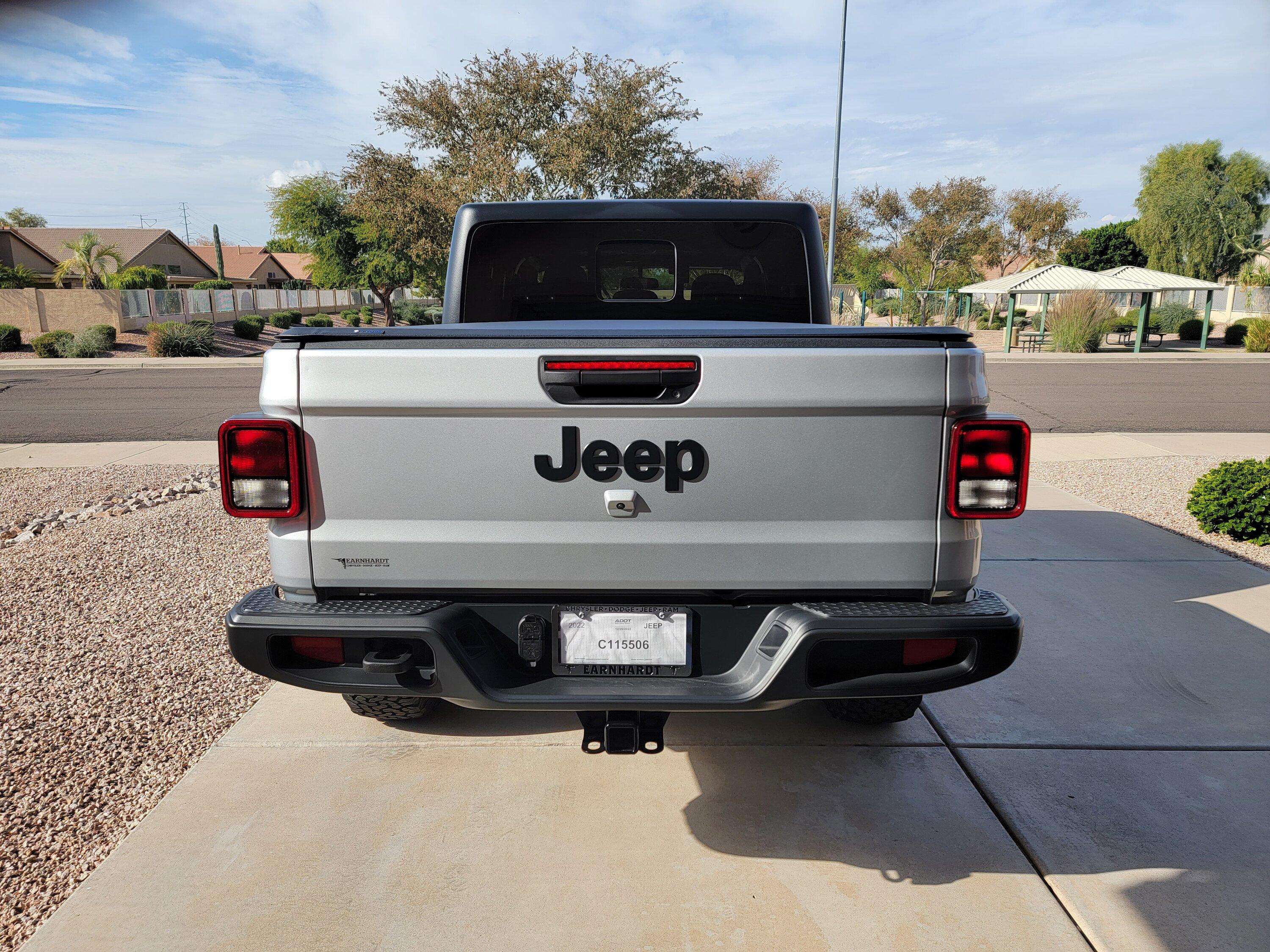

Tyger Gladiator specific cover arrived yesterday and installed this morning. Took about 45 minutes total and no adjustments needed after install! Looks good to me . Very impressed with the quality. Thanks to all who posted.
