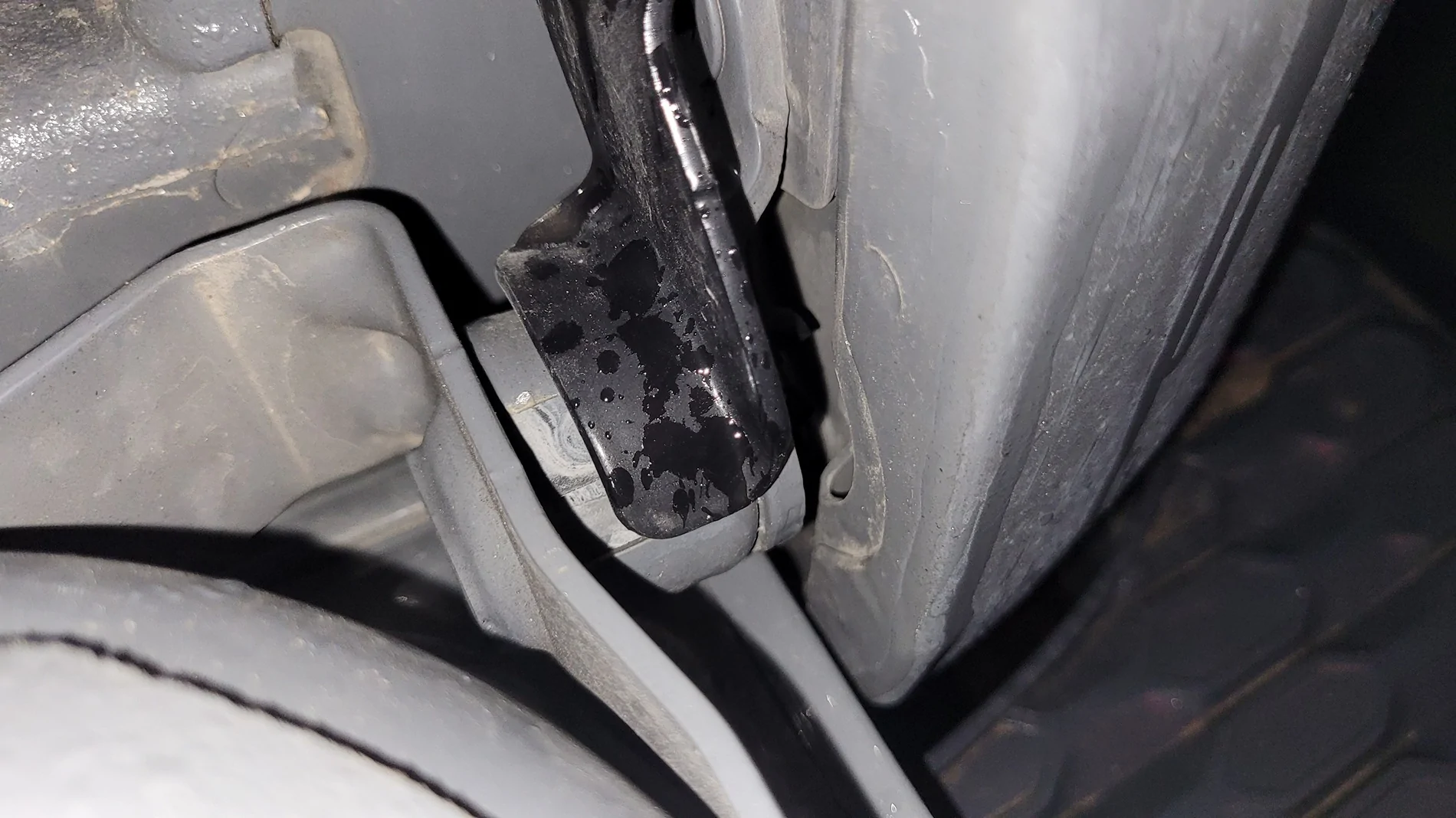

Do you have a small plastic collar/sleeve in yours that rotates with the tailgate movement?
Jeep Gladiator Gladiator Tailgate Modification 20260304_052746
Here's a picture of mine. I believe I have the plastic collar your talking about. It's between the tailgate cup and the pin on the bed/body side.

Das it!!!!
