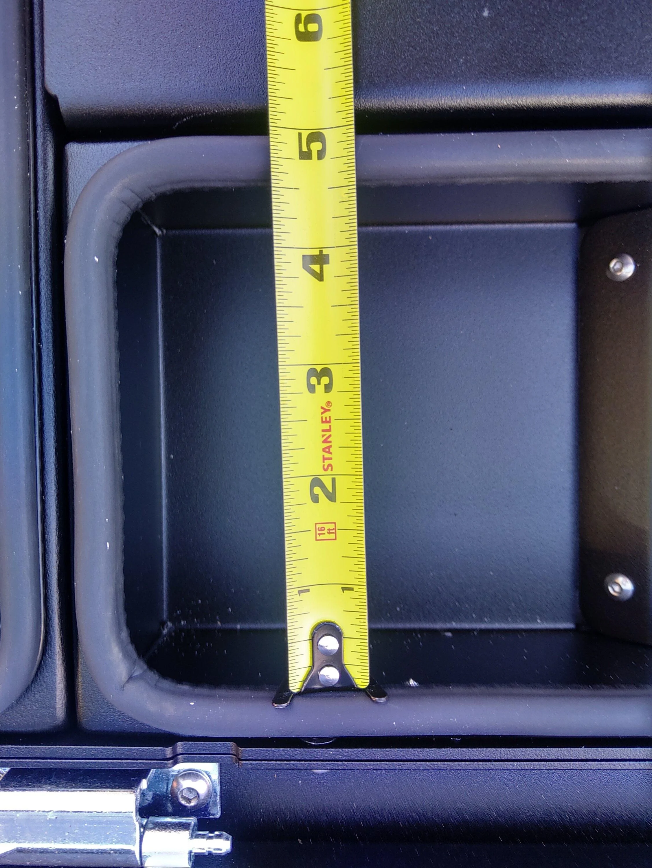

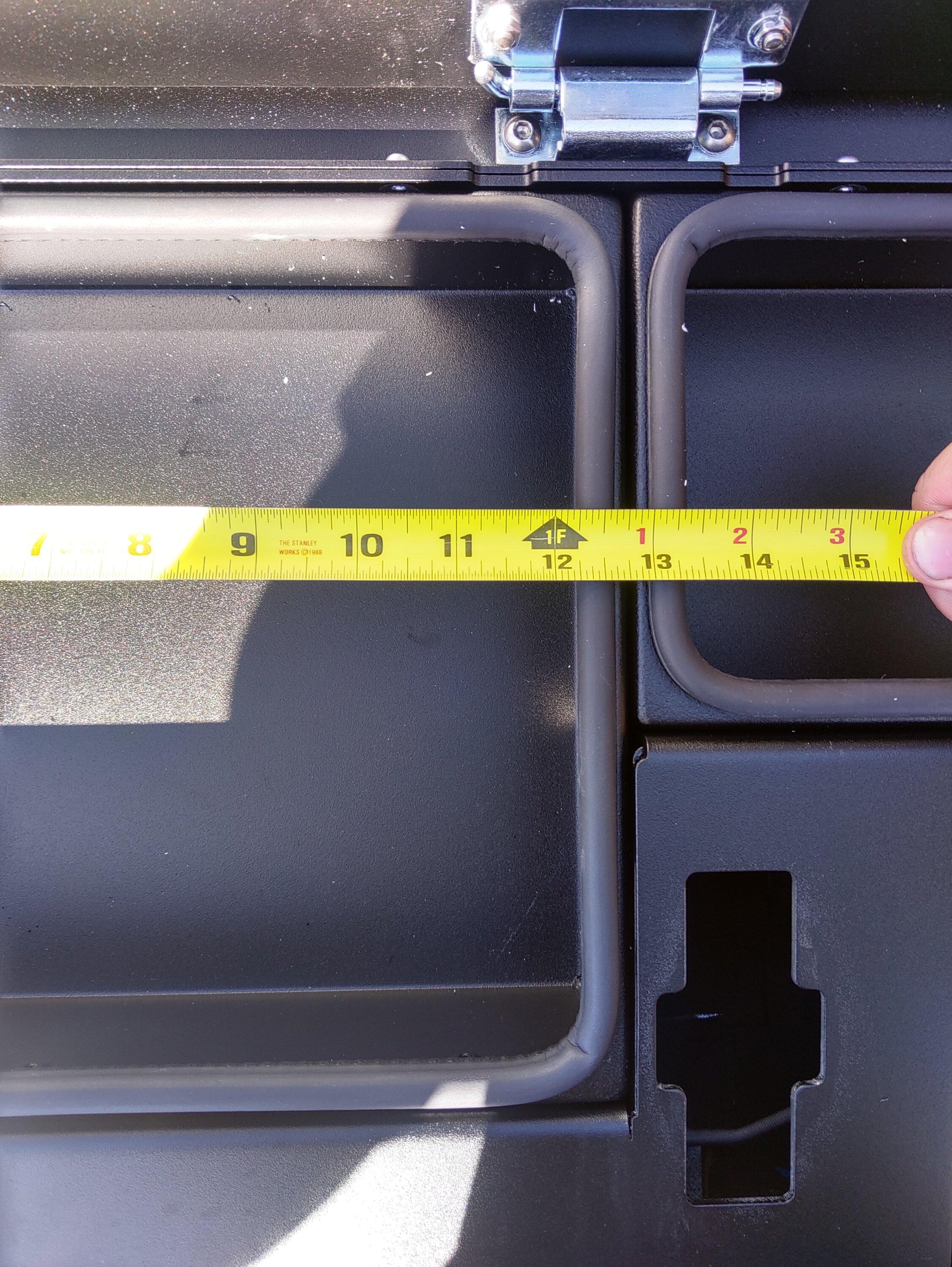

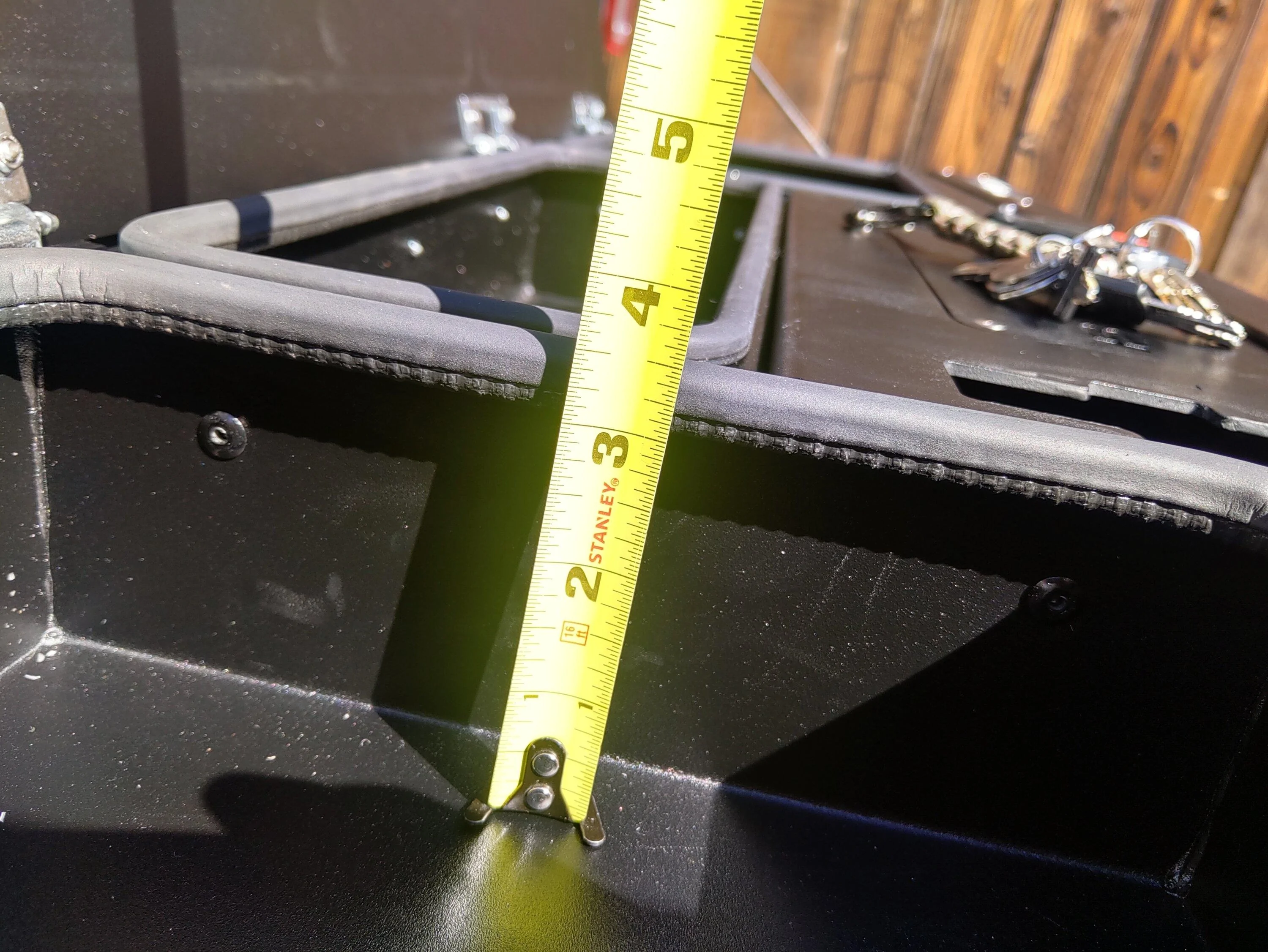

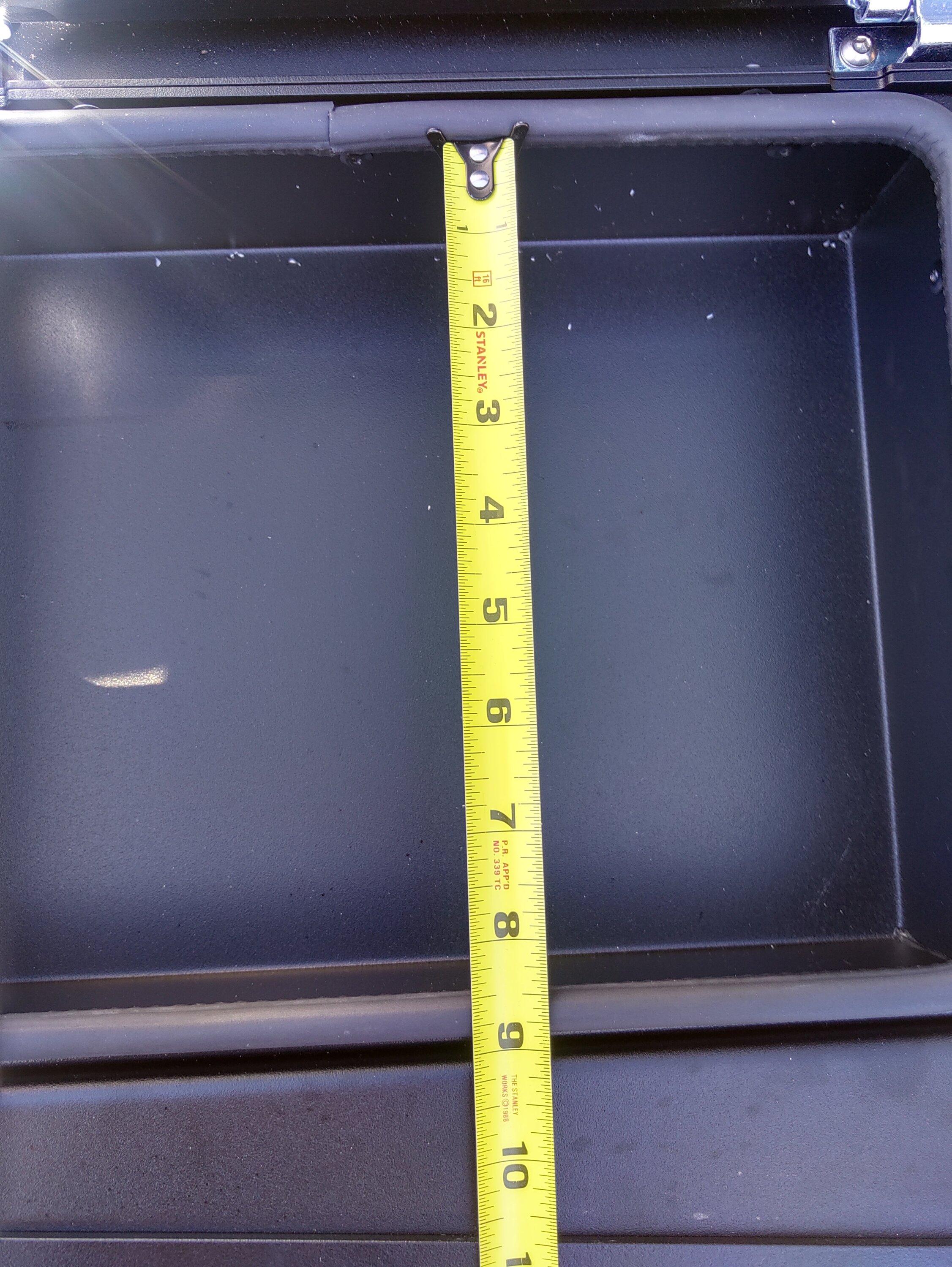

What are the dimensions of the compartments?
Outer compartments are the same, approximately 12.5" wide x 8.75" tall " 3.5" deep. I'm gonna say approximately because I'm measuring from the top and the seal is there and it's the weekend so Im halfassing my measurements.

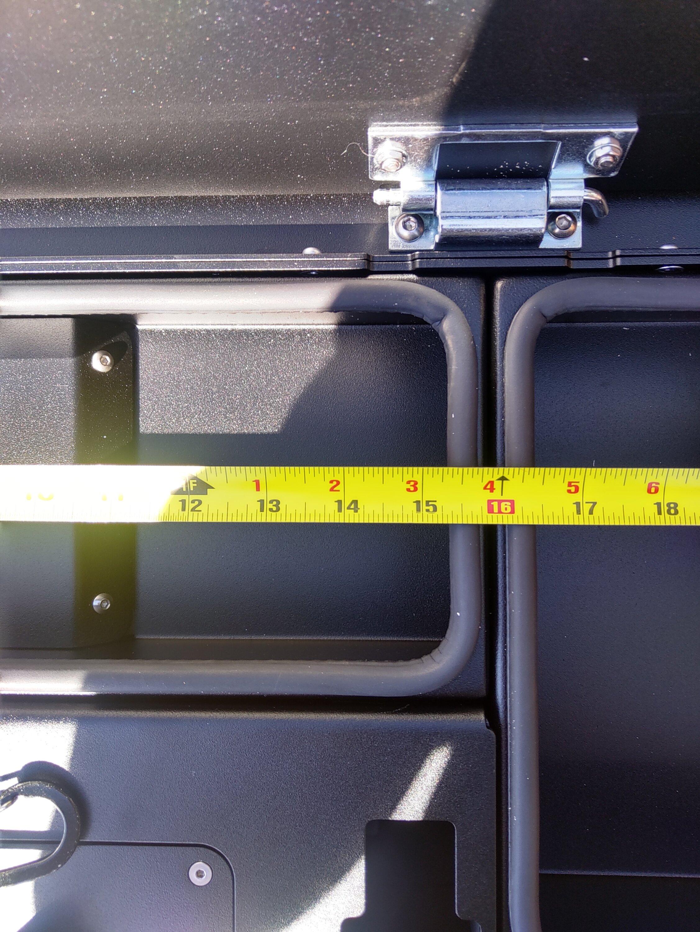

Inner compartment is longer and narrower, more like 15.75" x 5" useable space, same depth for the most part except there's a hump in the middle where a feature was designed into the base of the bin to account for 12v harness routing, you lose about an inch at this location.
