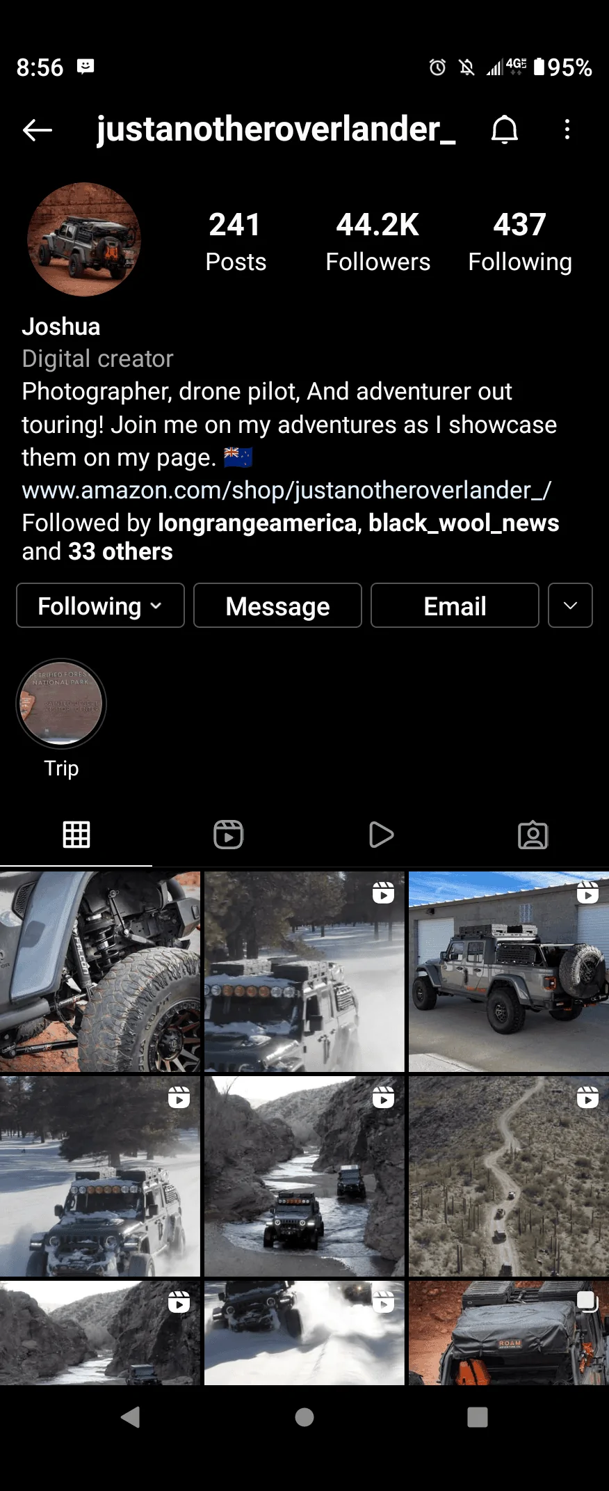

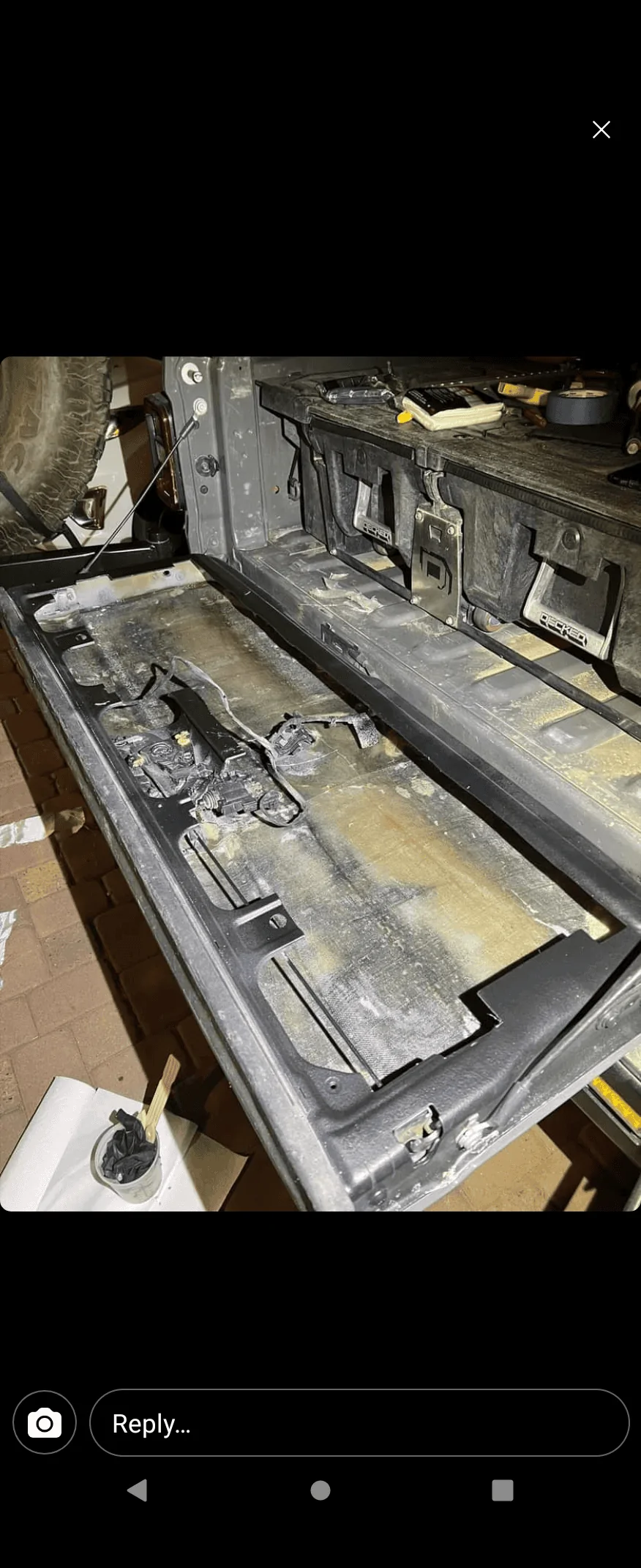

Heres a screenshot, Joshua / JustAnotherOverlander_ sent me a bunch of videos, but he also sent me a still image of the cutout he made. Ive attached another screenshot with his info.

Oh theres going to be a lot of pictures on this one ahaha.. when I get around to it.. Im hoping to get to this done over the Presidents day weekend we`re about to have, but Ive got a few other things to knock out first (New suspension, Wheels and Tires are on the way, housework, etc).
Whoa! Is that fiberglass inside the cut tailgate?
Yep, but thats not mine - Thats another owner I was talking to on Instagram.
My fiberglass skills arent great, and I hate working with the stuff, Im going to go with thick butyl patches instead on mine. Im not terribly concerned with reenforcing the outer wall of the tailgate, id be more worried about the flanges created by cutting, but I think that the pieces being riveted in will do a good job of providing structural rigidity. I admire the effort he put in though, that thing is solid.
Whoa. I'm not afraid to let some sparks fly but I'm past the DIY stage if fiberglass is required. Can I ask if this "structural rebuilding" is necessary or is this just taking extra time to go above and beyond "doing it right"? I love to go the extra yard if see the opportunity to tweak even aftermarket parts but if this is a required step of the process I think this upgrade may have lost it's luster to me personally. I know exactly what you are referring to with the rubber butyl panels though, I love using strips of it for various projects. Heck I have some old postal office rubber conveyer belt planks that I cut up to use a padding in projects :)

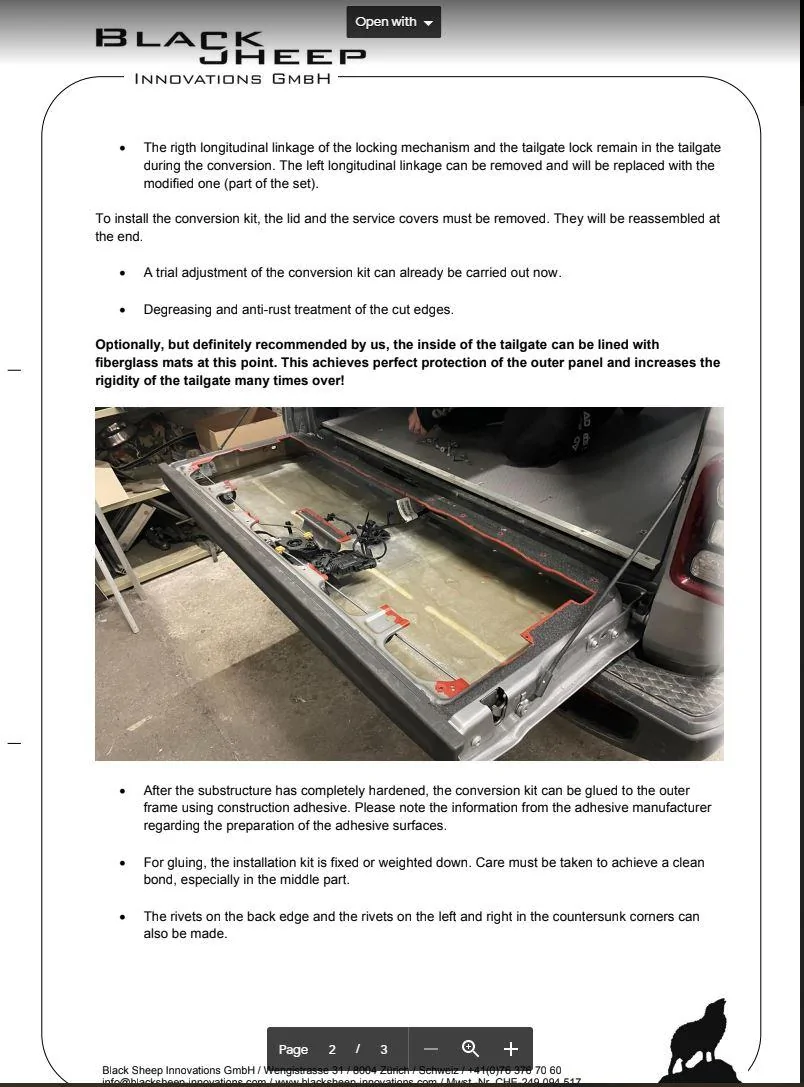

I'll be following along to see your process! Enjoy the long weekend and good luck!
I hear you - Its my understanding that this is a recommendation, but not a necessity. Ive attached a screenshot from the instructions provided by Thomas here, that specifically calls out the fiberglass as "optional but recommended".
Its my understanding that the kit is installed with a combination of epoxy and rivets - The instructions reference "Construction Adhesive", I am going to go with Betaseal U-418 Urethane, it comes in a standard caulking tube and I have used it in the past for Windshield replacements so I feel comfortable with it. I think it will provide a combination of strength and flexibility that will be beneficial in this application.

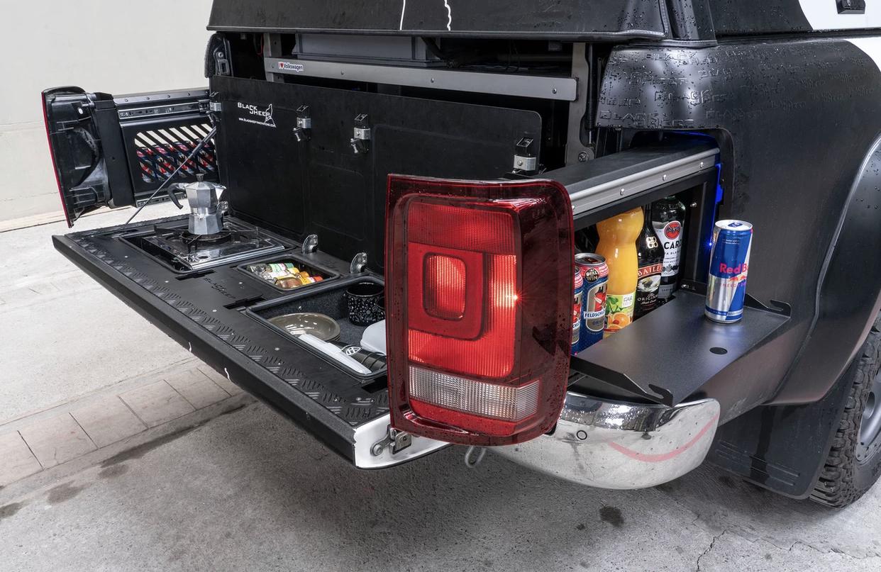

I received mine this week. Put down the deposit a month ago, got one of the first kits in the US - Hopefully wont suffer from too many "early adopter" issues. Havent gotten around to the install yet, have a few other projects that are waiting in the garage and short on time. Ive talked with a few owners who have already done the modification via instagram, and one of them (Joshua / JustAnotherOverlander_ )shared a lot of photos of the install with me.
The designer, Thomas at Black Sheep, was really communicative and helpful. It does seem like a fairly straightforward install, although you are absolutely doing some cutting. Thomas provided a GD&T sheet laid out with all the cuts necessary and the dimensions of them.
Im going to just lay down some Killmatz butyl patches inside the tailgate for the extra support, If I find that it feels goofy I may go back and fiberglass it later, but seems a bit overkill to me.
The parts were packaged really well, and Thomas was awesome about getting things set up for the US Folks - Had to change the language on his site and set up a credit card payment processor, etc.

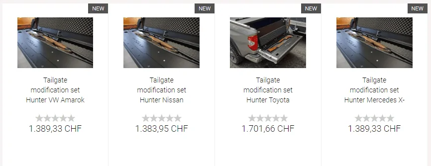

Ran across this interesting product. Based out of Switzerland & seems to be $1500 shipped. Shows promise about what else is being done with the gladiator.
Anyone seen anything similar? Curious as to what else could be done with the tailgate other than MOLLE panels or fancy cutting boards.
https://www.blacksheep-innovations.com/jeepgladiator
$1,362 + $165 shipping and it permanently alters the tailgate. Interesting, but no thanks.
