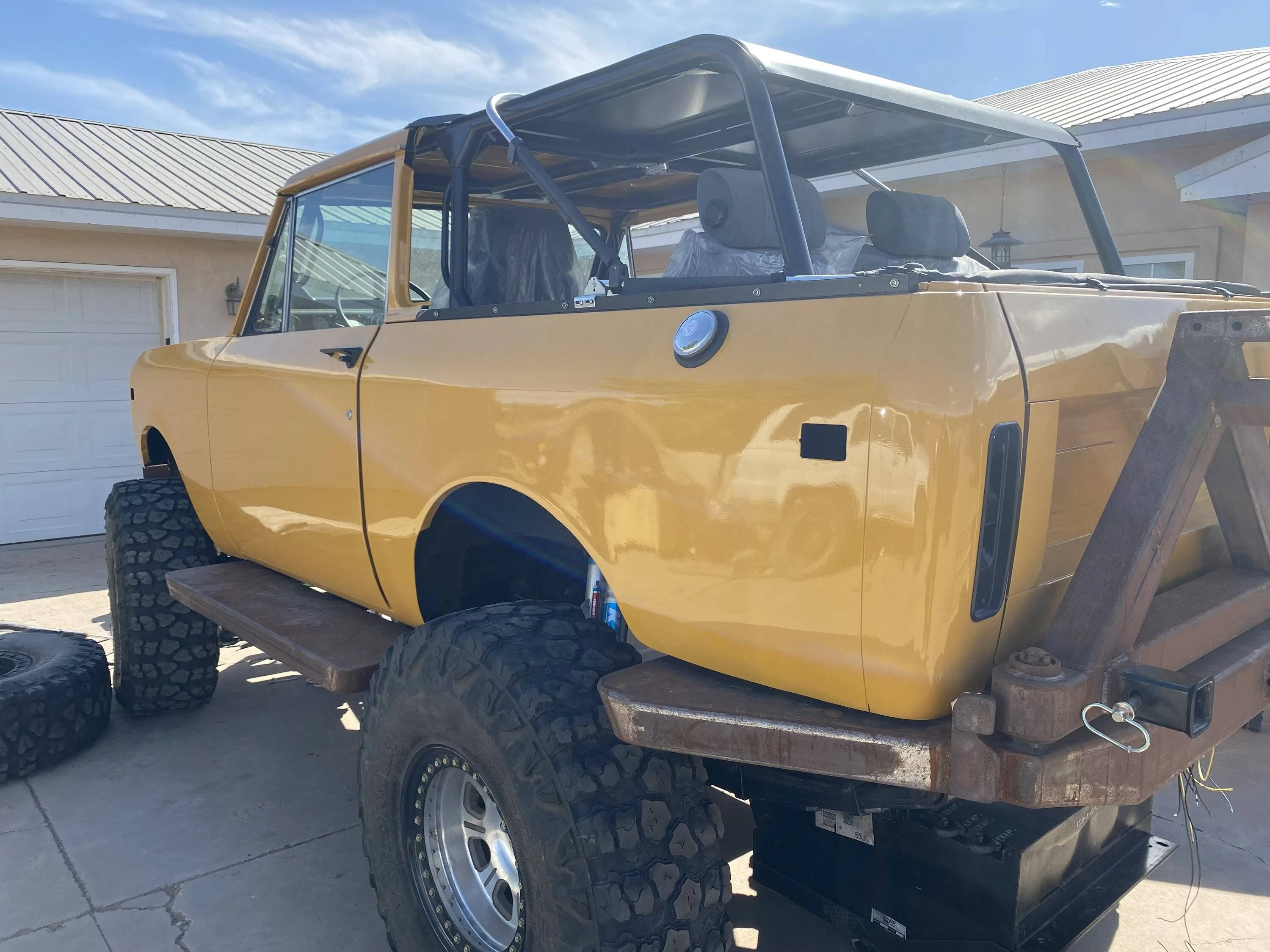

I know there is some knowledgeable people on here that can help.
I’ve got a IH Scout that I installed a 8.1L in. I have the original ECM. Starting for the first time. Trouble code P1626-anti-theft fuel rail shut down seems to be the problem. Anyone know how to bypass?
Thanks in advance.
