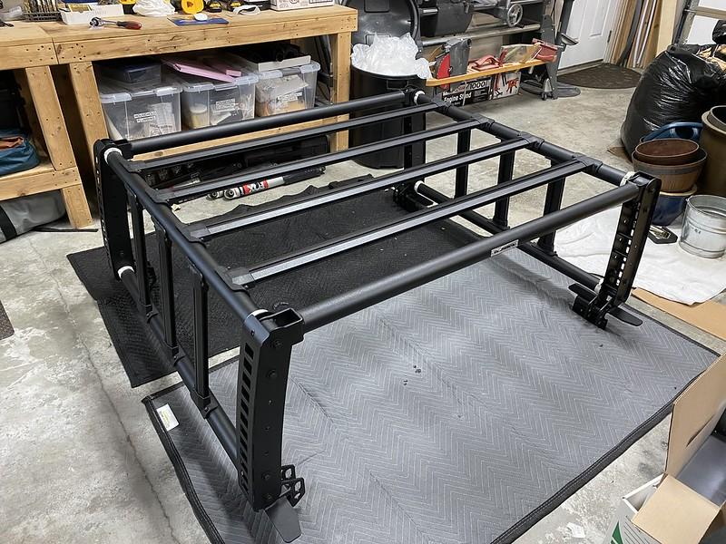

Ok, so putting this rack together... the instructions need some work.
Unofficially, its about a 3 beer job. 2 if you have some help.

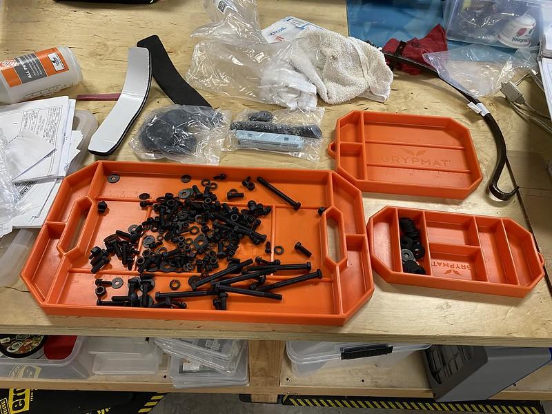

Officially, the vinyl washers are a bit of a pain, and there is an ENTIRE STEP MISSING in the instructions. Literally. No where in the manual does it talk about mounting the bottom connecting tube. And spoiler alert, its a huge pain to do! It goes hand in hand with mounting the "feet", and it is a big balancing act. The bolts that connect the cross/side members also need to be longer. 3/4 inch is barely enough to get one thread in before forcefully having to screw it down, rather than having them hand tight during assembly as per the instructions.
My rack is assembled and sitting in my garage until I can grab a second set of hands to lift it on to the truck. I'm excited to get it on there. Pics to come tomorrow.

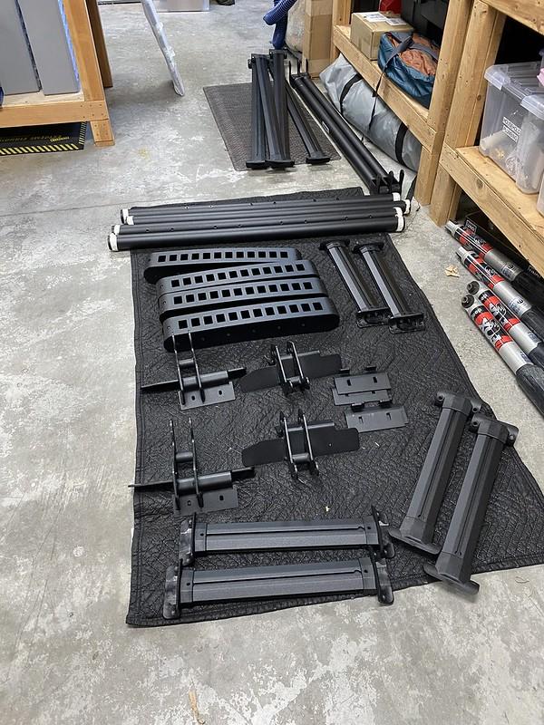

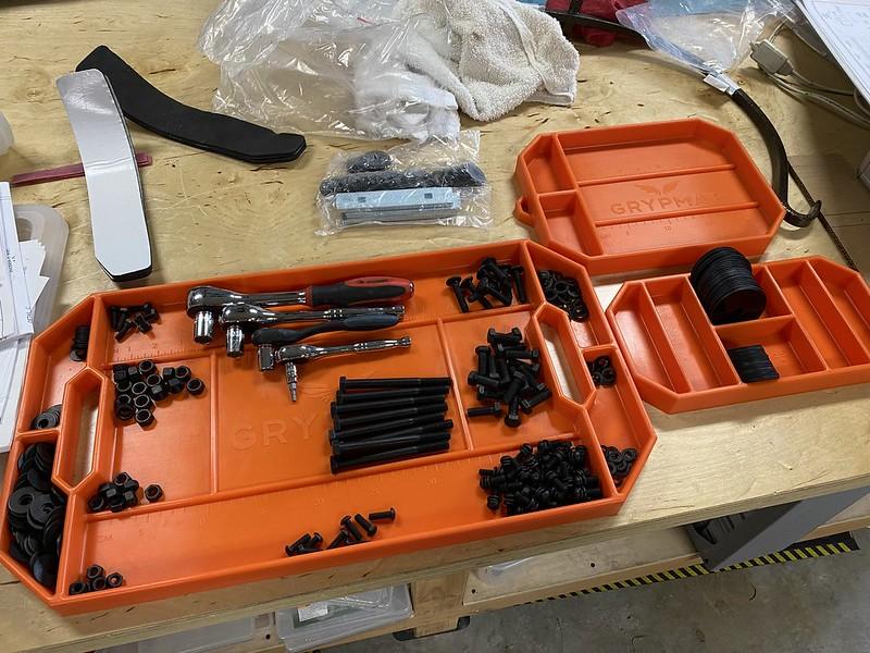

Laying the parts out.
Jeep Gladiator Go Rhino Xtreme Overland Rack 51177703110_b15f3372e7_c
Oh lord that's a mess
Jeep Gladiator Go Rhino Xtreme Overland Rack 51177401344_99b95f9a60_c
Much better.
Jeep Gladiator Go Rhino Xtreme Overland Rack 51176613186_04f588f1e6_c
2.5 beers, 3 hours later. Ready to be lifted on to the truck.
Jeep Gladiator Go Rhino Xtreme Overland Rack 51176832953_4a6df0e814_c

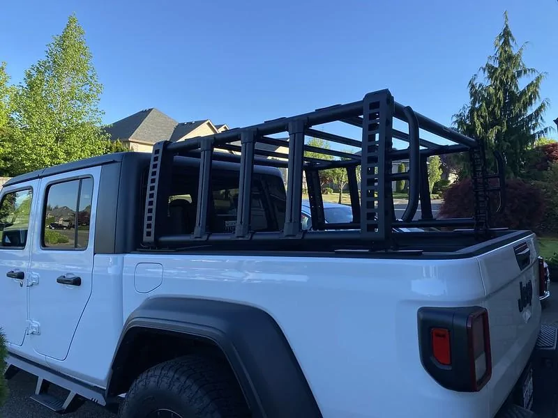

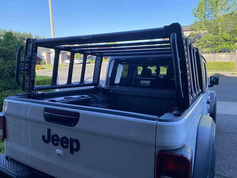

It's on!
Jeep Gladiator Go Rhino Xtreme Overland Rack 51176832928_852dae01f4_c
Enough clearance for my swing case.
Jeep Gladiator Go Rhino Xtreme Overland Rack 51177703100_2383e06193_c

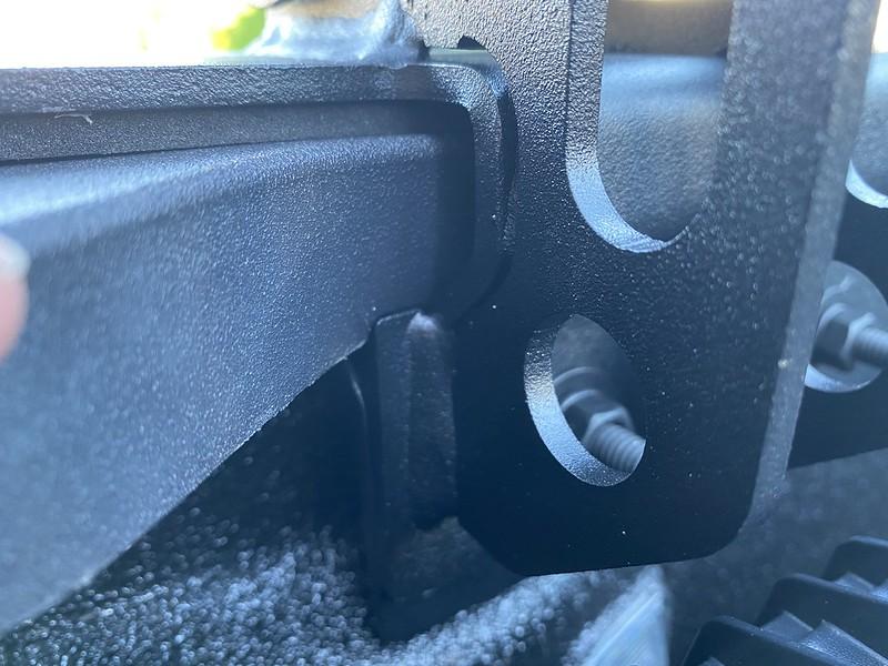

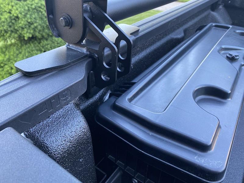

Ok, here is what I really don't like about this rack. The mounting brackets for non-trail rail pinch the CRAP out of our bed caps. You have to move the rack around a bit in order to get the feet to line up and for the attachment bracket to not interfere with the plastic tabs on the underside of the bed cap. Its very hard to describe but long story short I wish there was a better mounting option.
Jeep Gladiator Go Rhino Xtreme Overland Rack 51177703085_8c88d1297f_c
But it looks pretty good once it is all on there.
Jeep Gladiator Go Rhino Xtreme Overland Rack 51176613156_a781cf9489_c
