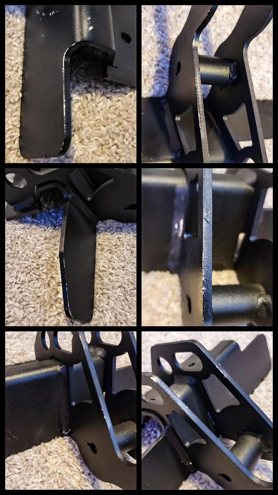

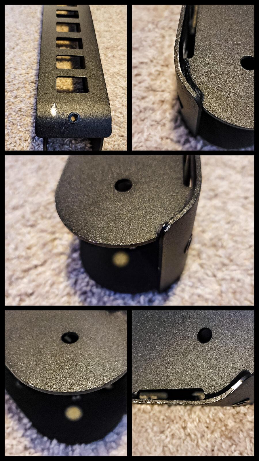

I just received part of my rack from Go Rhino (no tracking ever provided) I ordered via Quadratec. The boxes were pretty beat up and one was never delivered because FedEx sent it back to their distribution center to inspect it because it was apparently damaged in shipment. Unfortunately, what I received so far was a big disappointment... Almost everything in one of the two rack boxes had messed up powder coating (the other box containing the rest of the rack pieces is the one that's still missing and being examined by FedEx). The powder coating wasn't damaged in shipping, all the edges are peeling up and powder coat is falling off. Additionally the powder coat isn't holding on to a bunch of the welds... I also ordered their table that can be mounted to the side of the rack and the powder coated bracketry in that is having the same problem. Like I said, not a shipping issue, this is a quality assurance issue. I have to say, I waited a long time for this and was pretty excited. I'm very disappointed so far... I've sent an email to Go Rhino with pictures and details for each of the boxes that had damaged powder coat. I'm waiting to see what they do to make it right... Here's some of the photos...

@thekorky mine came up like that and I did touch em up. I only had powder coating issues with the brackets. Mine came super bundled up, but I agreeā€¦ itā€™s not from shipping.
Weā€™ll see if I have any other issues with the bars (still not received) but QUadratec said itā€™s suppose to ship today when I checked with them last week.
Man, that stinks... On one hand I'm glad it wasn't just me, but it's still not good... I'm still waiting to hear back from them and I still haven't gotten my other box. Did you just use some touch-up paint?

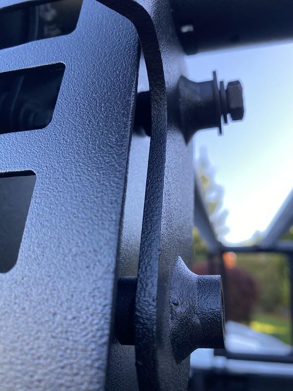

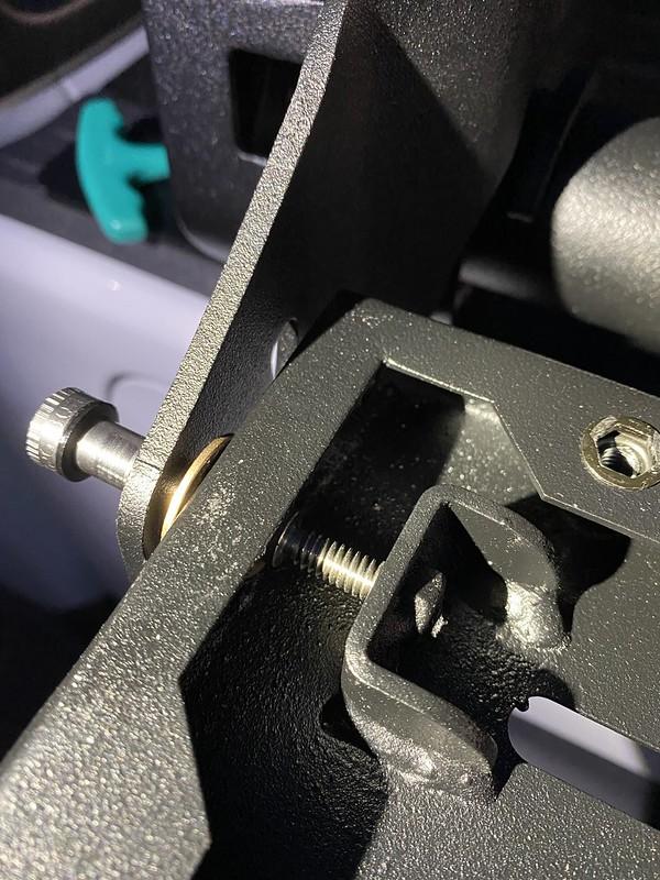

So Friday I had the sudden arrival of the table... And things went downhill from there.
First - the brackets for mounting the table do not come with long enough screws to secure to the other side. They come with 2 inch bolts, but they NEED to be 2.5 inch. I went to the hardware store and bought 3 inch (all then had) but ended up having to cut them down.
Jeep Gladiator Go Rhino Xtreme Overland Rack 51186868869_bf91dc7284_c
Jeep Gladiator Go Rhino Xtreme Overland Rack 51186868864_31eeff058b_c
Jeep Gladiator Go Rhino Xtreme Overland Rack 51186306358_b6ec9b4c0e_c
Second issue - only one of the 2 cables was drilled large enough to get around the bolt that mounts to the frame. Had to drill that out.
Jeep Gladiator Go Rhino Xtreme Overland Rack 51187158410_6b226517ae_c

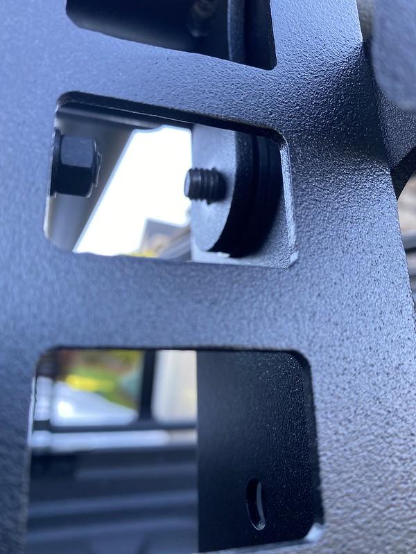

Third issue - the plastic washers they provide are a complete joke, not the right size or what is shown in the instructions and break before you can get them on the bolts for the table. (you can see it just barely hanging on in the next pic.

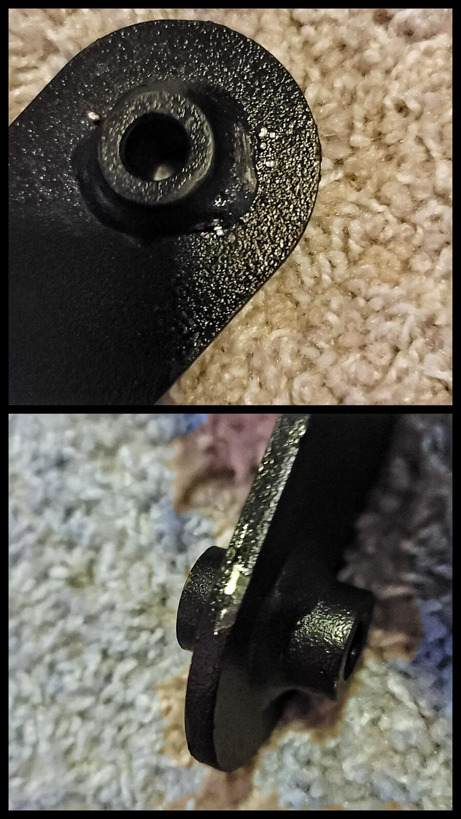

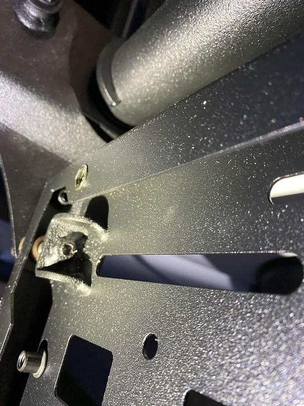

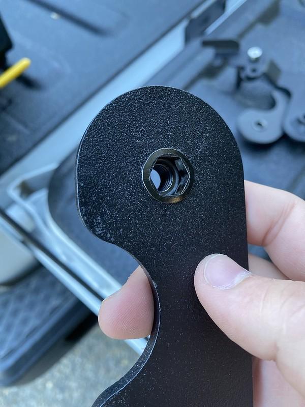

Forth issue - The threads for the pivot bolt needed to be chased out with a tap. There was enough overlap in the powdercoating that I spent 15 minutes trying to get one bolt screwed in before removing the table completely, seeing the problem and then fixing it. Major QC issue.
Jeep Gladiator Go Rhino Xtreme Overland Rack 51186087741_279fdb4ffa_c
Jeep Gladiator Go Rhino Xtreme Overland Rack 51185395297_0c35f8d625_c

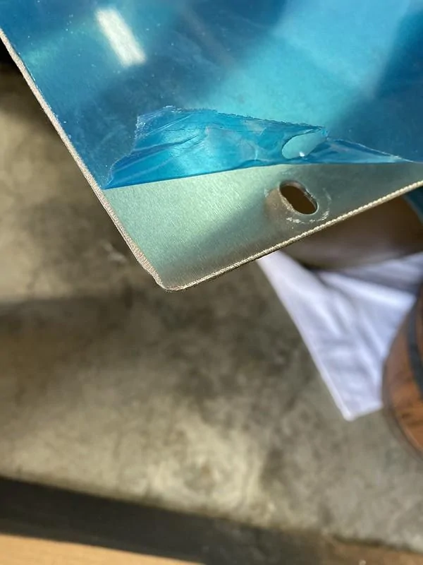

Fifth issue - the quality of the table top.... leaves much to be desired. I may end up replacing this end insetting a plastic sheet instead. I have no desire to add things to the molle panel on the outside/under of the table, so by insetting a plastic version, I can keep things from rolling off the table at angle, AND make it look a little nicer. But we'll see.
Jeep Gladiator Go Rhino Xtreme Overland Rack 51185395277_d10a23d6d9_c
Sixth issue - the instructions are even more whacked than the rack going together. They need to hire a technical writer, or at least allow us to add some critiques.
With that all said and done... I did get to use it this weekend. And it worked great!
Jeep Gladiator Go Rhino Xtreme Overland Rack 51185395252_bd238f574c_c
I use touch up paint using Mopar oem black for the hardtop. It matches very good and its really hard to see the touch up marks, but then again, i do have to take it out on sunlight to really determine lol.
I received many parts that have crappy powdercoat even from Artec, and Offroad Evolution to name a few so i expected the same with GoRhino. I prefer my parts non powdercoated if possible so i can powdercoat/ paint to preference.
The only product i purchased (twice) that had PERFECT powdercoating is White Knuckle Offroad.

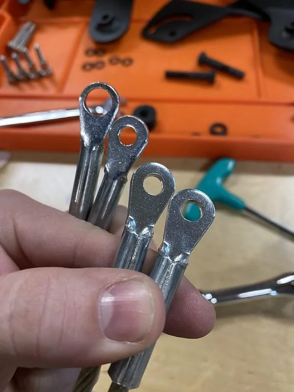

I just looked at my table to check for similar issues and found a few that you noticed. The eyelets on the ends of the retaining cables are all different sizes. Also my stainless steel table top didn't come with the blue plastic protector on it and there's a dent in it...
Just to clarify. Only the top ends of the cable need to be drilled out for a larger screw, so don't go enlarging holes for everything until you measure and need it. I almost made the same mistake.
Noted, and thanks! My cables actually came with one end attached to the table on either side. I did remove them to verify that the cables weren't reversed with the larger hole already attached to the table. This wasn't the case. I still have one eyelet that's not the correct size.
