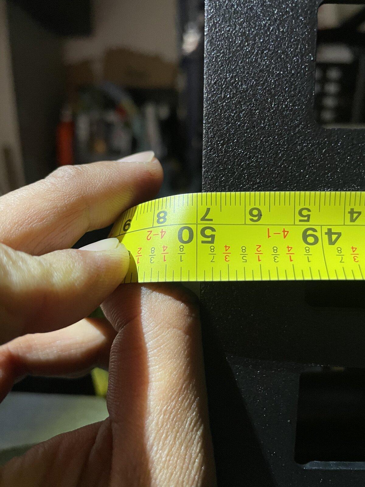

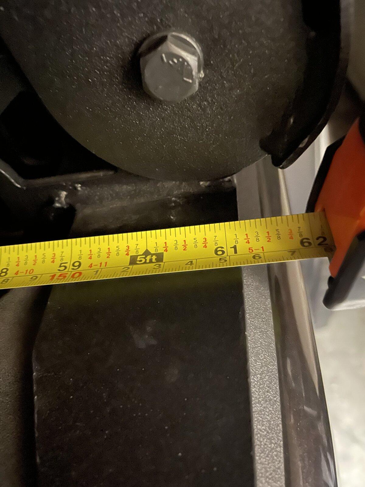

Bar pillar to bar piller is 60”
Bar bracket / to bar bracket WIDTH 61 3/16”
Bar bracket length to bar bracket LENGTH is 58 3/8” (close guesstimate)

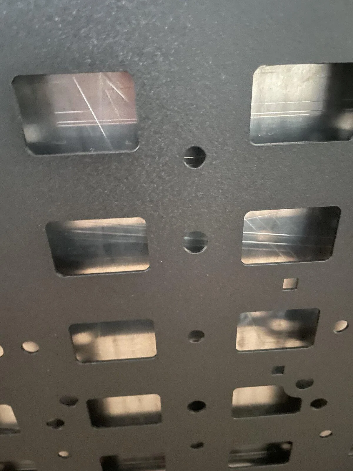

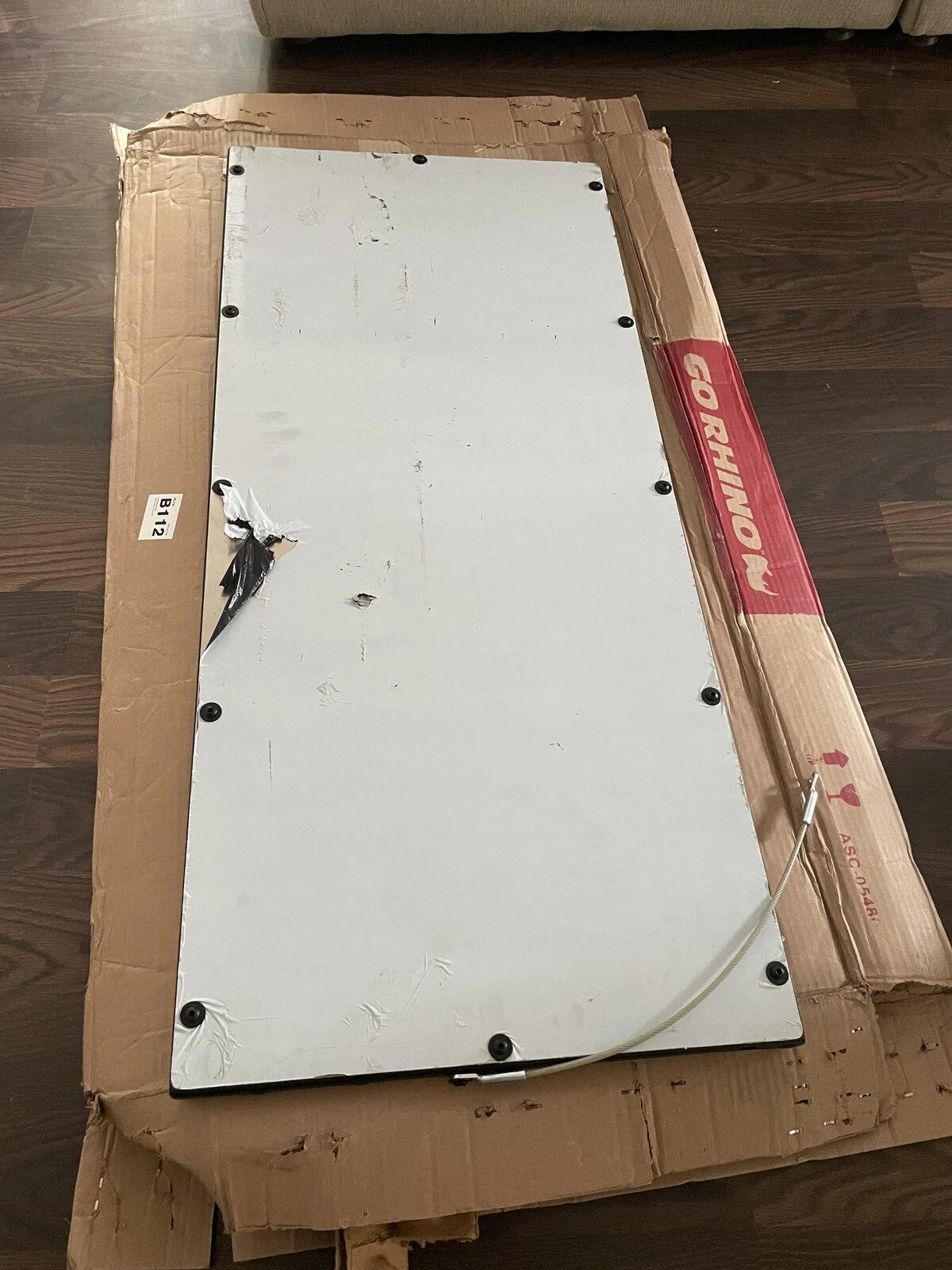

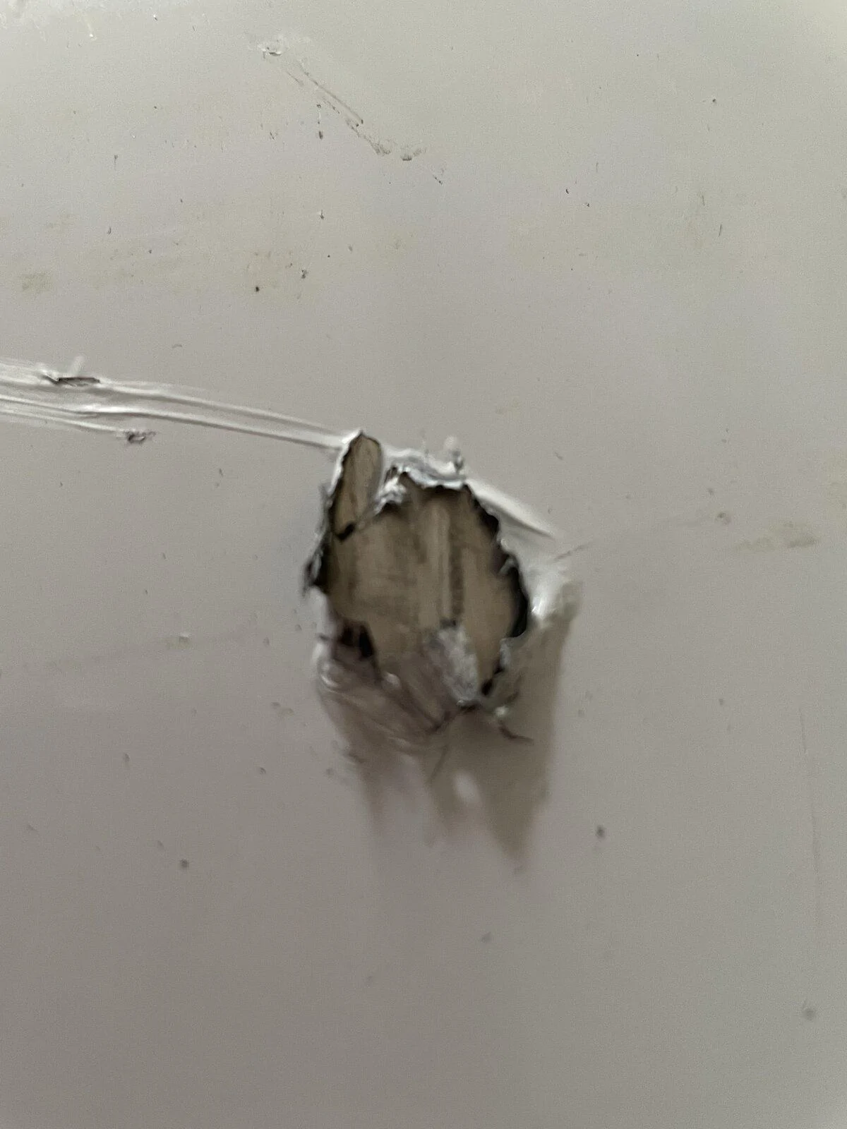

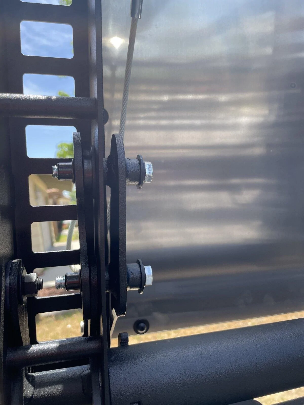

I bought 8 bolts 3/8-16 x 2 1/2” for the table. I will be installing tomorrow. I looked at the instruction manual and it’s a hot mess.

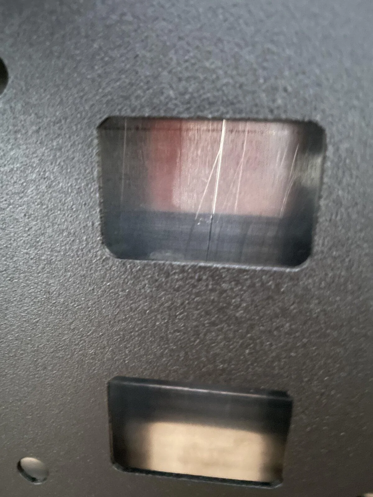

My table came preassembled but the aluminum is all scratched up and not from shipping since it was packaged nicely even though fedex mishandled.

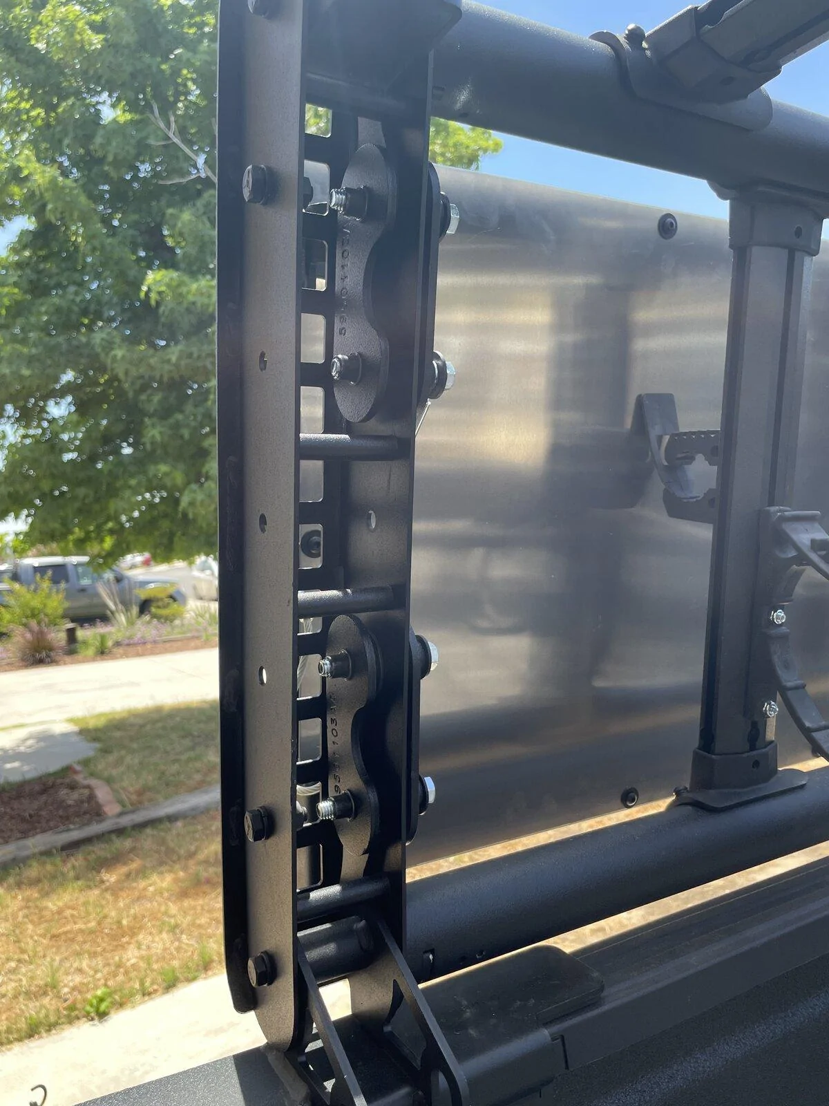

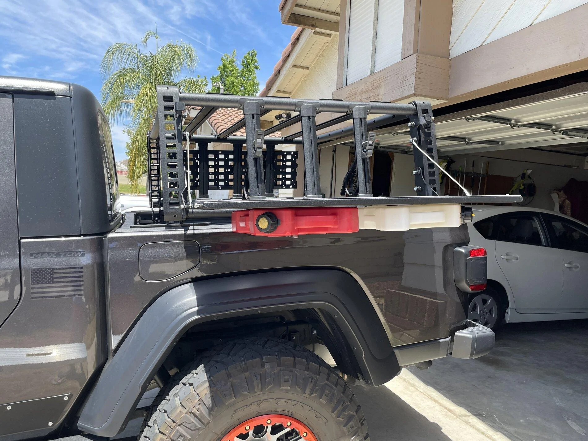

Installed. Instructions suck!! Have a friend before u install to hold the table while installing the bolts.
Jeep Gladiator Go Rhino Xtreme Overland Rack 90D0B872-FA82-4F88-A14D-BD41CA4CEE70
Despite the heartburn it does look good! I'm also glad the longer bolts worked out for you. BTW, someone else on this thread mentioned some touch up paint if you want to paint the bolts black. I used "Mopar 68060405AB Jeep Wrangler Black Hard Top Touch Up Paint" and it matched pretty well.

@Steak.Sauce are you able to use both lock latches on the table? I took one off because it had about an inch of separation and would not be able to lock.
Yeah I can use both of mine, I have to pull them in about a 1/4 to 1/2 inch to get it to latch, but then it stays tensioned.

Let us know what happens with GoRhino @Steak.Sauce. I did get both of mine to latch this am. I had to loosen the bolts from the bracket but left side is tight. I added red loctite to the left side mounting bracket bolt just in case.

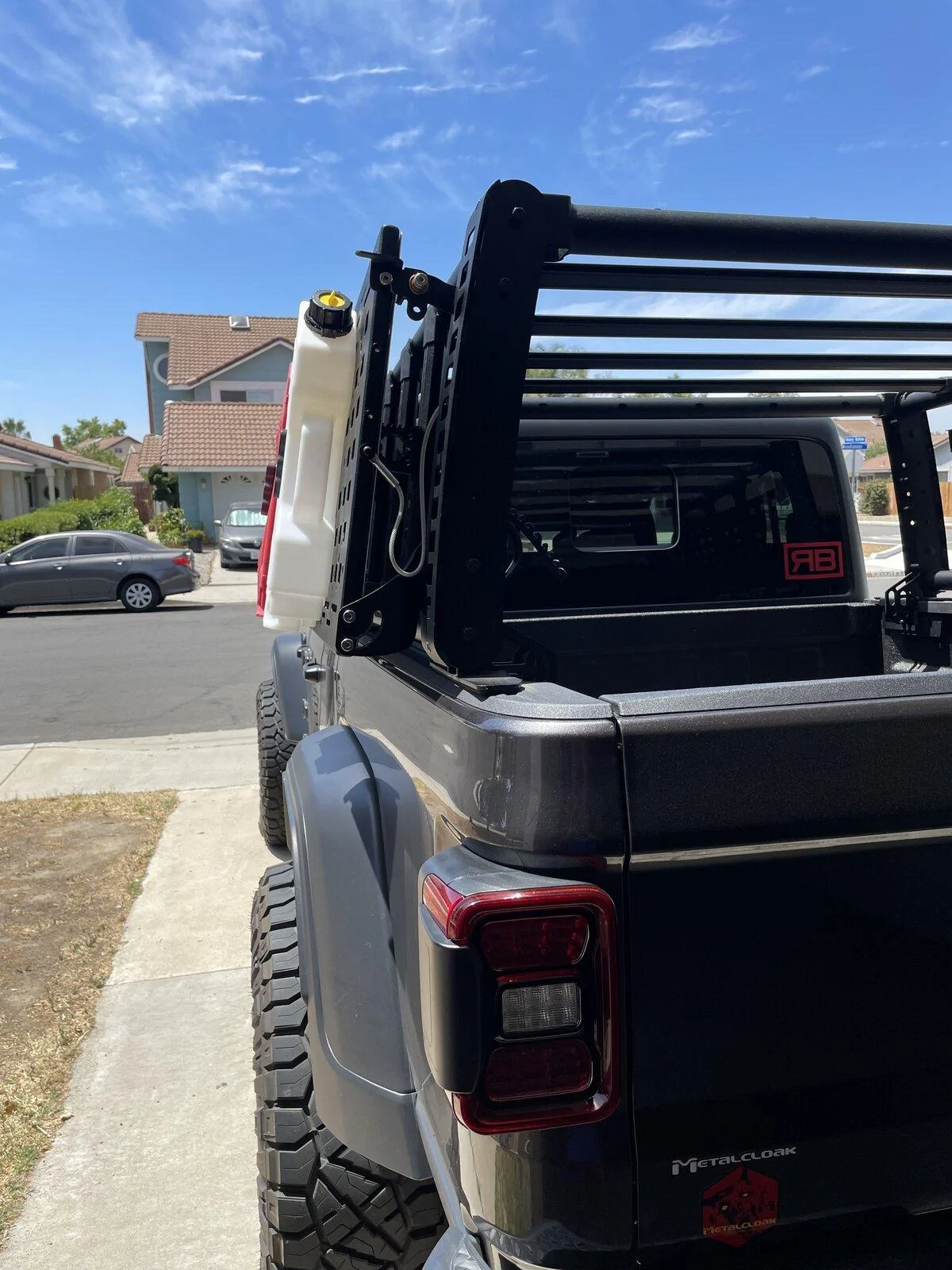

I’m very happy that I chose this rack. The others have only 2 bars on top which can be easily accessed… with my setup, nothing will fly away.
happy Camper… literally

-some Items came scratched or missed powder coat, but I expected that. Mopar hard top paint can help as it’s a very close match.
