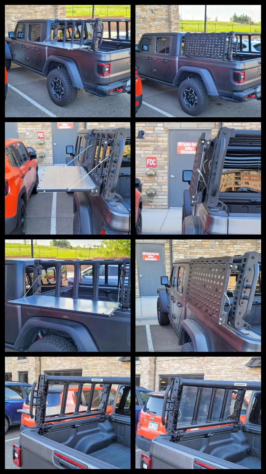

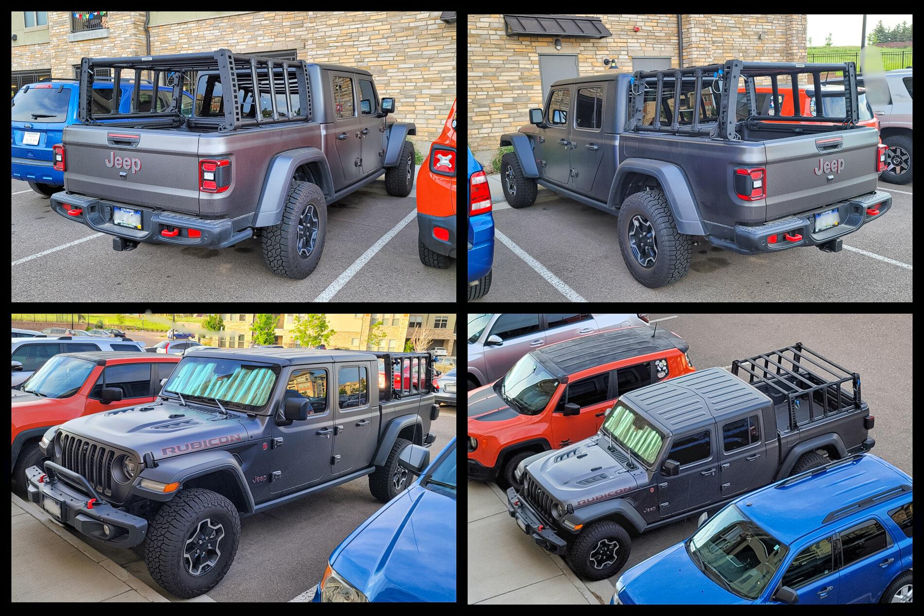

Finally got my rack mounted! I used the trail rail mounting method. It was a little bit of a pain but after loosening up all of the bolts (even more) I managed to get it to fit. I used a little bit of loctite on all of the table shoulder bolts to make sure they didn't back out.

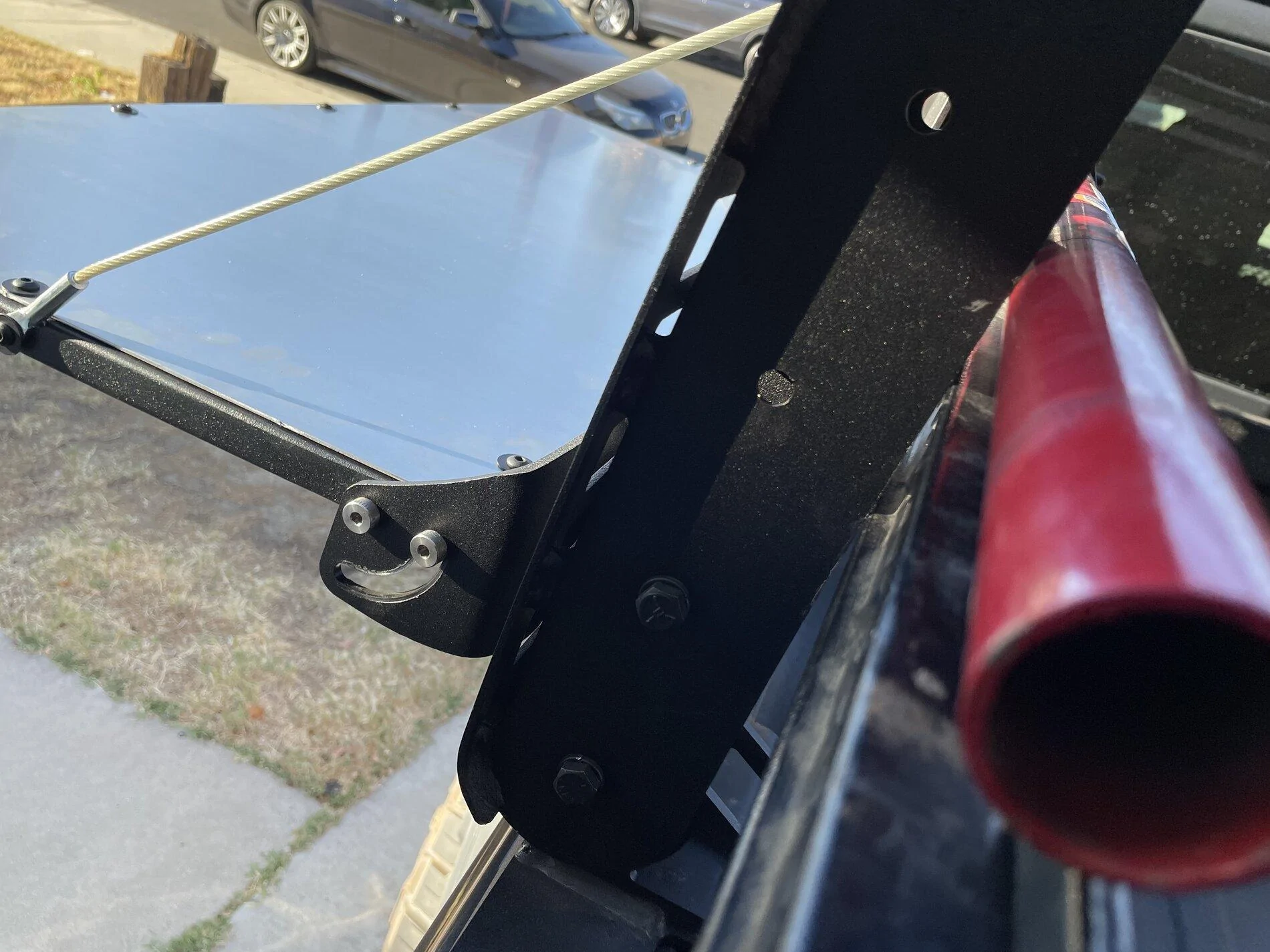

Getting the actual rack installed on the trail rail system was a bit of a pain. When you first set it on, the carriage bolts that are through a plate which is inserted into the trail rail barely poke through the rack's mounting feet; they also are coming up at a pretty extreme angle and not square. I had everything loose on the rack but I had to loosen it up even more and take out some of the upper secondary bolts which secure the mounting feet to the uprights (this way the mounting feet could be pivoted). My wife and I actually had to manhandle and push some of the mounting feet and uprights to get enough thread to at least get the nut onto the mounting bolts. There wasn't enough thread to put on the lock washer and washer. So I ended up just tightening down the nut enough so more threads were showing on the adjacent bolt. I was then able to put on the washer and lock washer, tighten that bolt down, and redo the first. I just repeated this process on all four mounting feet.
Also, I wasn't really a fan of how the mounting feet don't quite clear the plastic on the bed caps. They overlap by a little less than a quarter of an inch and while you're tightening down the carriage bolts it is bending and popping as it squishes the edge of the plastic.
My table went on without a problem despite the horrible instructions (I actually installed it a couple of times when the rack was not mounted to my vehicle, so I had practice). The latches line up, but one side is a bit tight. I will note that I put some of my own plastic washers on some of the shoulder bolts as the ones they send are flimsy at best.
I have a couple of rubberized weather resistant padlocks coming to help keep the latches closed on the table. My fear is if I hit a big bump or take it off-roading they may pop open in the table inadvertently opens.
I am thinking about putting another set of handles on the cab side of the bed to fill in some of the gap between the cab and the rack.

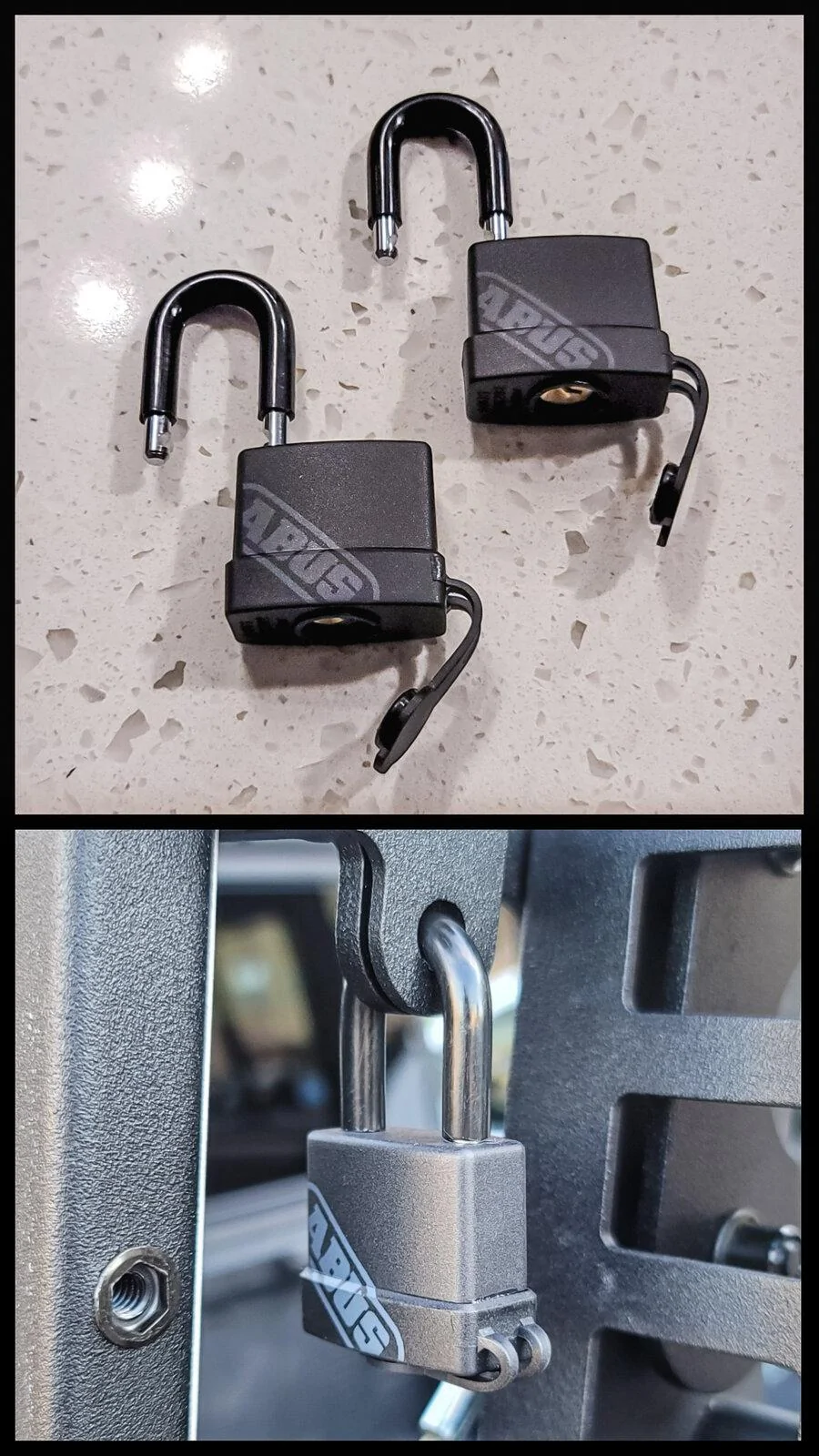

Just wanted to share a couple locks I got for the table system. Having something that was weather resistant and somewhat rubberized to keep noise low was part of my criteria. I found the "ABUS 70/35 KA Solid Brass Weatherproof Padlock Keyed Alike (Code - 6301), Black" locks on Amazon. The shackle fits perfectly within the latches on the table and the lock is not too large. So far so good.

@thekorky i see that u bought 2 locks. Does each lock come with each individual key? I prefer the same lock like boltlock and use 1 key to open all locks.
I ordered four of them last year and they were all keyed alike.

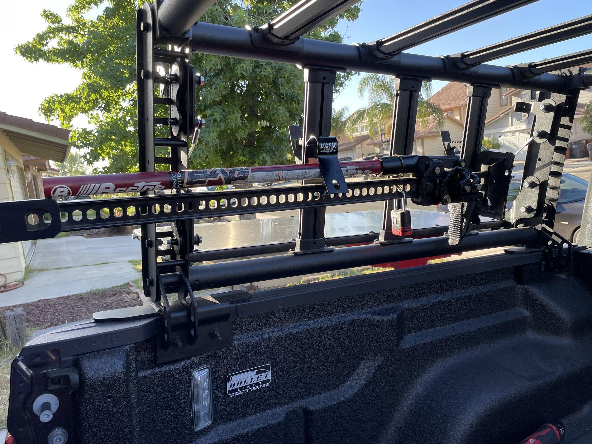

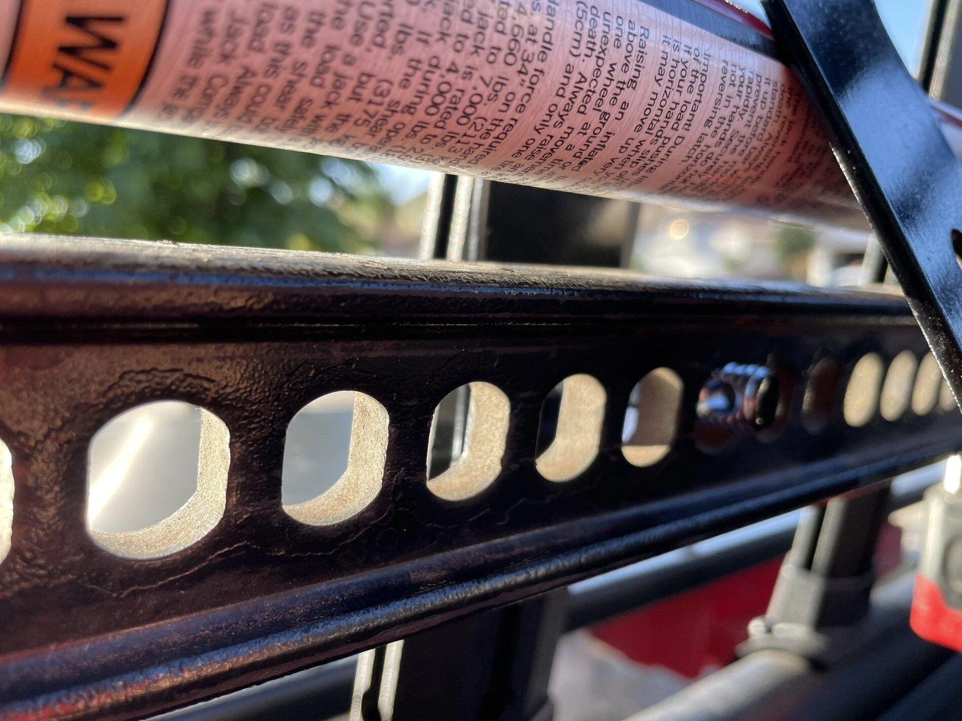

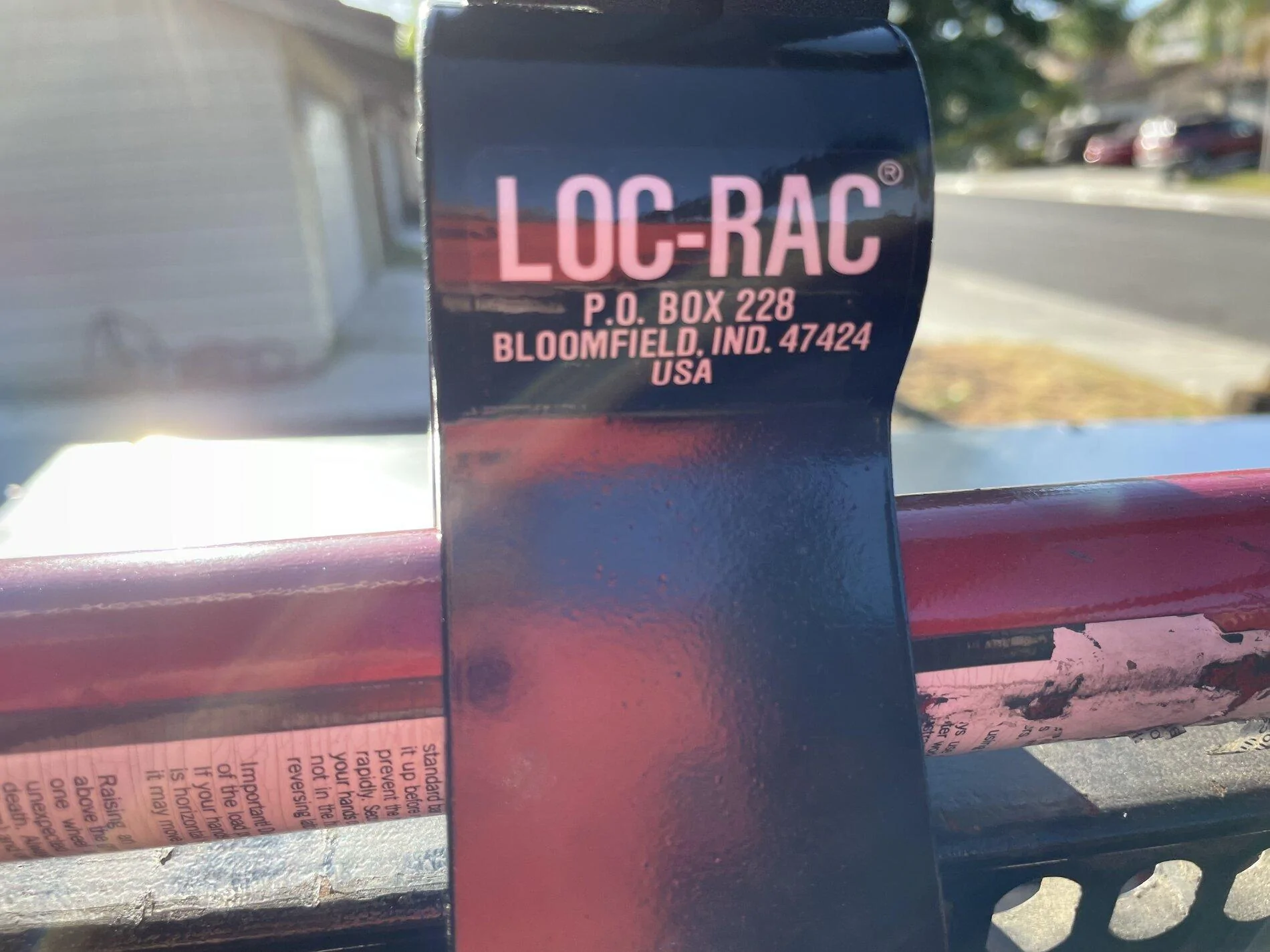

So… remember when I asked GoRhino for a recommendation of a hi lift jack mount to mount INSIDE of the rack??
well… I couldn’t get it to mount because the bar was hitting the GoRhino vertical upright.
This is their recommendation!!! Now I can’t return the product because it’s used. Be giving GoRhino a call. Let’s see what they have to say for themselves.

The only way to mount it is outside the rack which defeats whole setup as I will be adding a storage box or 2 on the outside.
