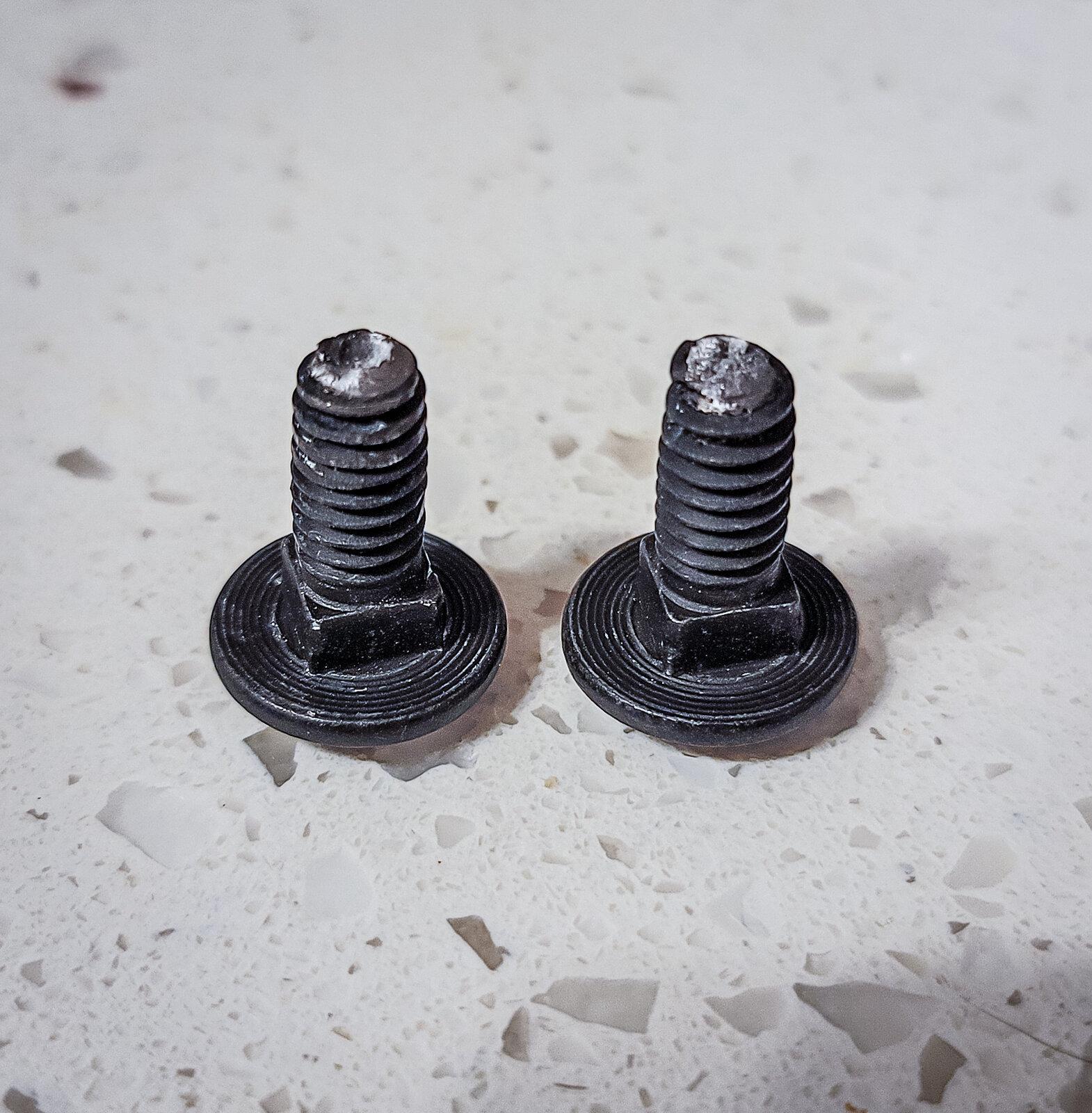

After 2 weeks of driving around with the rack installed I decided to do an inspection and see if any bolts needed to be tightened or if anything had backed out. To my surprise I discovered two of the carriage bolts attaching the rack feet to my bed rail had broken. I haven't really been doing any aggressive driving or off-roading and none of the carriage bolts were crazy tight. My best guess is they aren't a very good quality metal and/or the angle the bolts have to be positioned in during install (while getting the rack to seat on the bed rails) put stress on them... I suggest keeping an eye on them. I did manage to stop by Lowes and find some new carriage bolts that were the right size.

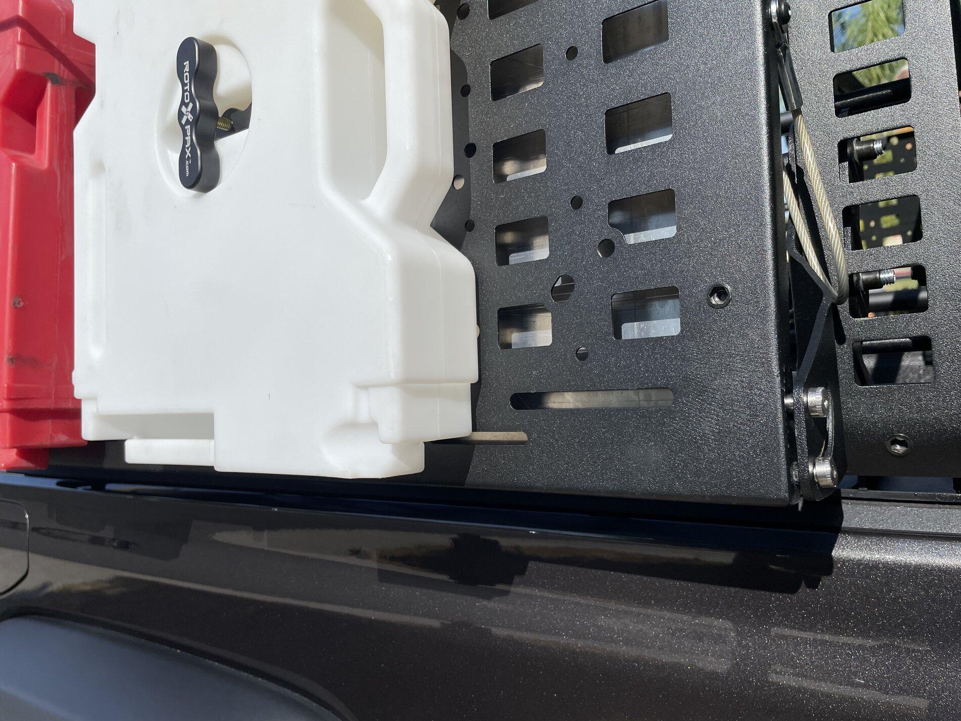

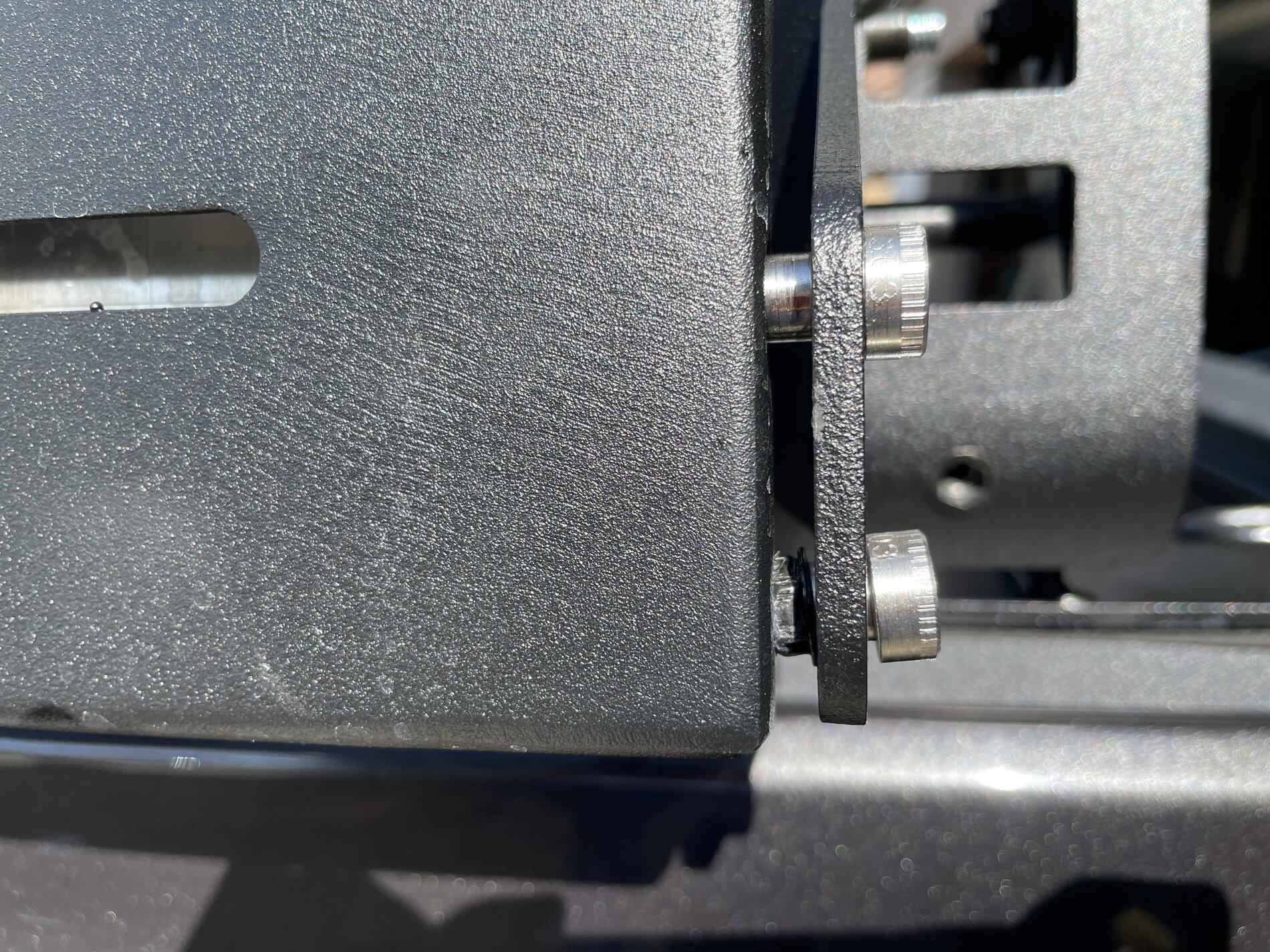

-fold down table… again, they need a technical writer as it doesn’t state to remove already installed bolts. The supplied hardware is unusable so purchase some replacements (8 2” bolts need to be 2.5”). The cable needed to be drilled for some users… mine came out good.The locking mechanism is off a bit, but I managed to make it work (loosen bracket bolts).

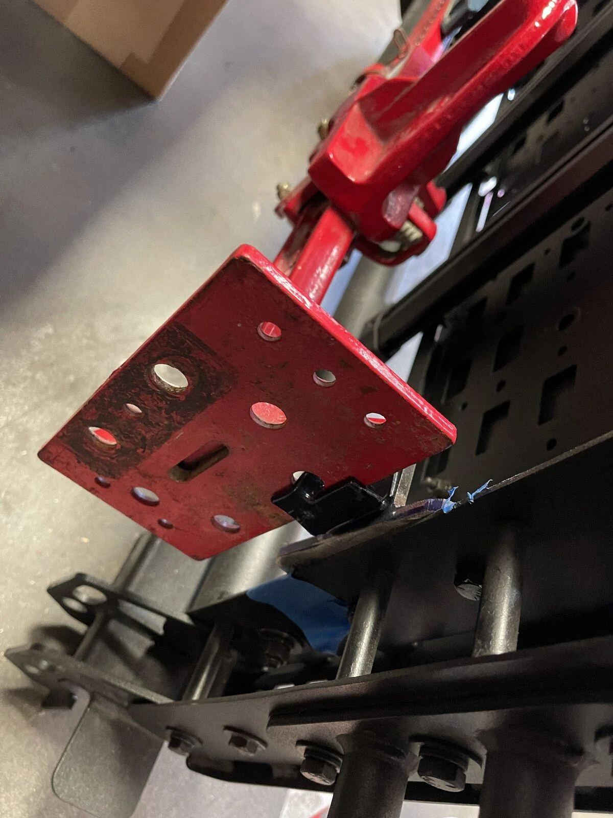

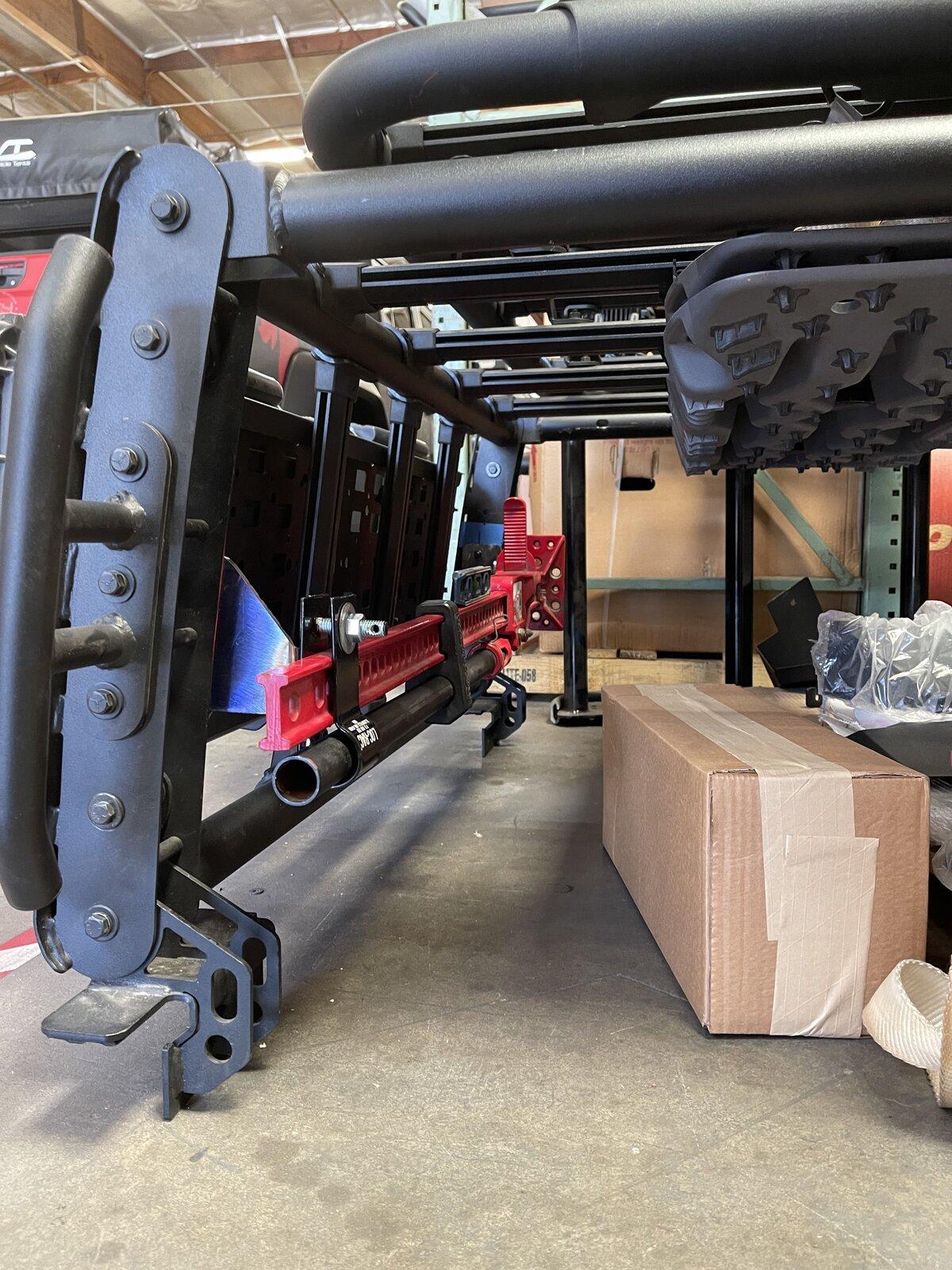

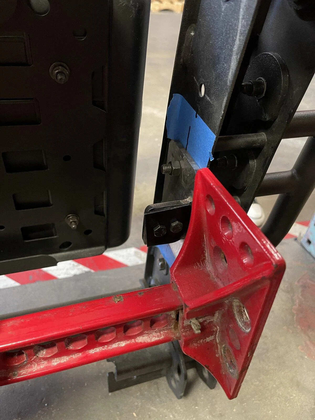

So… the hi lift jack bracket only works on one side. The drivers side. Unfortunately my drivers side has the table. I will have to remove it next week as I will make arrangements for them to fix my table (broken rivnut). Thanks GoRhino for your help in getting me a bracket but my setup is incompatible.
anyways, there’s another issue. My rack has the mounting holes for light accessories. No wonder they took it out of production. I was able to get the bolt in, but im unable to secure it with a bolt as the hole is too small. I may mount it to the pillar bracket’s rivnut but I’ll see what I can do on Monday. I really want to mount it on top.
