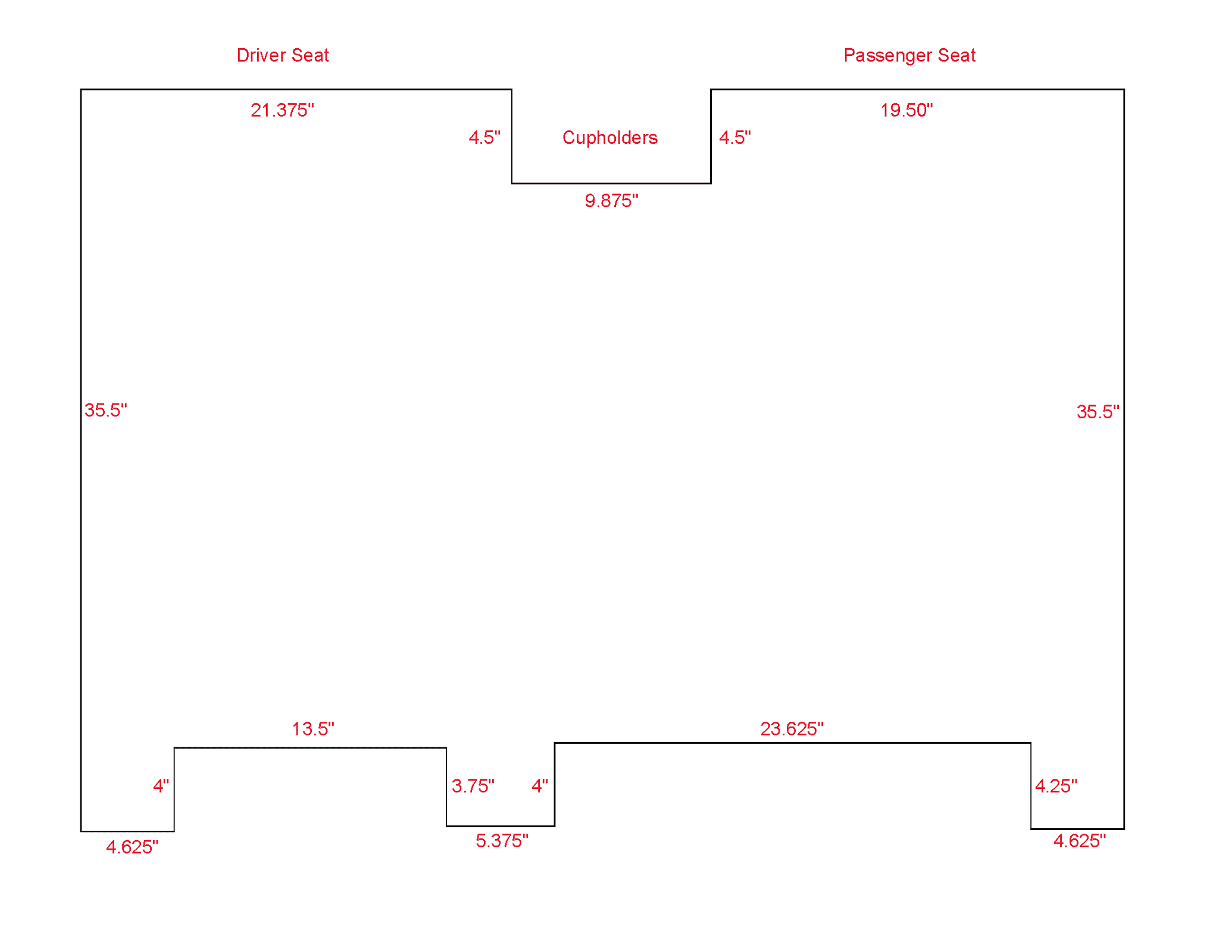

Awesome. Is there side pieces for allowing storage under it?
I suck at "crafts" but to save $1000 I am gonna try.
3/4" Ply wood or ???
Jim
Don’t use 3/4 plywood. What Goose Gear and I use (I was the one with the template a couple of years ago) is 1/2” Baltic Birch plywood. In normal 1/2” plywood you’ll have either 3 or 4 plies. In Baltic Birch plywood you’ll get 7 or 8 thin layers that provide incredible strength but at the same time is lightweight. You’ll have to go to a cabinet supply place to buy it and it comes in a 5x5 sheet.
Agreed. Baltic birch is the shizzy!!!
