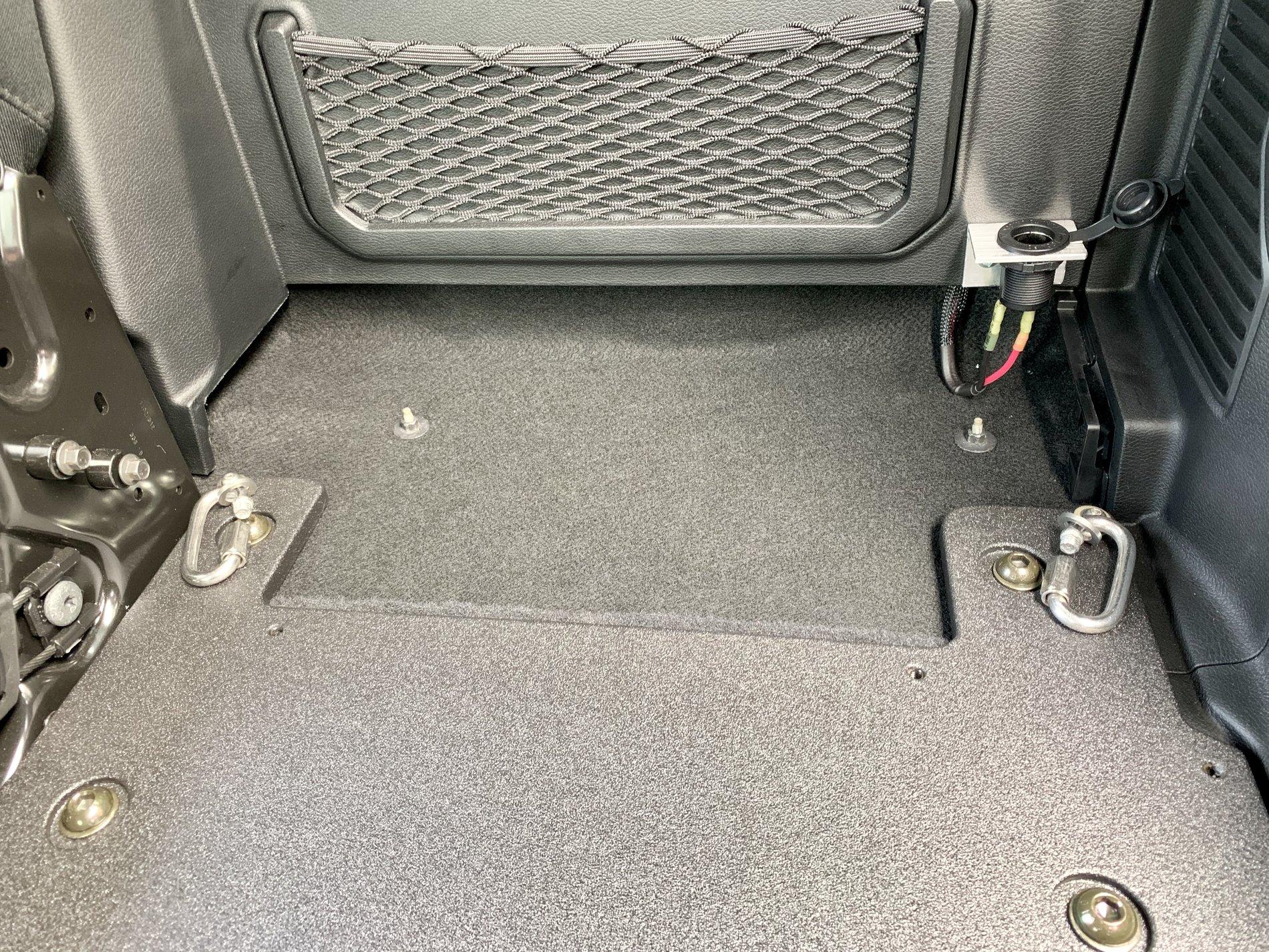

My seat delete platform. I could not justify the price for GG. I think mine turned out just as good with more access to the space under the platform. Also removed the plastic storage compartment on the drivers side for an additional 6" of space. Whole thing is covered in paint on bed liner.

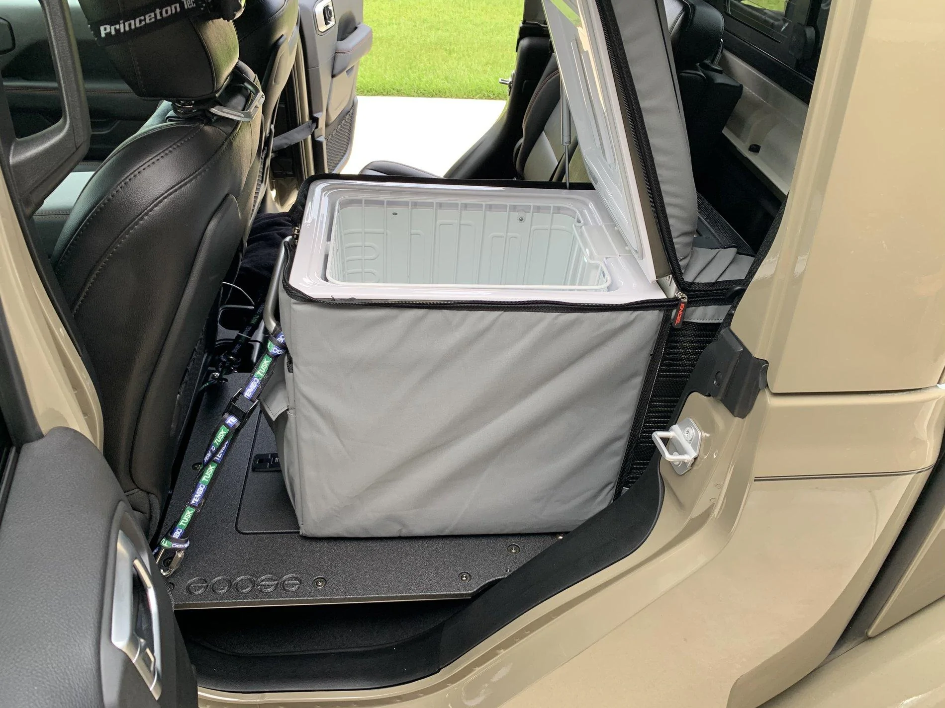

Engel MT45 fridge fits with the 40% delete from Goose Gear.

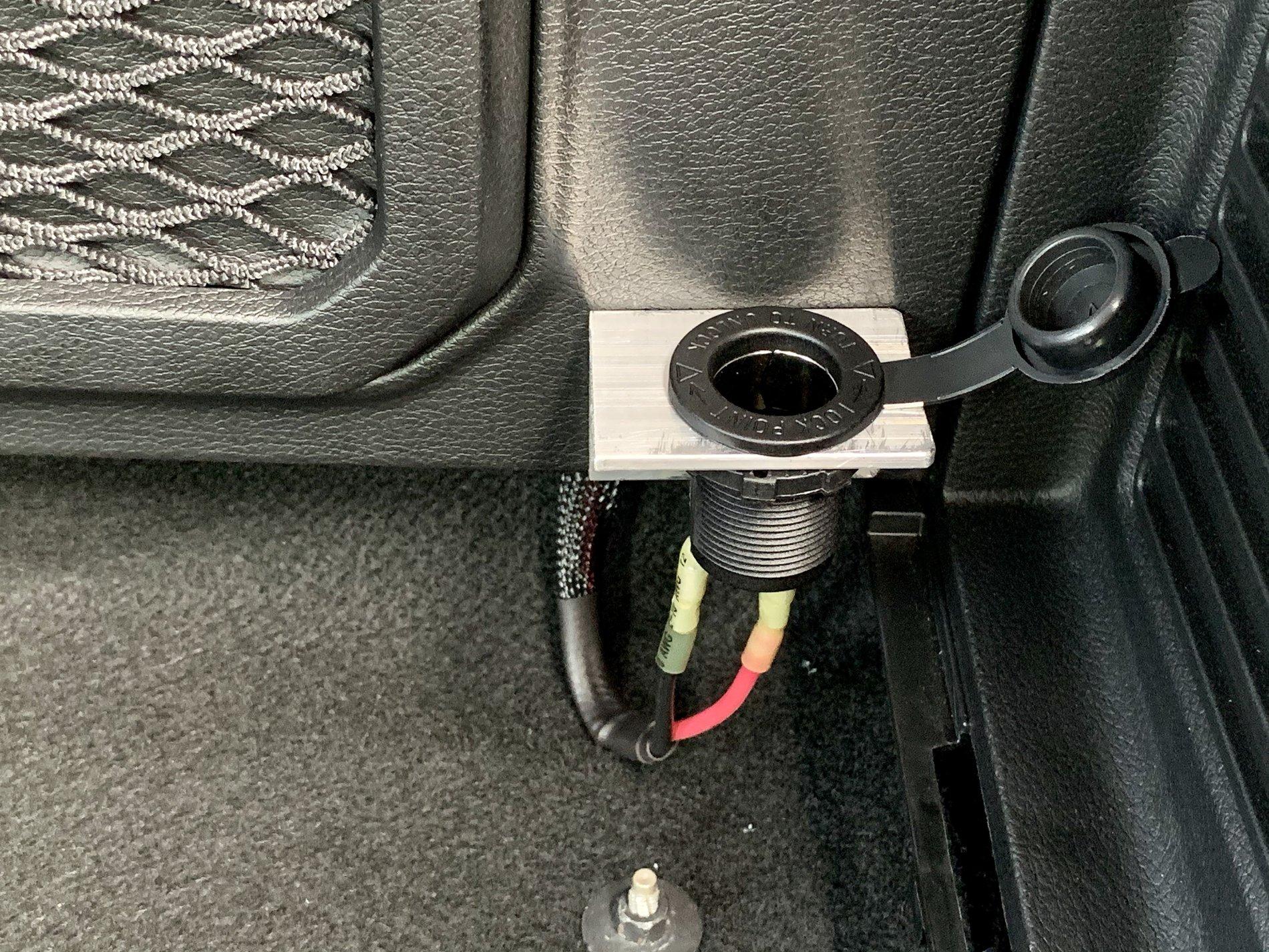

How are you powering your fridge? In the center console? I'm eager to do the exact same set up as you.

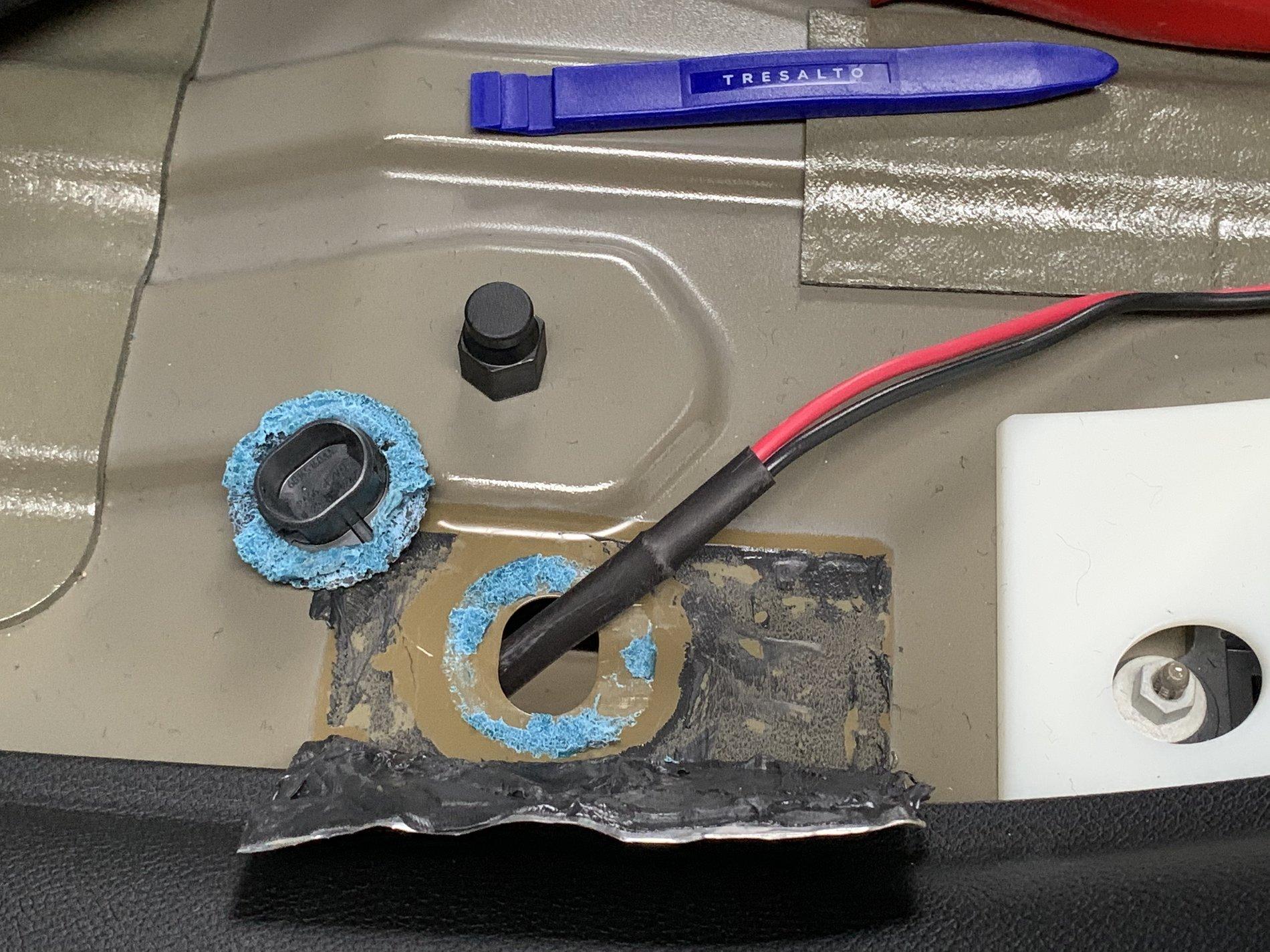

Nope. Ran a dedicate 12v power port just for the fridge, independent of the OEM wiring. 12ga fused at the battery.

My contribution to the diy solution. I originally planned to cut out a piece of the driver's side panel to access the bolt storage solution as you can see by the outline on the wood before coating it but ultimately decided to just relocate that storage box somewhere else. I also have the non-subwoofer rear so slightly different layout of the tray thats normally under the seat.
