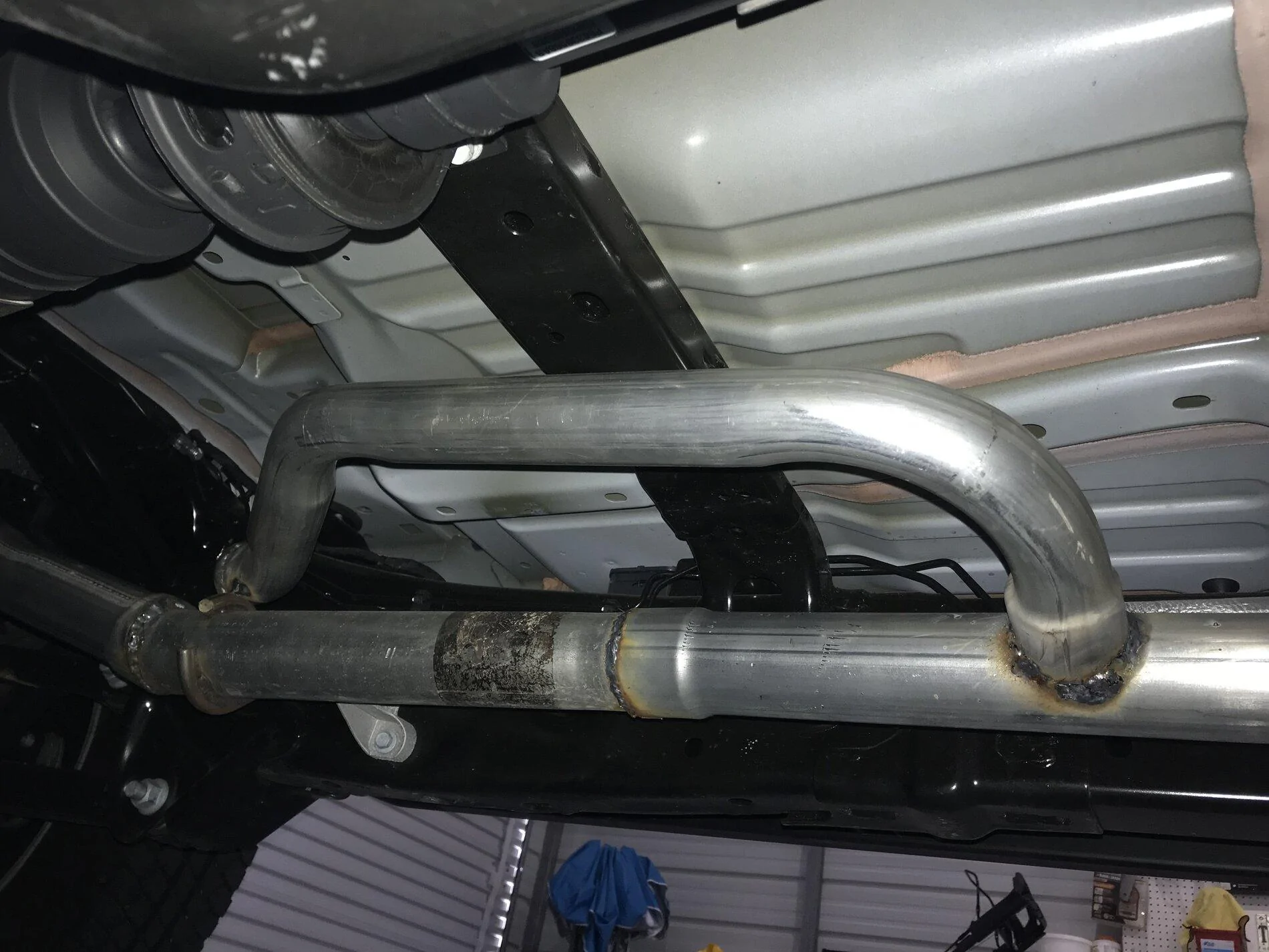

Most systems have a resonance point. I believe both of ours had max drone around 2100 rpm. Thus the 32 inch j pipe. I will try and get a pic of my j pipe. It is mostly above the actual exhaust pipe.

We kinda bent it around to rest on the exhaust pipe for support. Looks a little strange but works very good. Length is the important piece of the equation and not really shape.
