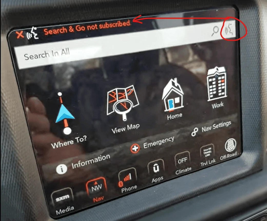

"All"
Not one other Gladiator on the lot had Uconnect Search & Go.
It requires a subscription.
Can you show me yours working so I can show the dealership here.
There's nothing at Jeep.com, the owners manual or on the internet about it.
