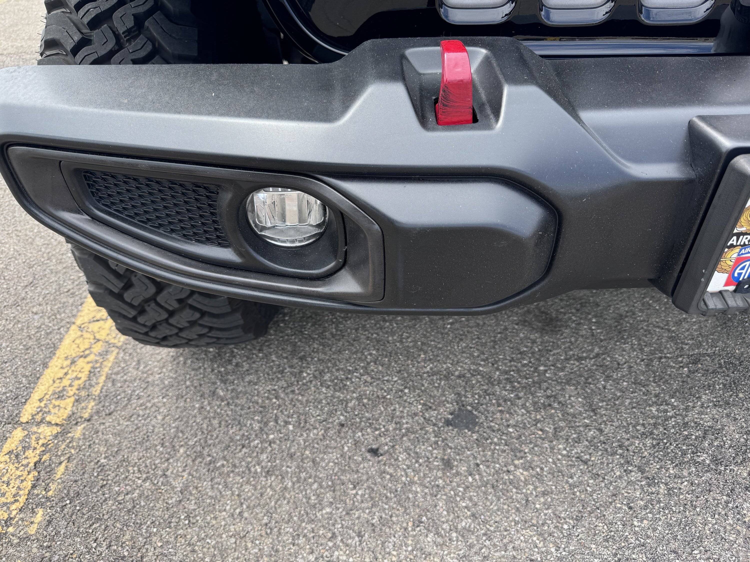

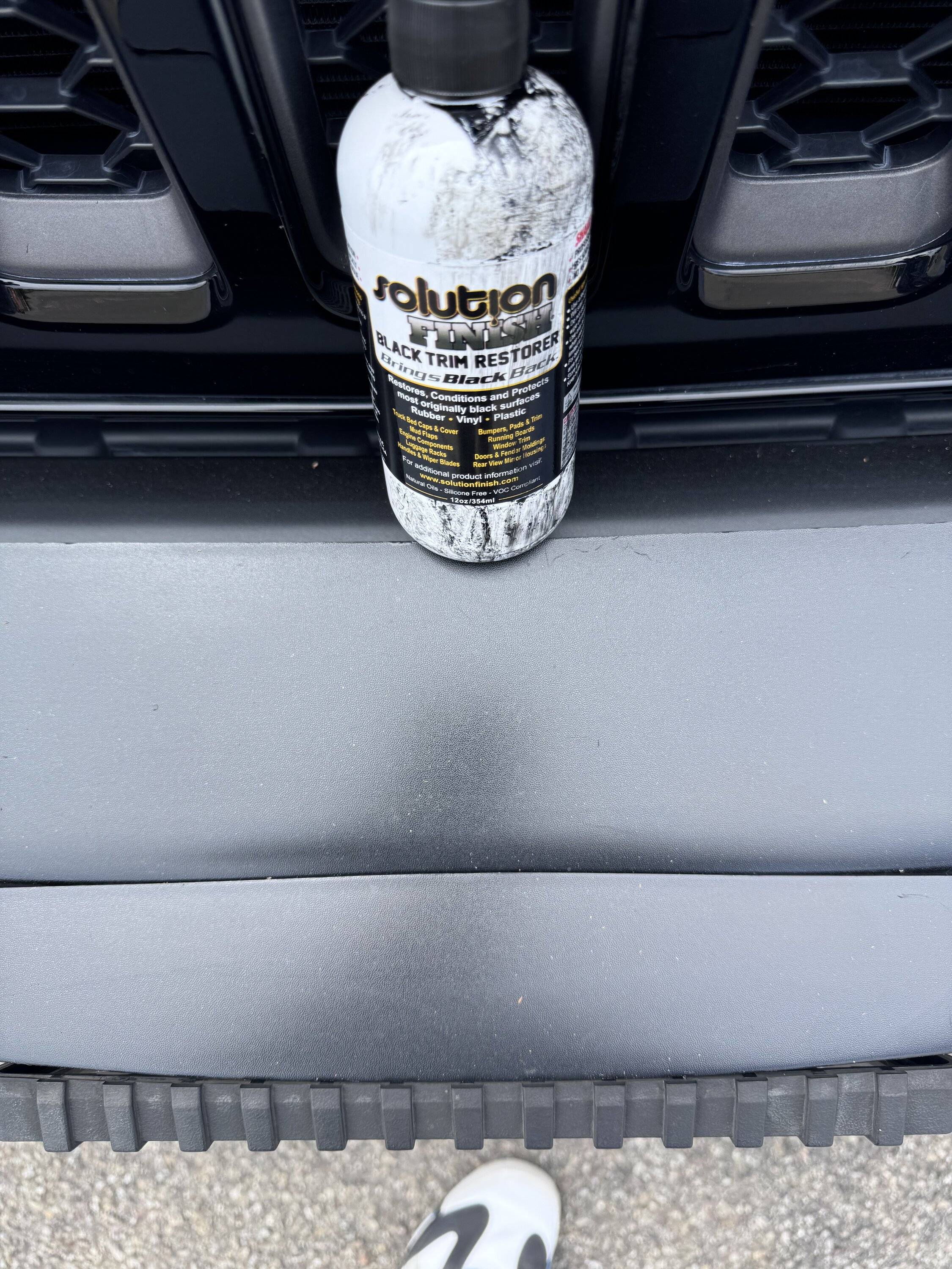

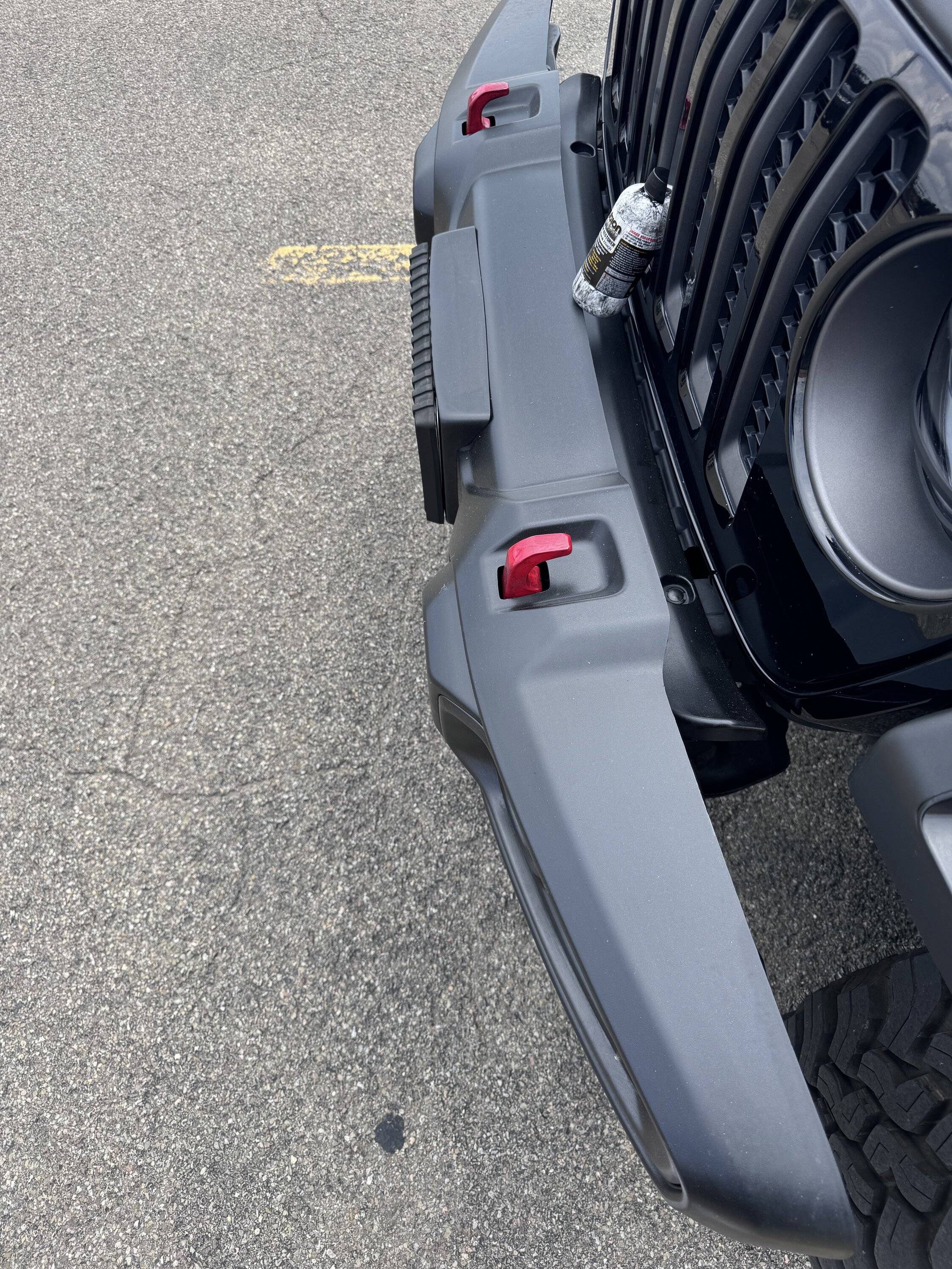

Had some of this stuff leftover from when I owned my KL so I figured let’s see what happens.
(steel bumper eventually, this will hold me a while lol)
Product is called solution finish
https://a.co/d/0d3vpSLQ is what I used
So far that bottle has done my KL twice, and the JT once, plus the bumper you see in the pics.
black bumper, no painting and this far has survived 6 automatic car washes.
1000% wear rubber gloves, and apply with a tire sponge. Shake well and wipe excess off after 30 mins. Let dry for 5-6 hours before driving.
Jeep Gladiator Grey bumper no more! IMG_0290
Jeep Gladiator Grey bumper no more! IMG_0289
Jeep Gladiator Grey bumper no more! IMG_0288
