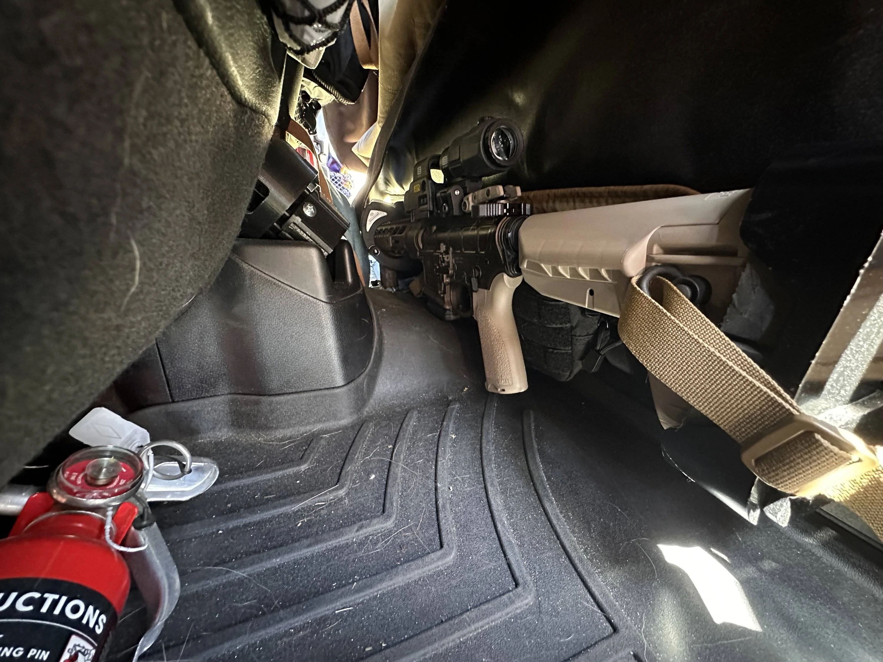

The @813 Fabrication & Design basket’s molle squares fit Grey Man Tactical’s baking plates. I added some plastic to cover adjacent holes making it impossible to get a tool into the basket to unscrew the butt cup and Santa Cruz lock. The seats lock to the basket, so you’d have to use serious tools to destroy the seat and/or basket. The wiring for the lock is run under the ArmorLite flooring. The electronic release is in the center console where it too can be locked. The key hole (not a handcuff key) to manually open the lock faces down. It’s accessible but would be really difficult to pick upside down and blind. The truck is wide enough for an AR with a can on it. I’m not sure about really long guns, like a sporting clays shotgun.
