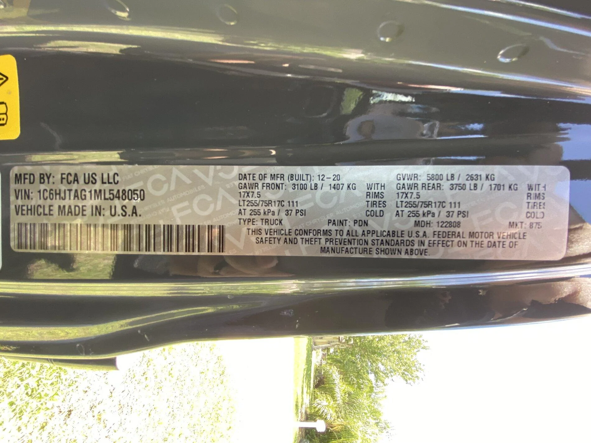

Not trying to out engineer Jeep. My understanding of payload was GVWR less curb weight. Thank you for pointing out this is not correct. I don’t see payload on my door jam sticker and that’s the number I’m trying to determine. My understanding was that it was 5800-4650=1150. You’re saying it’s not that simple. Do you think it could be the 1700 listed on the spec sheet? That is a substantial difference. I’m not comfortable going with that payload rating unless it’s confirmed.
Payload number is on the door frame sticker. Towing capacity is not.
You can look for payload on the stick - mine is something just under 1,100 pounds as I recall.
I've done the math using truck weight differences compared to some of the other versions of the JT and it always comes out off by a fair amount.
What your sticker says is your payload based on the FACTORY CURB WEIGHT. Now if you put on a steel bumper, skid plates, anything that adds weight to the truck, you need to subtract that. So if you have bed rail system - subtract that. Steel rear bumper - subtract that, from your factory curb weight.

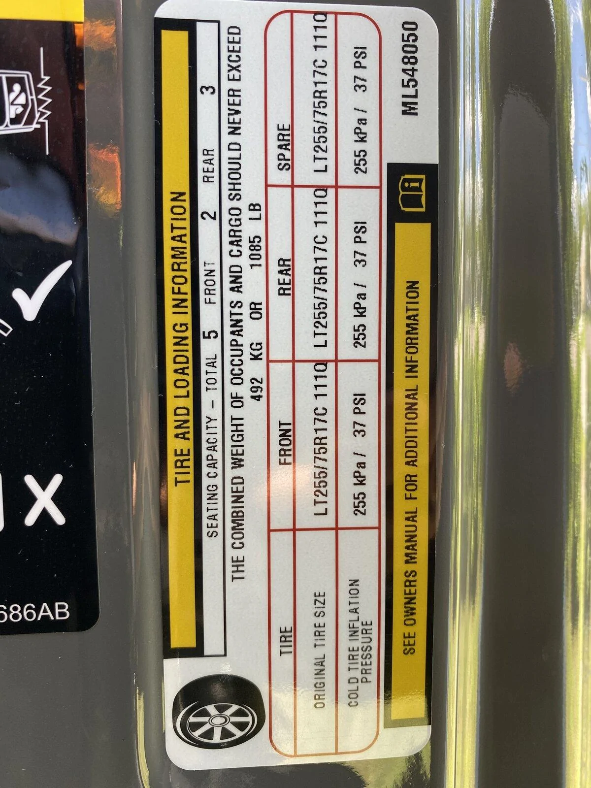

Can you point out to me which number is payload? I don’t see it.
Jeep Gladiator GVWR 3E533D1E-82C4-4ADA-A462-F2DD394FDED4
FloridaJT6MT
Rick
Apr 6, 2021
827
2,152
Port Charlotte, Florida
2021 Gladiator Sport Willys
Found it on the other sticker. Thank you. I knew it couldn’t be 1700.

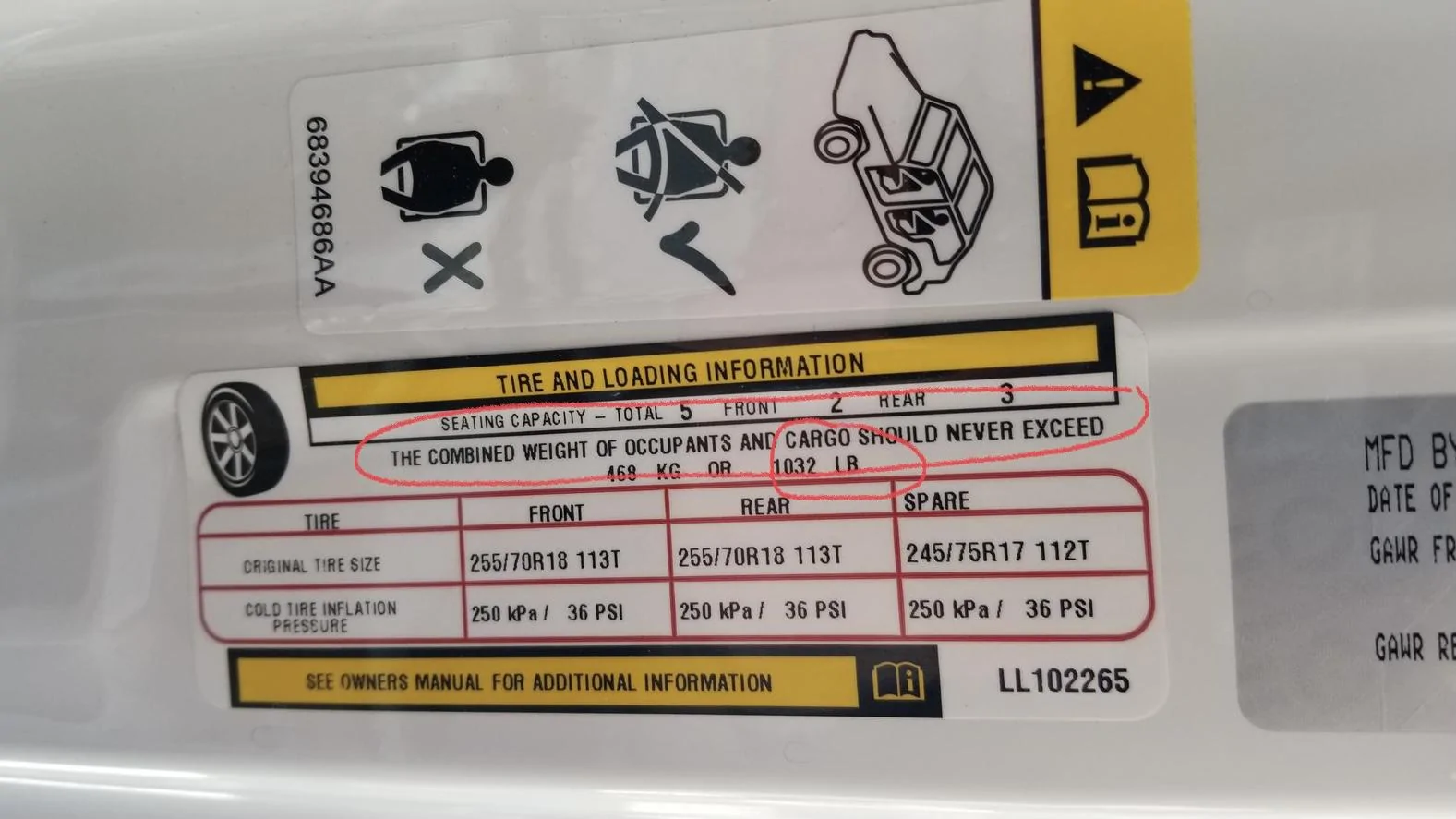

It is on the white (with orange top bar) door sticker, across the top listed as, Tire and Loading Info…. See photo below cargo and passenger weight (circled in Red):
Thanks. If I had to guess I’m thinking the base sport 6MT has the 1700 payload.

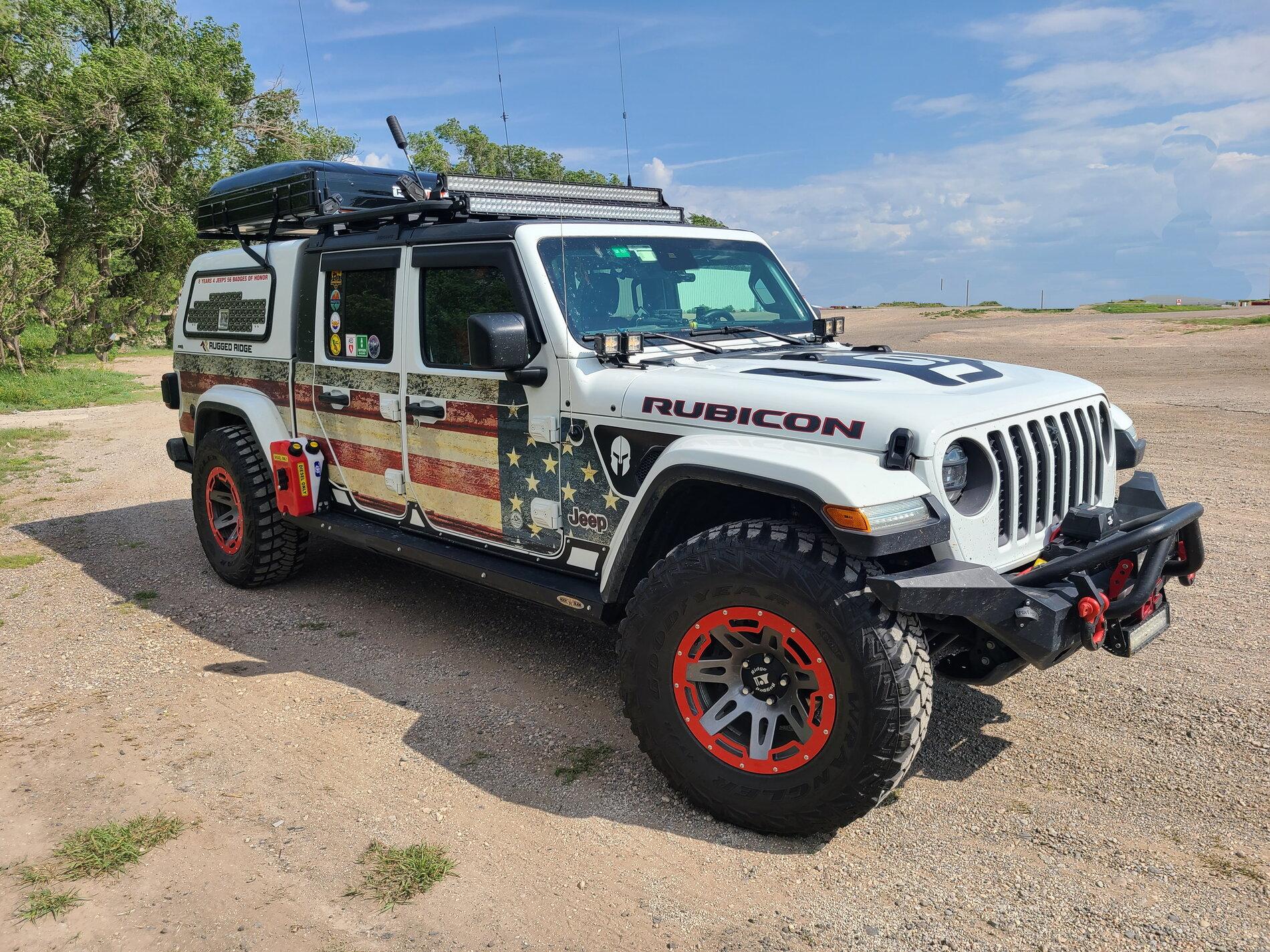

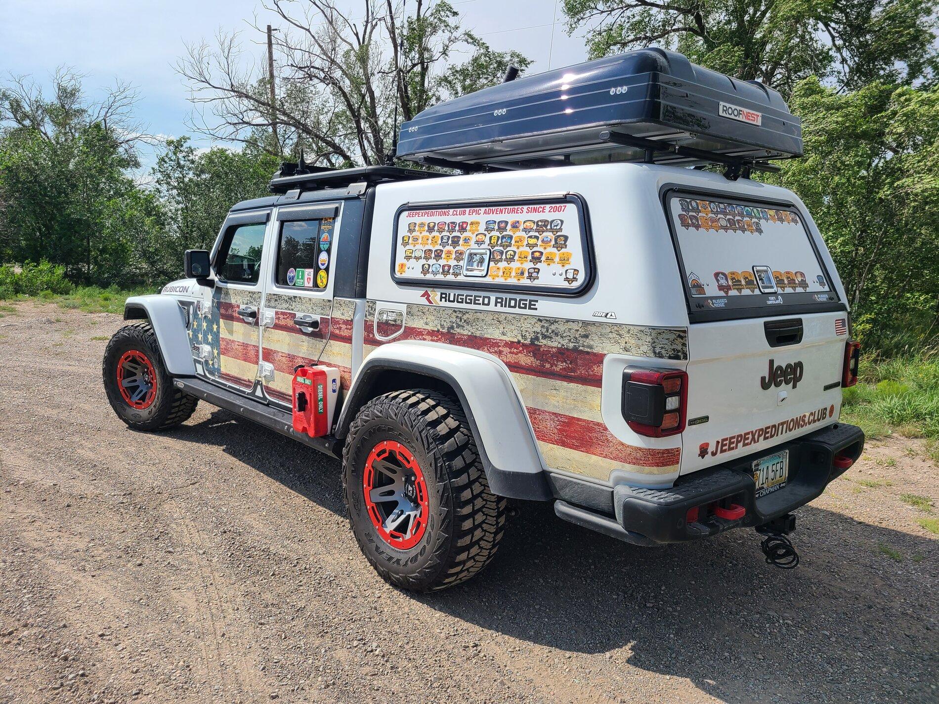

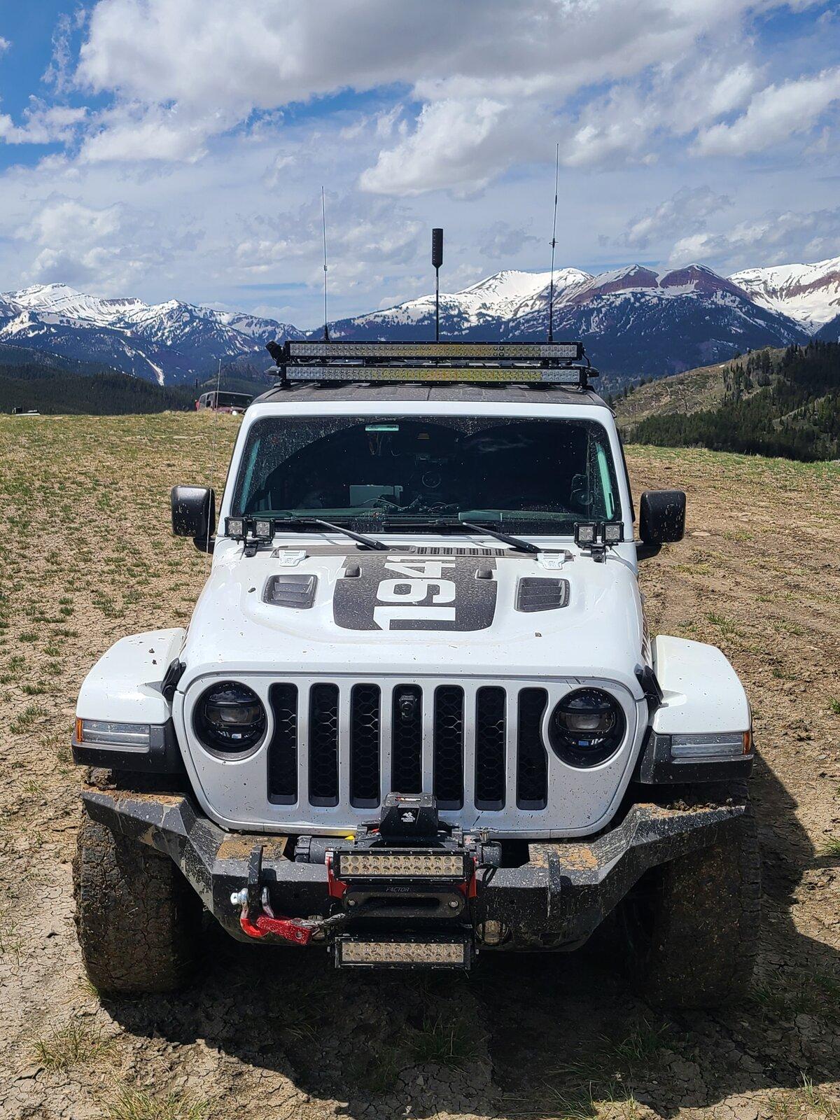

2021 JTR diesel. 35's, topper, roof top tent, full bed slide, loaded for extended overland trip with supplies for 2 weeks it weighs in at 7580 on the CAT scales at the Flying J.
I think the 1st 2 pics were taken in NM, the last was at the top/end of Monument Ridge Badge of Honor trail in WY.

Yes, like almost 2,000 lbs overloaded. It is surprising how many people think GVWR and Cargo limits are only guidelines, or they do not understand cargo is passengers and accessories you add to the vehicle, not just the stuff you put into the truck bed. Once this guy gets into an accident and his insurance company refuses to pay off, because he exceed his vehicl’s max weight rating he might figure it out…

The GVWR on my 2021 EcoDiesel Rubicon is 6450 so that puts you 1,130 lbs. over. Nothing shocking that I have not seen before on other builds. "E" rated tires, improvements on springs, shocks, add airbags, steering, and sway bar will improve your driving dynamics. I believe the weak link is the suspension to give these vehicles articulation and a comfortable ride. The axles are rated at around 4,000 lbs. each, and they have a buffer, so you are not over stressing these axles.
If you keep the center of gravity in the middle and most of the weight low, it should still drive well and be very safe down the road. No, you can't swerve or stop as quickly to miss something without noticing the added weight so drive accordingly. If it feels unsafe to drive then it is.
