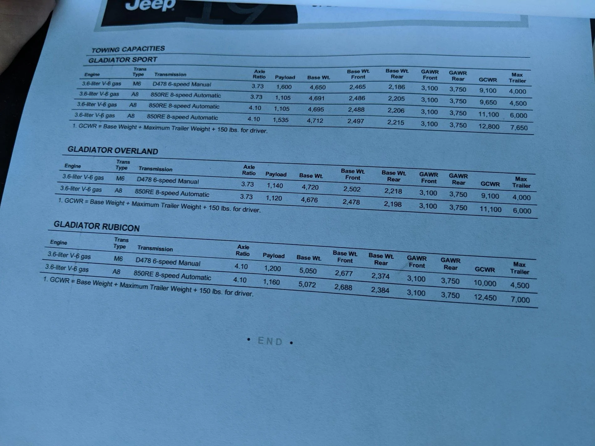

I've seen auto Rubicon JT's on the lot with GVWR of 6250.
Are manuals likely to have a different GVWR? (I know towing capacity is less, but what about GVWR?)

is there any difference between the sport base and sport s in manual transmission? that table only lists sport

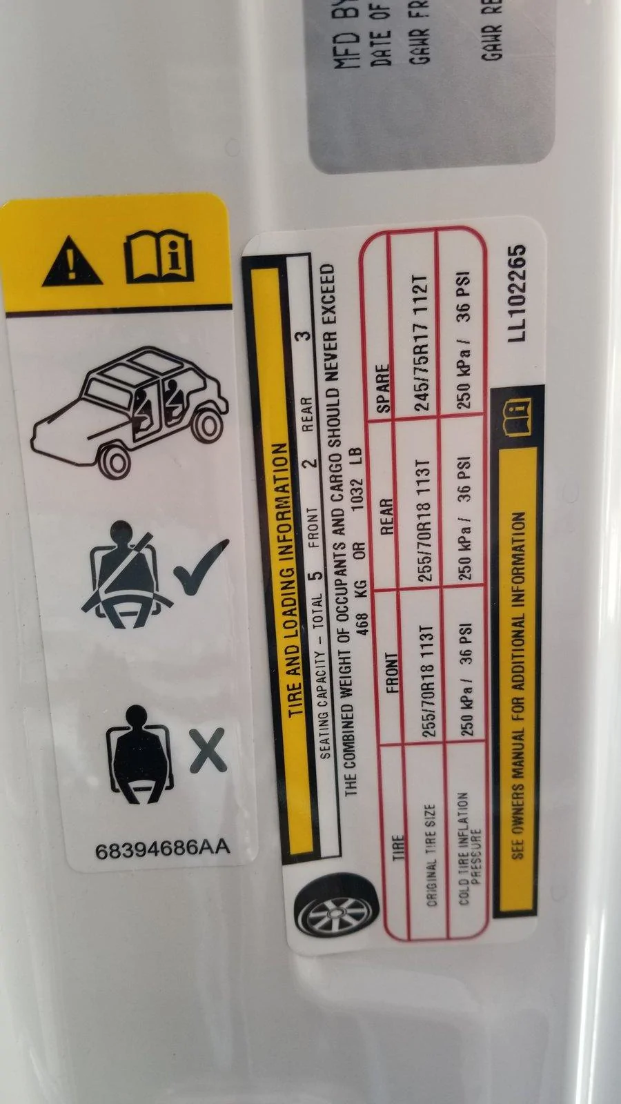

This is from my Overland. It came equipped with every option except for the tonneau cover, which the dealer added.
Jeep Gladiator GVWR 20190825_151455
Jeep Gladiator GVWR 20190825_151451

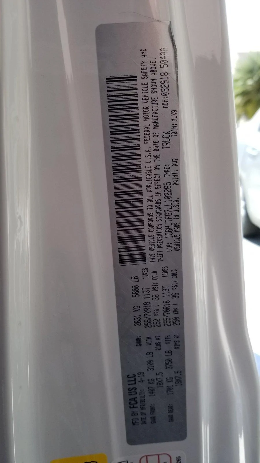

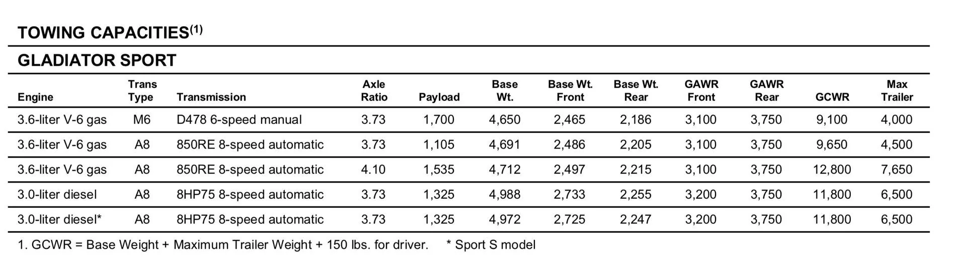

I’m trying to figure this out. I have a Willys Sport. The GVWR per my door tag is 5800. Curb weight is 4650, I have the 6MT. So my payload is 1150. However, I pulled this same spec sheet updated for 2021 Gladiators. I’m assuming the sport models they are referencing here must be max tows. But can you get max tow in a manual? It’s says the payload is 1700 for a sport 6MT. That means the GVWR would be 6350. Would someone help me with this math? ?

Each model of the Gladiator has a different max weight rating, depending on the suspension and axles used. Auto vs manual tranny changes the max tow rating, but not cargo. Your door sticker shows the ratings for your truck, and this is what you use to determine your max cargo, which includes any passengers or gear onboard (plus any non factory extra options that you add). I read somewhere that a 200 lbs allowance for the driver is factored into the cargo rating on the door sticker. GCWR (GVWR) less actual vehicle weight equals your cargo capacity, including driver, passengers, truck cargo and tongue weight of a trailer (if connected).

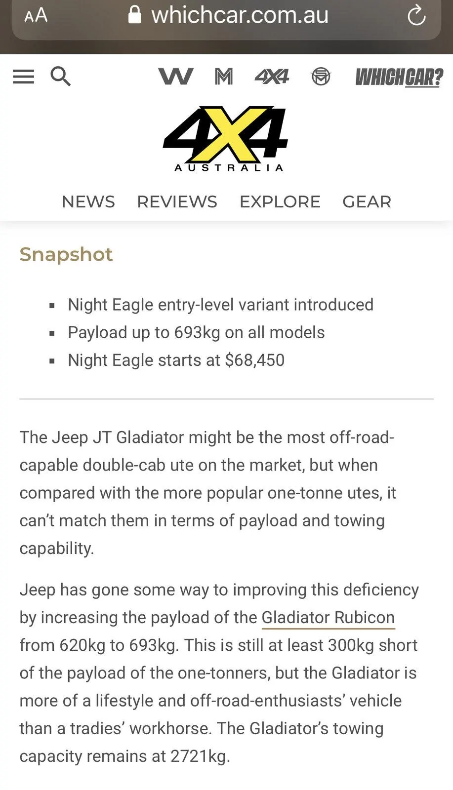

Spot on. It’s rated based on requirements here in the US.
It’s why my WJ had a higher tow rating in Europe and why I’ve read the payload of a JT in Australia is higher than here in the states.
1,500lbs in Australia.

Not trying to out engineer Jeep. My understanding of payload was GVWR less curb weight. Thank you for pointing out this is not correct. I don’t see payload on my door jam sticker and that’s the number I’m trying to determine. My understanding was that it was 5800-4650=1150. You’re saying it’s not that simple. Do you think it could be the 1700 listed on the spec sheet? That is a substantial difference. I’m not comfortable going with that payload rating unless it’s confirmed.

Thanks for the info. It’s clear to me that my model’s towing capacity is 4000. I’m trying to confirm payload.
