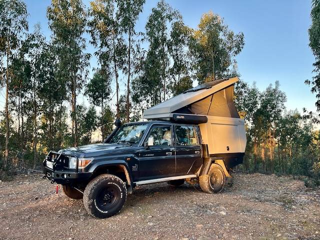

I'm actually not sure, whether this is just the "American way of seeing things" – it feels wrong to have to buy a MASSIVELY bigger rig, just to get a reasonable payload. It just should not be necessary. Our LC79 isn't any bigger than the Wrangler, okay, it can't be used it for rock crawling, but it still has a payload more than twice as high. And when I look around, the only "compact" truck that through the lineup has decent payload here in the US seems to be the Ford Ranger.
The LC79 pretty good offroad and drives reasonable on-road. The picture below is with one spring leaf still out and with all fluids just filled and my wife inside the camper, so max load on the rear. Would I do rock crawling or difficult trails with this? No, but I don't have to. We enjoy camping off the beaten path and away from people and traveling in areas where there aren't (m)any paved roads, not extreme off-roading.
