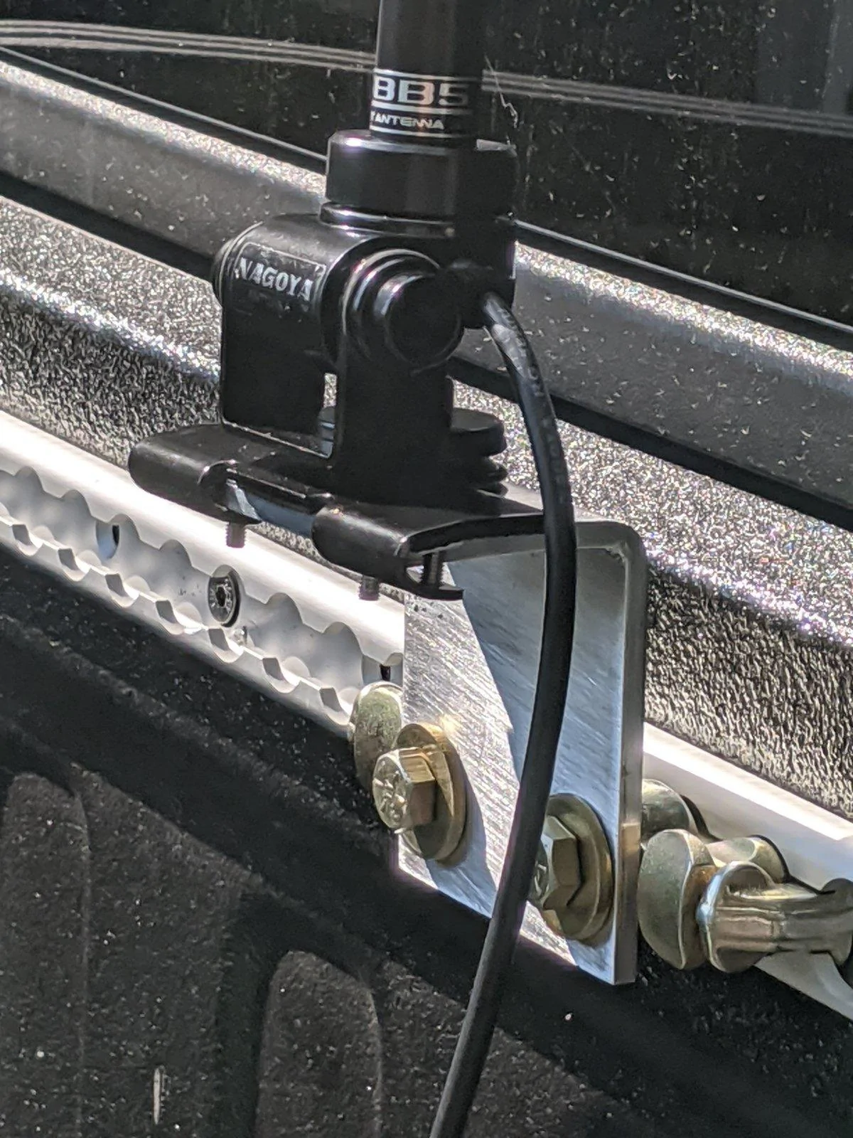

So I got a magnetic antenna for my other cars yesterday. Decided to test on the JT just to see. There was absolutly nowhere it would work, lol. With no roof, and the hood and my diamondback HD being aluminum there was no usable surface at all. Getting one mounted on here is going to be interesting, that is for sure

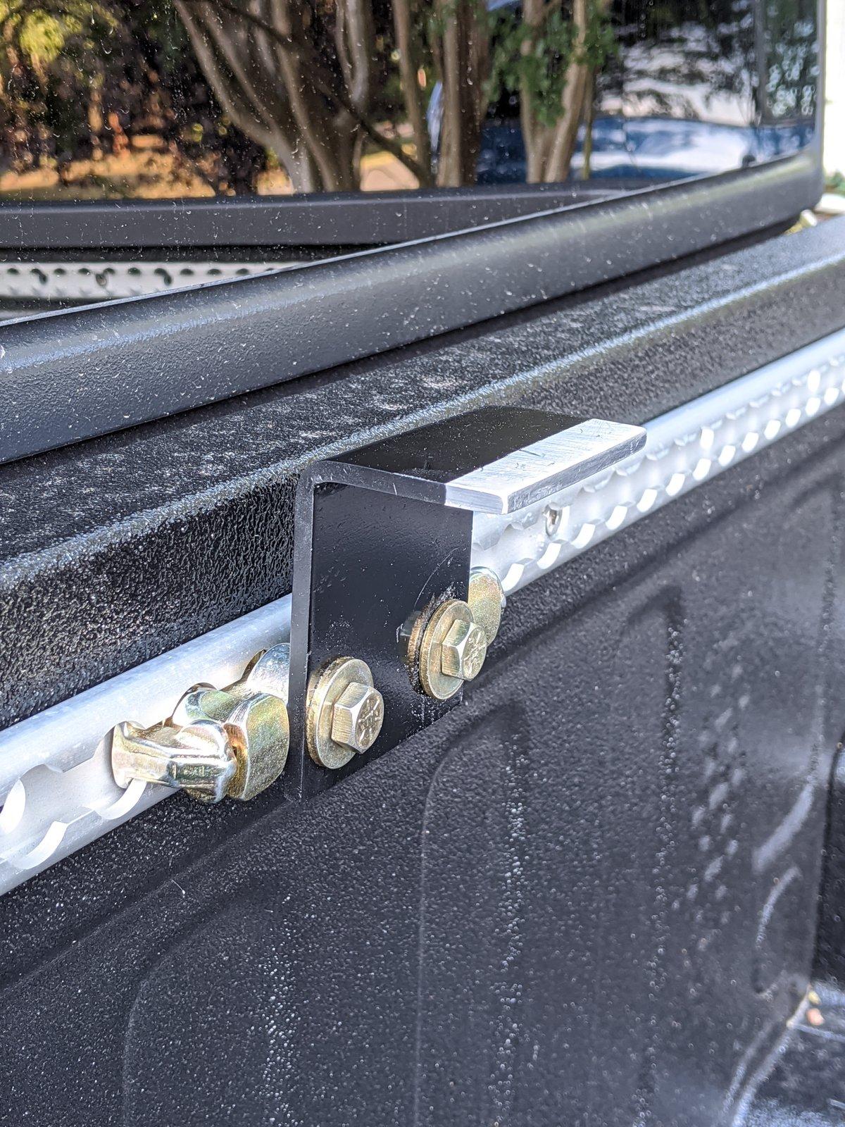

I fabricated this mount and went with a lip mount antenna. I will post pictures of the full install once I get a couple of more things finished up on it.
Jeep Gladiator Ham radio install antennamount (1)
Jeep Gladiator Ham radio install IMG_20200718_164434antenna

Is that a custom rail system you did as well? Your setup is cool but gets me thinking how I could pull something off on mine. Got the diamondback HD cover installed full time.

The rail is L-track from mytee products then I bought some l-track connectors that have the bolt in them. The problem I ran into with them was that they wobbled in the track to much so I drilled and tapped a smaller diameter hole ( 1/4 x 20) all the way through the connector where the bolt goes and bought 1/4 x 20 x 1/2 set screw to go in the hole that took the play out of the connectors. Then I bent a 3/16 inch piece of aluminum in the shape you see in the picture. Taped it off and painted it. Things I will change in the future are I will get a wider piece of aluminum as only 2 of the lip mount screws are able to be used with the narrower aluminum.

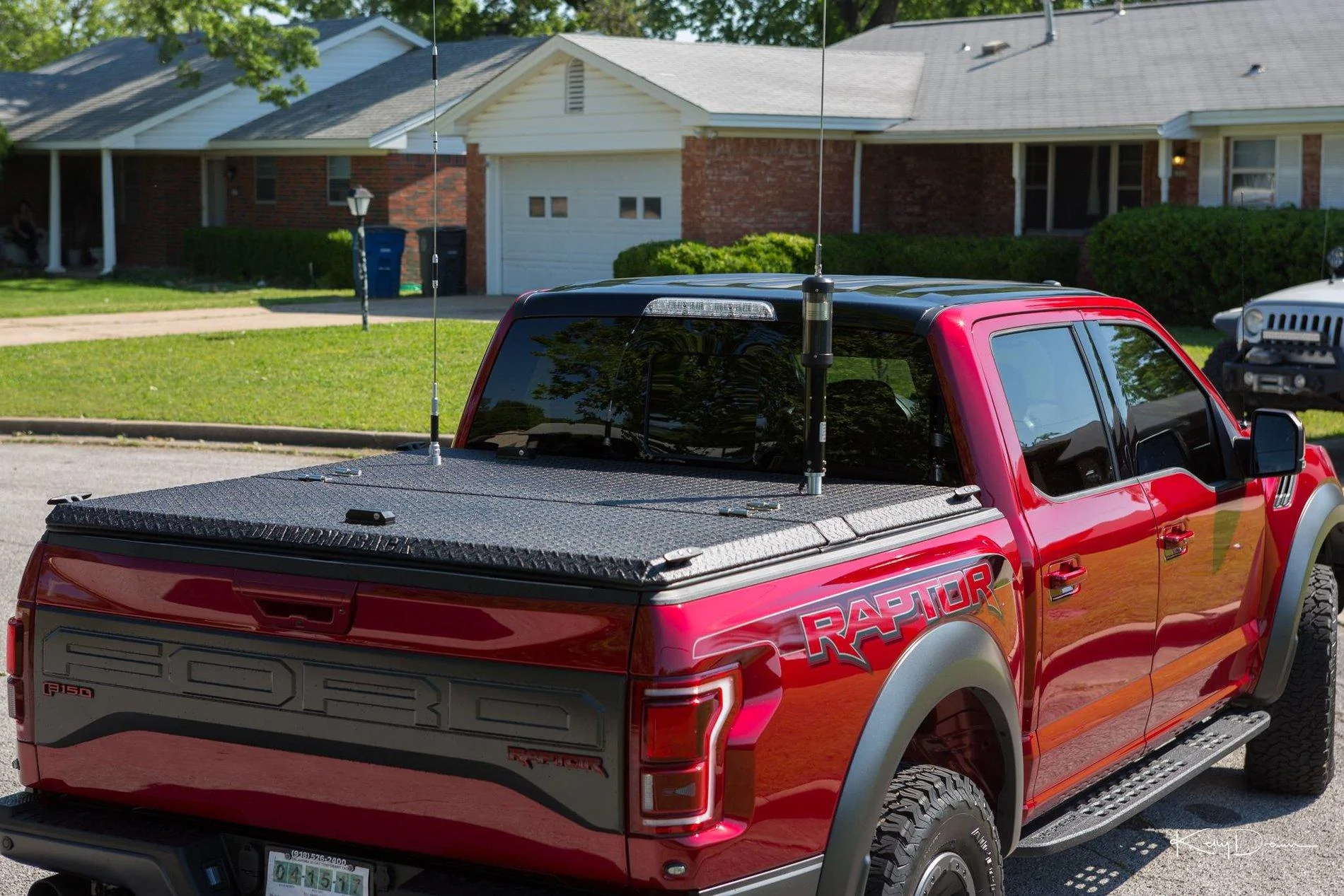

They're telling me that my Diamondback cover has shipped so I'm hoping that I'll receive it by this weekend and I can start working on it. For a reference, you can see how I had my HF screwdriver antenna and my UHF/VHF antennas mounted on my Diamondback cover on my new Raptor here. This worked exceptionally well.
Jeep Gladiator Ham radio install 18319011_10212063394355858_1727261597832357267_o (2)

Nice setup. Have you considered inserting a spring at the base of the antennas? If the screwdriver gets whacked it makes a pretty big lever and could mangle the tonneau.

I did in fact whack it once but it was my fault. I backed into the garage and forgot to remove the antennas. lol. The motorized mount was about 1/2 inch below cab height when all the way down. My JK in the background also had a screwdriver antenna mounted in the same fashion where when down it was a tad below roof height. I was just careful. I don't know that you could put a spring under the screwdriver as it's fairly heavy and bulky, and the stinger is 6 feet long. I had reinforced it with a larger plate under the mount which I no longer have so I may have to find another. The HD version of the Diamond back is thicker metal than the non-HD version. For that very reason, I ordered the HD version for the Gladiator. If you have non-HD version, you'll probably have to reinforce the mounts a bit.

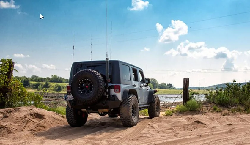

For another reference, I had a custom mount made on the rear tire carrier on that JK and ran the longer mast screwdriver antenna from there. There are two UHF/VHF antennas on the back in addition to the HF, one for my main radio and I was also running APRS positioning. The front was a 102" whip I had on the CB, but could connect that back to the radio on HF side through a tuner and run 6 meters from it nicely. I had an overhead AB to switch antennas between radios. The Gladiator will have some similar setups and I can use what I've learned from previous setups to do it better. (Hopefully)
I'll post pics up once I get a little further along on the JT.
