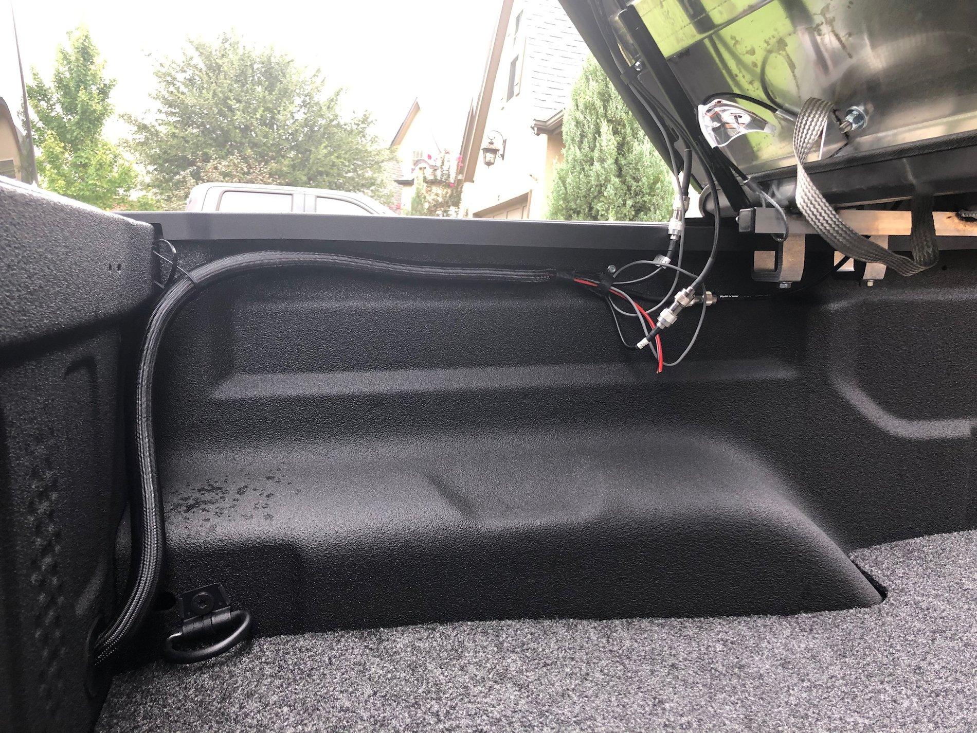

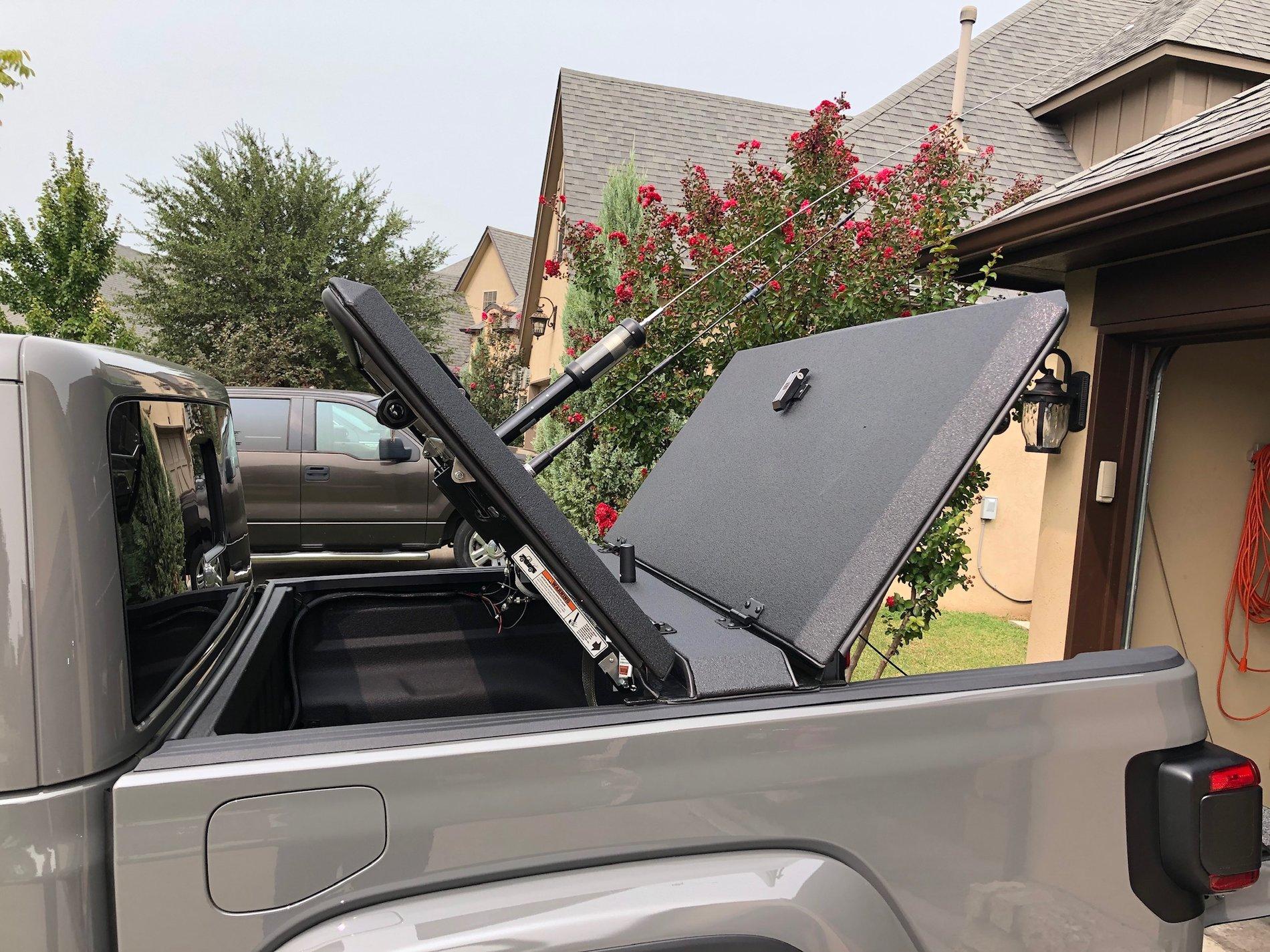

Just a couple more pics as an update. My radio is an ICOM 7000 which I absolutely love. Best detached display on any radio I've ever seen. I'm really going to be sad when that one quits working.

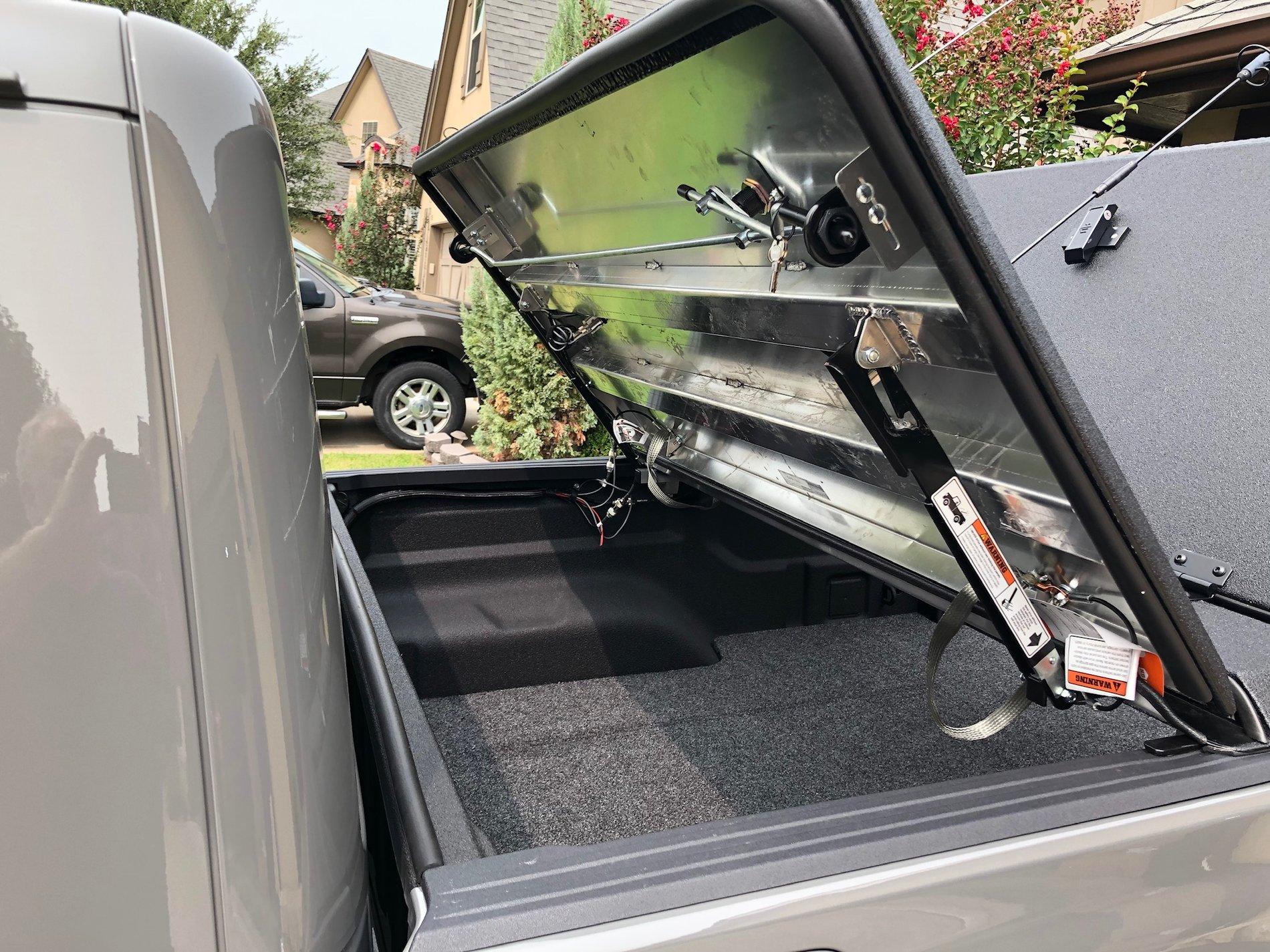

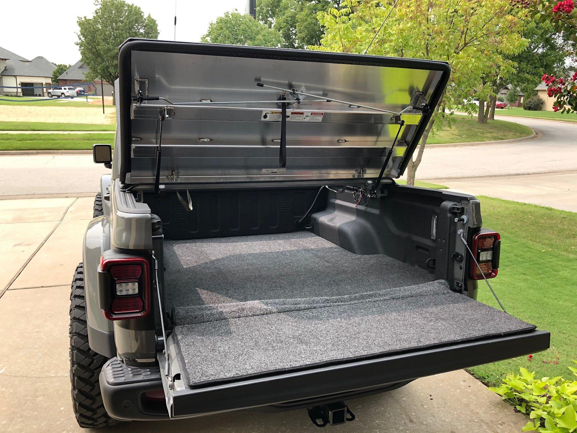

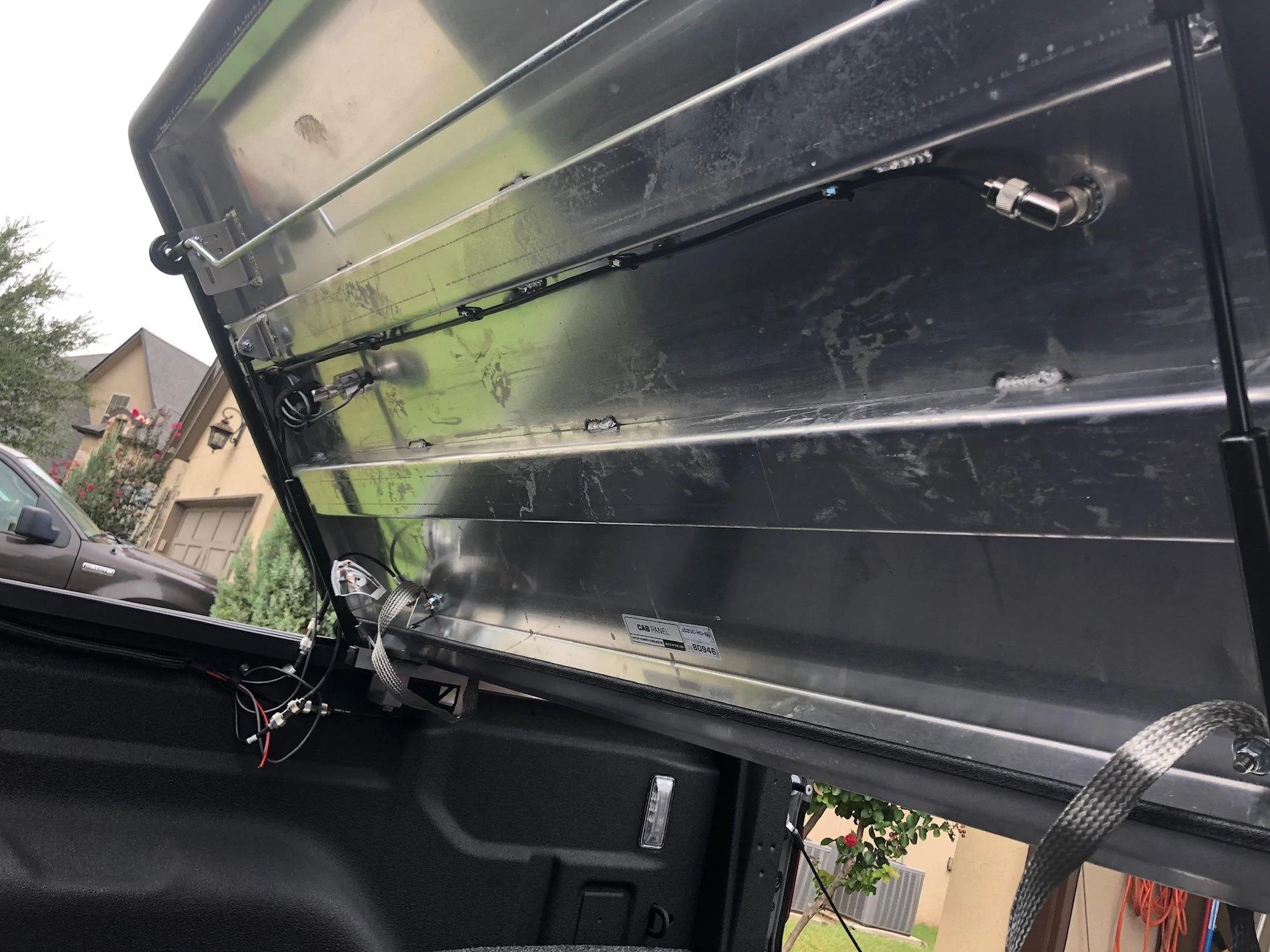

Inside front lid where I've mounted NMO (closest) and the HF at the farthest. That's a choke on the control wire for the screwdriver antenna to eliminate RF feedback down to the controller.

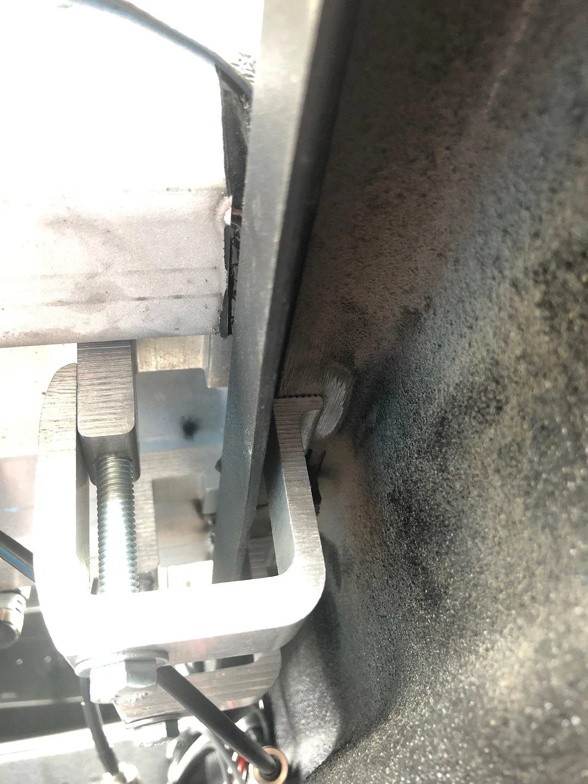

When I mounted the Diamondback tonneau cover, where the clamps are for the center piece I removed a patch of the linex to make a bare metal contact. This makes the center part of the tonneau well grounded to the bed. I added a couple ground straps from the front cover to the center piece to ensure solid RF grounding.
All the connectors to the antennas are coupled at the edge so if I need to remove the cover, I can just quickly disconnect everything. I ran an extra 12 AWG red/black zip wire to this location in case I might want to connect something to DC here. It wires back to a fuse box under the rear seat where all the radio chassis are located.

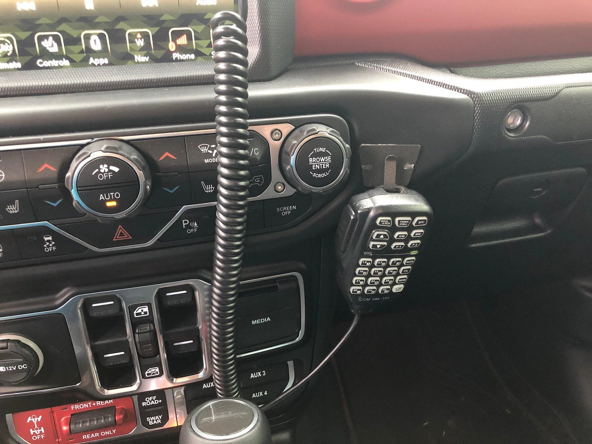

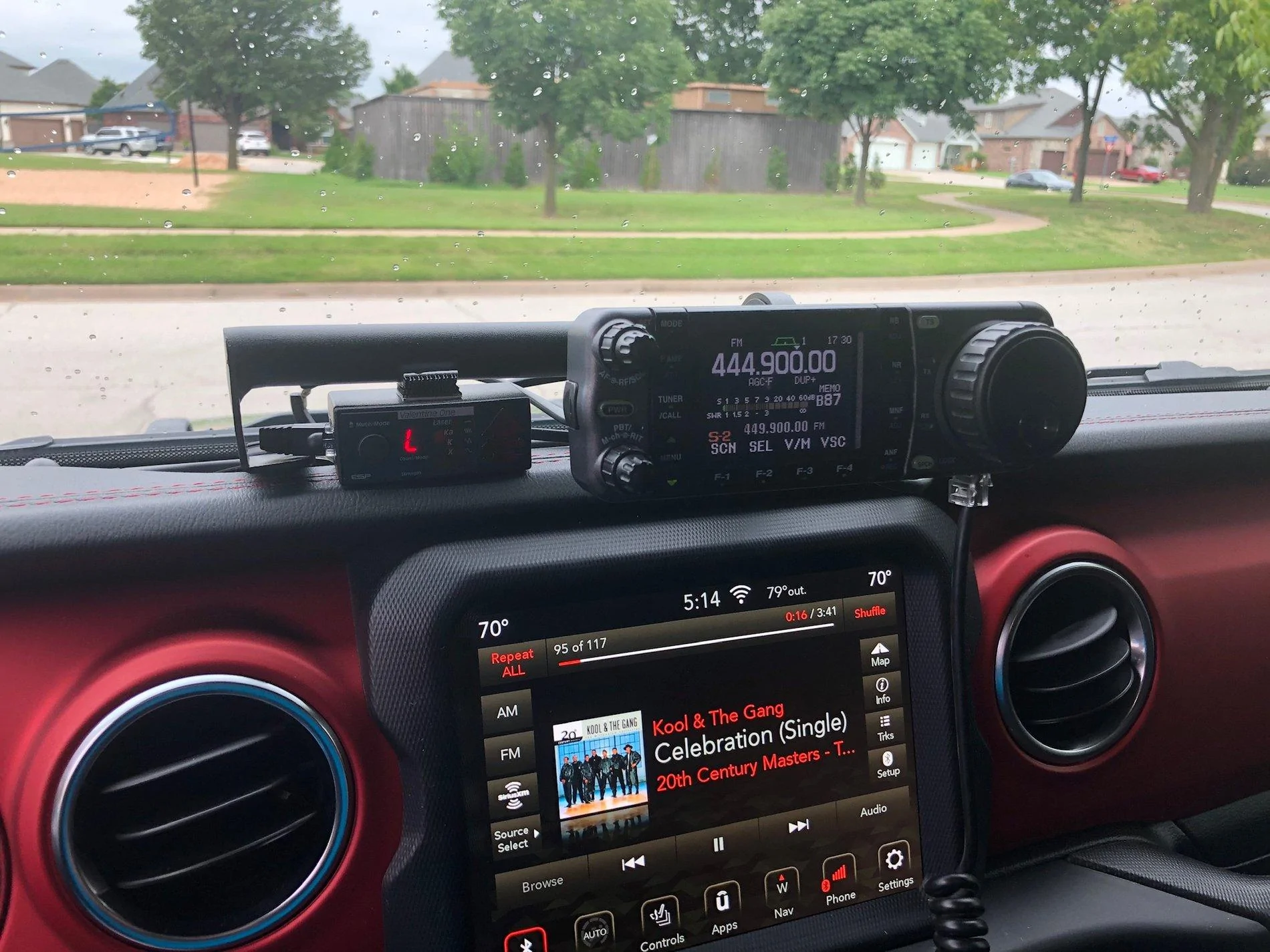

The head unit for the radio and the radar detector remote for my Valentine One are located on a bar bracket in the center console.

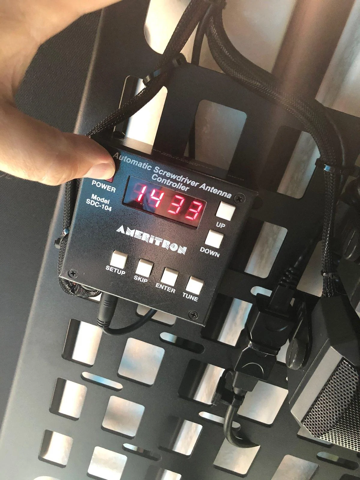

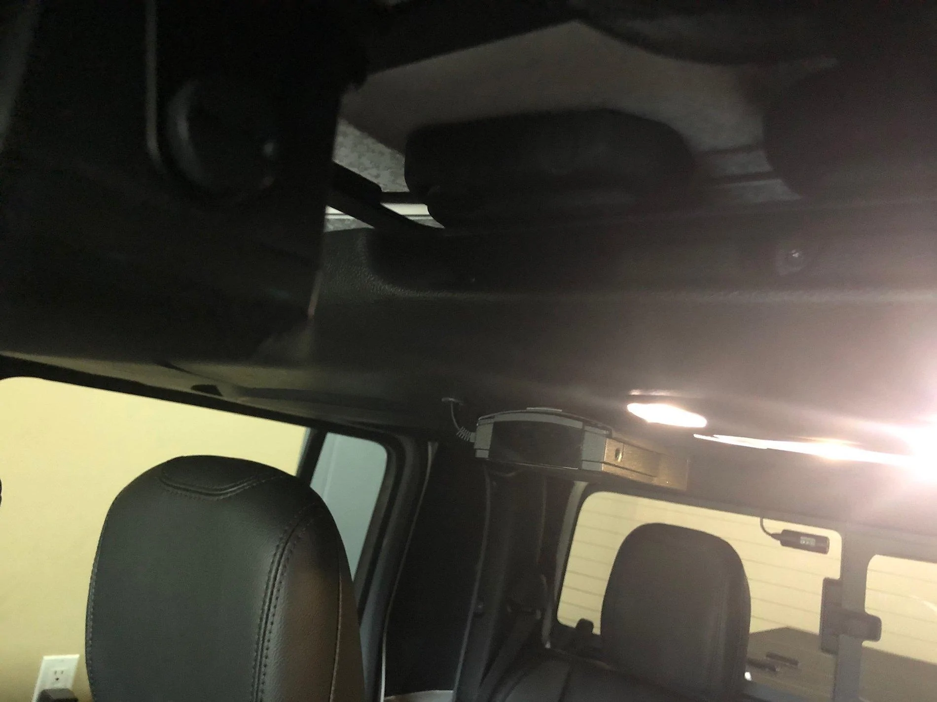

On a molle panel overhead, I have the mic/controller for the Motorla GMRS radio so all I need is the Mic here. The screwdriver antenna controller and two speakers, one for each of the radio. I plan on re-doing this and just use one speaker and a couple diodes to connect them both without feeding back one radio to another.

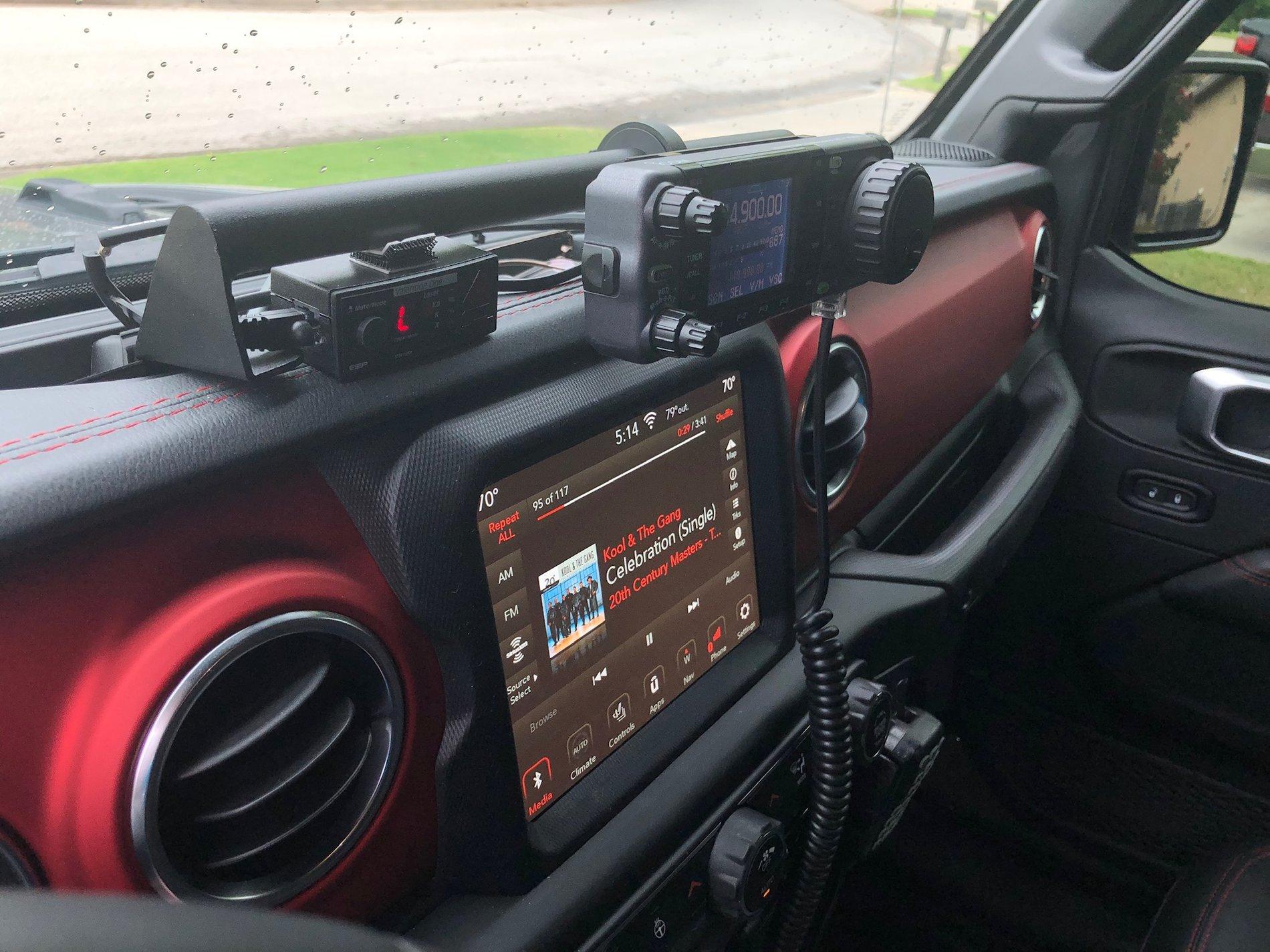

And finally, to reduce any clutter for having crap up in my windshield other than the Dashcam, I've mounted my V1 radar body on the center bar between the seats where it's not very visible or obvious. Seems to work without any issues here and seems to be every bit as sensitive as when it's in the windshield.
When the Diamondback lids are open, the antennas just flip back so it's not in any way impeding my use of the lids.
How did you run the wiring from the bed into the cab?
I just ran through the plastic plug that's in the bed, straight down then into the cab under the passenger side rear seat through a drain plug in the floor. Could not have been more convenient since the radios are both located there under the passenger side rear seat as well. I had ran the power cable from the battery across the top of the frame and came up through that same drain plug as well. Easiest install I've ever done on any vehicle.

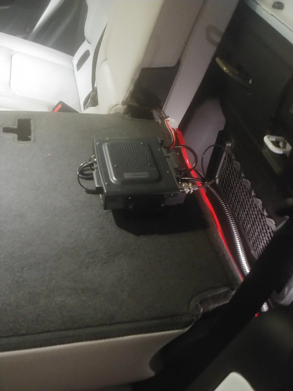

Consider ON the back seat ... It gives you a perfect place to set a laptop if you ever need to when programming by just putting the seat down.
Worked well for me ...

That’s a darn good idea. What did you use to secure the bracket to the seat back?
MrZappo
Tom
Aug 9, 2020
780
1,872
Granger, Indiana
Gladiator Mojave
Computer Consultant
The rear seat back is a thin plastic or composite material of some kind. I can't tell as it is covered in a carpet material.
If you just take some short fat sheet metal type screws (pointy and only 1/2 inch long or so) (do not need to be self tapping), place the mount plate where you want and exert minimal pressure as you twist the screwdriver, it will self tap.
The material is thick enough to hold very securely but not so thick or hard that you can turn the screw like it's metal or something.
Just turn till snug and a slight bit more. It's obvious when you do it and you won't strip it unless you are paying no attention.
There is nothing but 6 inches of air behind the seat back.
Works perfect.
The only additional concern is a speaker as you won't hear it from back there.
I mounted a yaesu speaker under the driver's seat facing forward. Works fine.

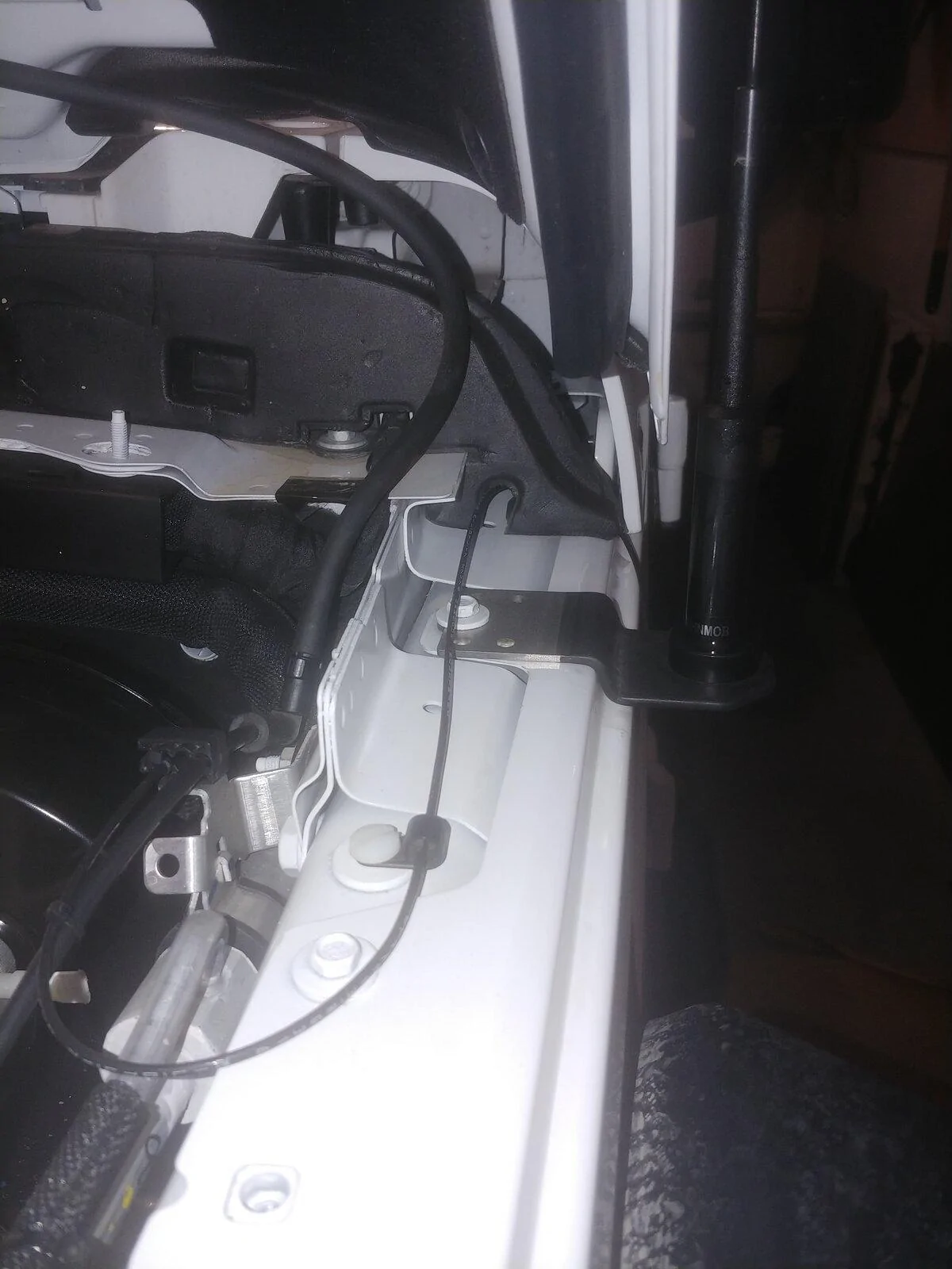

As long as I'm going, here are a few more things.
If you can get the antenna and power wires into the cab (pm me if you want details), you can run them all the way to the back on either side of the jeep by stuffing them under the plastic between the carpet and the door jambs. Works fine and it is invisible.

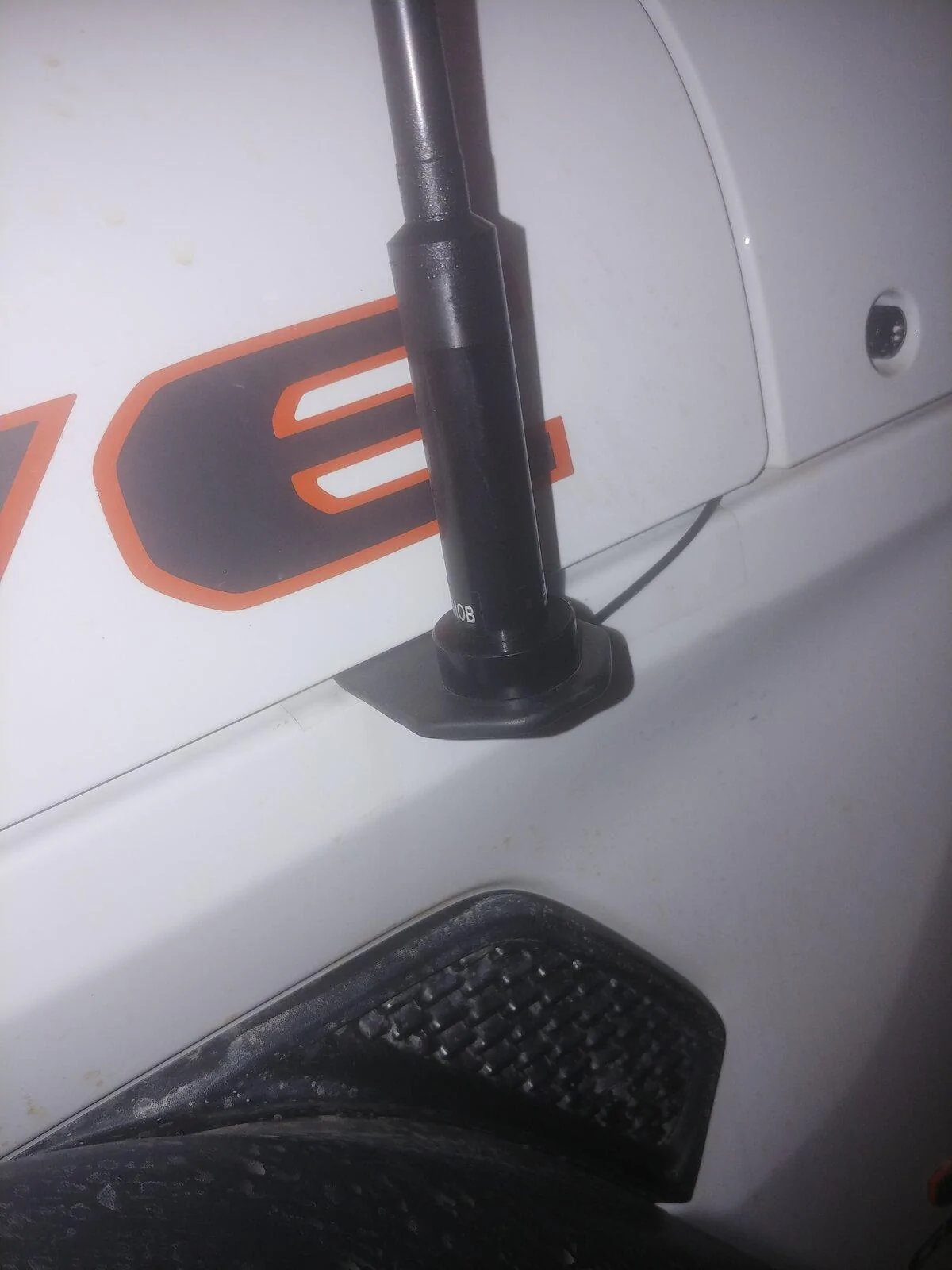

Thanks for those tips. I still need to settle on a hood antenna mount and decide if I want to just have a power on relay like I did in my Cherokee or tie it into my Aux buttons.
Jeep Gladiator Ham radio install 20210101_134343
Jeep Gladiator Ham radio install 20210101_134417
Topsy products makes this mount which fits gladiator perfect. I plasti Dipped mine for protection and looks.
Also best to power direct from battery although I've heard of some using the Aux buttons with success.
