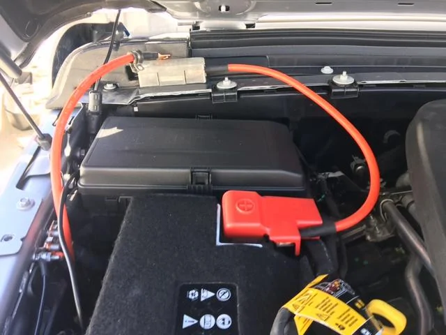

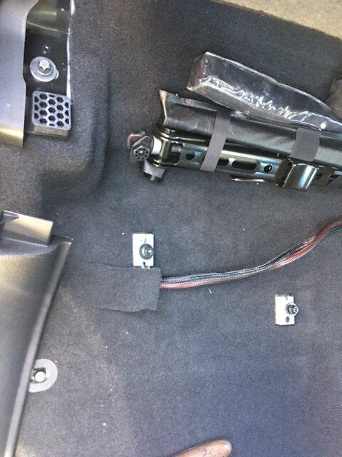

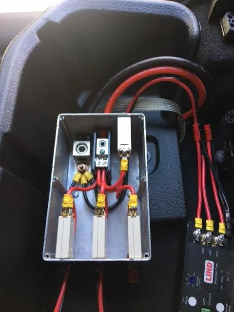

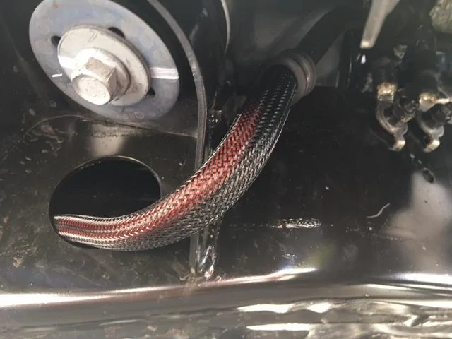

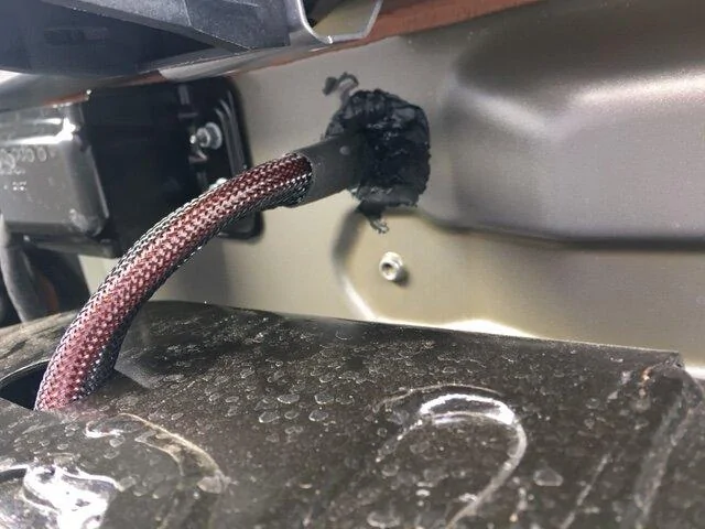

I worked a bit on my truck today getting some high current wiring under the rear seats to power a few radios and a 500W HF amp. I didn't want to take out batteries and other stuff to get the power wiring through the firewall so I went down the front fender into the tubular frame then popped out of the frame under the back seat where there was an existing grommet in the floor. I enlarged that to 1" to pass a pair of 4ga wires and some coax. The entire run of 4ga wire is inside expanding loom and it has a length of thick hot glue heat shrink where it enters under the rear seat.
Here are pictures of the power cable from the battery to a 150A fuse on the cowl then the cables going in and out of the frame. Under the rear seat is a power distribution box (with the lid off) I pulled out of my old truck that has aircraft circuit breakers, three 20A and one 30A plus an ignition timer that will turn off the radios after 30 minutes or so after shutting the truck off. The distribution box also grounds to the body with some flexible braid. The distribution box has several short 10ga cables with Anderson Power Poles and one set of large binding posts.
I still have two radio control heads to mount, a Yaesu FTM-400 and Icom 706MKIIG. The best place I've found so far is on a 6" long RAM ball and socket mount attached to the lower front of the center console. With the twist of a knob the mount with control heads will come off and stash inside the center console out of sight. Then there is the antenna mount for a huge HF screwdriver that goes on the inside bed wall. That's going to be fun.

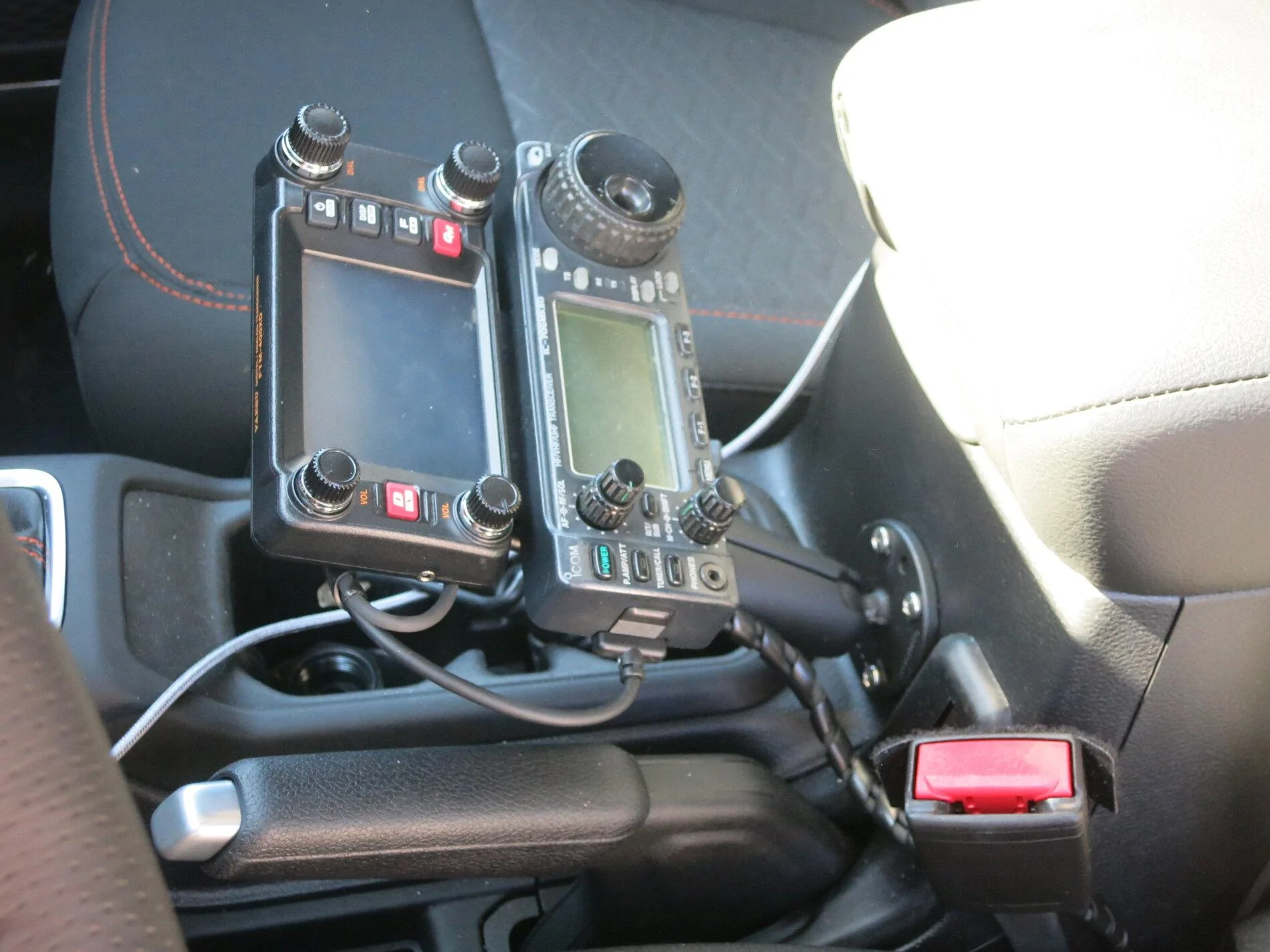

I got my radio control heads mounted on a RAM swivel ball mount and wired to the radios under the rear seats. I can loosen the wing nut on the RAM mount and the radios and 6" extension come right off and will all store in the center console leaving only a little ball mount on the front of the console. I also mounted two small speakers on the sound bar either side of the drivers seat head rest. Only thing left on this install is a mount on the drivers side bed wall for HF and other type antennas.
