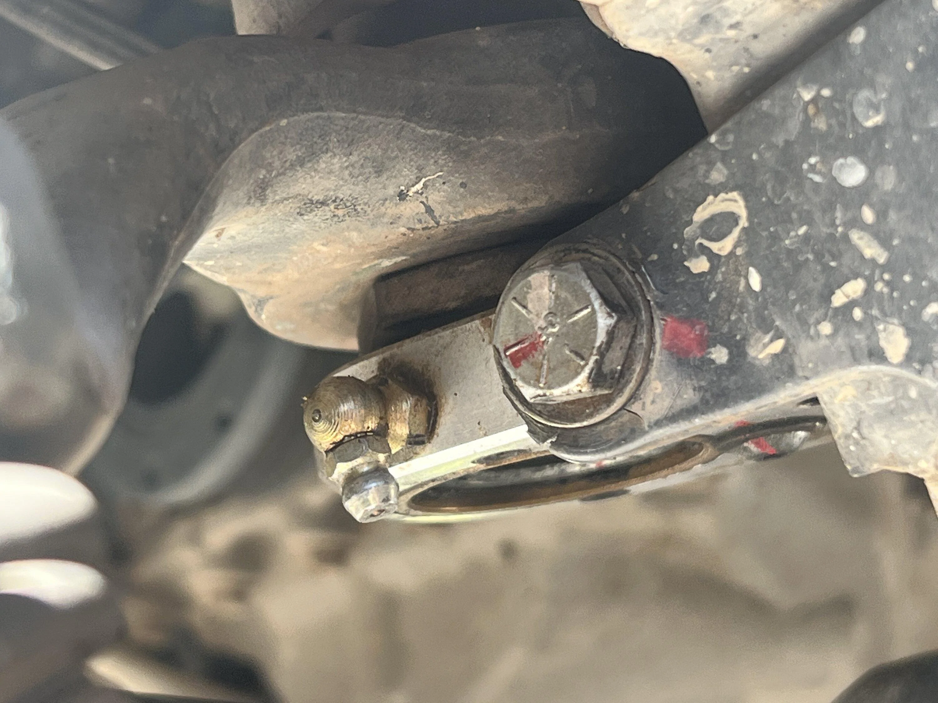

Not sure what you’re seeing exactly. The paint around the bolt is chipping away and the arm just has a little nick from a rock or something that took some paint off. But no crack I can see :)
