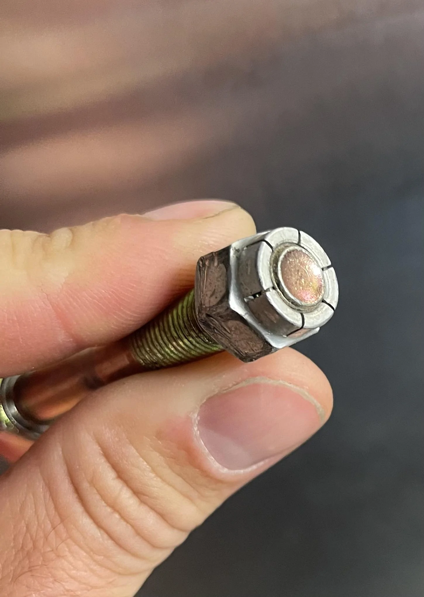

I've had my Synergy for quite some time now and while I've been generally been happy with it, I have not been able to keep it stable. I it needs to be retorqued (the 3/8? bolt that holds the shaft bearing housing) every 1500-2000 miles. Steering gets noticeably loose and then I have to go down there and retorque it. I've tried blue locktite. I suppose I could try RED, but at the same time I'm not sure it is the superior solution anymore.
I saw MetalCloak has a more elegant looking solution but curious if anyone has made the switch or if they are happy with it.
Try finding one of these. I have known it as an aircraft lock nut…. Probably has different technical name??
I had the same issue with a few different joints (heim joints on sway bars are even worse….)
Few different causes…. Few different solutions. Stay away from nylocks on any suspension component that has movement…..
McMaster carr can get the nut’s in this photo in almost any size/pitch.
they hold their torque the best of any other nut I have found- they can be taken on and off 25?? Times before they are trash… compared to a nylock that has a 3x?? Removal at max torque spec…. They are worth it.
Kimble Midwest can also get these nuts. Expect to pay about $6-8 a piece….. but they are worth it. If the mount wallows- your going to be in deeper than $6-8 (cost justification).
Kimble Midwest also has “mining grade” nuts- basically a grade 10+ Pinch nut, but they cost even more….
Thanks but a nut won't fix this for me. it is the bolt that goes into the aluminum bearing housing that won't stay.
