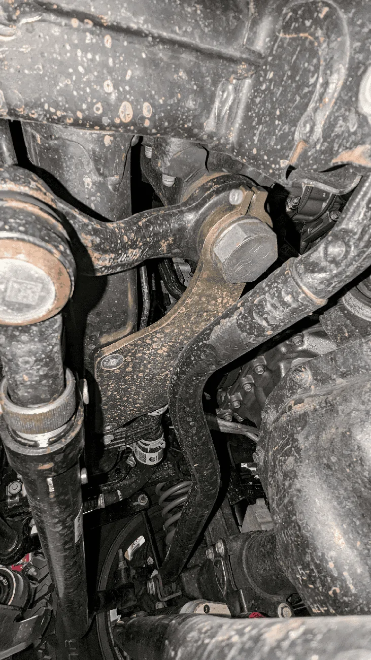

I was thinking that I can put on the synergy brace minus the bearing part on the steering box. Just to strengthen up the track bar. Being as how I already have the Meatalcloak brace already on. This way it's captured from both sides. Thoughts on that?

Over a year with the Metalcloak, and still loving it.
Ignore the dirt. I've been busy with the trees.
I don't know if there's room in the Synergy to go "over" the metalcloak. Looking at the designs, it seems like it might work but maybe not.
