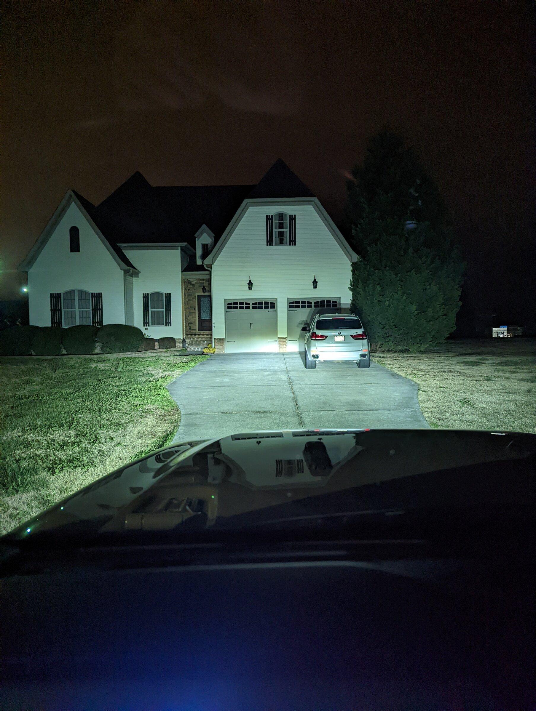

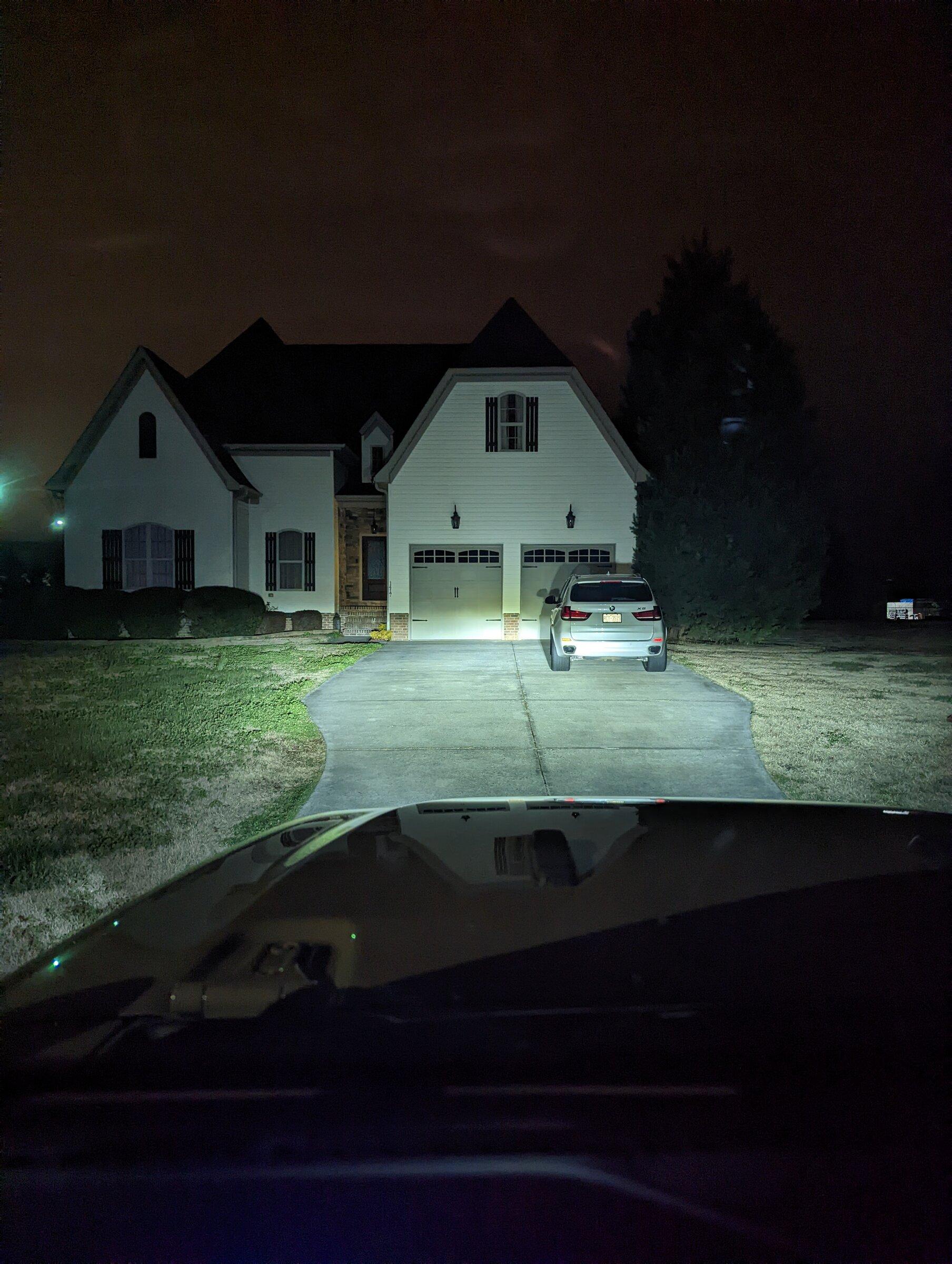

My factory LEDs are a legitimate safety feature on the dark mtn roads I drive and because they’re properly designed I’ve never once had anyone flash their high beams at me. This is a pic of my high beams.
Jeep Gladiator Headlight upgrade major confusion 570EA38D-C626-46D9-A0EC-9551832BCE72

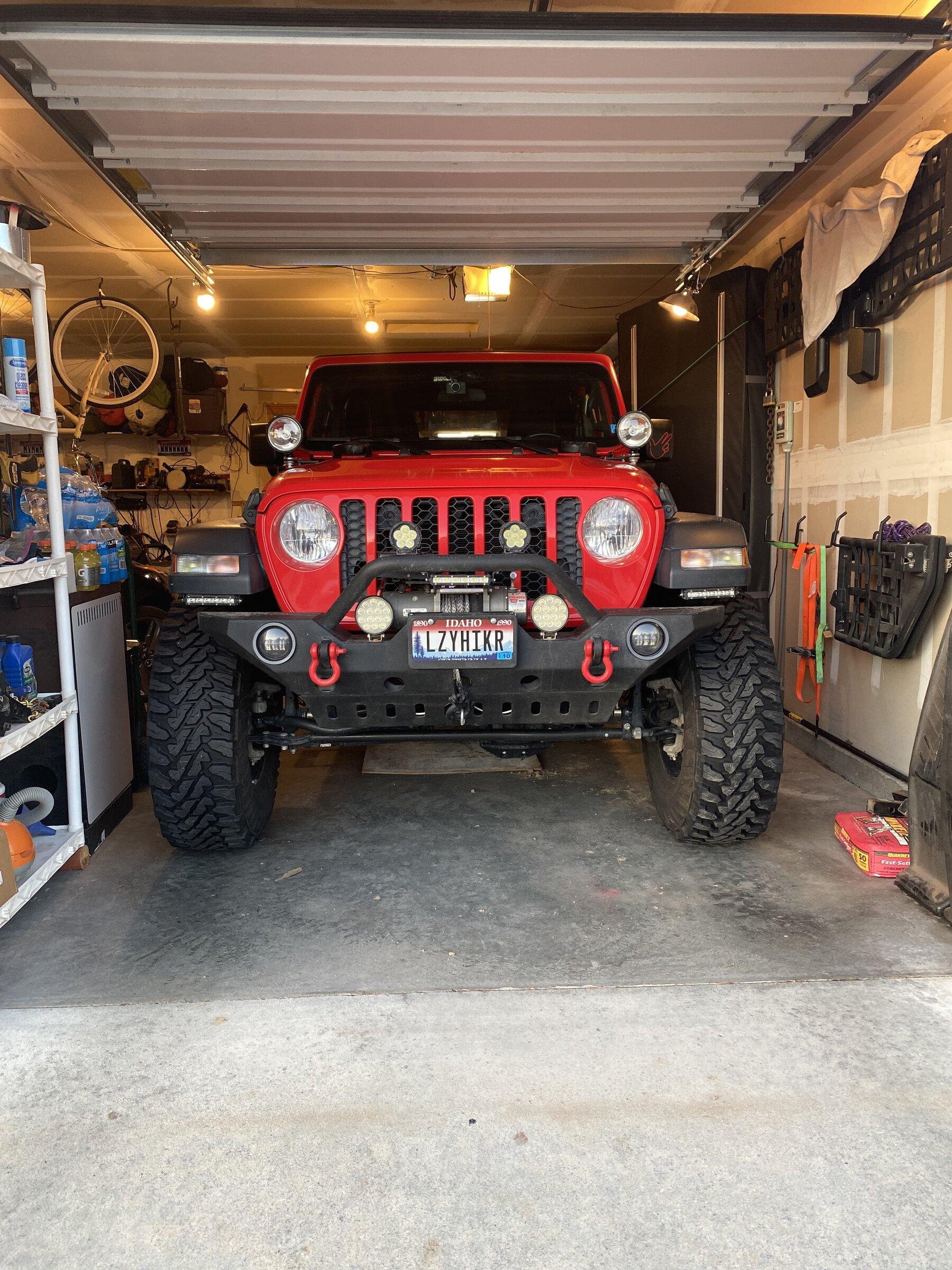

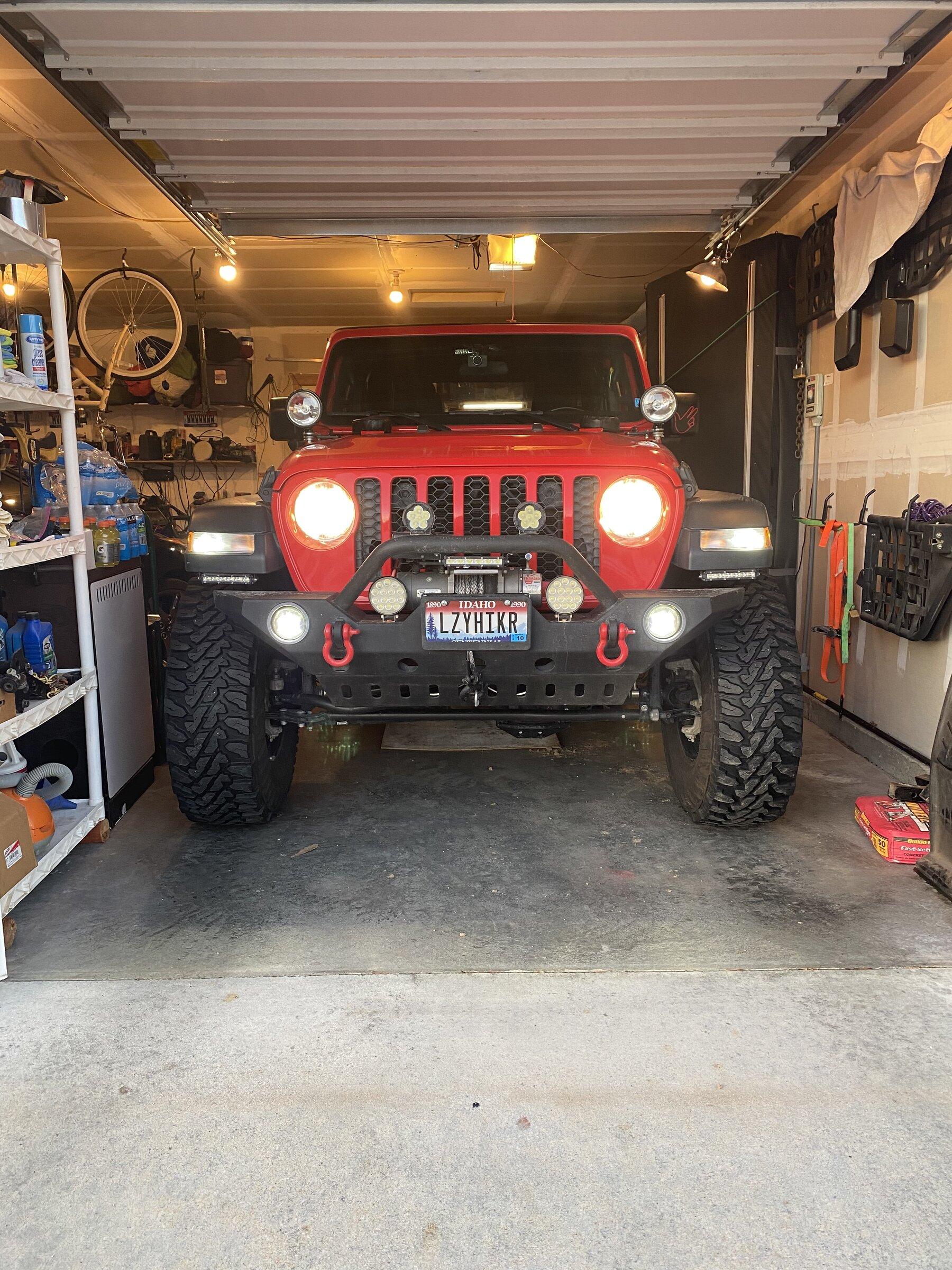

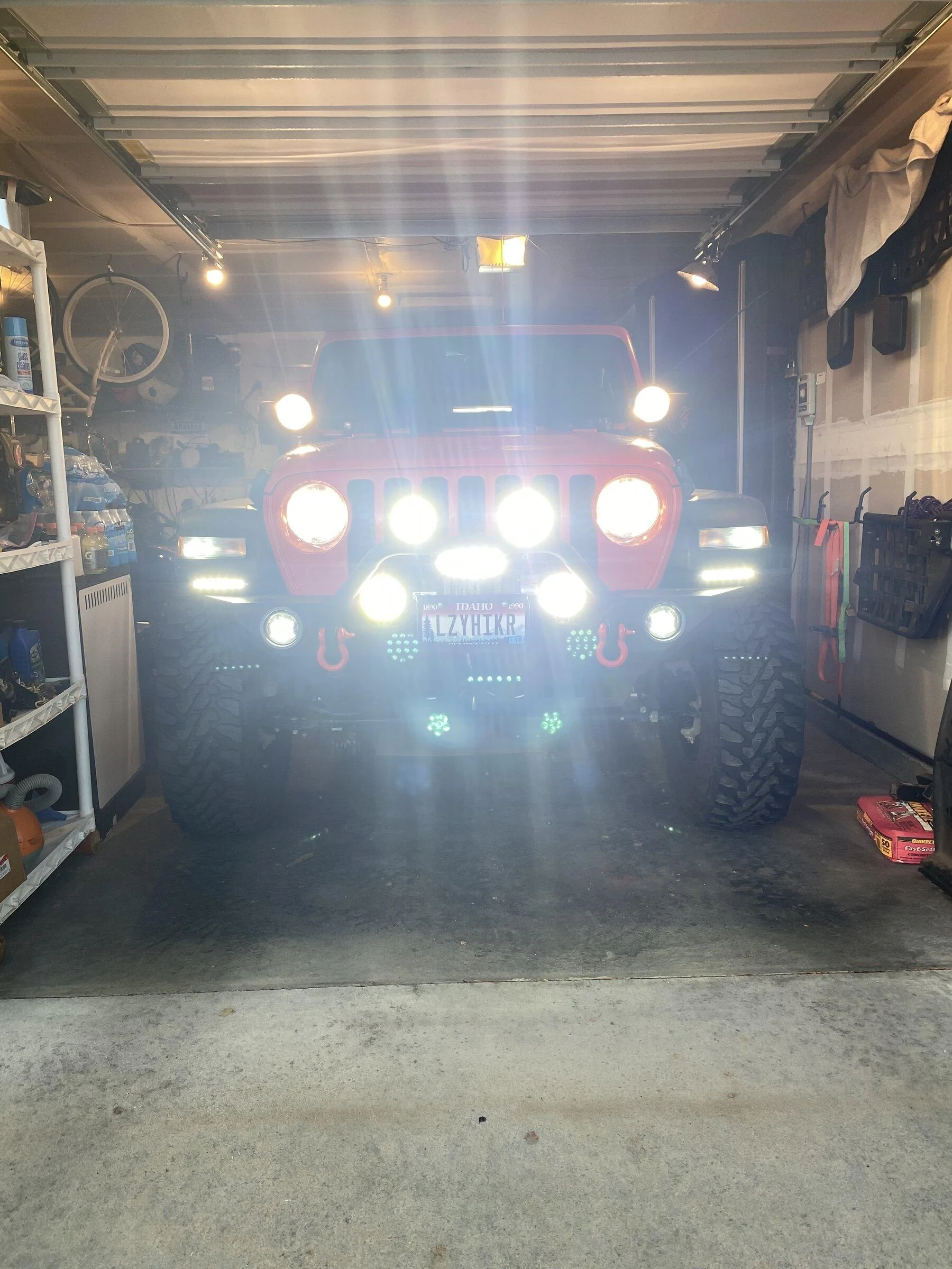

I upgraded my headlights to Koito H4 Headlights at the recommendation of Daniel Stern. LEDs have a lot to offer, but I like a timeless look of H4s. These headlights allow me to retain that look but have the best lighting I can get. He also recommended a pair of 60/55w bulbs made by Tungsram. If you do install 7” headlights, you will need to get adapter wiring harnesses and headlight brackets, which you can find online.
Below is an image before and after I installed the headlights.The brightness is hard to judge accurately because it was dark by the time I got the Koito headlights installed, but you can see how clean the beam pattern is. I also added a photo of what it looked like after install (I’ve since removed the fender air dams)
Jeep Gladiator Headlight upgrade major confusion BFEE433F-6267-470D-9601-491027225771
Jeep Gladiator Headlight upgrade major confusion B5845D4B-6972-44DA-8605-234B99A8CEE3
Jeep Gladiator Headlight upgrade major confusion 7A77D0CA-3ACE-4F3D-ACF8-998957CEA74C
