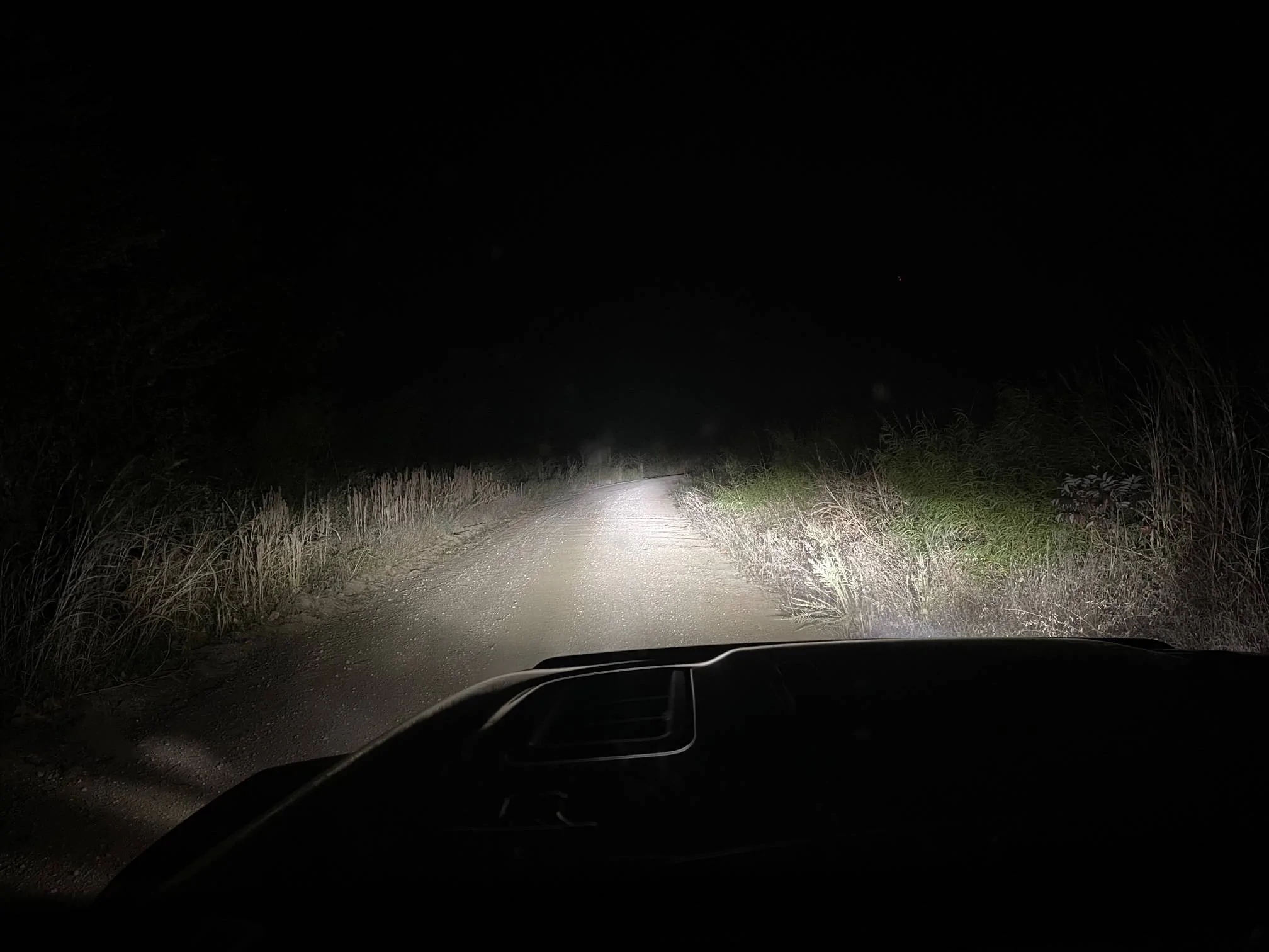

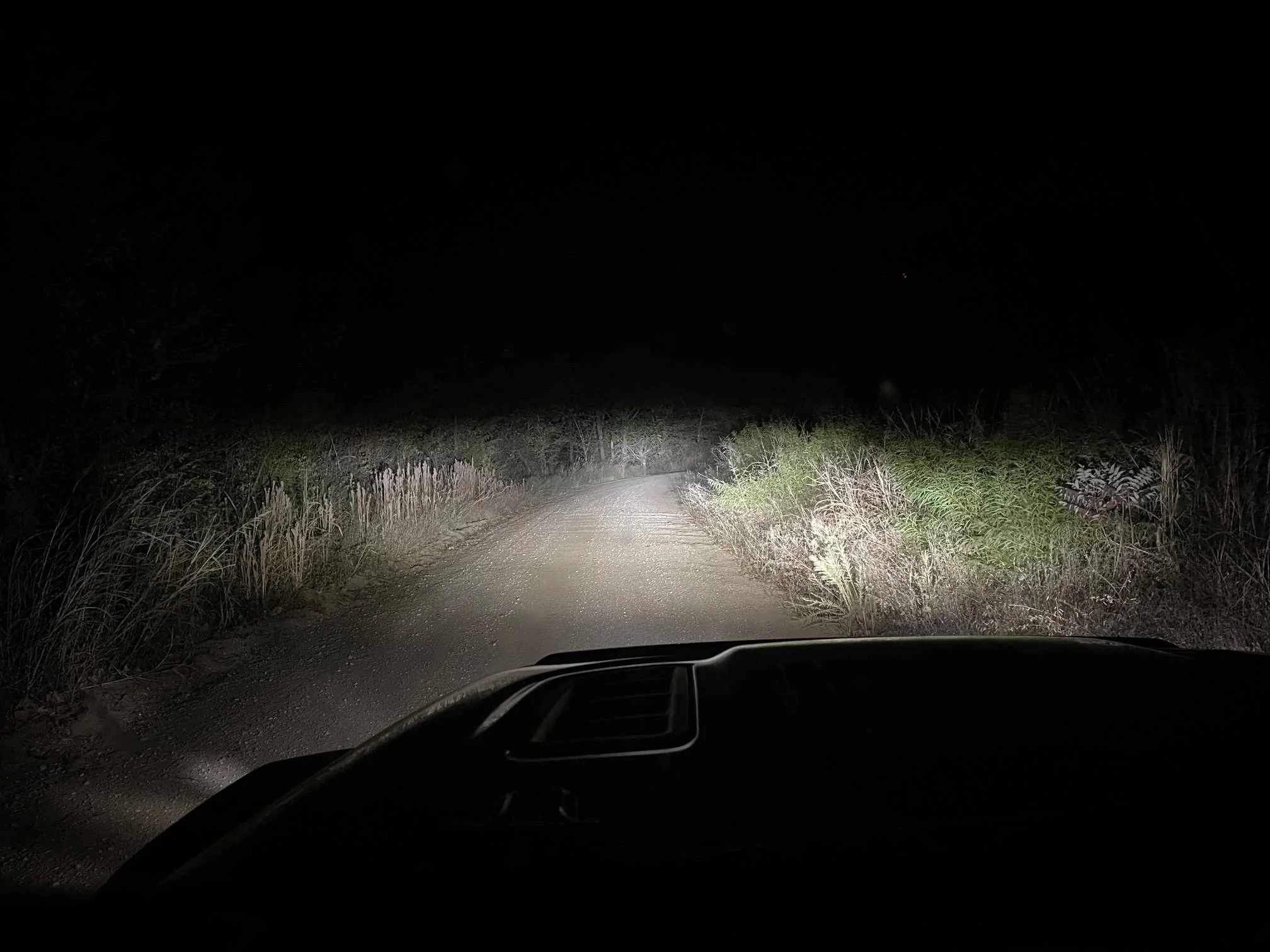

I ran a set of LED bulbs in my halogen housings for about a year and a half until I could upgrade to Diode Dynamics Elite LED Headlights. The bulbs were a huge improvement over the halogen bulbs. Mine came from Amazon but the bulbs I bought are no longer available. I'll add a couple of pictures showing the cutoff. Mine were made by a company called Firehawk and these are the closest available: https://www.amazon.com/Firehawk-Bri...T2F9/ref=cm_cr_arp_d_product_top?ie=UTF8&th=1
Jeep Gladiator Halogen Headlight upgrade bulbs LED Bulb High Beam
Jeep Gladiator Halogen Headlight upgrade bulbs LED Bulb Low Beam

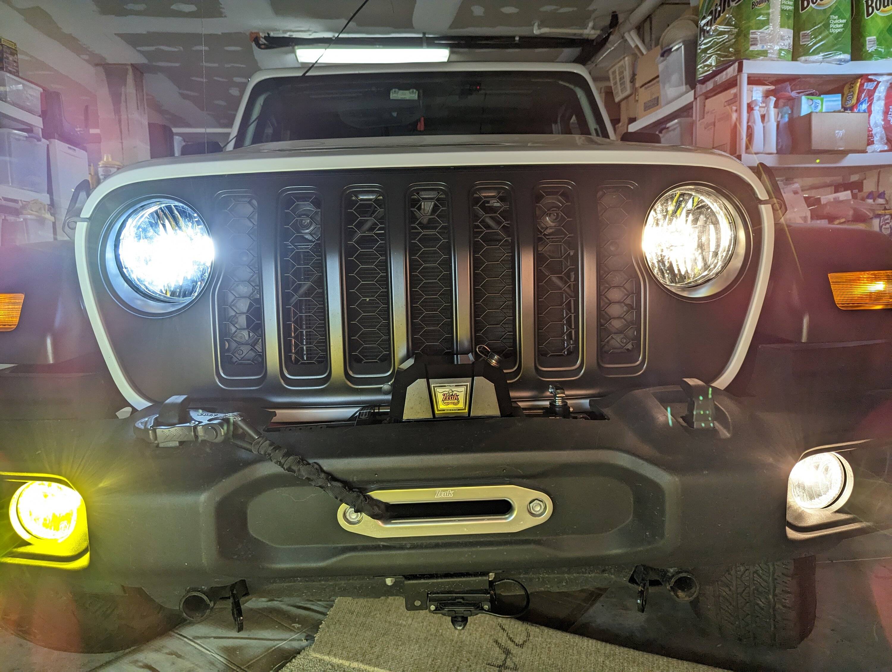

I replaced my halogens with LEDs I sourced on Amazon. I had previous success with the brand (SEALIGHT) on my RV, so for under $60 for both headlights and fog lights I had little to loose. I am 100% happy with the result. As mentioned above, you want the replacement dual filament bulbs to have the illumination point be as close to the original location as possible. The SEALIGHT 9008 bulbs I used required no adjustments after installation - they fit perfectly.
Driver side is before / passenger side is after. I measures the lumens, and it was as bright as advertised. Real world experience was like 'night and day'. (Sorry, I had to go there ;-)
Jeep Gladiator Halogen Headlight upgrade bulbs PXL_20230304_203918958
