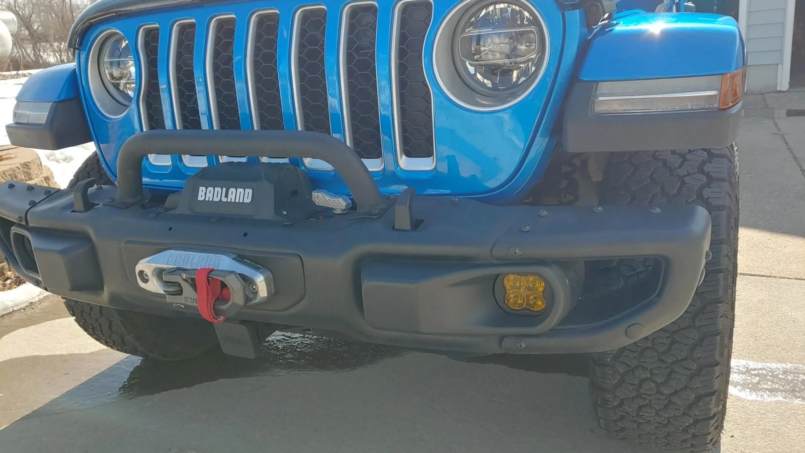

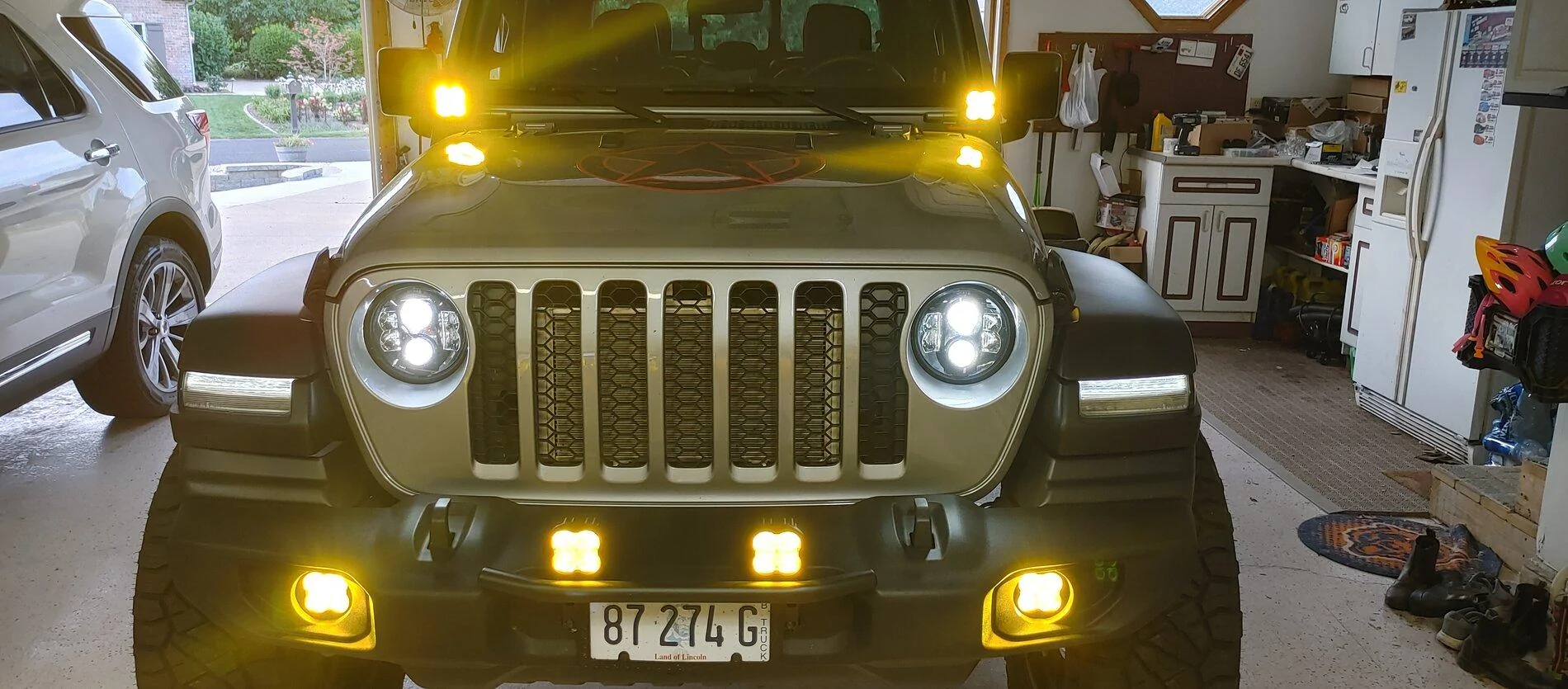

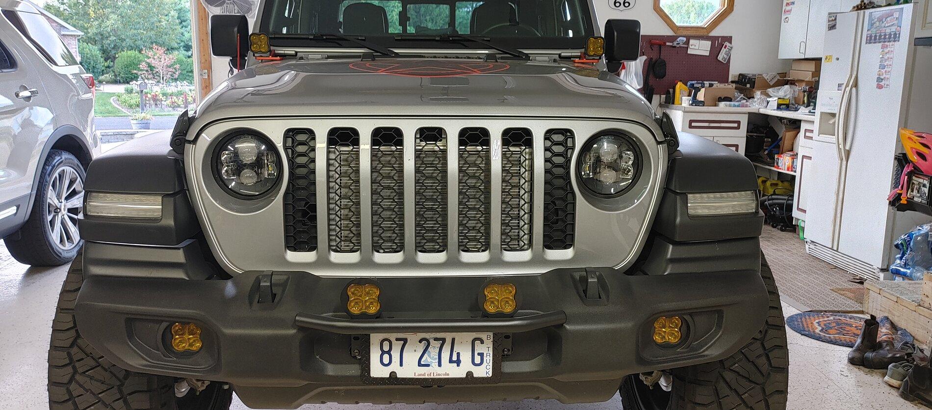

Diode Dynamics, and yes they are plug and play, and dramatically improve night time vision when running LED headlights.
40,465
53,916
DiodeDynamics fogs here, too - very well made, good wiring harness, connectors, etc. Good fit, look nice. Solid feeling lights.

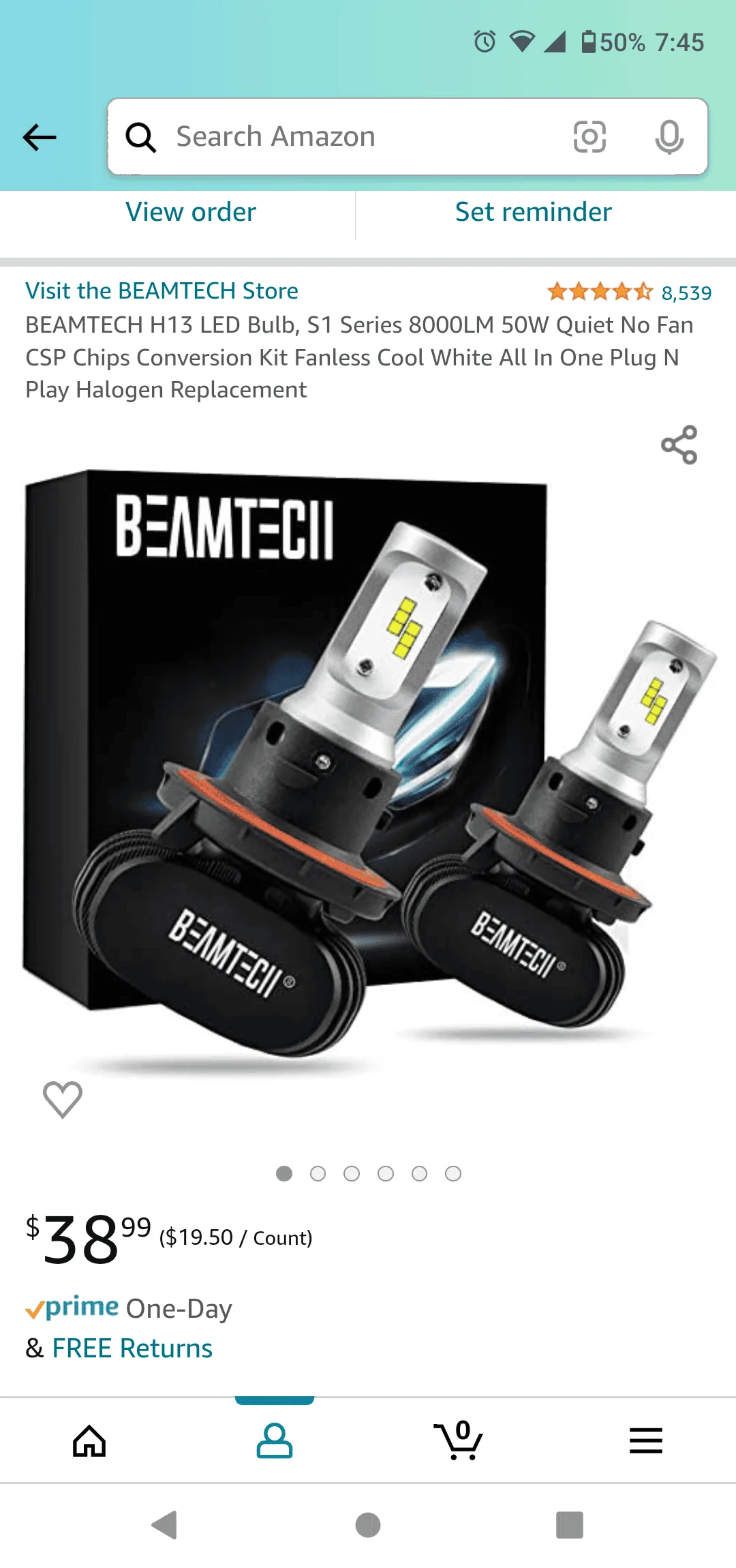

What beamtech part number do you have?
sdk131
Jul 27, 2020
342
528
Calvert County, MD
2021 Gladiator Sport S w/ Max Tow - Sarge Green
I just went with the basic ones without the fan.....these:
Jeep Gladiator Headlight Upgrade for Sport S W/ Max Tow Screenshot_20220223-194519
Edit to add - they did flicker a tiny bit until I used jscan to change the setting to led for the low and high beams.
