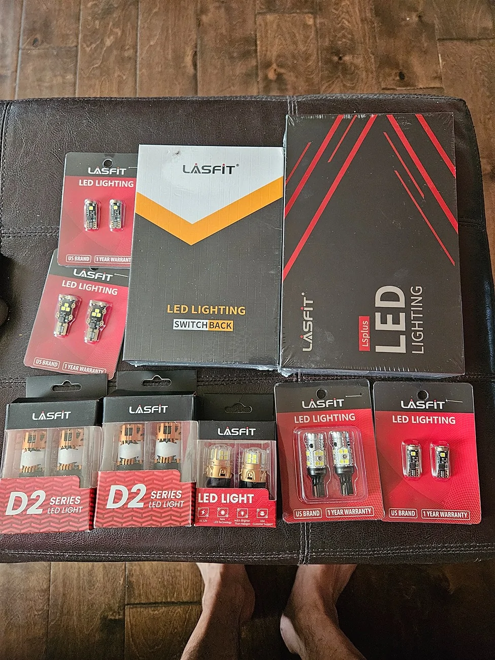

I got this bundle from lasfit, supposed to be canbus friendly, we'll see when I install them today, but I do have the Tazer to switch to LED's present as well.
Jeep Gladiator Headlight upgrades 20260829_084319

Just an OBTW, most aftermarket LED headlights bulbs are not DOT approved and are not street legal. From lasfit website on the kit you bought:
Application:
HID and LED bulbs are street legal in the USA for Fog Light use only. Not compliant with DOT / FMVSS108 and not street legal in the USA for Headlights. Legal for off-road use in Snowmobile and ATV headlights and off-road racing use only auxiliary or forward lighting. International street legality varies by country. For detailed clarification, check street use.
Note: This usage regulation is not unique to Lasfit bulbs. All LED and HID bulbs from all other brands, regardless of marketing claims, are prohibited from street use in halogen headlights in the USA.
DOT/SAE/FVMSS108: NO (NOT STREET LEGAL IN HEADLIGHTS IN USA)

I know they are not legal, but so is tinting your front windshield, and I see A LOT of Jeeps around here with tinted windshields. Plus, I'm gonna double whammy the legality issue with smoked headlight covers too.😁

Just took the Gladiator out for a night drive after installing the Lasfit bulbs. Man, what a difference. RC quadpods are pretty useless now except for the ones aimed to the side.
