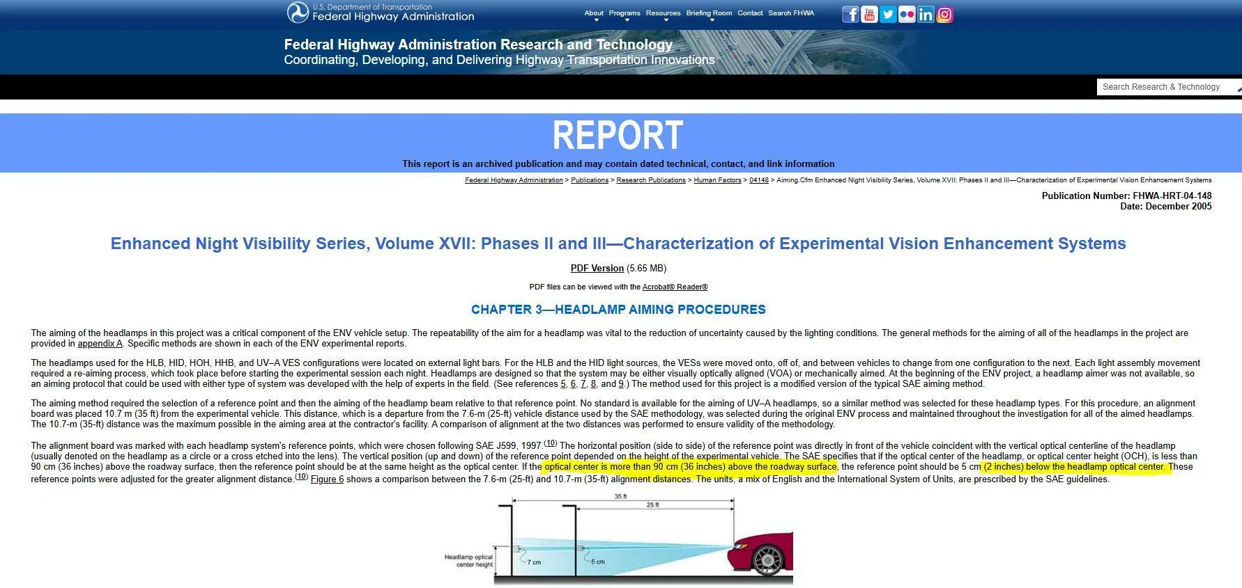

I personally like the video from Diode Dynamics and have been using the DOT recommended 2" below center of headlight height @ 25ft from wall. I lean towards 2.5" below optical center as the load in the bed of my JT fluctuates. I too have watched the Northridge 4x4 video and think something is slightly amiss with the info. I feel like NR4X4 confused the 36" optical center note from the DOT as the actual aiming measurement... in the case of my lifted JT this would be entirely too low.
Anyway, I've been following the 25ft distance and ~2" below optical center for years with no issues or flashes from other drivers.
