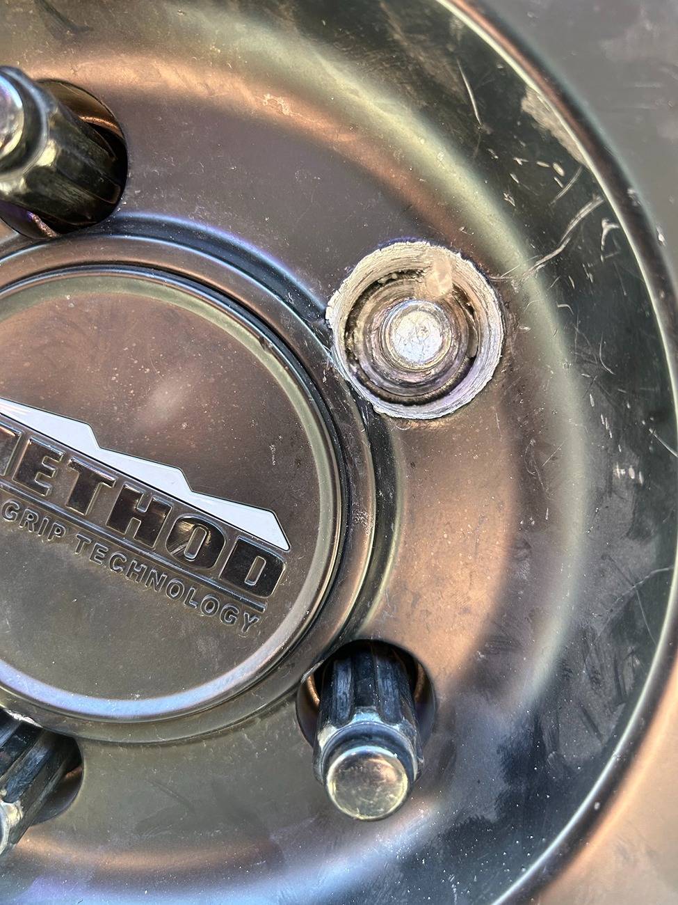

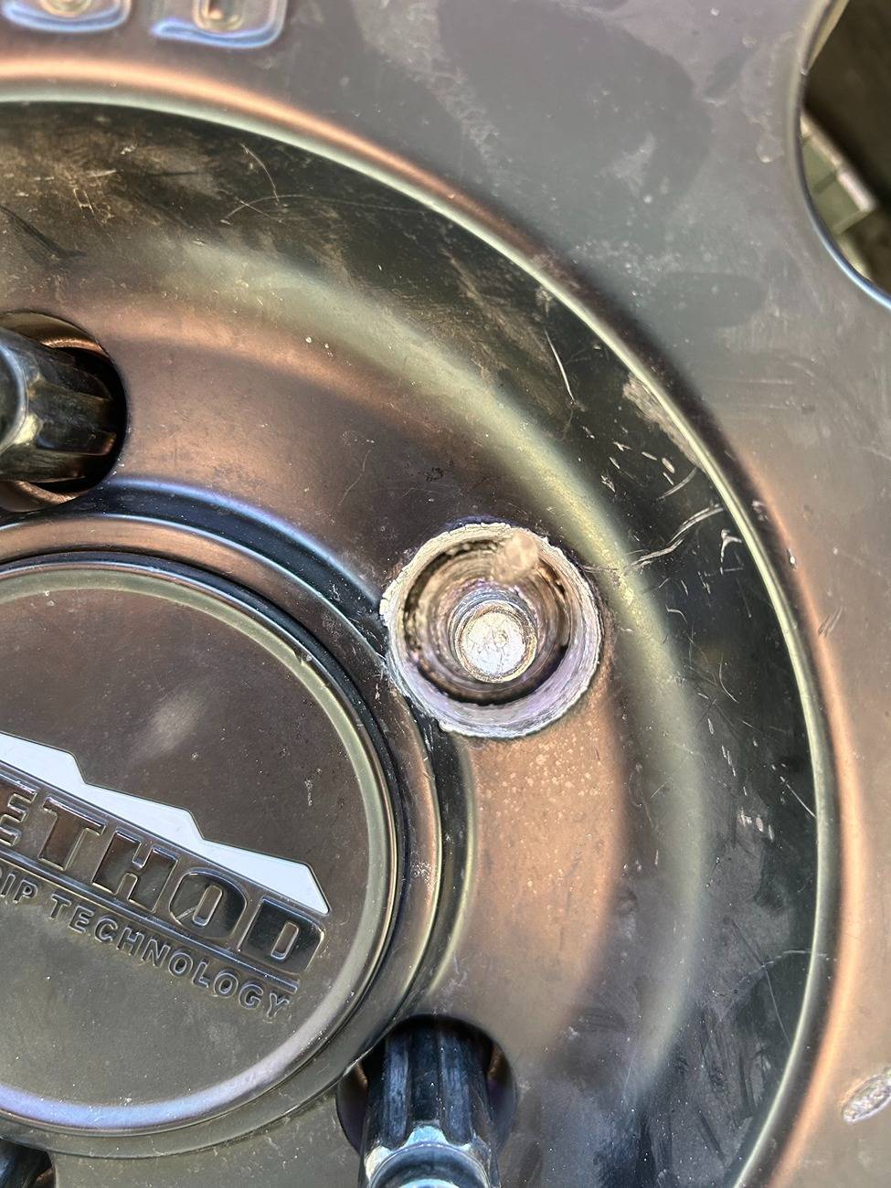

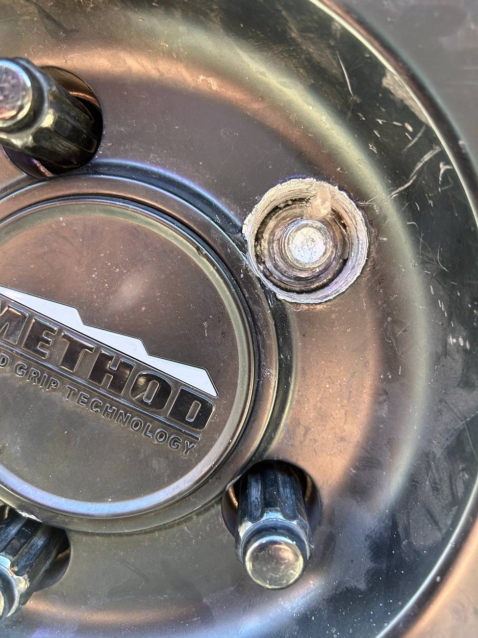

I’m looking for some advice to help out a friend. They recently went to a local tire shop, and unfortunately, the shop put on a spline lug nut that’s now rounded off. We’re stuck trying to figure out how to remove it without causing more damage to the wheel or surrounding area.
Do any of you have tips, tricks, or recommendations on how to bust this thing off? I’ve heard of a few methods, like using special extractor sockets, but I’d love to hear what’s worked for you in the past. Tools, techniques, or even services that could help would be awesome!
X
Jeep Gladiator Help & Advice Needed - Spline Lug Nut Broken & Rounded Off IMG_1898
Jeep Gladiator Help & Advice Needed - Spline Lug Nut Broken & Rounded Off IMG_1899
Jeep Gladiator Help & Advice Needed - Spline Lug Nut Broken & Rounded Off IMG_1900

Not sure if you meant to post different pics, but...frankly I can't tell what I'm looking at. Is that not the exposed stud? Did you "round off" half of it down to the stud itself?
I'll post some better pics today.
Pretty much from what my homie was telling me, the heehaw at the tire shop snapped the spline lug half off, where it was just the base left on. They tried to grip it with a 3/4 socket and an extractor, and couldn't do it. It's just the base of the spline lug nut with no grips for the spline key.
I had to go down there to check it out for him, and sure enough, it's just the base of the lug nut, no teeth to grip it or nothing. I took my drill to see if I could try to drill that and bust it for him there, and no luck. The tire shop kid was gonna try again, and I told him, just leave it before you screw it up, and you owe my homie a new rim, big dog.

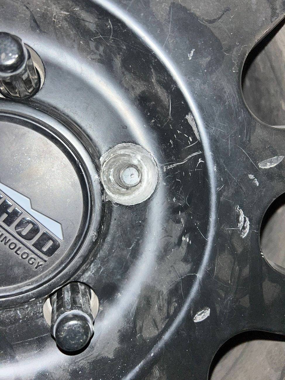

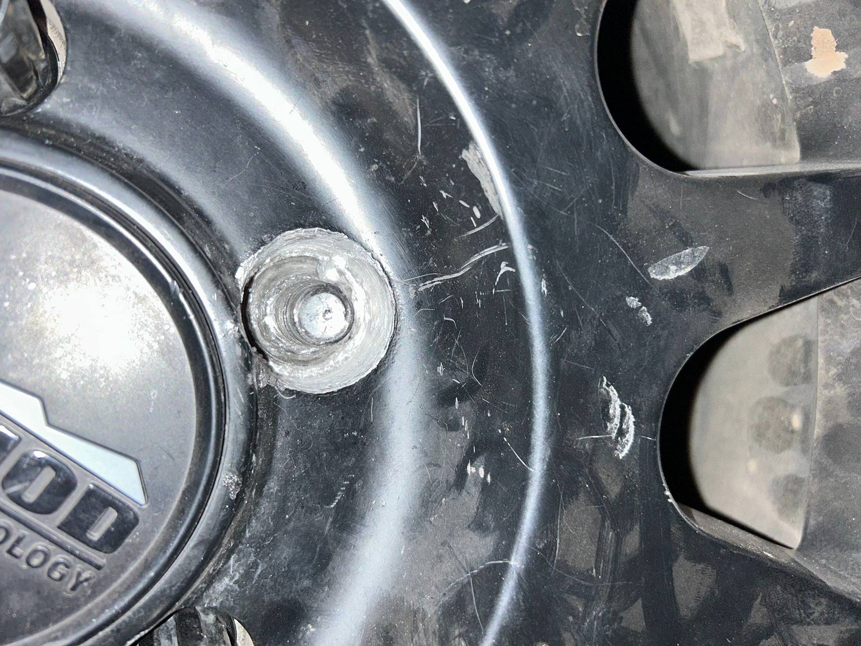

Sent from my buddy Joe this morning;
Jeep Gladiator Help & Advice Needed - Spline Lug Nut Broken & Rounded Off IMG_1934
Jeep Gladiator Help & Advice Needed - Spline Lug Nut Broken & Rounded Off IMG_1939
Jeep Gladiator Help & Advice Needed - Spline Lug Nut Broken & Rounded Off IMG_1936
Jeep Gladiator Help & Advice Needed - Spline Lug Nut Broken & Rounded Off IMG_1935
Jeep Gladiator Help & Advice Needed - Spline Lug Nut Broken & Rounded Off IMG_1930
