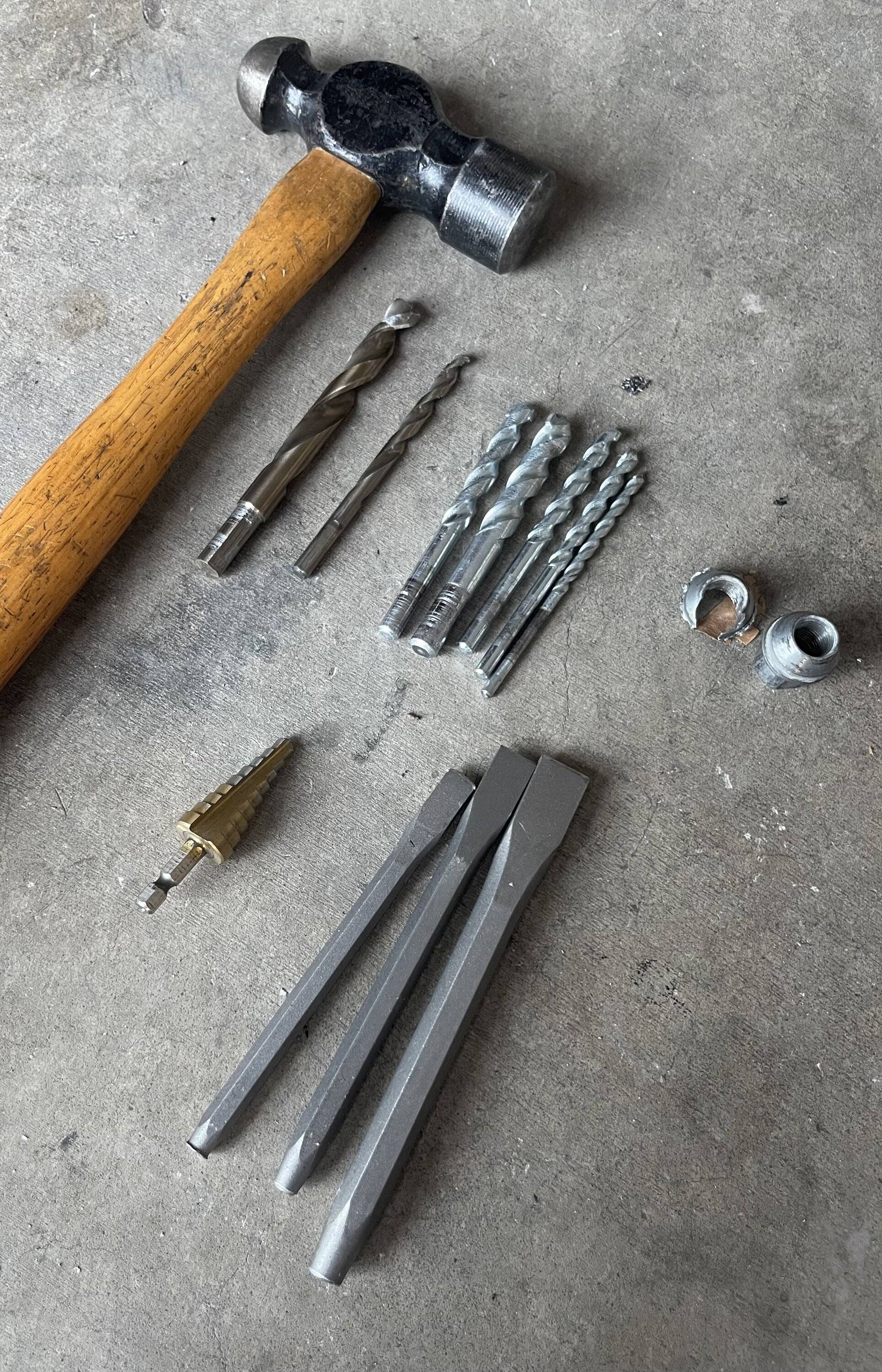

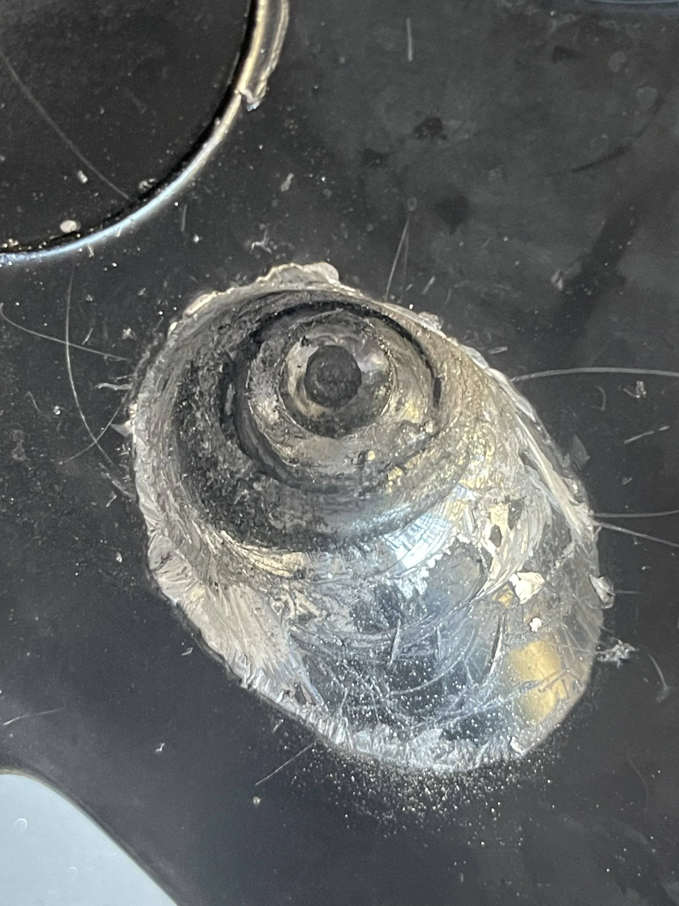

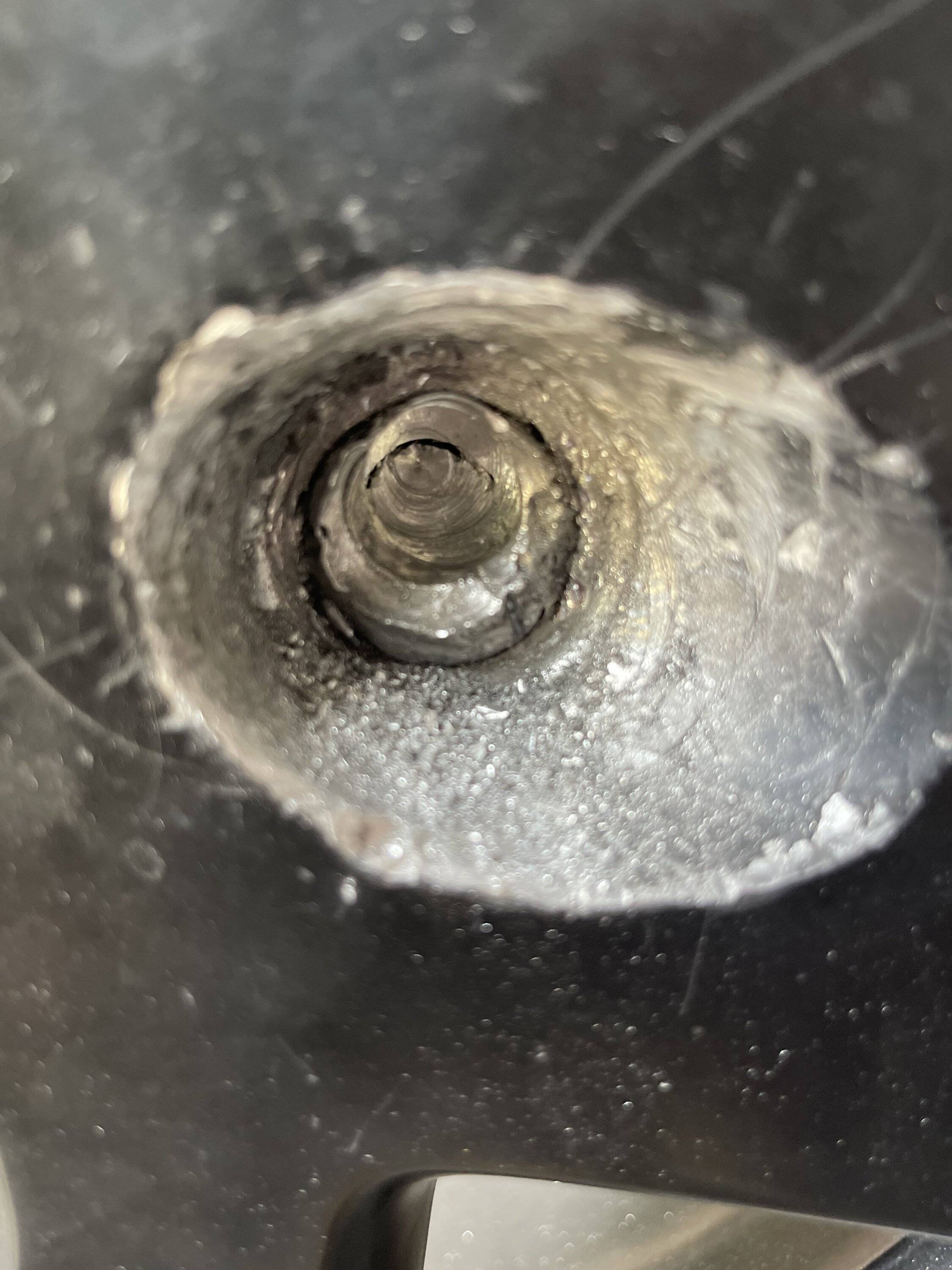

We are finally done! Drilling is the way to go, a chisel was working but once I got to far into the lug nut hole I was damaging the wheel more, drilling is the way to go

This is what I did
I used a set of drill bits along with 2 cobalt drill bits, some chisels and a hammer. The most important tool for me was a StepBit. It was going through the metal easier then I would follow up with the drill bits swapping from small to big, then stepbit repeat.I had to be so dam patient especially with this Phx Az heat

Woof. If you weren’t worried about destroying the wheel then I think chiseling would’ve been faster.
the chisel was the cause of the damage lol
