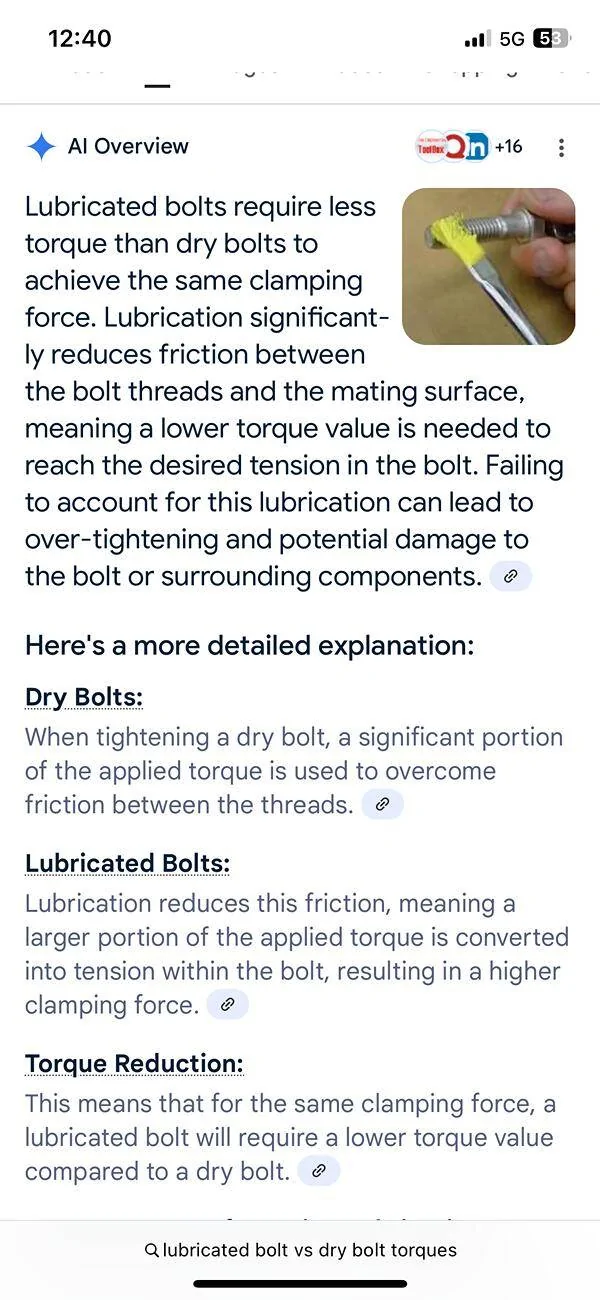

No, think of the lubricant acting as a pillow layer. Have to overcome that with more torque to retain the same clamping force as if the threads were dry.
I work in aircraft manufacturing and we have separate standard torque tables for both dry and lubricated threads. In all cases, lubricated threads have higher torque values for a given fastener.
I worked aerospace my whole career but never worked with anything but dry bolt torques. But your reasoning isn’t making sense to me. The lubricated bolt would rotate easier, thus applying more clamping power at the same torque load (in my mind). Kinda like this search says…
Jeep Gladiator Lug nut torque IMG_7359
You are right, I got it reversed on the risk of over torque with lubricated threads as the torque reading of the torque wrench comes into play and can actually over torque going by standard values of dry threads.
As to lubricated threads, it is rare but we have a few instances of setting torque and torque to yield but that is called out in the drawing as applicable. 99% is dry torque. I just knew going off the top of my head we had tables showing different values for dry and lube and also depends on lube used.
