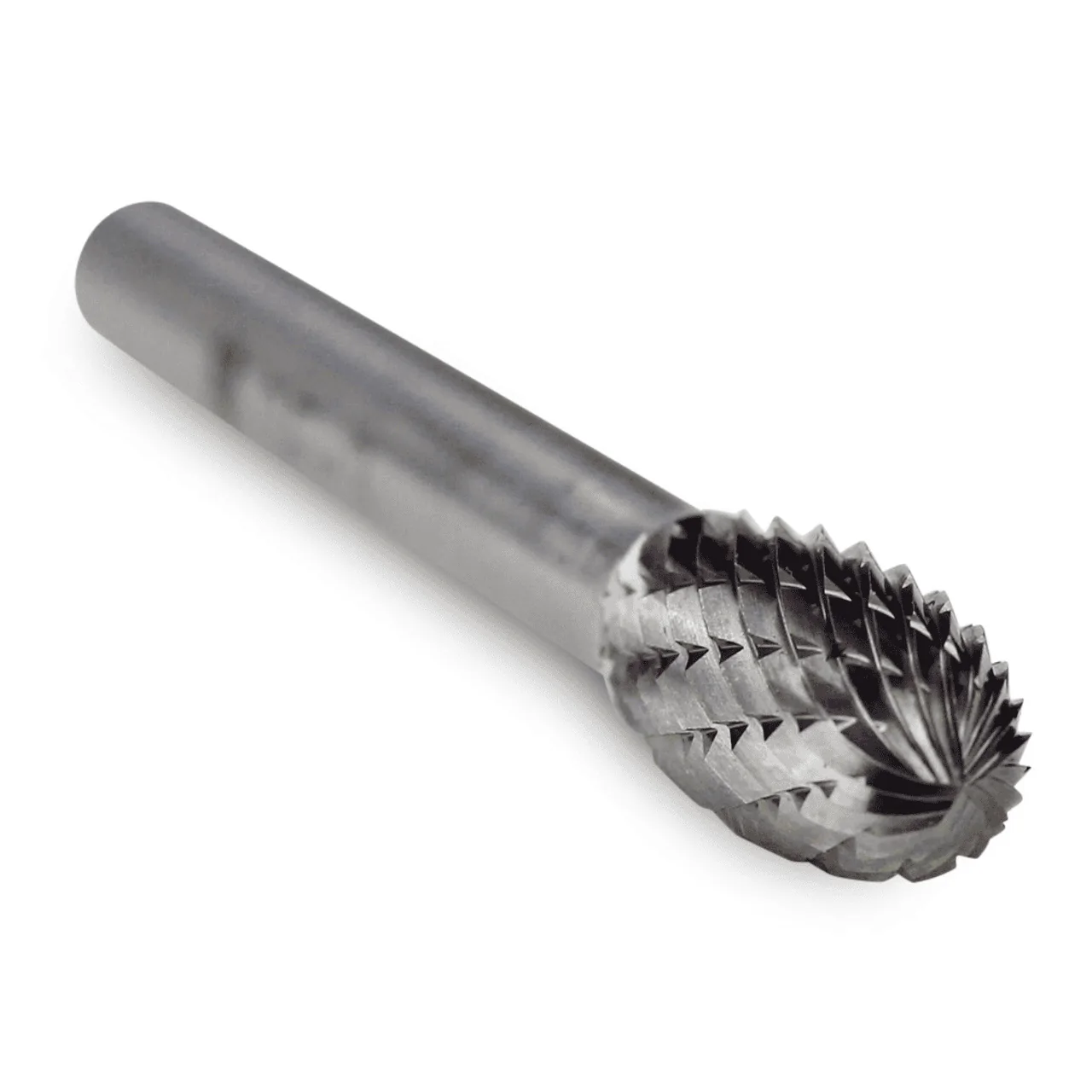

I've removed nuts like this before. Air powered pencil grinder (or Dremel) with a 1/8" burr bit. Grind 2 slots 180* apart the full length of the nut. Since the stud is shot. You can grind into that too since you will be replacing that too. Once you have both slots ground. Take a narrow chisel and hammer. Tap at the edge of the slots you just ground. The nut should peel back.
This shape would work. dip the end of the burr bit into ATF to lubricate it ever once in a while. Helps to keep it;s sharpness.

I've removed nuts like this before. Air powered pencil grinder (or Dremel) with a 1/8" burr bit. Grind 2 slots 180* apart the full length of the nut. Since the stud is shot. You can grind into that too since you will be replacing that too. Once you have both splots ground. Take a narrow chisel and hammer. Tap at the edge of the slots you just ground. The nut should peel back.

Yes, but some people are visual learners and there was a nice big picture posted to show how pointy and round the attachment was.
