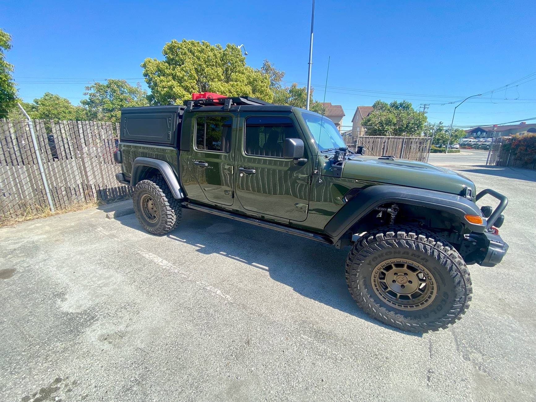

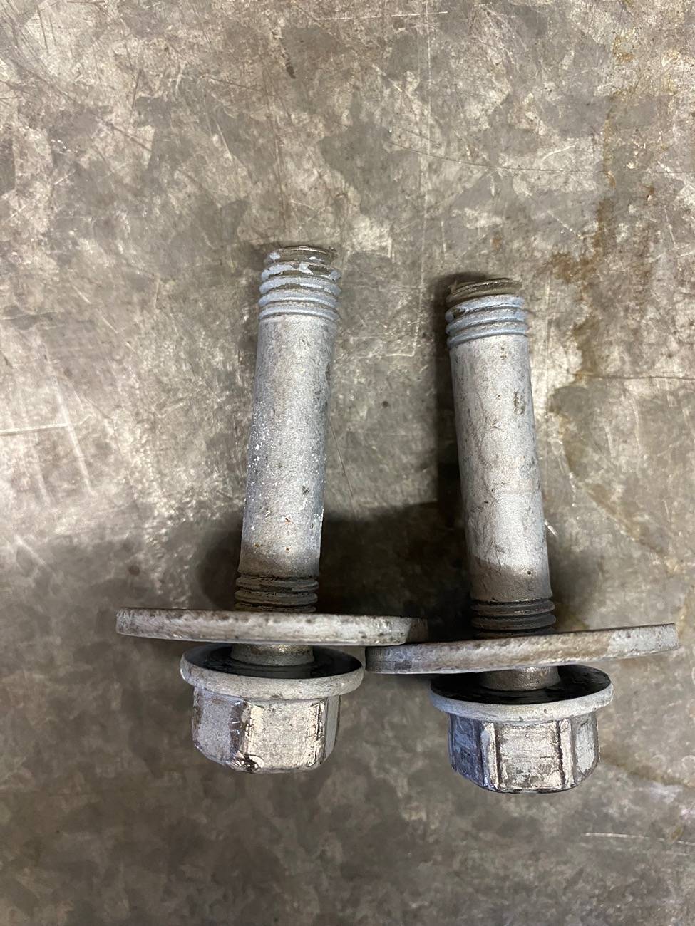

UPDATE: truck is repaired. I don’t have pics of the repair steps but they ended up going through the floor boards. The cut rectangular hole but only 3 sides about 4”x2”. They then peeled those sections back and were able to extract the bolts. To fix the fix they folded the peeled ba k section back over, put seem sealer around the cuts and then riveted another slightly larger piece of metal over it and more seam sealer to prevent water intrusion. And painted all the bare metal of course. Cost was $953. Not cheap but cheaper than more damage and this repair is waaaaay outside my wheelhouse. If anyone in the CA central coast needs this repair the guys at Street Scene in Watsonville got me in quick and did a solid repair.
Glad to read a good conclusion sad on the cost though. But that's looking good.

Expensive repair, been there lol. But it's done and that's good!

Definitely a costly experience but could have been worse. Im just happy it’s done. Headed to the Sierra for a week Friday to do trails and camp and that was in limbo up until yesterday.
