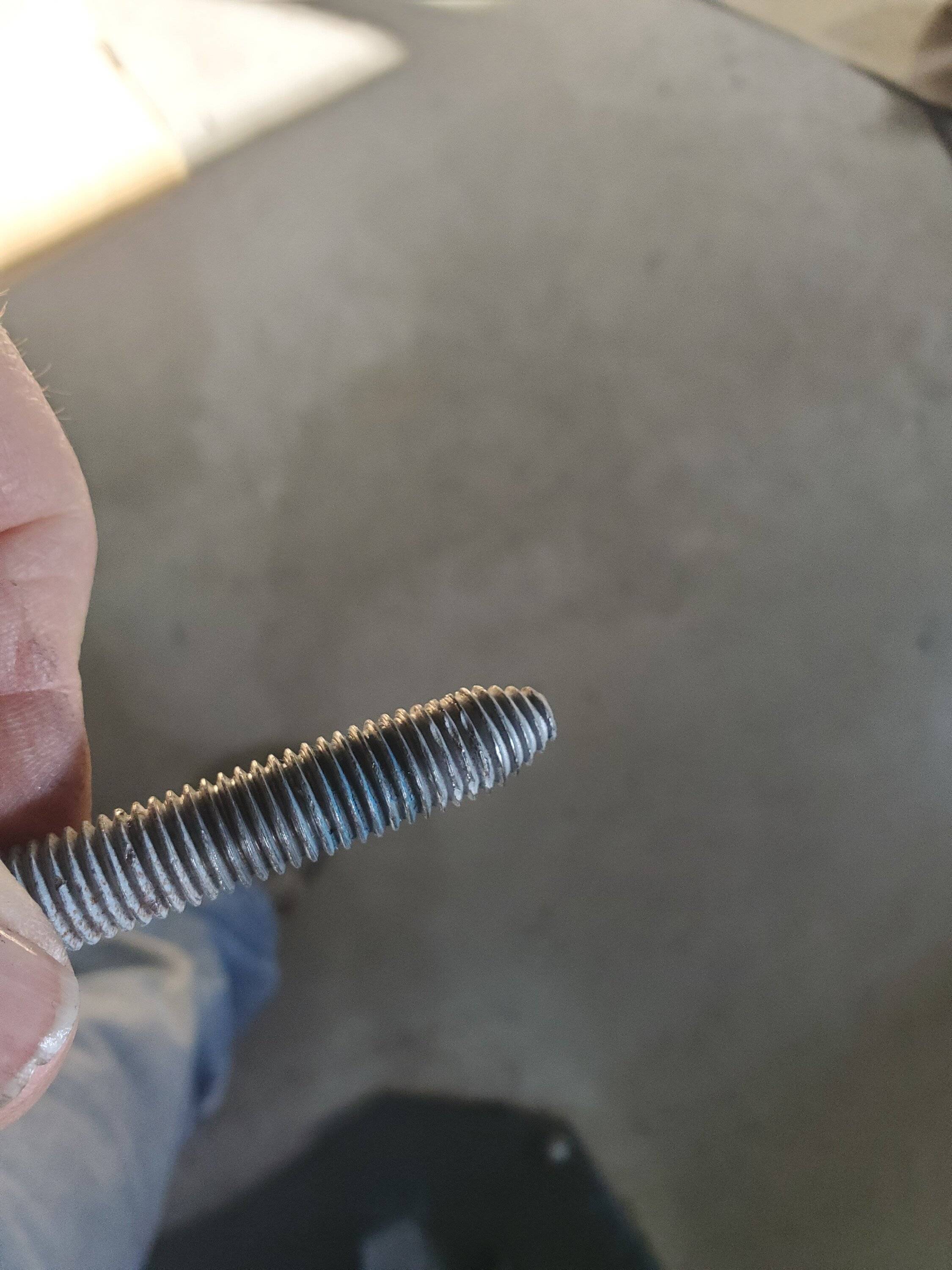

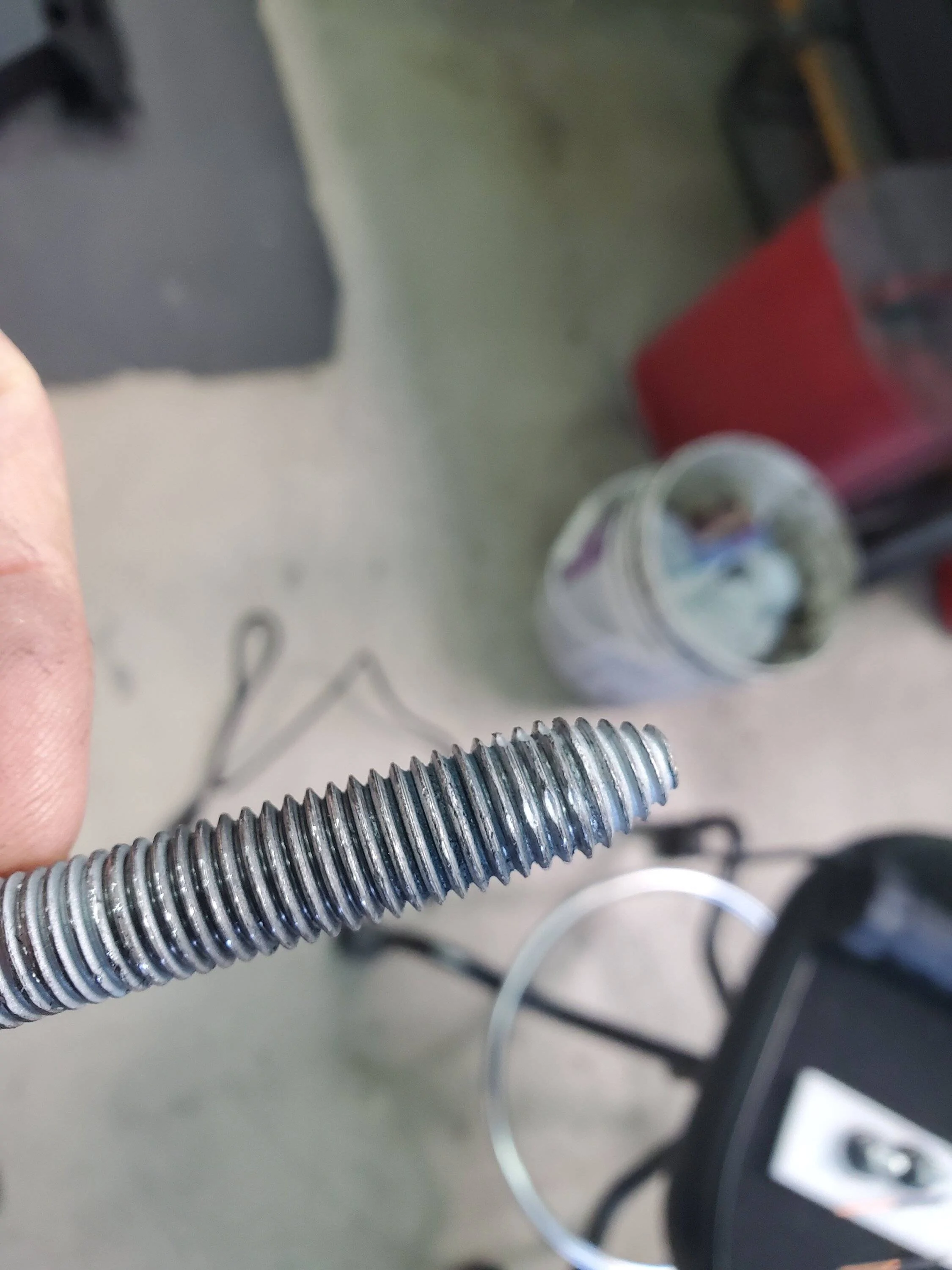

TTT, well started my Rock Slide install after reading all the problems and solutions. I have been working on Jeeps, trucks and cars for over 59 years so not a novice. Bought a bolt heater and long story short 1 bolt just easy as can be, 1 easy till last turn then nut inside broke loose, 2 very difficult and both nuts broke loose but got the bolts out. 2 bolts snapped and haven't got them out yet.. At least from what I see on a couple of these bolts its not the fact of to much loctite as I don't see any evidence of it being used but ends of threads are deformed on 4 sides on purpose so they bind solid and were not meant to be removed. My JK' were not deformed.
Now to fix this dam mess. My thoughts..if the wife can't get in so that's the reason for getting the steps just use a stool. If you rock crawl and need something for protection get ones that do not attach to the body mounts.
Jeep Gladiator Broken body mount weld 20231103_110528
Jeep Gladiator Broken body mount weld 20231103_110553
that looks like blue on those threads. How is the factory getting the deformed threads through the nut Without causing issues while tightening?
You know that the RSE power steps do not need to have the bolts removed - just a few turns loose. All you need is just enough to tap the bracket into place between the head and washer.
My bet - not enough time, not enough heat, not enough patience.
You mention taking bolts out - why?
