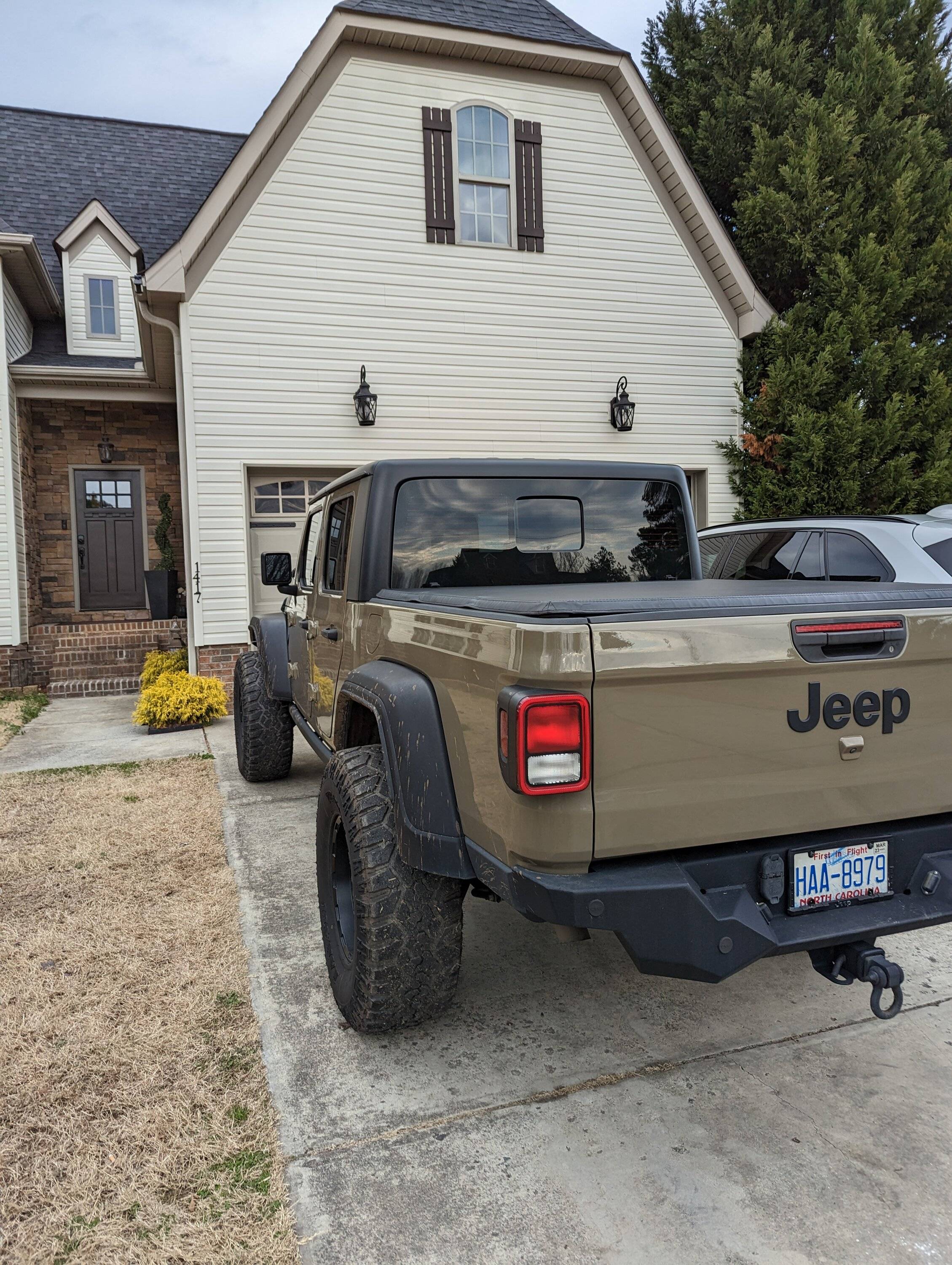

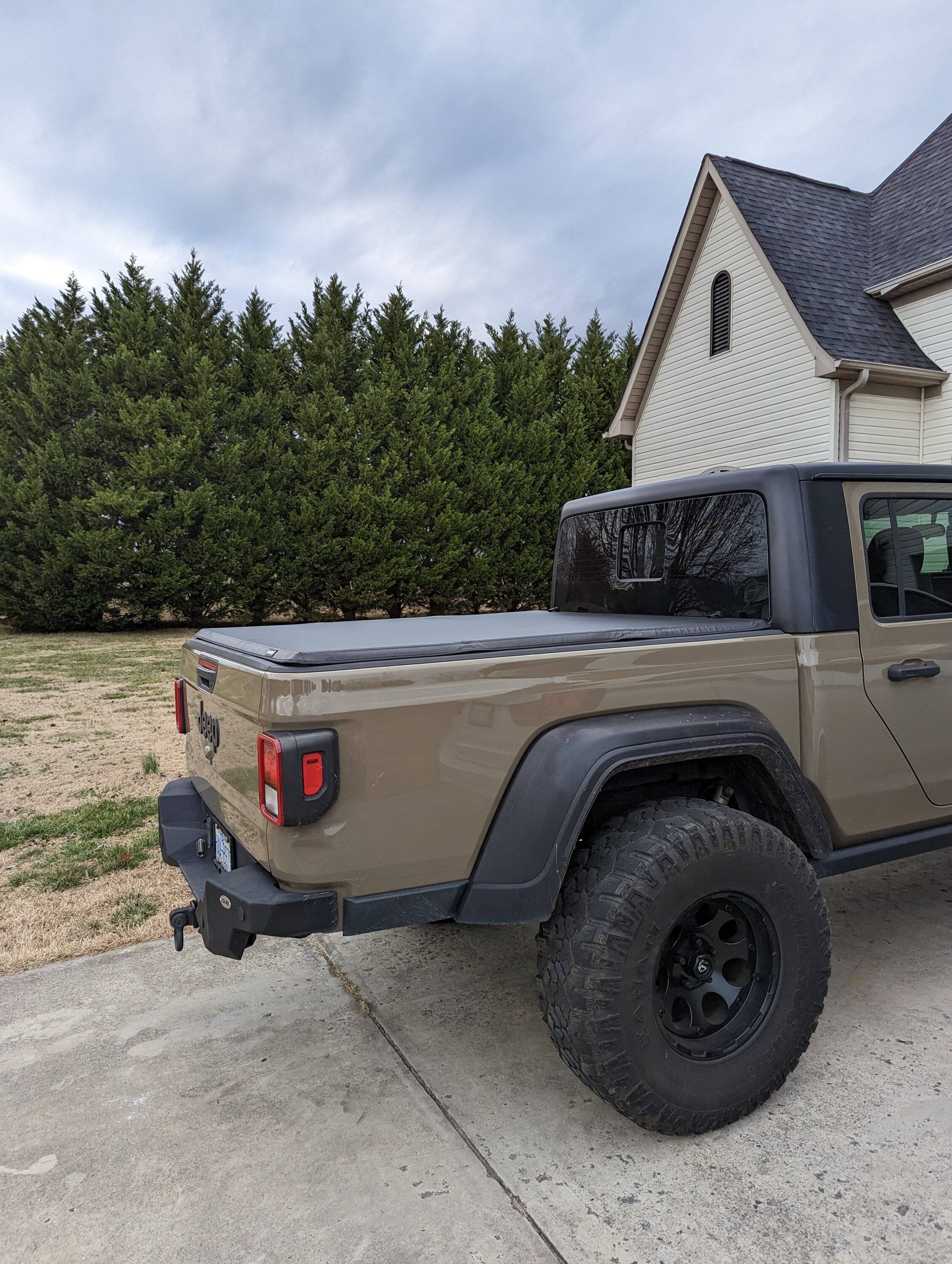

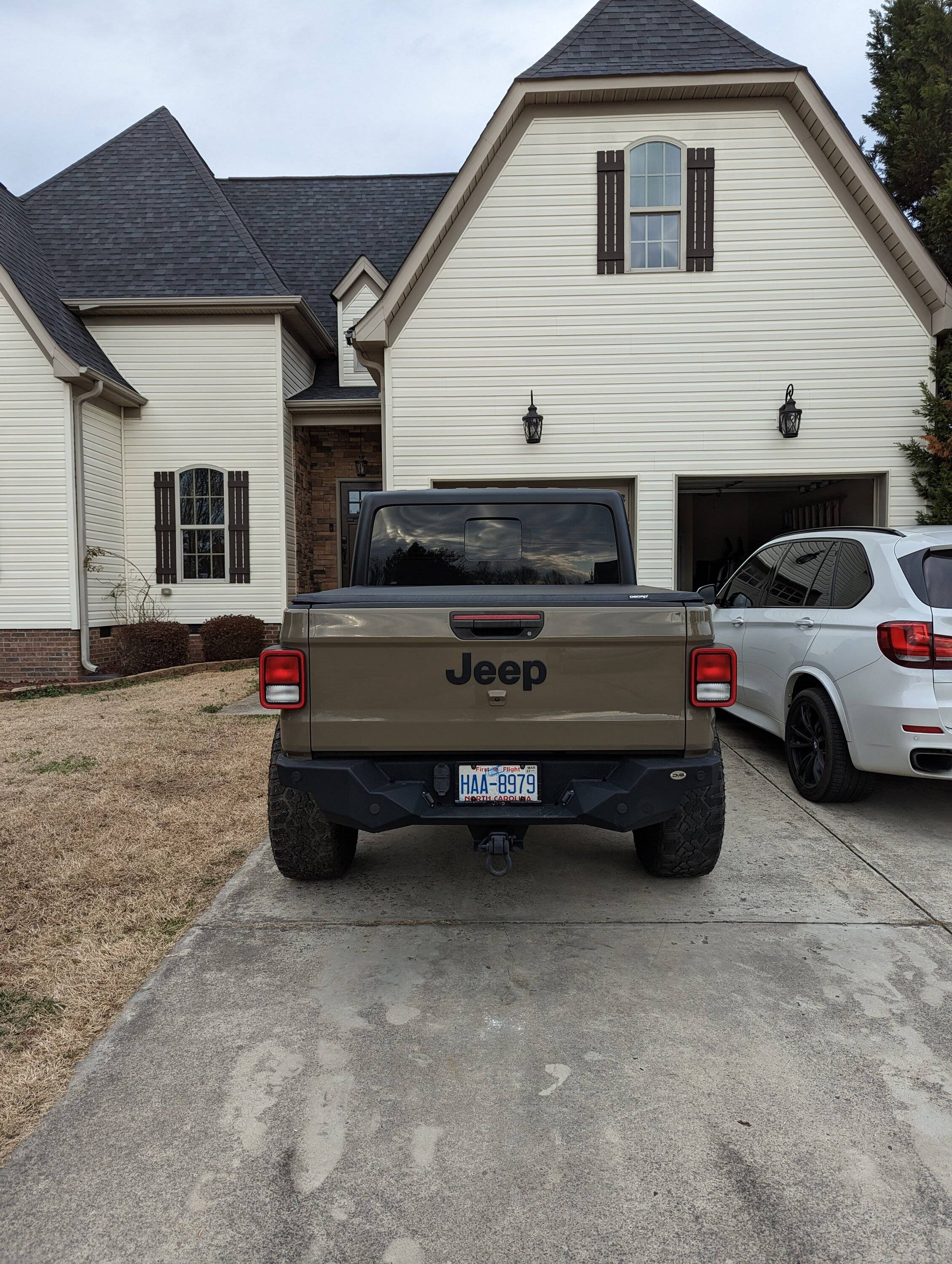

Covers on and pretty much the same as the one I took off as far as fitment and how it attached to the bed. Need it to warm up some so the sides will fold down and been more clean looking but other than that it's a tight fit. When it rains I'll report how well sealed it is
