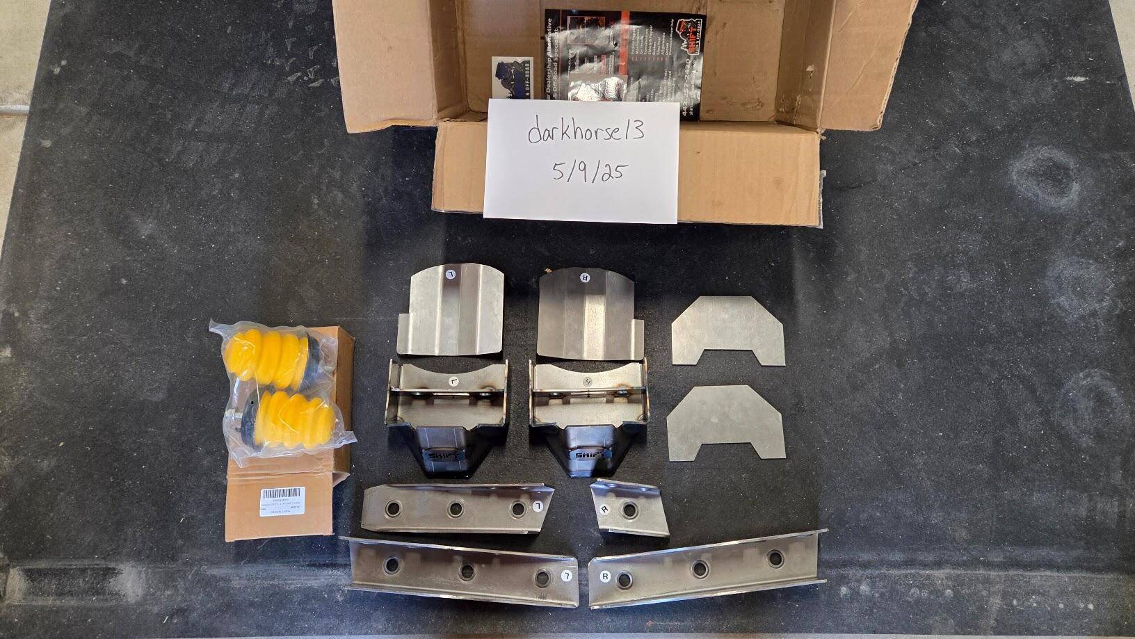

Hey folks,
I am going to be posting up my Shift frame bridges for sale shortly but I wanted to give the peeps here a heads up as well. I won't be getting around to install these this year and want to save someone $100.
Jeep Gladiator Broken Frame 1746825687841-gd
