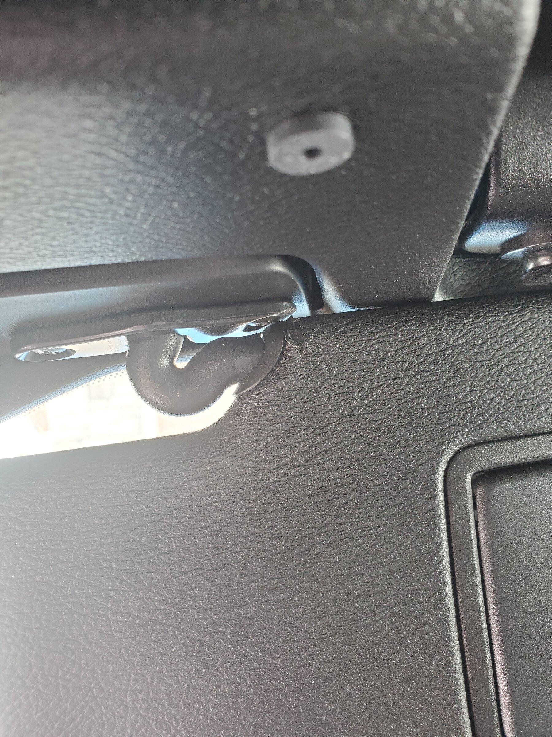

Just installed mine as preventive maintenance.
I suggest grinding a bevel as shown in the ebay pic. I accidentally cut a small groove in my driver side visor upon initial installation.
This pic shows groove and the necessary bevel..
Yep, I had to grind both sides as the visor would not even come close to snapping into the bracket. This is an easy fix for a stupid jeep problem.
